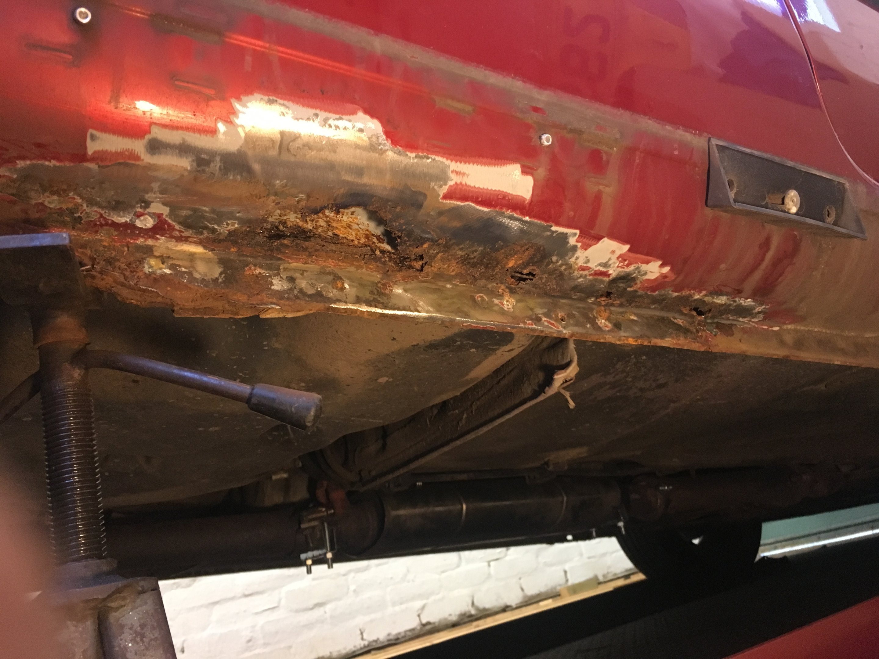

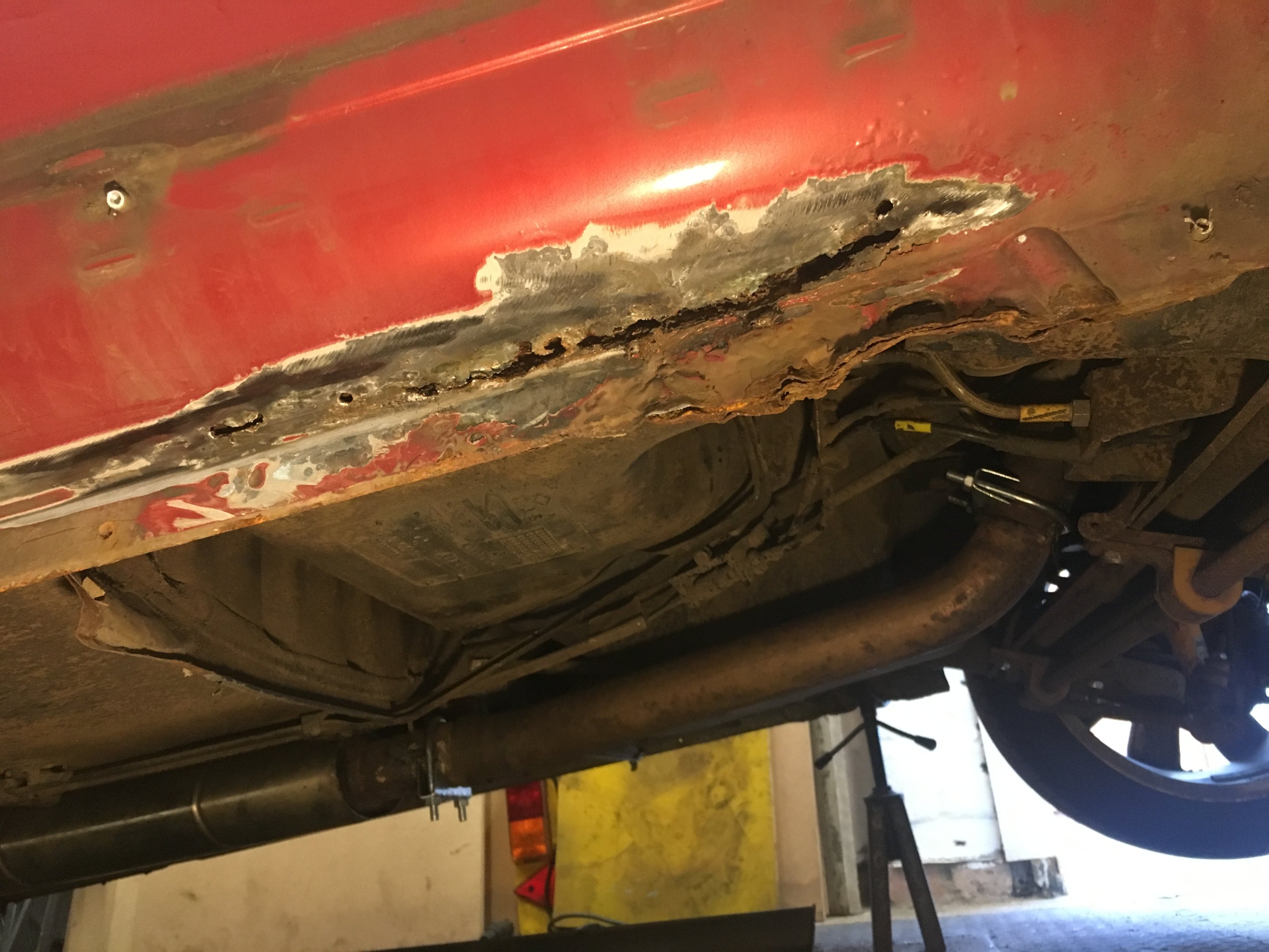

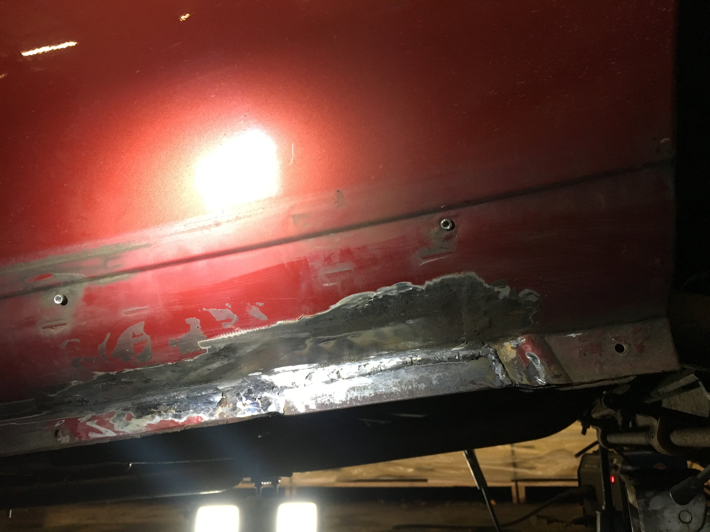

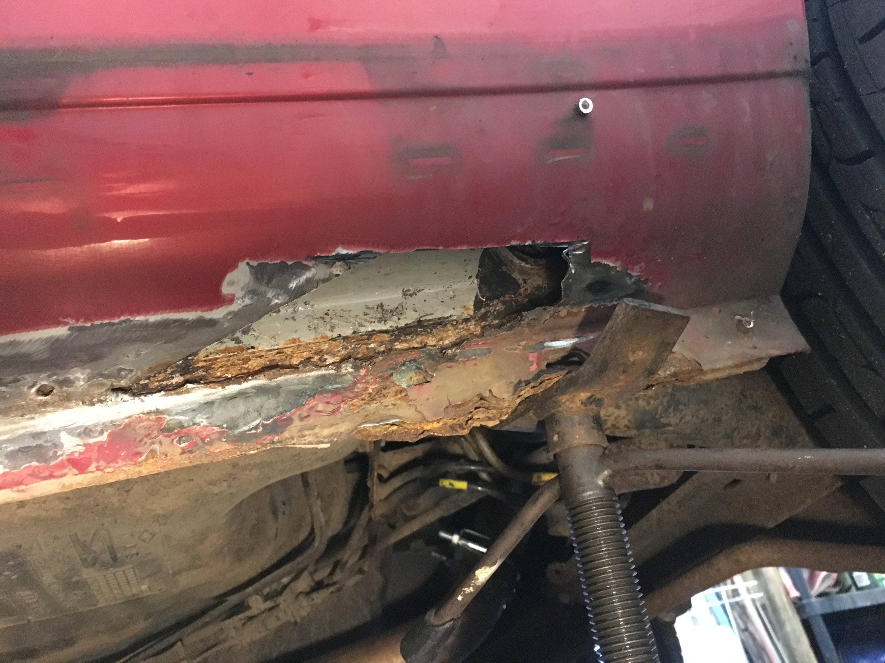

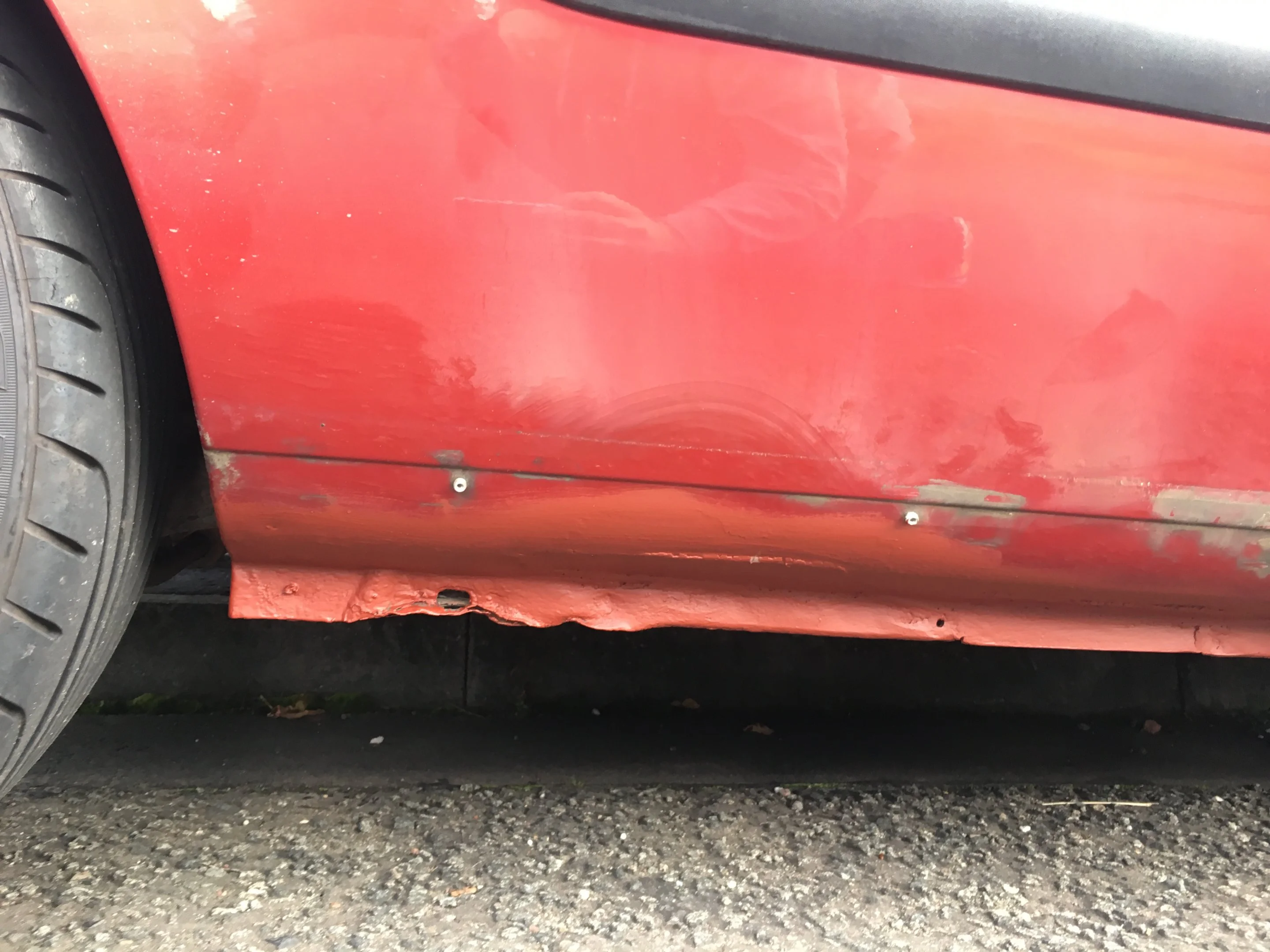

I may have spoken too soon

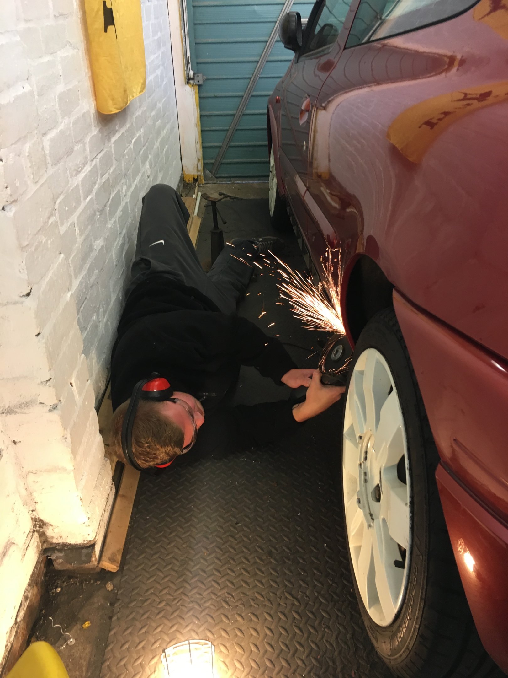

My ex friend @Djw Dave is over currently ruining my car.
Coops Mk1
  Lots of Scrap...
Totally fixable, bodge it up with some sheet steel, slap the skirts back on, done
Djw John
Scotland - South
Not being able to weld could cost me money here. Are rivets just too pikey even for track?!
But yeah, agree, it will be saved just annoying really.

I paid 200 for around 1.5ft of rear sill like that on my mk1 recently, only one side, but inner and outer welded up solid

Not too bad :up: never managed to get good at welding myself, have tried a few times. Does anyone know if you can you buy complete sills or part sills? Is their a company who make them?

My ph2 is the same as this as @Coops Turbo can attest to, I had the same 'just needs kurust' and when I got the grinder out holes started to appear!
Djw John
Scotland - South
Got a plan forming with another mate who's good at welding, we'll get it as ready as we can for him and he can stitch it together.
The inner sills don't look hugely pretty but they are solid so that's good news.
I think we'll do something with the jacking points too, straighten them out and bolt some box section on. May as well whilst we're there.

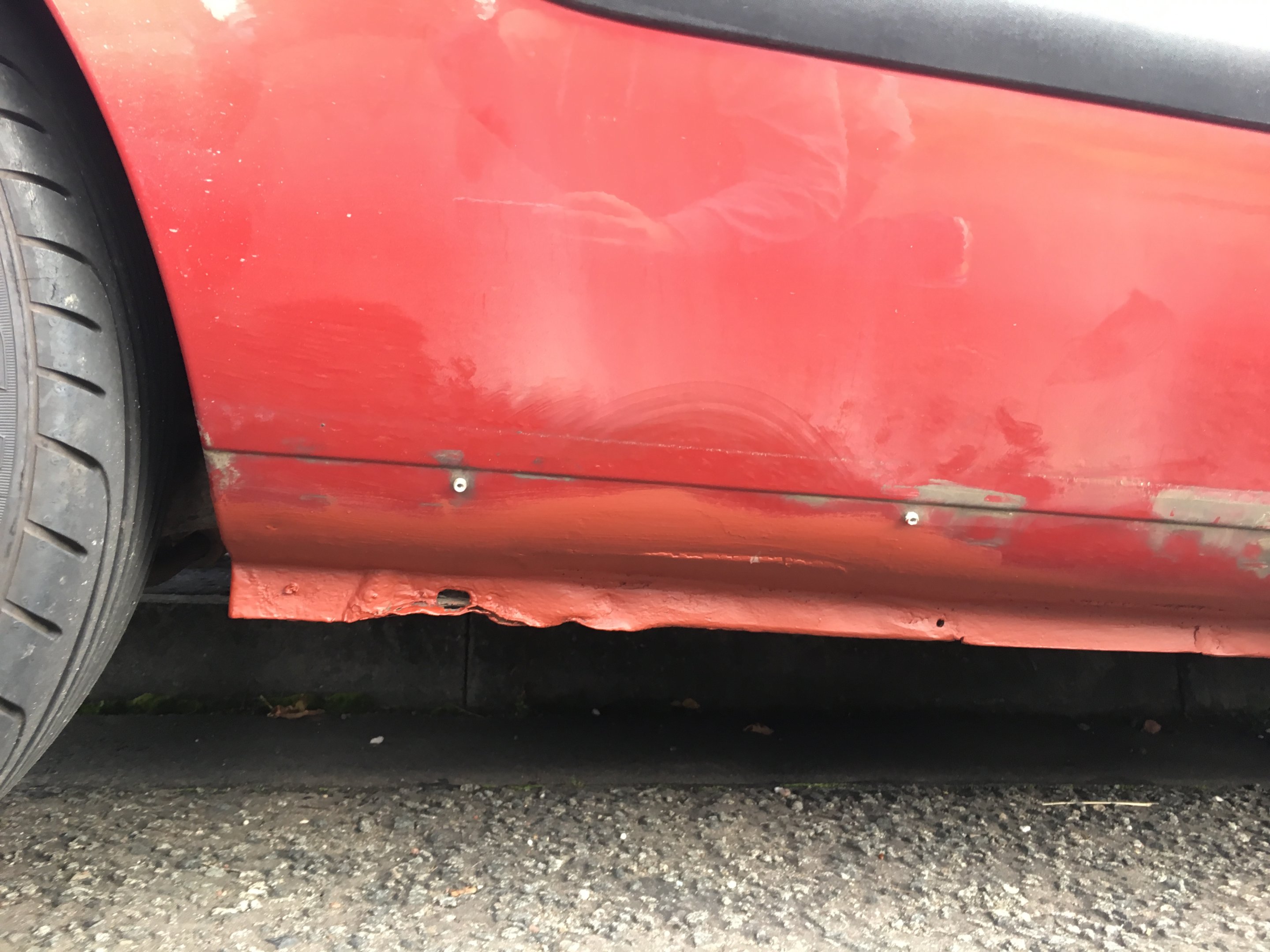

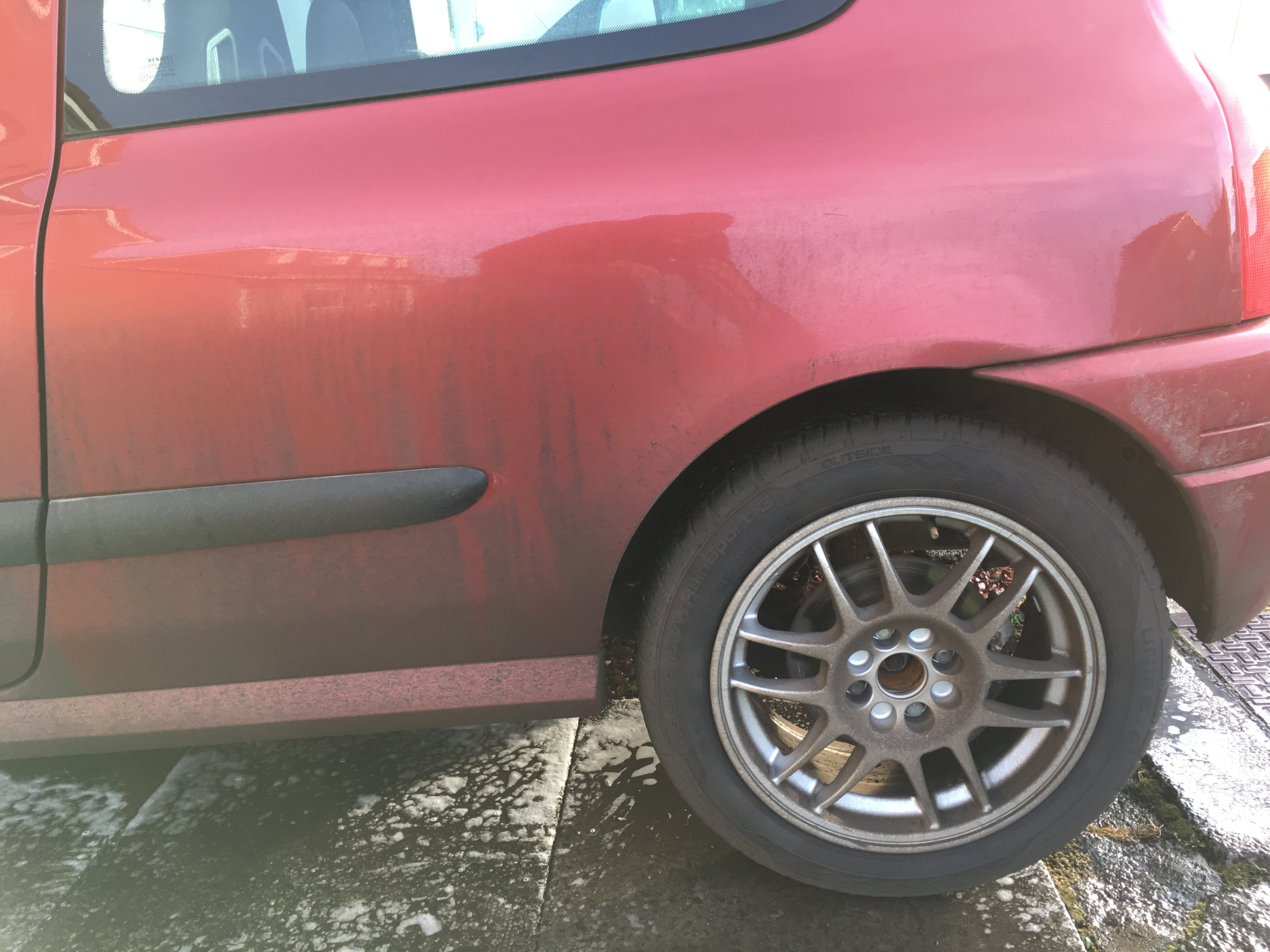

I bet a lot more mk2s are rusty than anyone realises @Akay whilst I'm not much of a detailer whenever I've washed it I've been very careful to blast all the s**t off the arches etc but this is from the inside out.
My guess is it's condensation running down the inside of the rear quarter and then sitting on the sill rotting it. Not much you can do to prevent that really.

Get yourself a bottle of Bilt Hamber Hydrate 80 for the crusty looking bits of the inner sills. It's like Kurust, only 100 times better and will give you a good chance of it lasting longer term

I think its the fact that the sills are rivetted on, combined with the bendy jacking points preventing adequate drainage means water is held for a long time.
I need mine repairing really, they have been plated but the rot is still coming through.

I took half a bucket of water out of my sills the other year. Not sure how long that was sitting in there, not my problem any more as I don't own the car!
Tbh that doesn't look too bad, I've seen worse. And no, rivets are not too pikey. Adds to that "race car look". Just keep the car living!

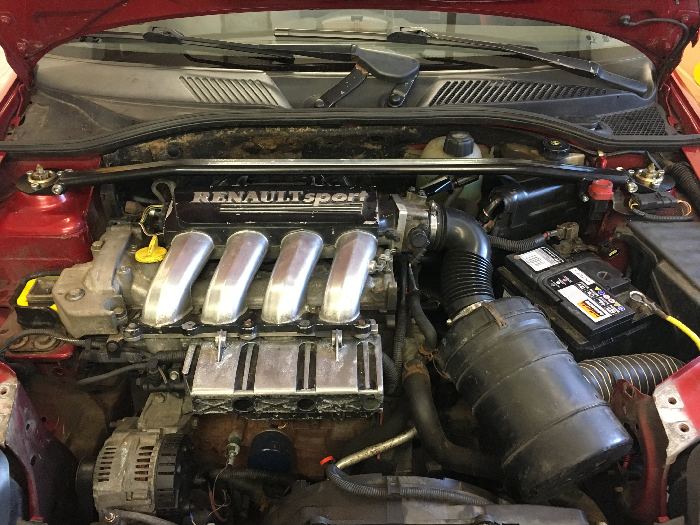

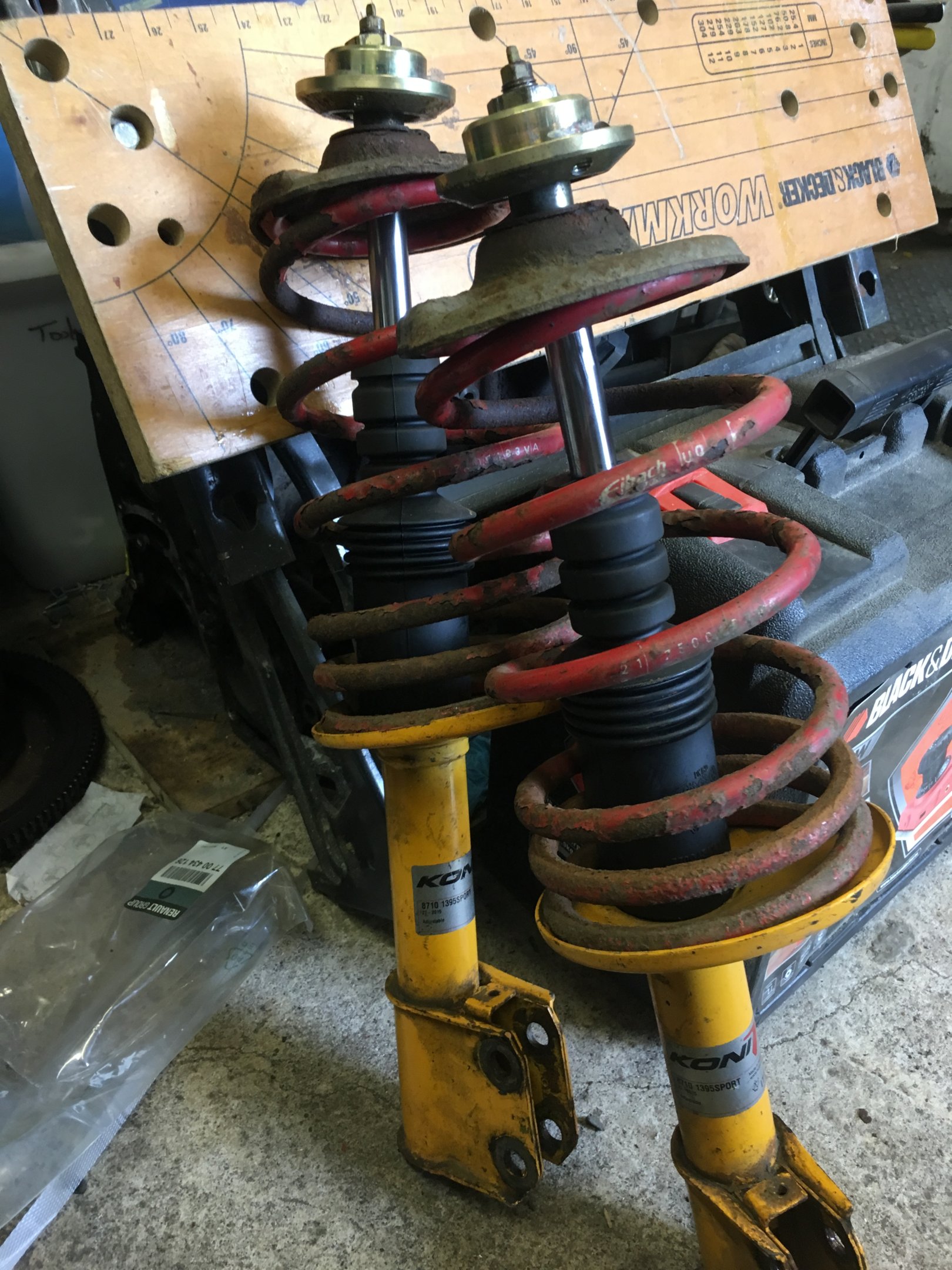

Did a wee bit more today after being busy with the family Mazda and Honda. Was almost nice getting back to French s**t and not jap crap.
Just chucked the pms brace and mounts on along with new bumpstops/dust covers.
Can see the inlet and fuel rail guard getting painted over the winter. Beginning to annoy me how s**t they look!

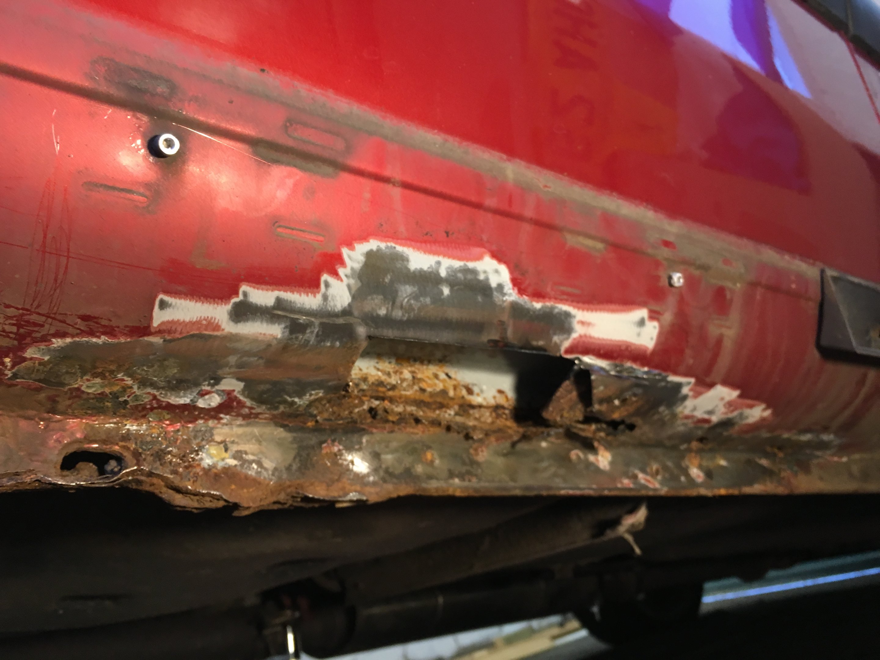

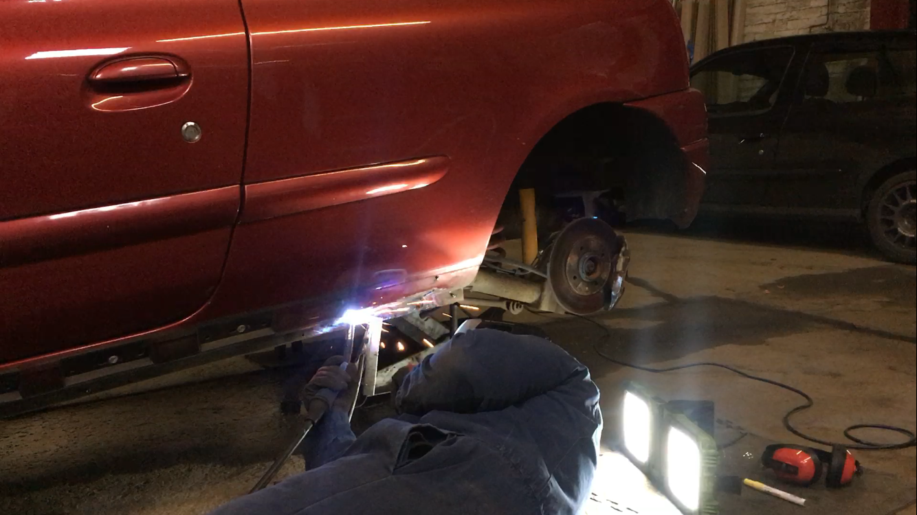

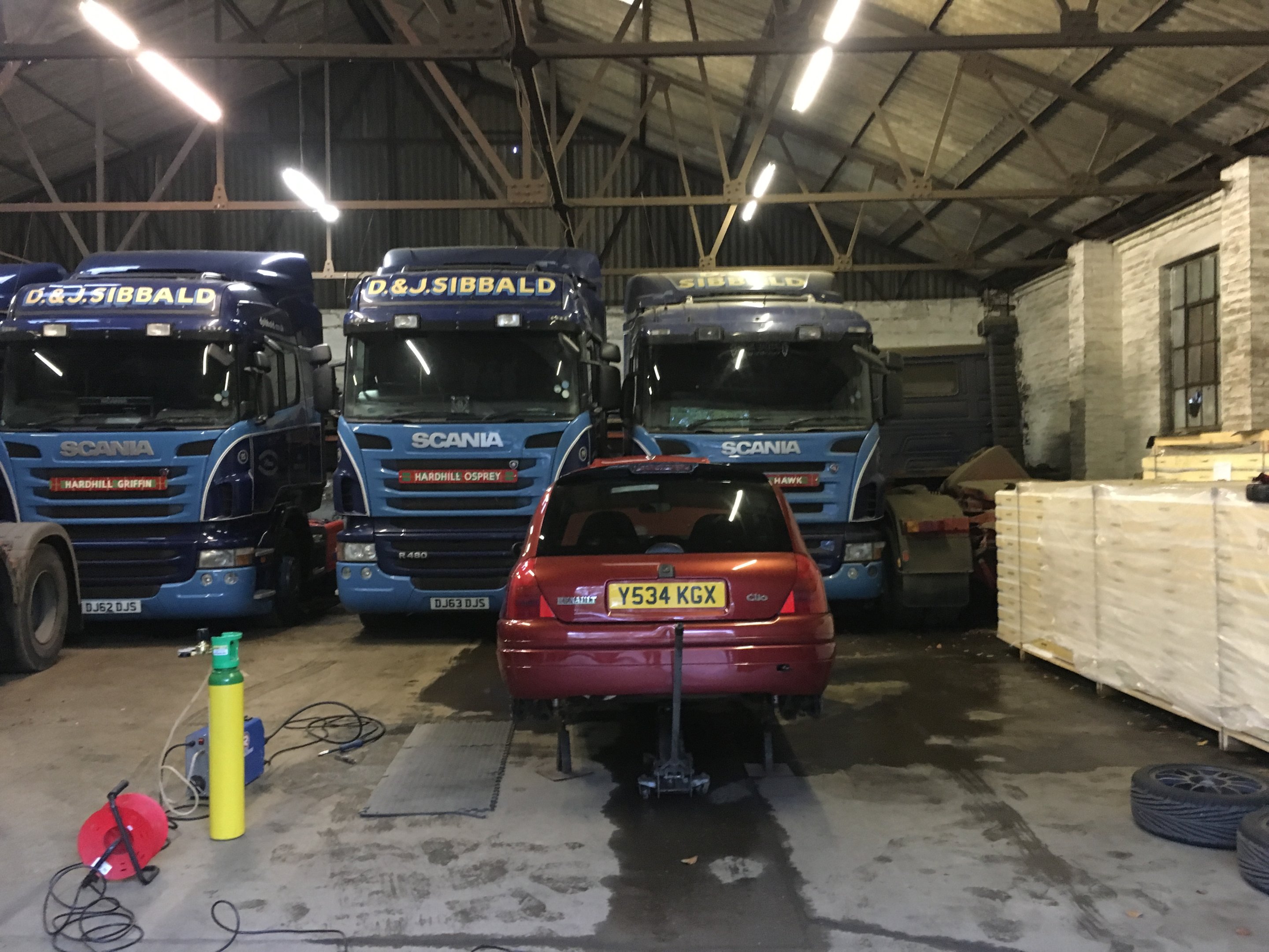

Well last weekend the Clio finally stopped having such large holes in it. Massive thanks to Henny for doing the hard work and Dave for the use of his work (again!) just a few pics from throughout the day.

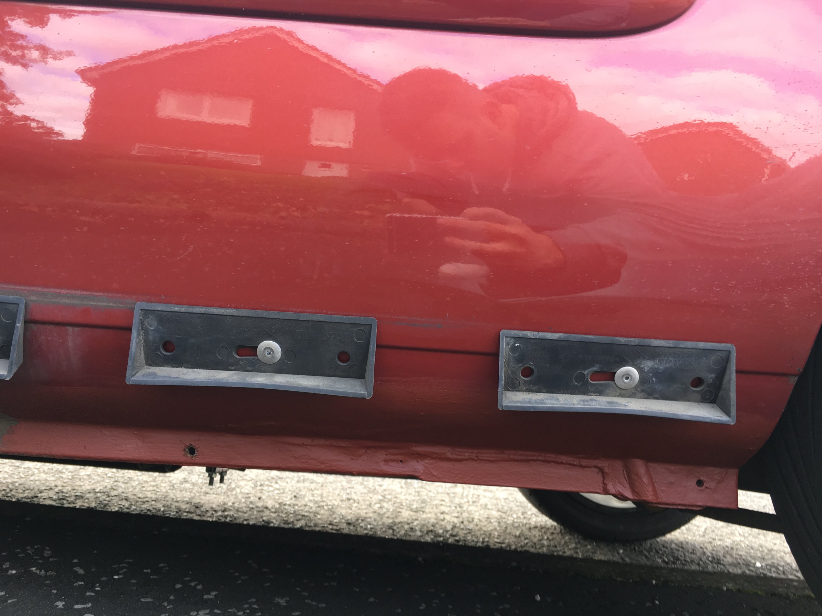

And the semi finished articles. All kept below the sideskirts so won't be able to see that anythings been done. Needs some paint and then skirts out back on. Bare in mind it's a track car, I had to tell Henny about a hundred times I wanted it strong, not pretty. But I'm delighted with both its strength and how it looks too.

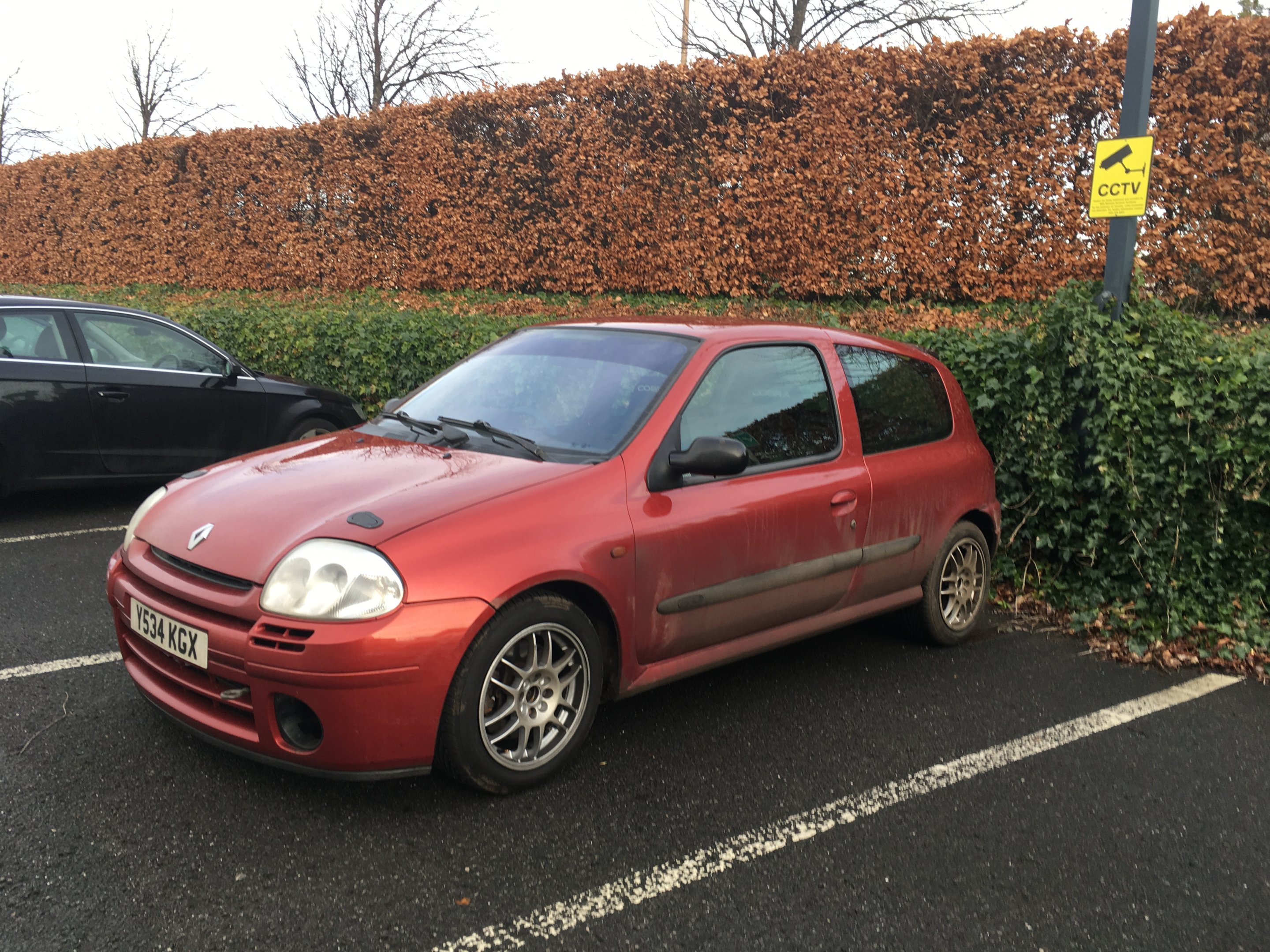

Been a fairly quiet month with the car until this week when I thought fuckit and used it to commute in. Which was fine bar the day I was hungover and then it was just annoying!

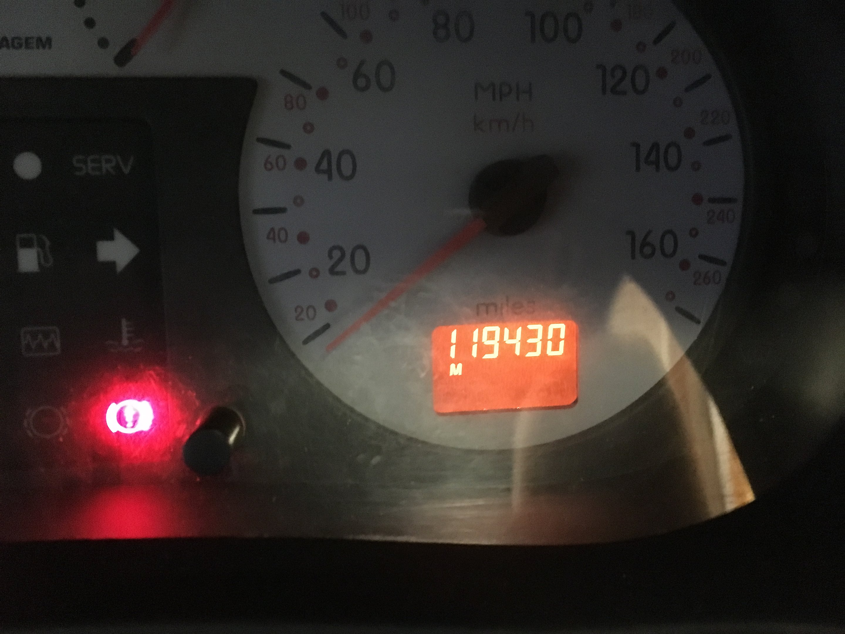

Really need to sort this battery light out though, gonna chuck a spare battery on just to make sure it is the alternator that's at fault but it doesn't take much of a charge at idle and they battery breathes heavily on track days so something isn't right.
Anyway, no update is complete without a pic so here's the only ones I've taken of it!
Didn't even take a clean pic dammit!

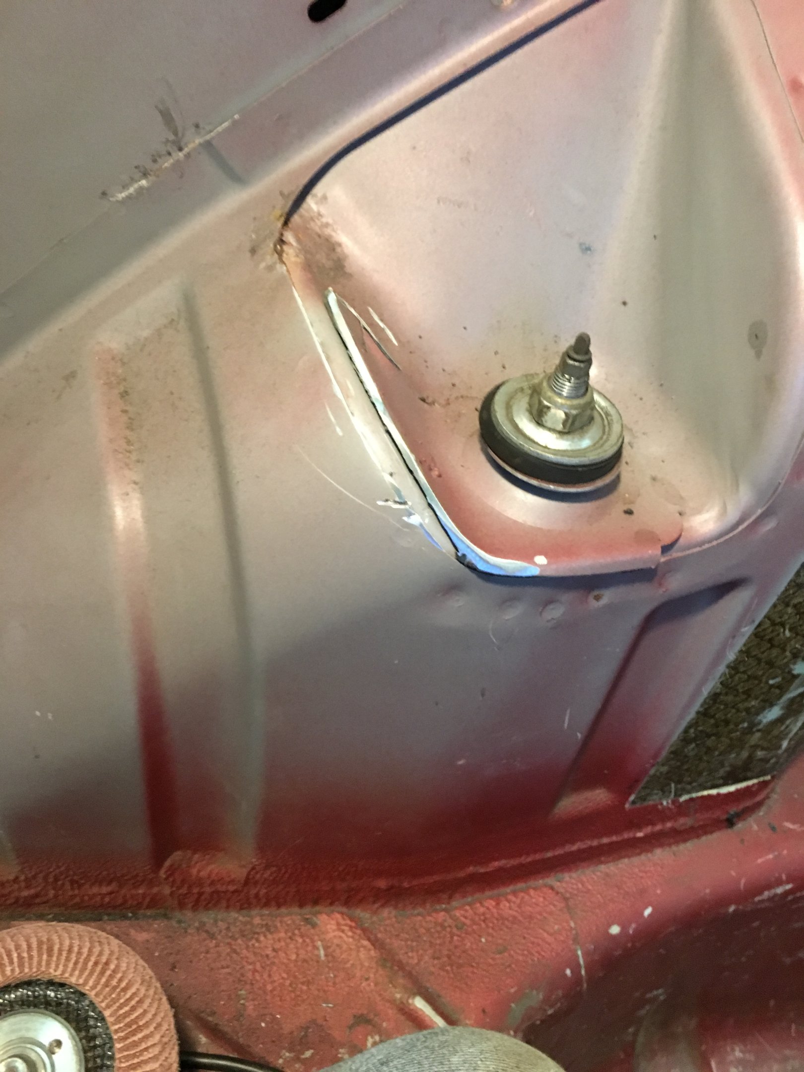

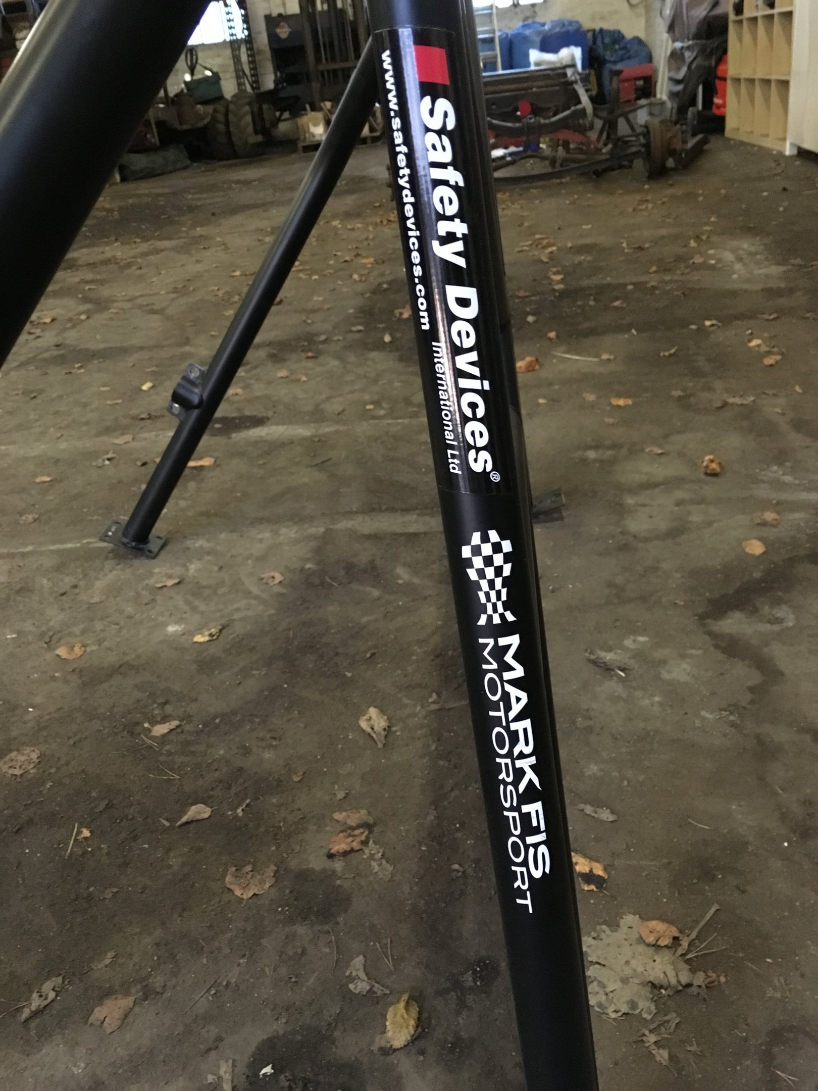

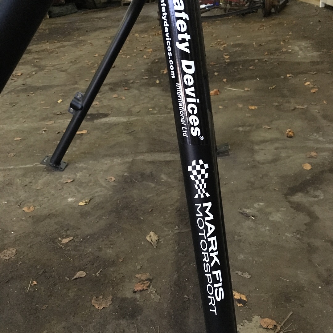

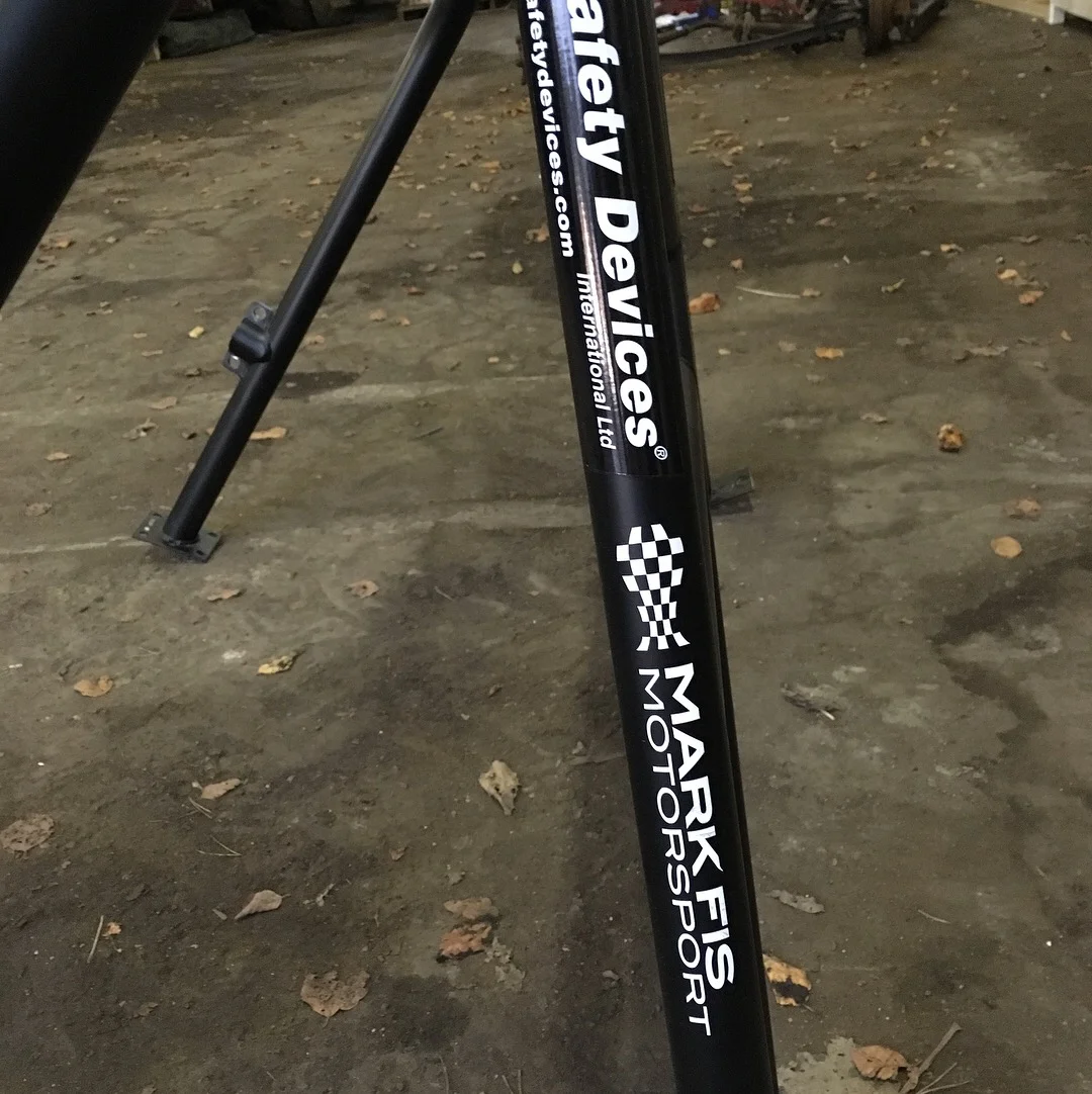

Also drilled out more bracketry from the back pre cage fitting which should hopefully be happening soon.
yeecup
  mk8Fiesta ST,172 cup
will look even cooler with the sd rear cage in. least you are doing in properly and not one of those ebay jobs. hopefully see it in action up at knockhill once the weather improves.
