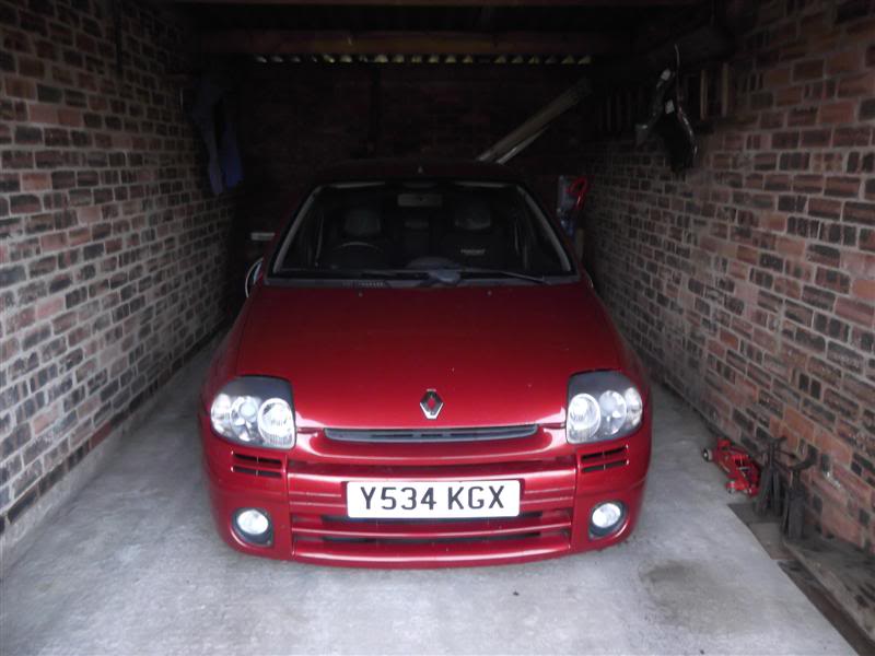

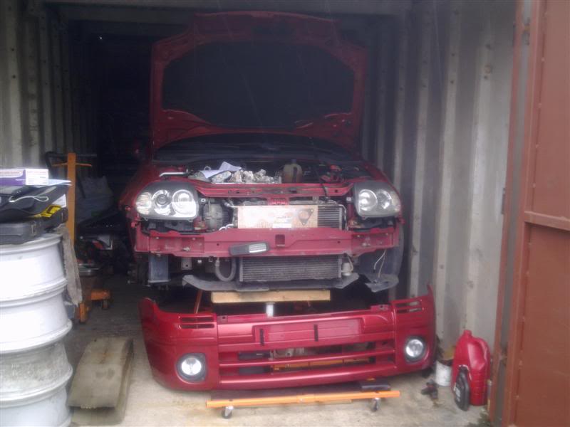

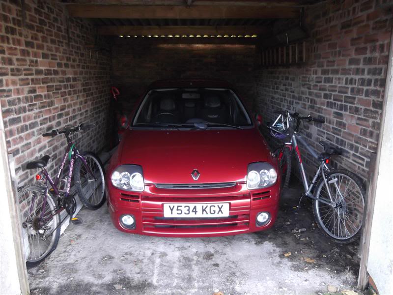

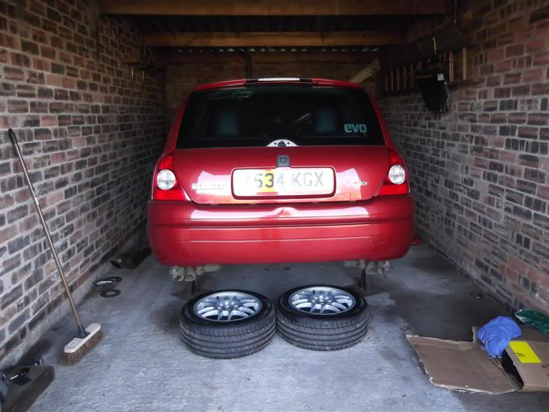

Well thats it officially off the road as of now, in a mates garage which turns out to be a decent size, a nice bonus, and now the work can begin. Again!
Djw John
Scotland - South
Re: Project Log - Ph1 Flame Red 172 *UPDATE March 2011*
Finally made it down to do something almost worthwhile, so far its just been tiny little things or making it worse by taking the coil pack off for Gaz!
Anyway, went down to it today, started straight away :)
and let it out in the sun for the first time in a month

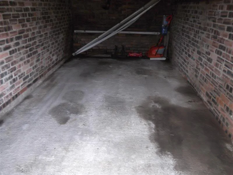

as you can probably see the garage isnt exactly waterproof, yet. Thats a side project I'll be doing, and soon hopefully.

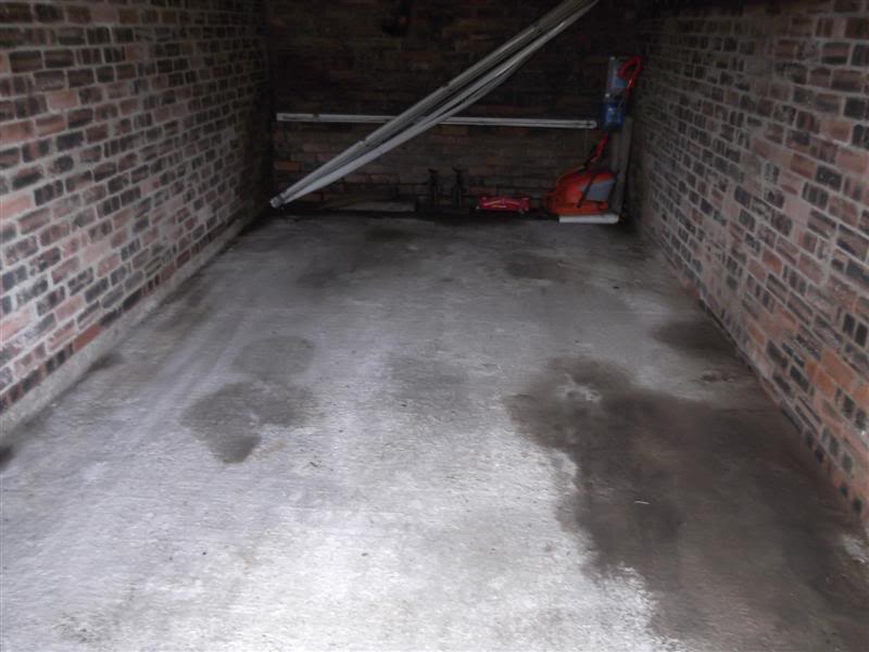

It was also a bit of a state so having learned from previosu laziness I gave it a good sweep out
much more pleasant to lie on now!

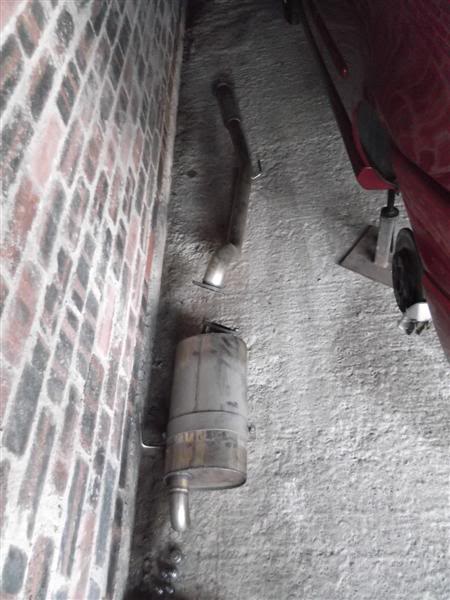

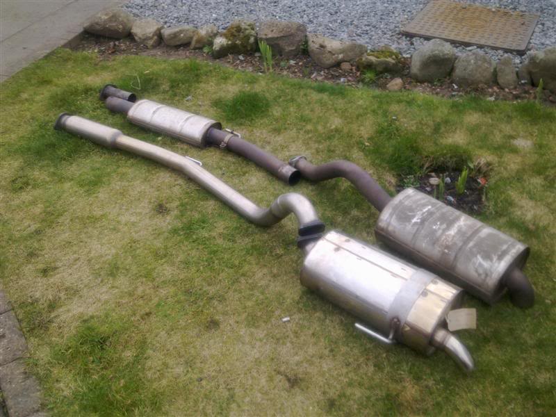

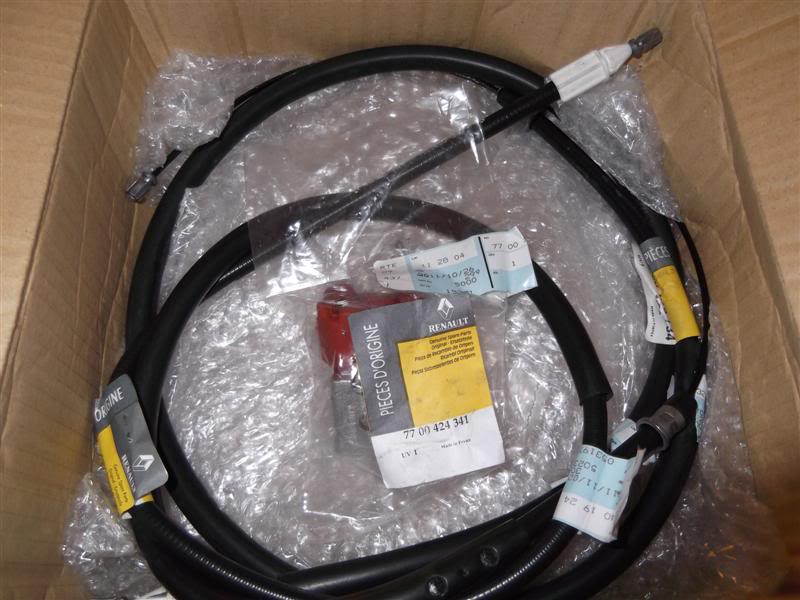

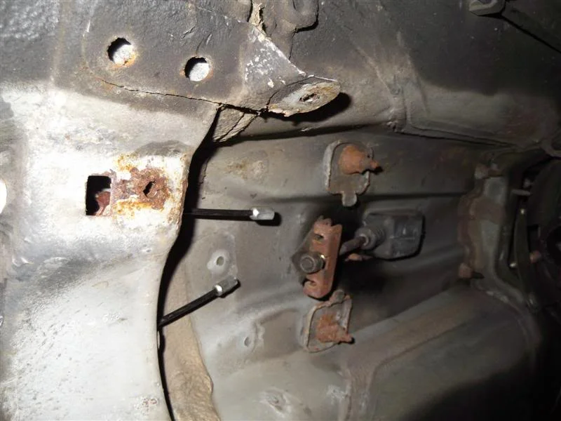

Anyway, went down to change the handbrake cables over and check the state of play with the rear calipers, first things first, the yozza has to come off
such a pleasure to work on, especially compared to most exhausts.
Old cables came off fairly easily but the new ones were far too short. Pattern parts ftl. Buy cheap, buy twice etc etc
Bought the cables about 6 weeks ago and they're now covered in copper slip and general dirt so wont be getting my money back from them, only a tenner thankfully.

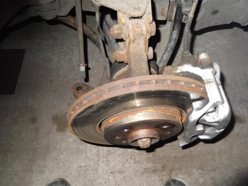

So decided to take the rear discs off as they're getting replaced anyway, (abs rings will be for sale if they come off without damage btw). No pics of this. NS was fine and so was the caliper. However the os disc was a bugger to get off and the caliper was sticking. This is also the side that the handbrake cable snapped on so imo the caliper has seized causing the bearing to overheat and the cable to give up. Was planning to service all 4 calipers anyway so no biggy.

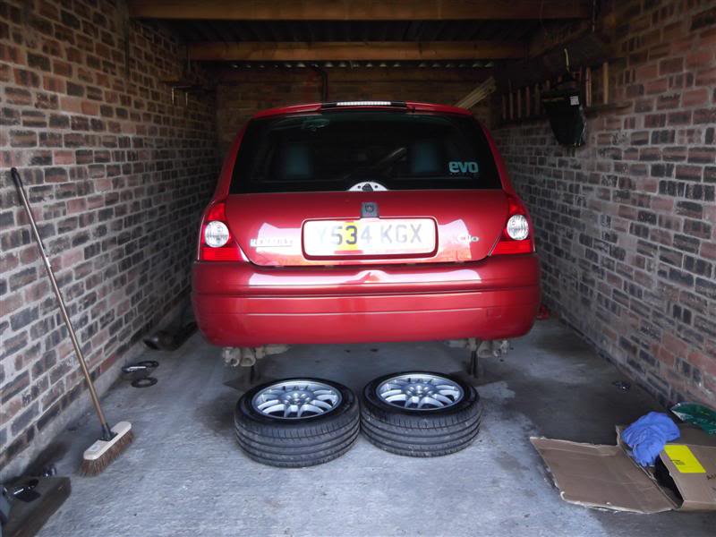

So having run out of things to do on the rear end due to a lack of parts I took off the rear wiper blank and drivers mirror to bring them home and give them a quick blast of satin.
So the car currently stands like this

Handbrake cables and exhaust mount have arrived thanks to Tom at Wests Renault for that :)
Probably fit them tomorow.

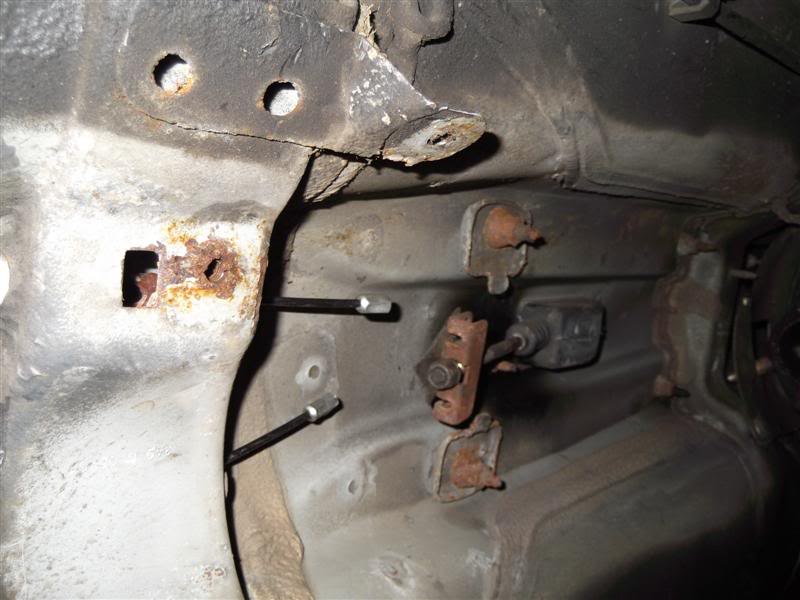

Managed a wee bit of time down at this the other day. Got the new handbrake cables and mid exhaust mount on, no pics cos really nothing to look at.

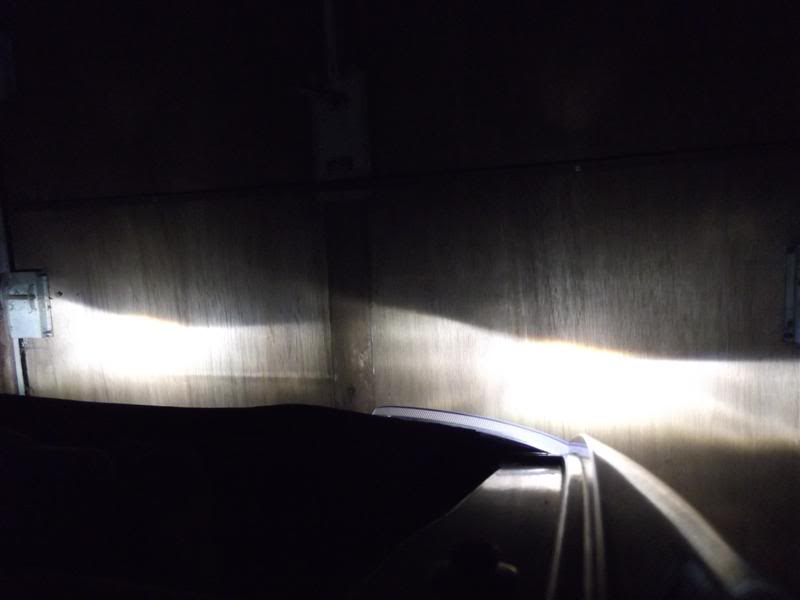

So having got it back down on its 4 wheels I turned it round
so I could adjust the headlights
It was at that point my mate turned up and probably thought I was gassing myself with the door down!

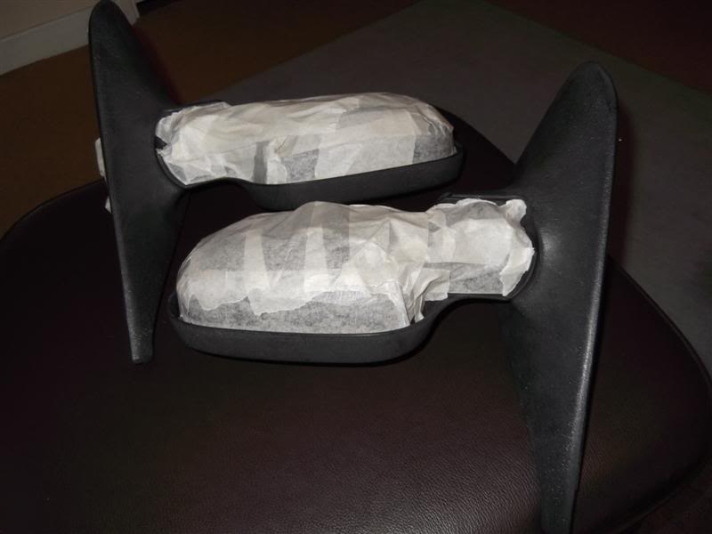

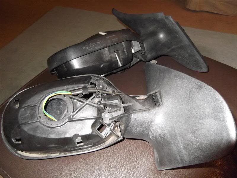

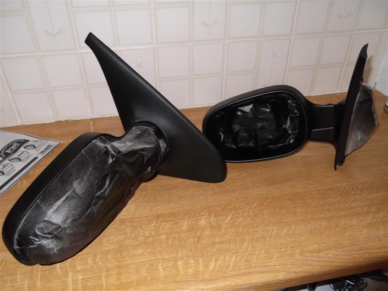

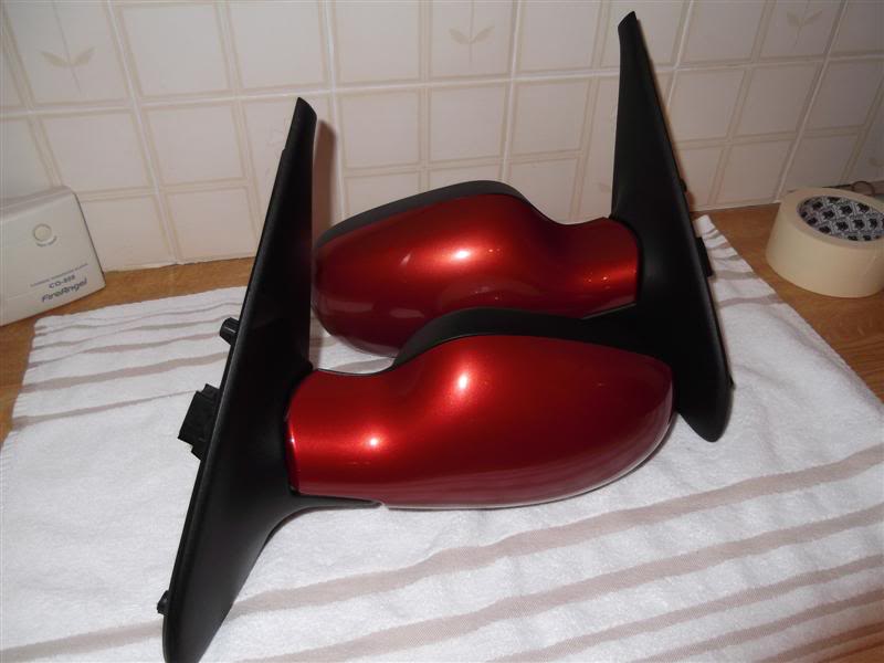

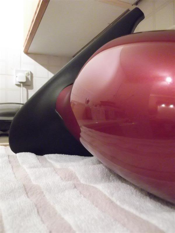

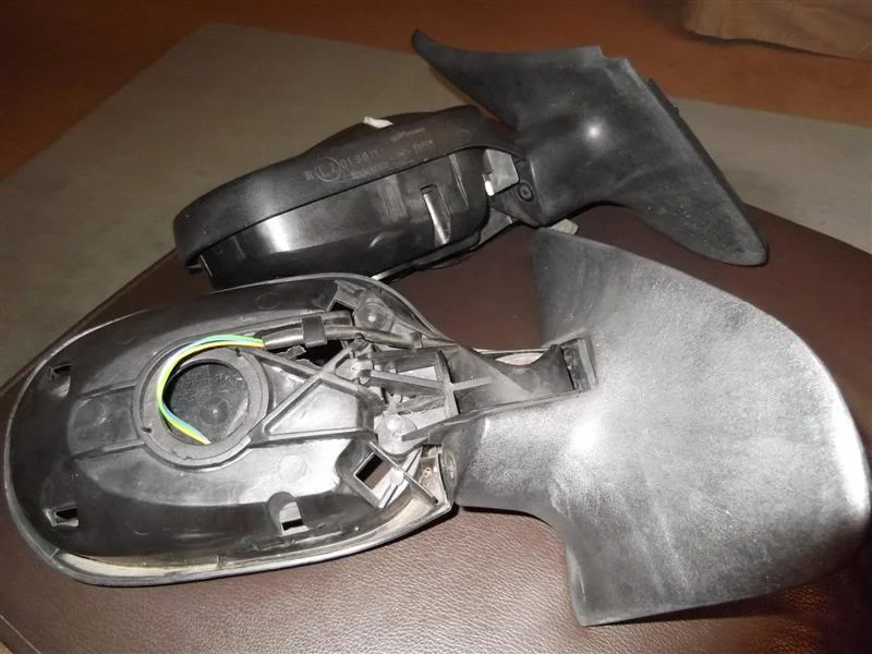

Also having previously taken the mirrors off I got on with tarting them up with a bit of satin black paint.
Started like this
Few coats of paint
and then with the help of this little lot
I also cleaned the glass and mirror caps to end up with this
Very happy with them and will never need to AG bumper care them again :D

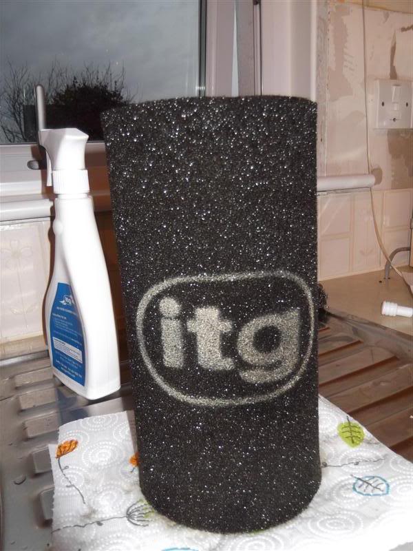

Also gave the ITG filter a quick clean but going to give it another one as it was horribly overdue

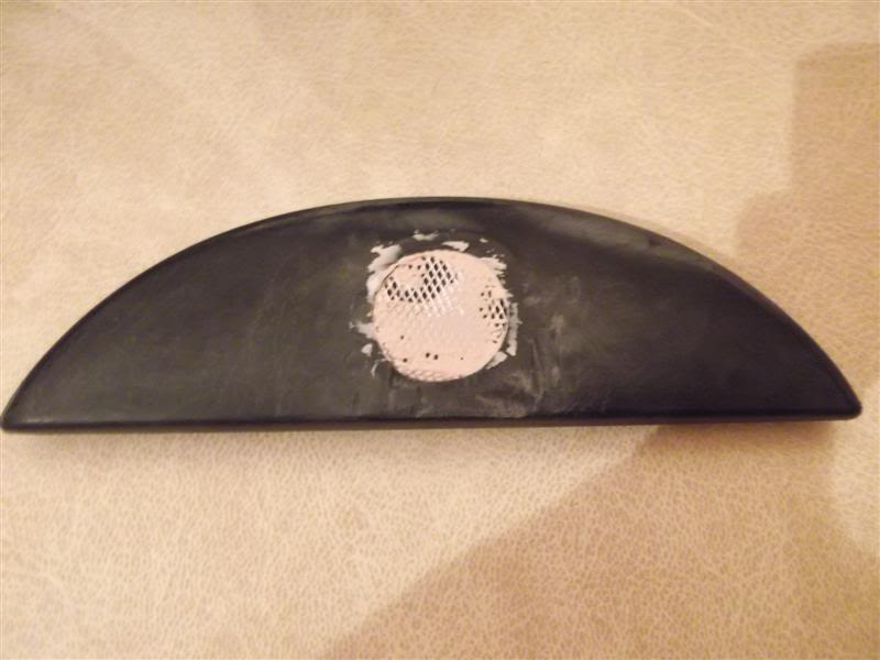

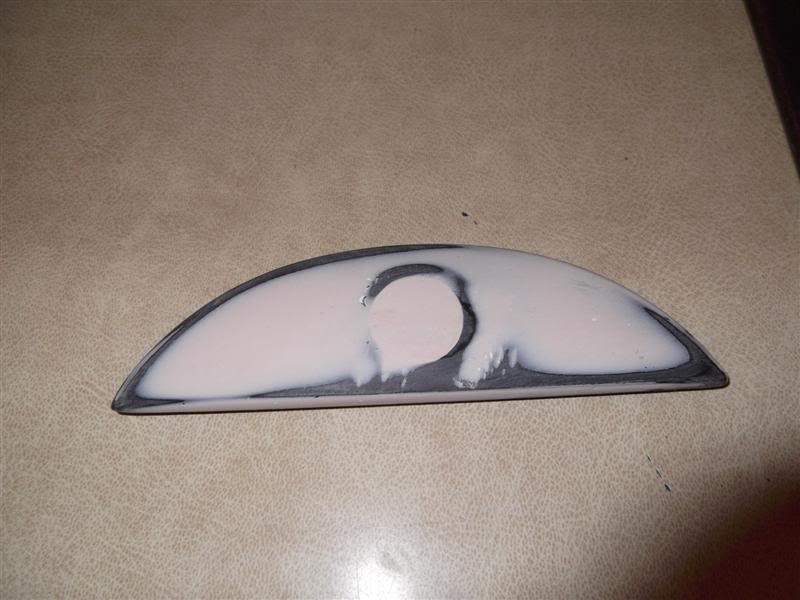

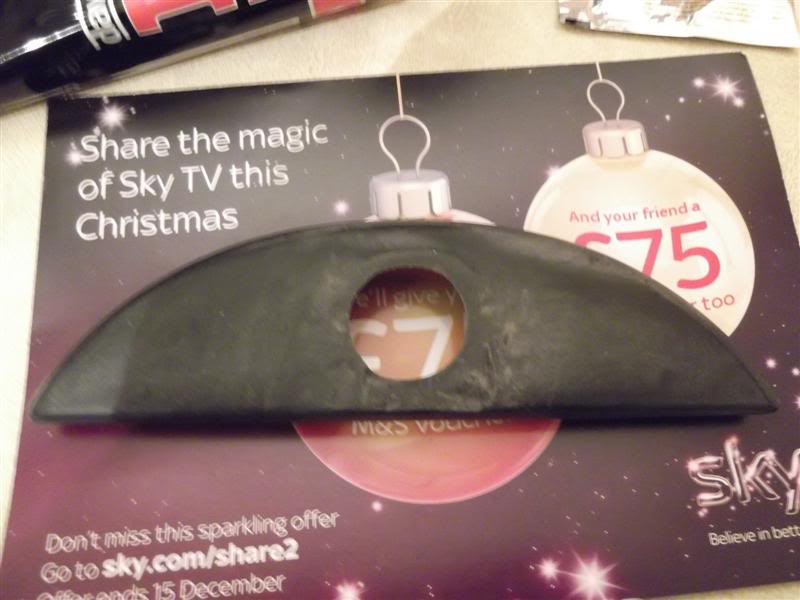

Started the next wee bit tonight, was hoping to get it all done but having never used filler before I had no idea how much it would stink the house out so my wife doesn't seem to keen on me doing the top of it tonight!
A bit of filler on the underside to hold the mesh on and voila
Cheers to Dave for cutting the panel yesterday when I went on an emergency cable tie run for another one of the cars!

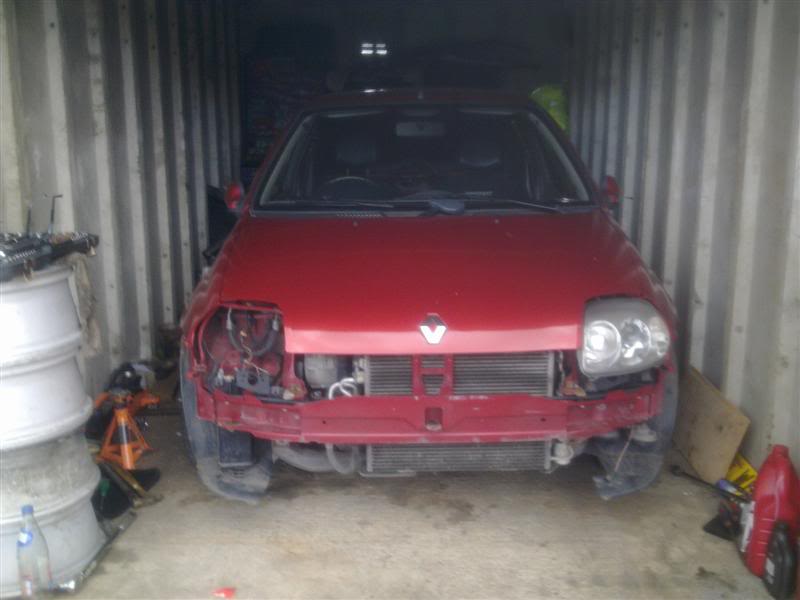

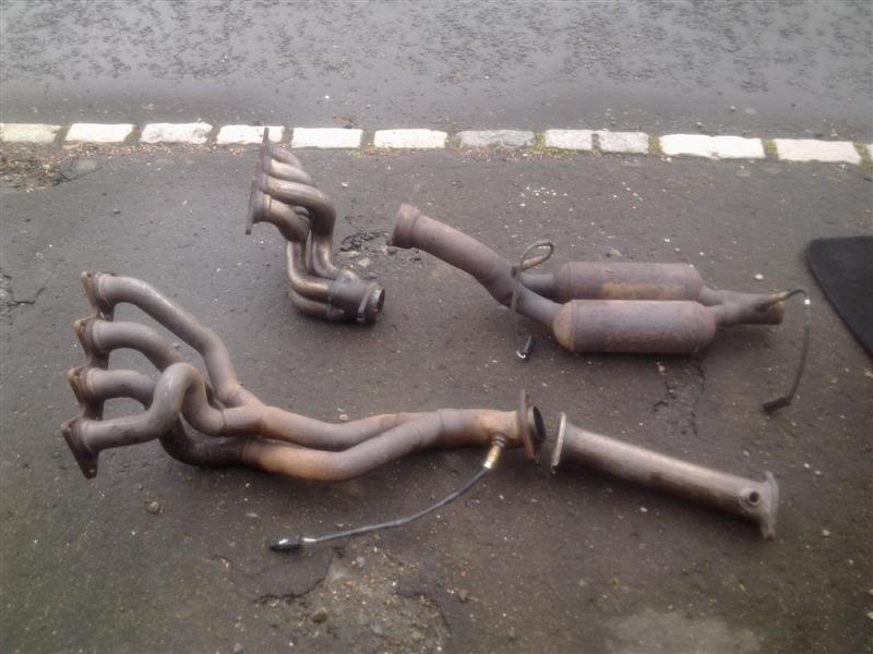

Just found some phone pics that I thought I'd chuck in here too, first one is a direct comparison of the ktec stealth and the yozza stealth that I changed it for
and then a similar idea with the original 172 manifold and the broken cat that I replaced with a 182 manifold and what I assume is a ktec link pipe
and a quick couple of it half way through that job

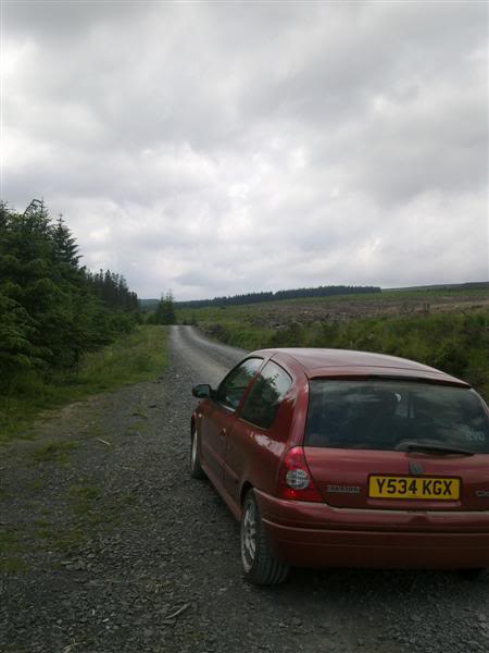

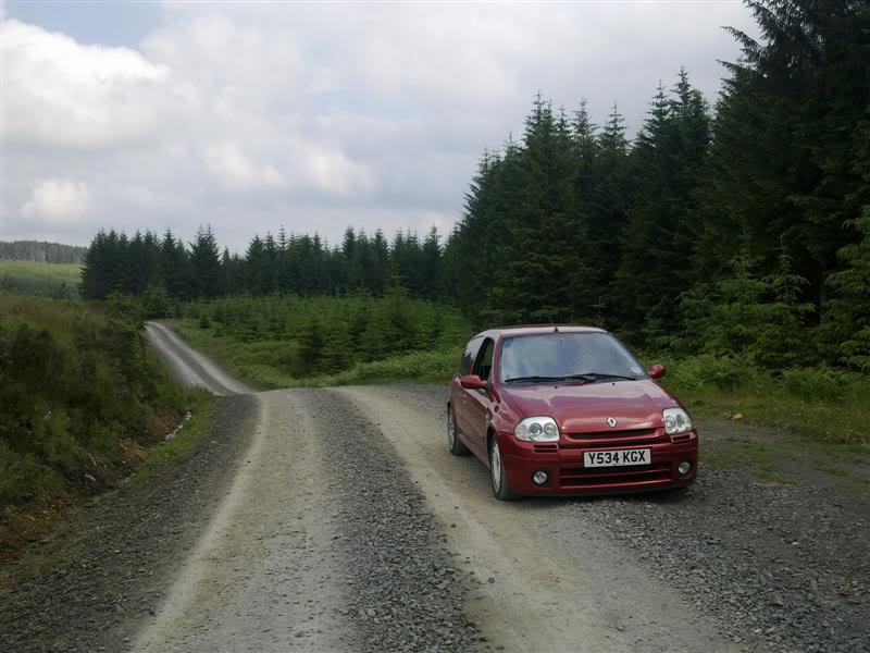

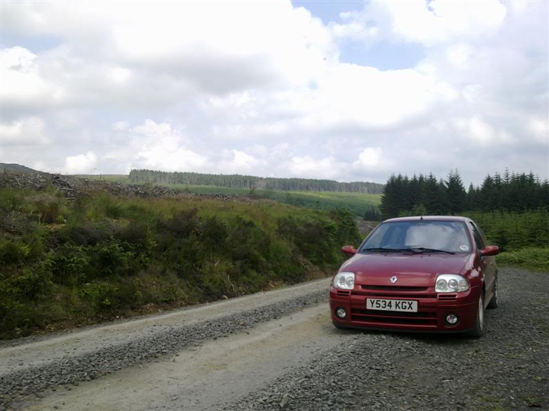

And also a few that I took on the Kielder forest road which is probably where I damaged the cat in the first place, a seriously bumpy road with huge mounds of gravel in between the wheel tracks, pretty much had to try and drive 'off piste'! Turned round after a few miles and thought i'd got away with just a filthy car but the car broke at Crail a few weeks after, maybe a coincidence, maybe not!

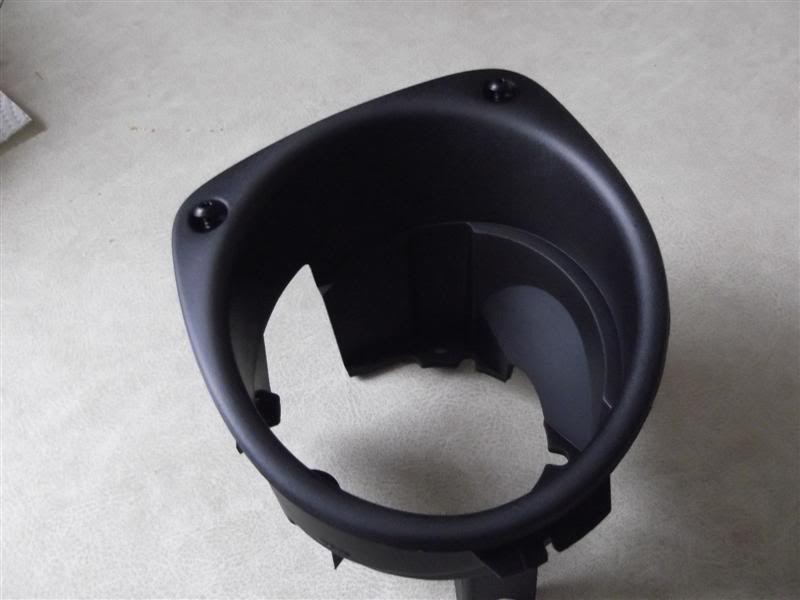

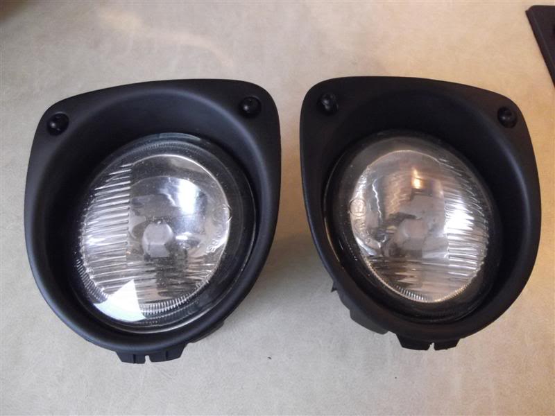

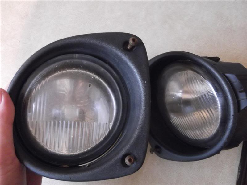

And popped the fogs off to give them the satin black paint as well
Before
Before putting them back together
And done
Easiest job ever? Probably tbh.
