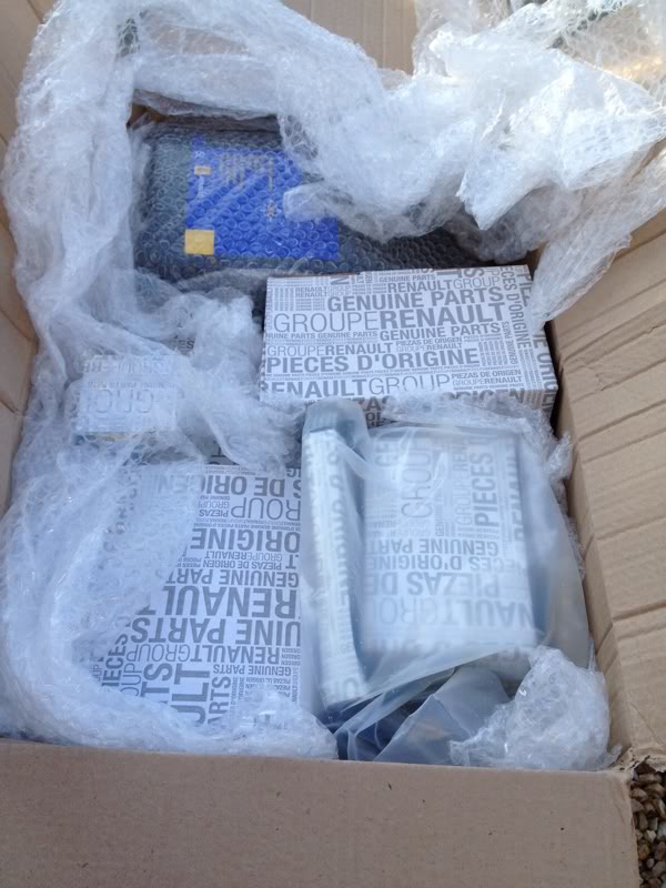

Well a bit more has happened recently to the flamer, got this box of bits from renaultpartsdirect

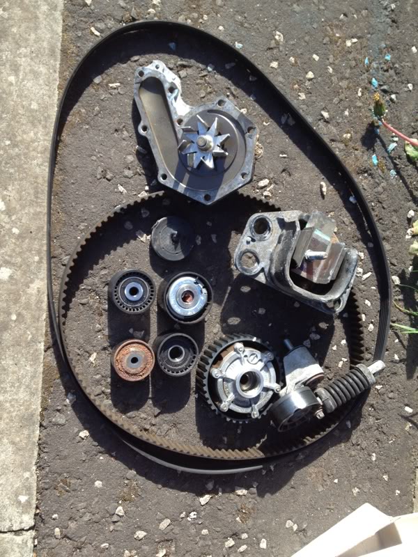

Which I then took along with the car to swr Stirling and picked it up today with this in the boot in return
Very happy, car seems bang on, got a rolling road a week tomorrow so will be obvious soon how good the timing is! Every faith in them though.

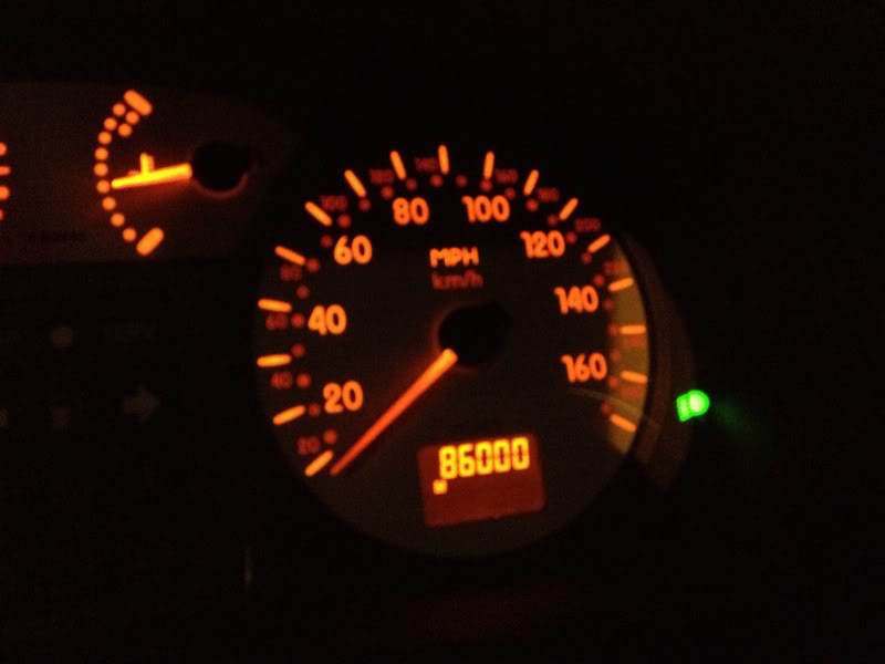

Also went through this landmark recently, it's certainly getting below average for its age these days, I hope to change that but too busy for the same random driving that I used to do

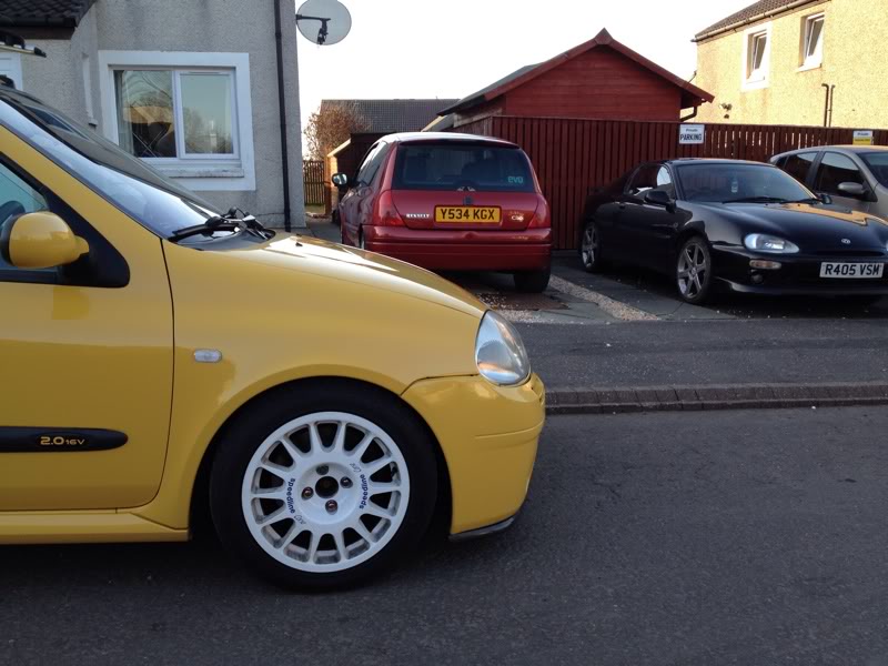

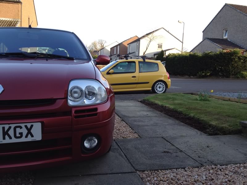

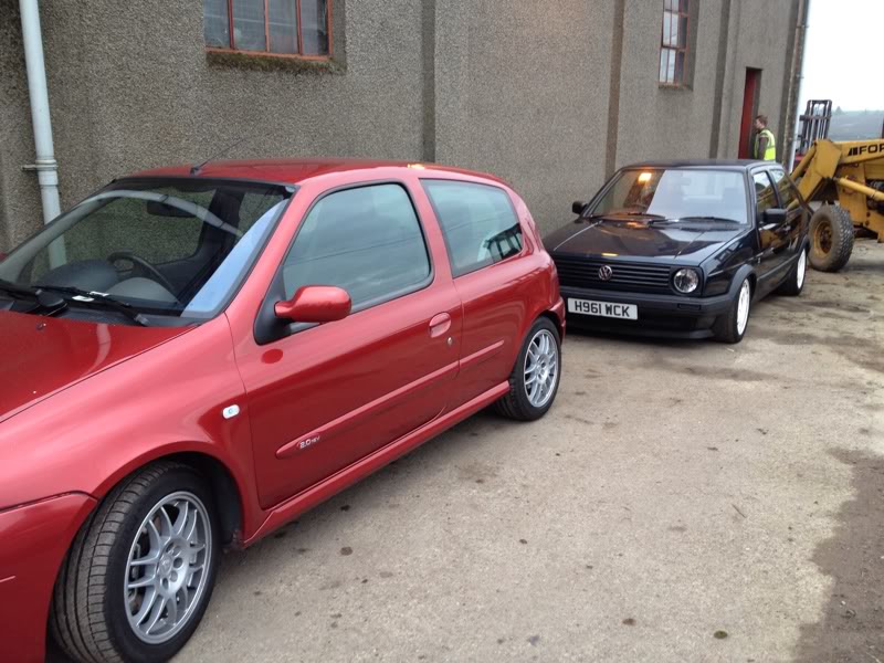

Also took a quick pic with daves golf that is up for sale and wee stu was over skirting my back room so took a quick pic of the 2 rarest 172 colours together!

Damn fit Jamie, figured may as well, also got the thermostat changed As well but forgot to get it out the box, only do it every 5 years so may as well do it right!

For fitting both belt kits, thermostat, dephaser and water pump they took £273 labour, I supplied all the parts. It had an oil change 1500 miles before hand and will get another in 3500 so didn't bother with that.

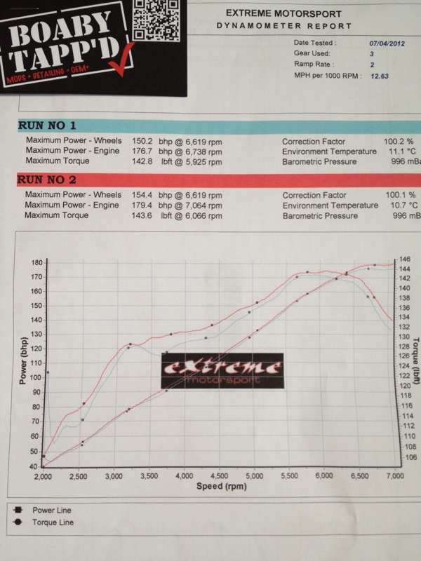

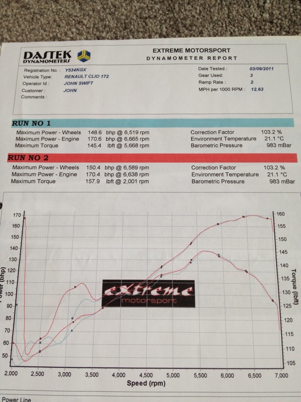

Well went along to the Boaby Tapp'd RR meet at Extreme in Whitburn today. We last went along as a CS meat last year and this is the graph from then
at that point we had just put the 182 manifold on and there wee a couple of teething issues, like a buggered lambda causing a large flat spot just before 4k and generally causing poor running.
Obviously replaced that since then and a wee bit of other tinkering and this was todays results.
Very happy with that, especially when you consider the only engine mods are an ITG panel filter, 182 manifold, decat and Yozza Stealth. I think its fair to say SWR have got the timing bang on!
And yes I know RR can pick numbers out of the sky but at least it was exactly the same rr and operator.
