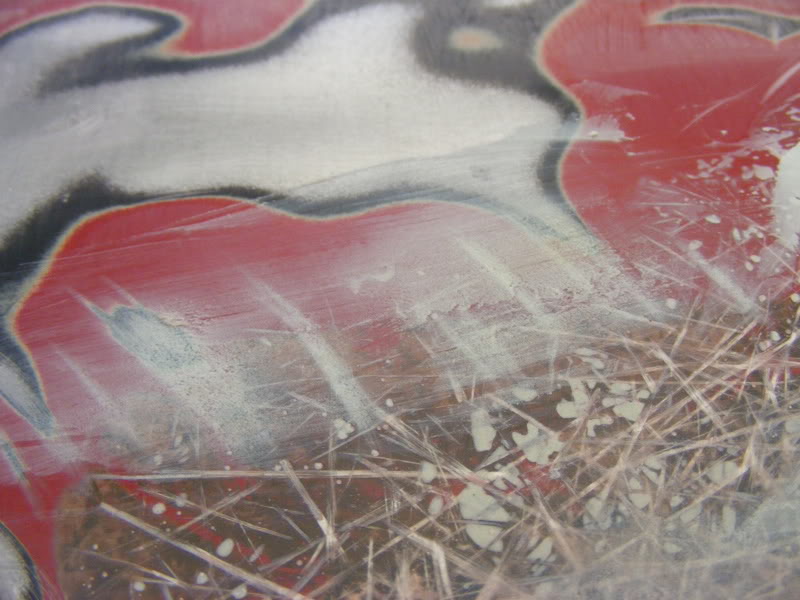

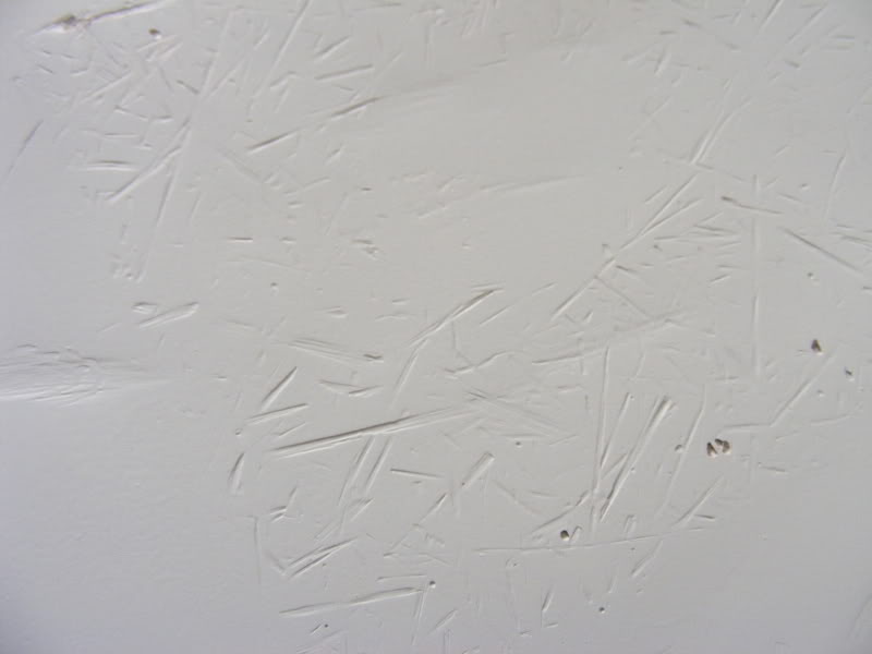

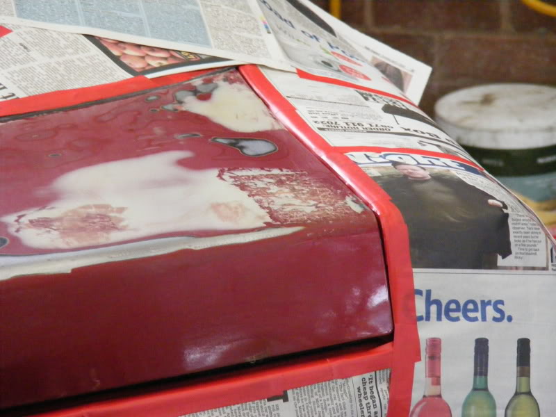

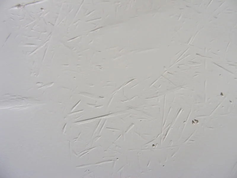

1st up, like I said I had fibreglassed the boot and it was quite raised from the boot, not really a surprise but the fact that I didnt smooth the fibreglass before adding filler made it an absolute pain in the arse to get right. I spent about an hour on 1 spot of fibreglass/filler to get it anywhere near smooth, which annoyed me... So given the spirit of my work so far I used powertools for help, namely a grinder. You laugh but it actually worked pretty well, aside from grinder marks in the boot skin now, see:

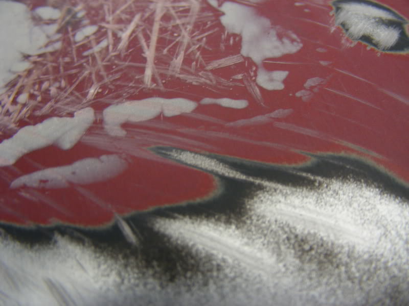

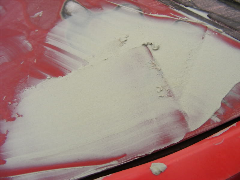

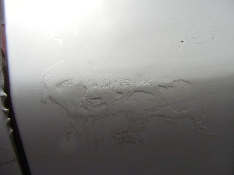

The grinder marks were a small price to pay given it took maybe 15 minutes to flat the boot down so all the patches were even and smooth to the boot. All this meant in terms of work was I had to smooth out the grinder marks, so I applied a very thin skim of filler and left it to harden, here are 2 of the worst spots:

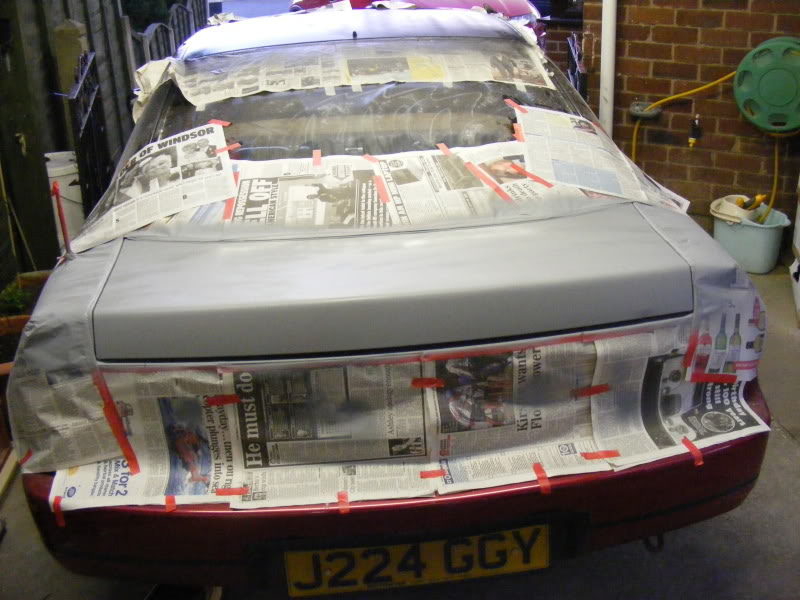

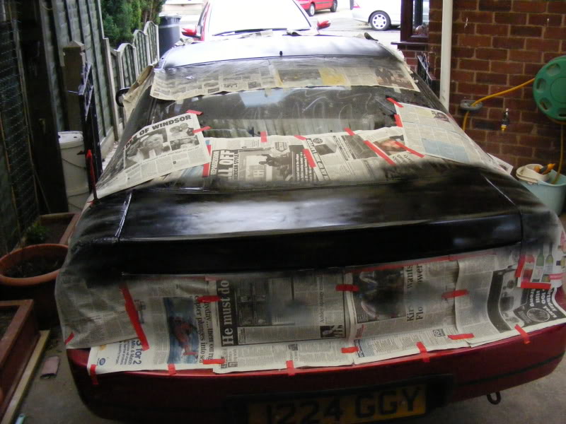

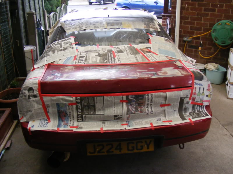

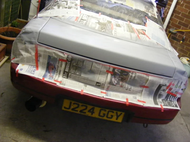

That was sundays work, so when I got back today I decided to crack on and I sanded it down smooth and masked off the boot ready for primer:

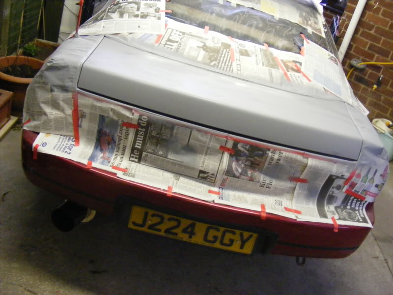

And 1st coat of primer on:

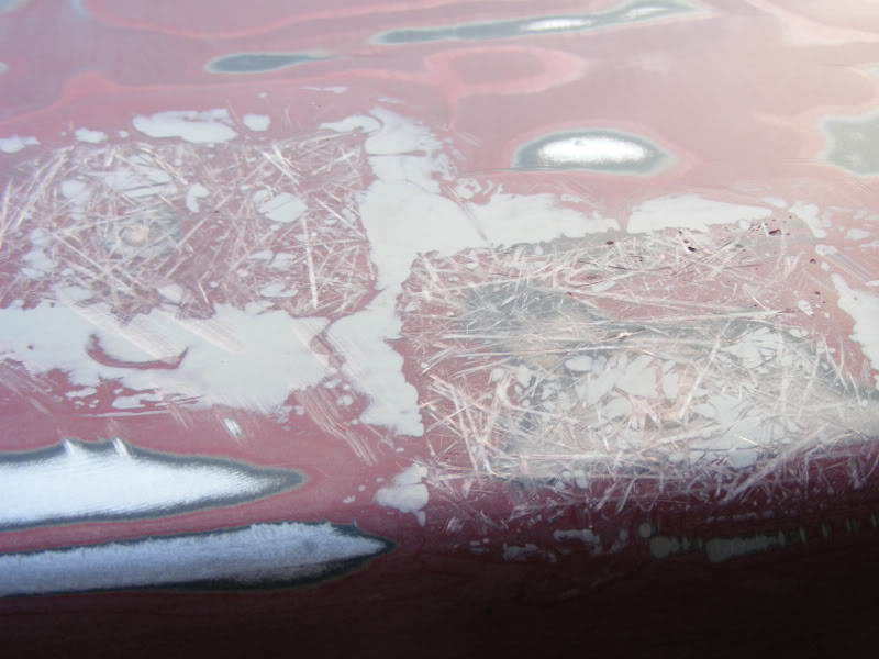

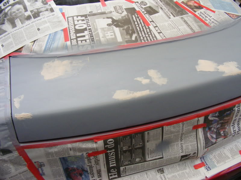

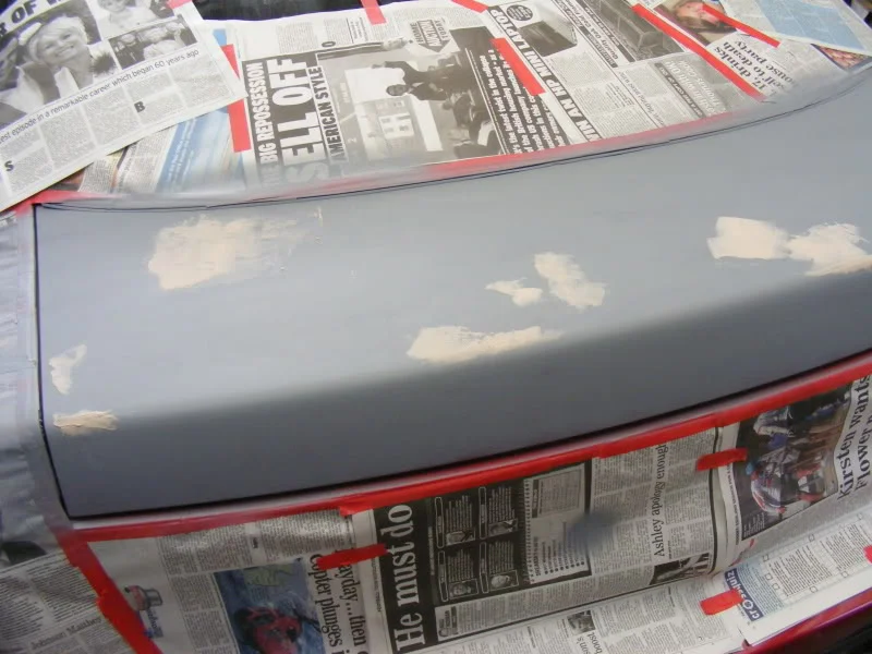

The primer mainly was to show any nasty points in my 'work' and it revealed a couple of bad points:

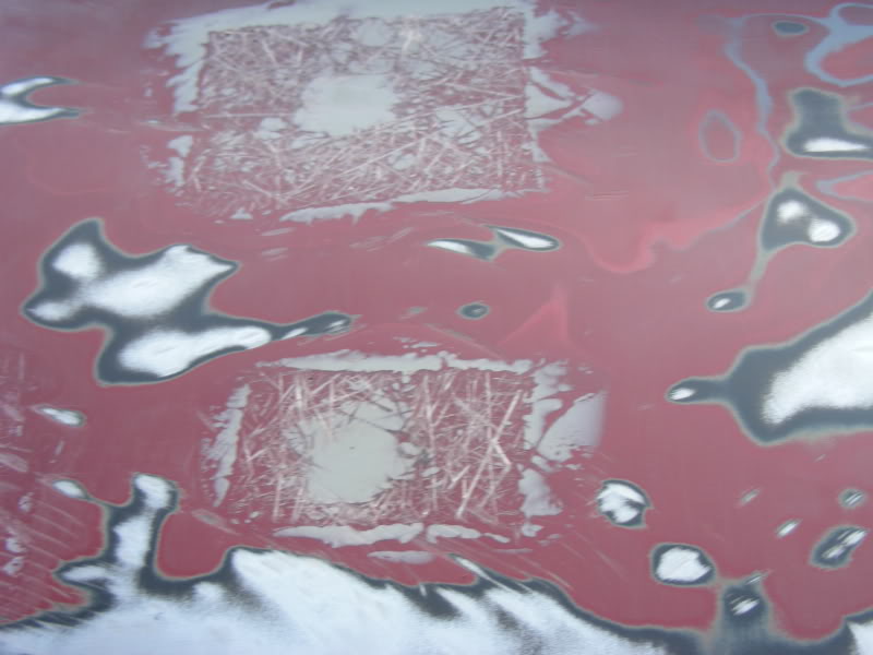

This wasn't a huge problem as my Dad had some finer filler and decided to cover the bad parts for me, so as it is now:
I'm going back out now to try and get it perfect, then hopefully the next coat of primer will sit right and then that should be it for the night.

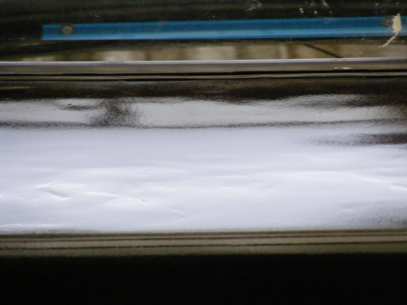

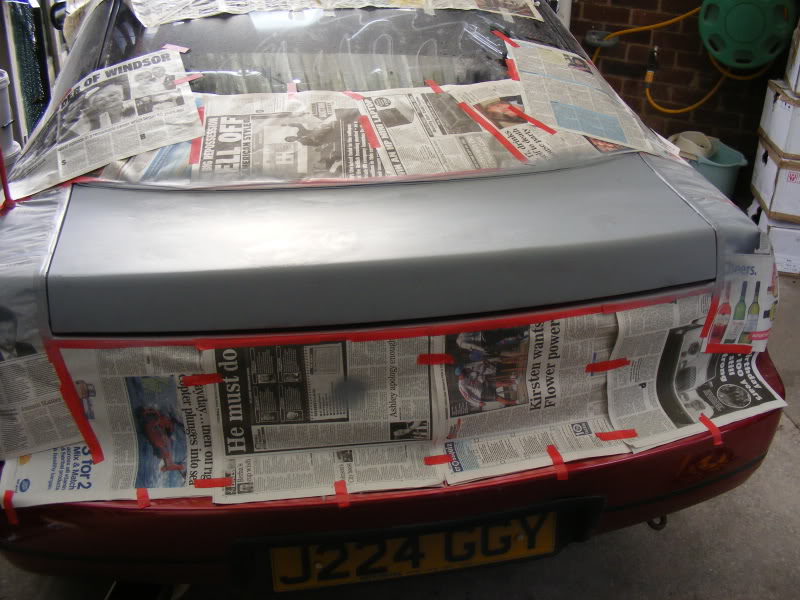

So I spent sometime sanding down the filler Dad put on yesterday to realise, the extra filler really wasn't necessary on a couple of bits... I got it down so it felt smooth to the body then got on smoothing it right down to 1200grit ready for another coat of primer. The primer went on and it looked perfect:

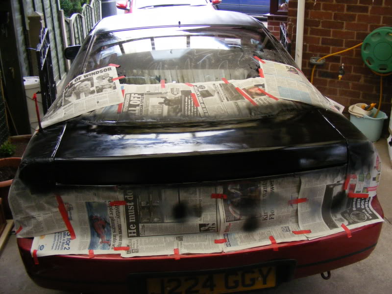

well, ok it looked flat and smooth and perfectly good for a DIY job by a complete novice lol. So that in mind I left the primer to dry over night last night and today I went over it with some 1500grit. To look at the primer was flat, you couldn't see where the patches had gone on and it was smooth to touch so on with the painting, the 1st coat and 2nd coat went on. The paint went on really nicely but it showed the patches pretty clearly :(
I figured its too late to change it now so I got on the final coat and then laquered it up. I have put on 4 coats of laquer and the paint itself looks pretty good, painting a boot is certainly easier than painting a set of TSW erm, Venoms, so now I'm wishing I had rattle can'd the rood. I'm gonna leave the laquer to harden properly for a day or 2 and then get a polish on it to see just how good it comes up. Ultimately I'm happy for my 1st attempt with it but I will be re-doing it when the weathers nice again and I have some money for more paint lol. I have a pretty good idea of what I need to do to get it perfect next time...

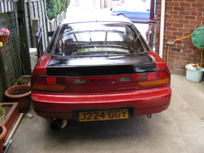

Anywho the 'finished' product:
