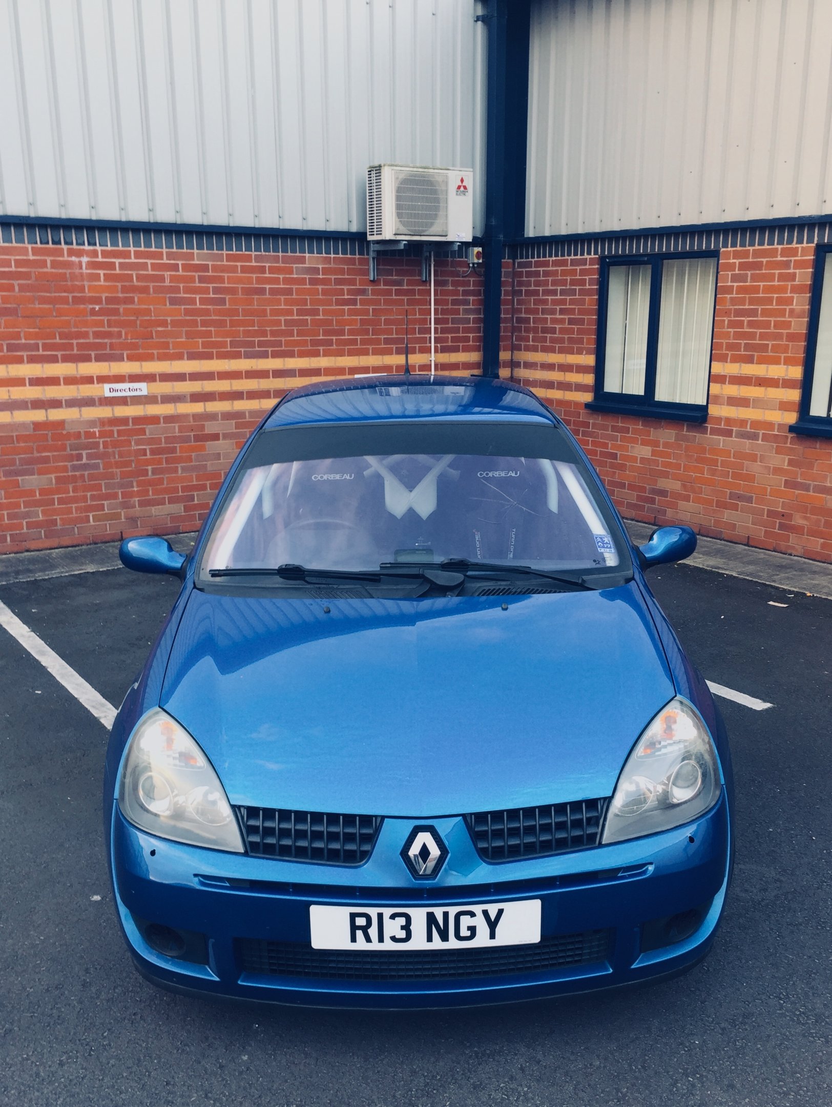

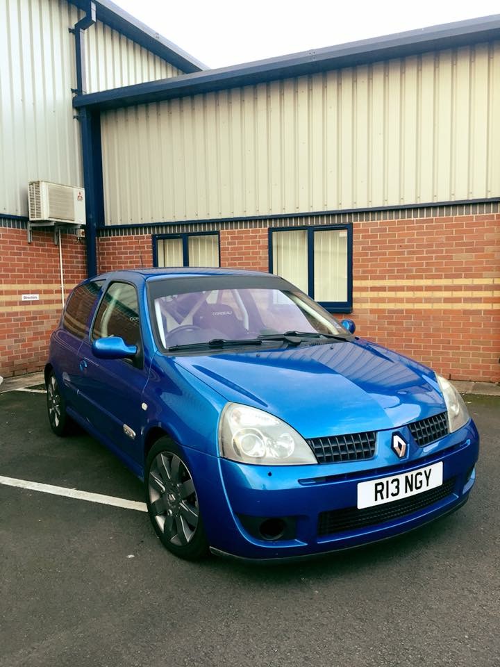

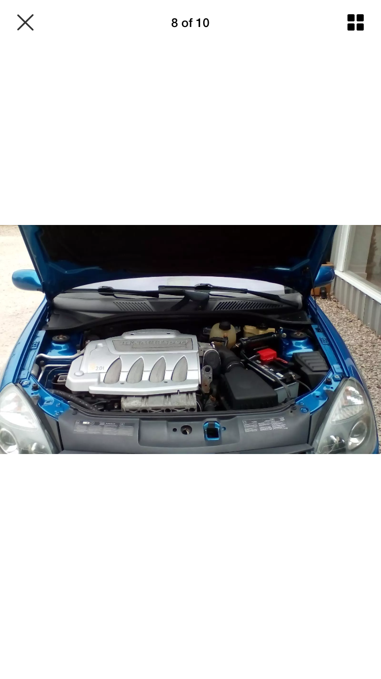

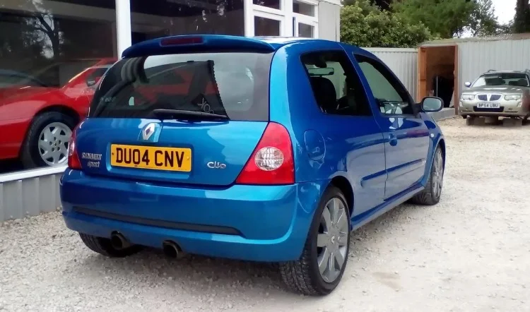

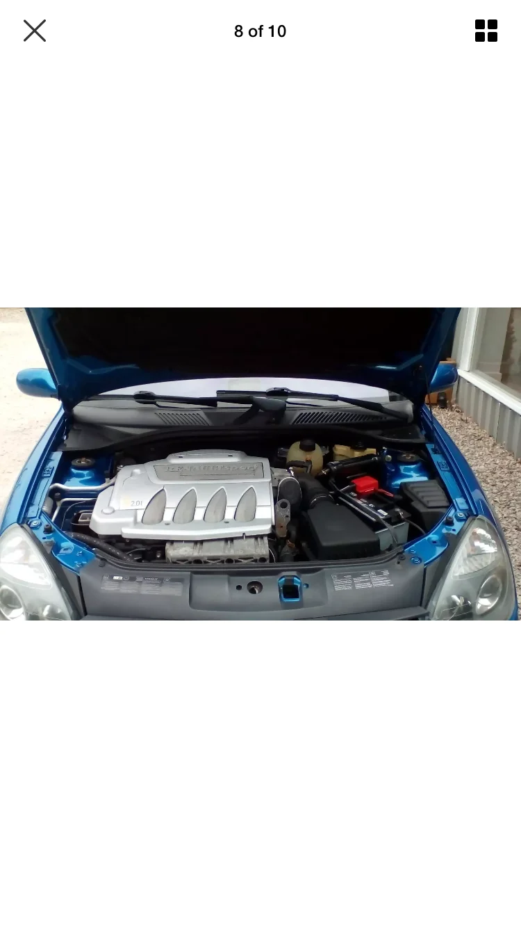

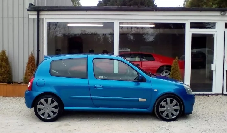

Picked this up last weekend, absoulutely love it.
89k with de phaser done (twice in its life)
Scorpion rs192 cat back with resonated centre
Brembo HC front discs
Eibach 35mm springs on the cup dampers
General plan is to give it a good service, engine, box oil, plugs and give it a check over.
Then fundays out, trackdays and ring trips.
Big plans for the car :yum:

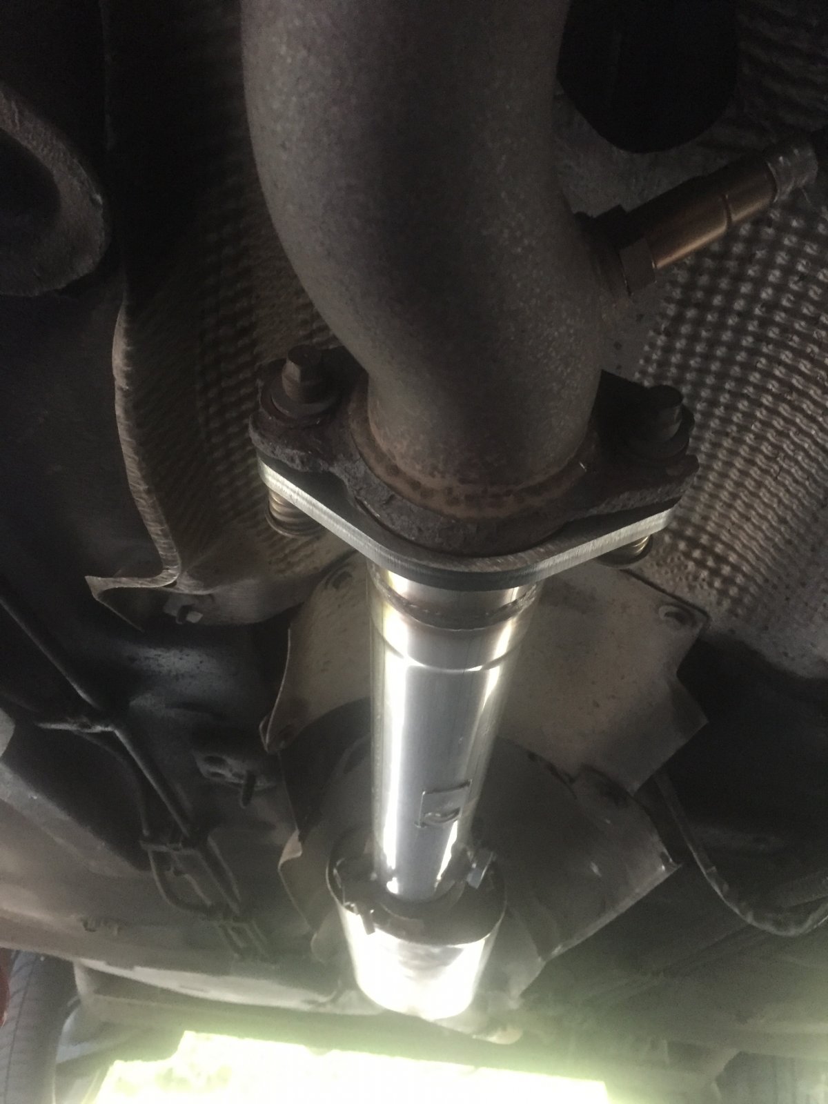

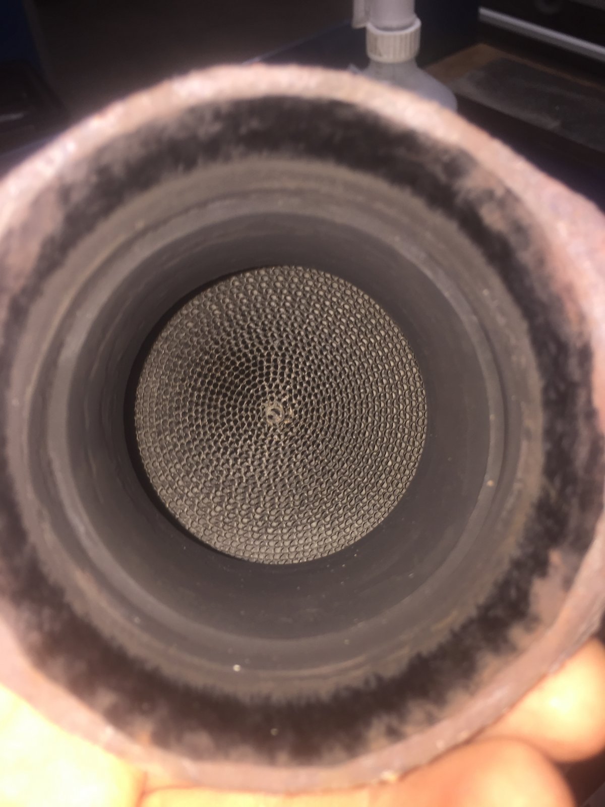

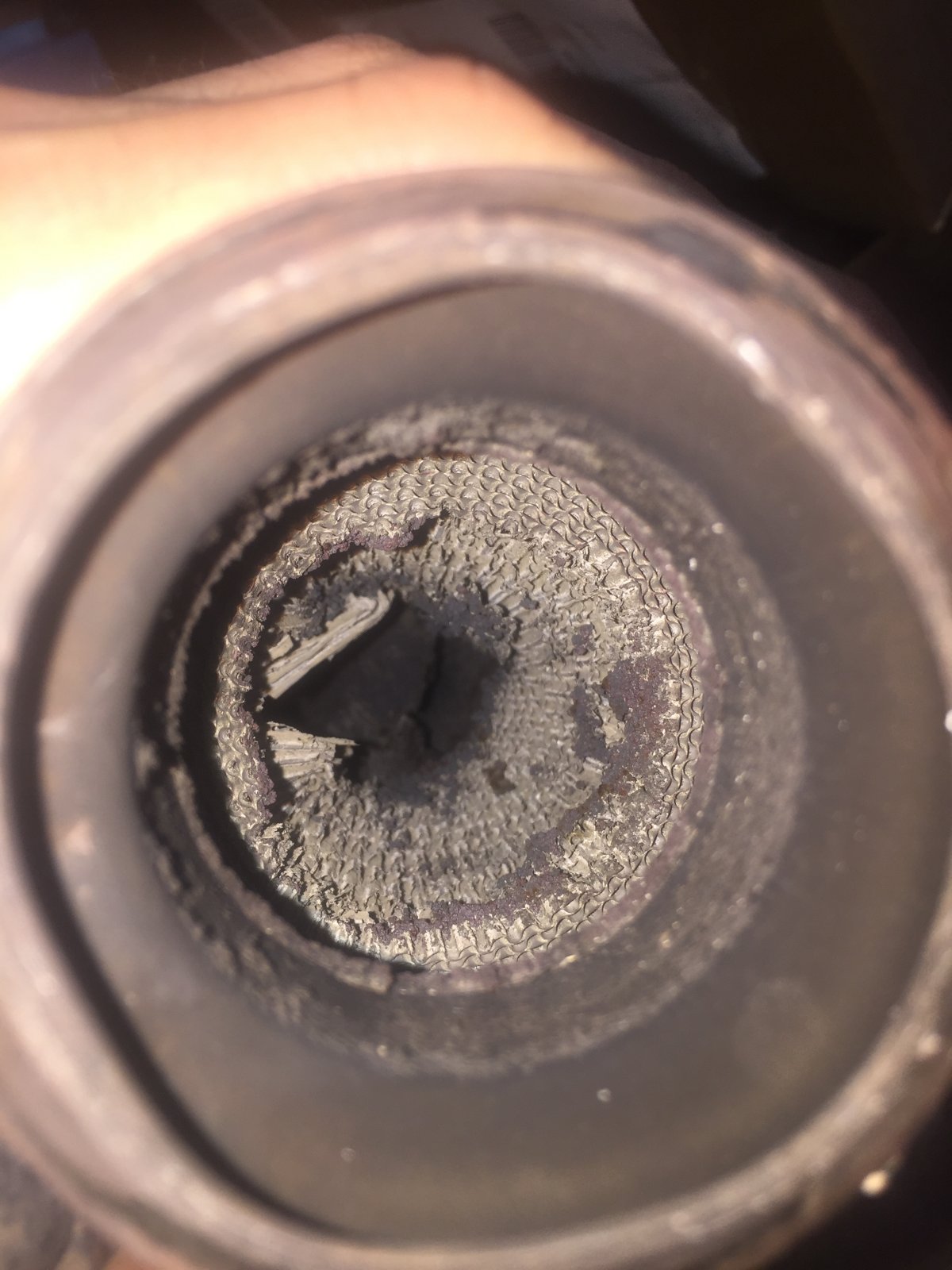

So, bit of an update, driving along minding my own business and the engine light pops up. I didnt have access to a fault code reader so was in the dark abit until i orderd a eml bluetooth reader which came up as pre cat lambda and speed sensor. When i took the cat off i was greeted with this. R.I.P Kitty
So ordered a decat as there was also a large crack around the olive joint.
While i was there i added a Evol "track" dogbone mount, very well put together and very easy to fit. Made a huge differance, there is a fair amount of added vibration which is to be expected but very much worth it
Scorpion Decat and new lambda
Didnt bother vlogging as, well its hardly exciting.
The exhaust is blowing slightly but all back together and the speed sensor hasnt come back on yet...so we shall see.

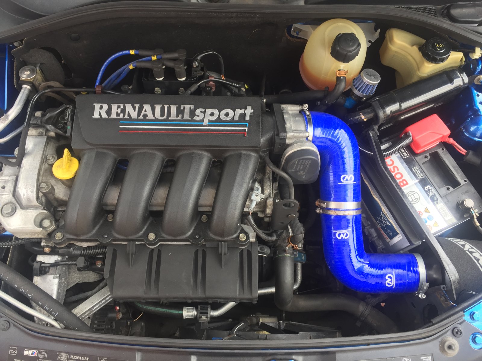

So, I finally sorted the Gopro out, filmed the fitting of the Fatty styled silicone induction setup, and it deleted the file...so im giving up on the vlogs, back to typing.
So Friday after work I set about getting the new induction kit on, really happy with it, sounds AWESOME, amazing how putting a cone on the end of the OEM pipe hardly made any difference to induction noise but adding abit of length makes it sound like it does.
forgot to order new jubilee clips so have a miss match set on, will replace at some point.

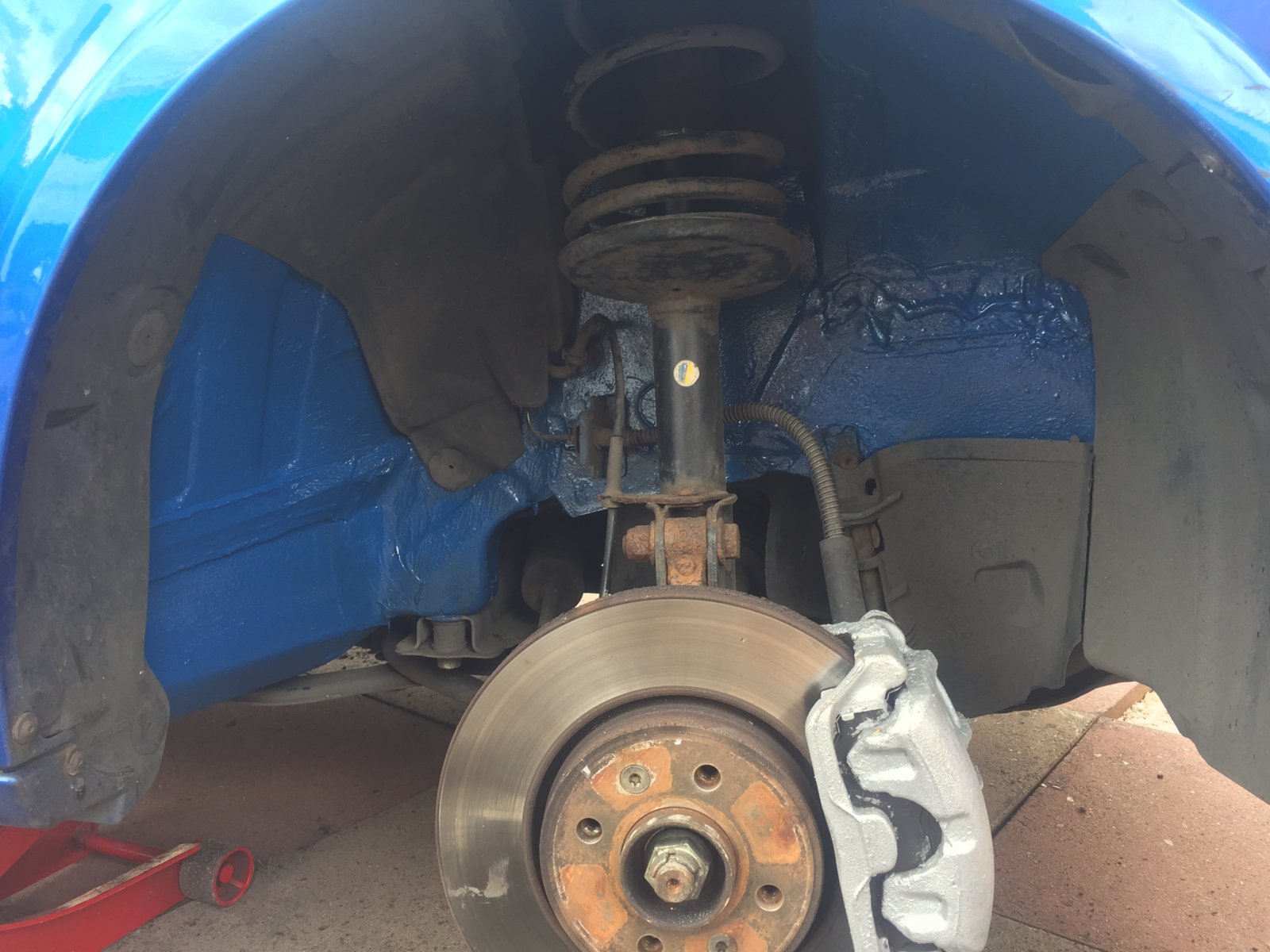

I had afree sunday so thought id get the wheels off and give them a good clean along with the archliners out to get all the muck out from behind, glad I did.
Gave the arches a good clean and a lick of paint, decided while I was there I may aswell give the calipers a quick coat, unfortunately I only had 1 other paint brush and it was huge, so not the best job but cleaner than before.

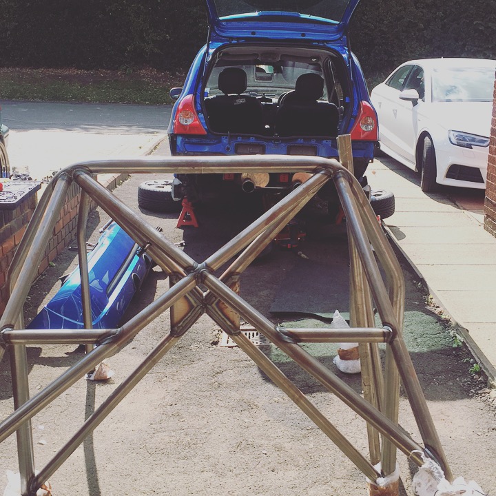

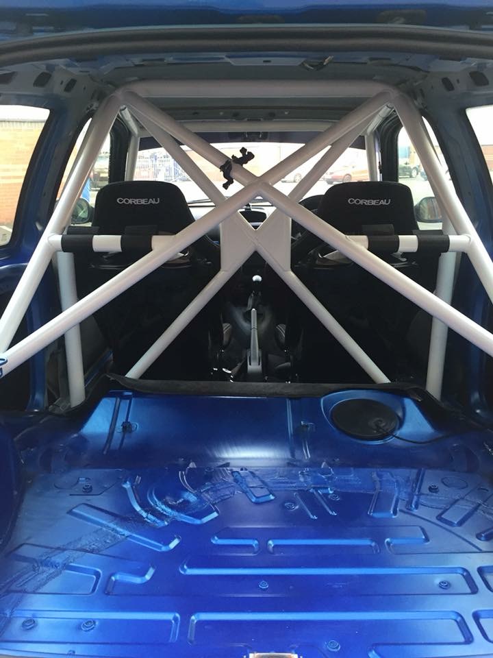

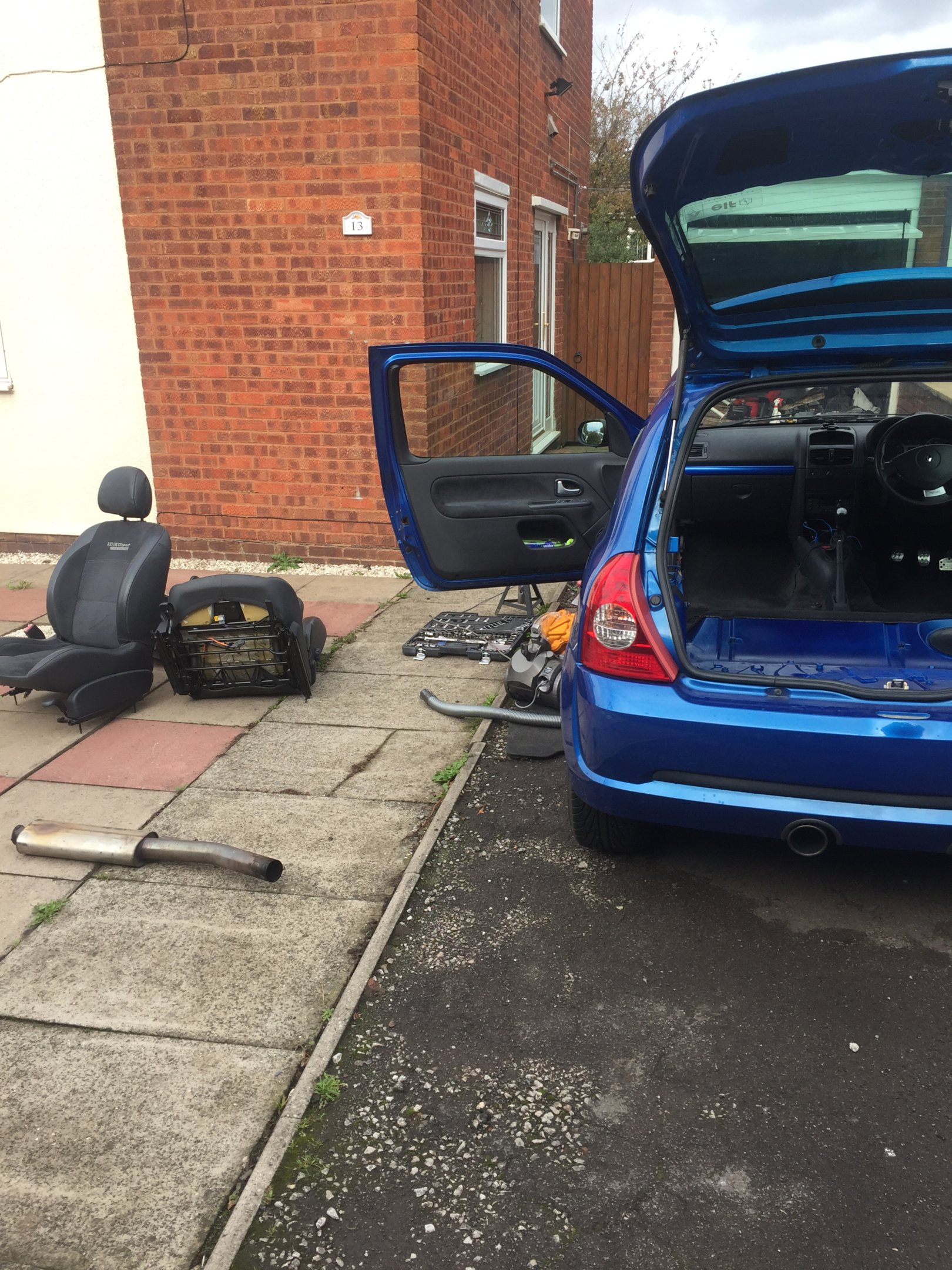

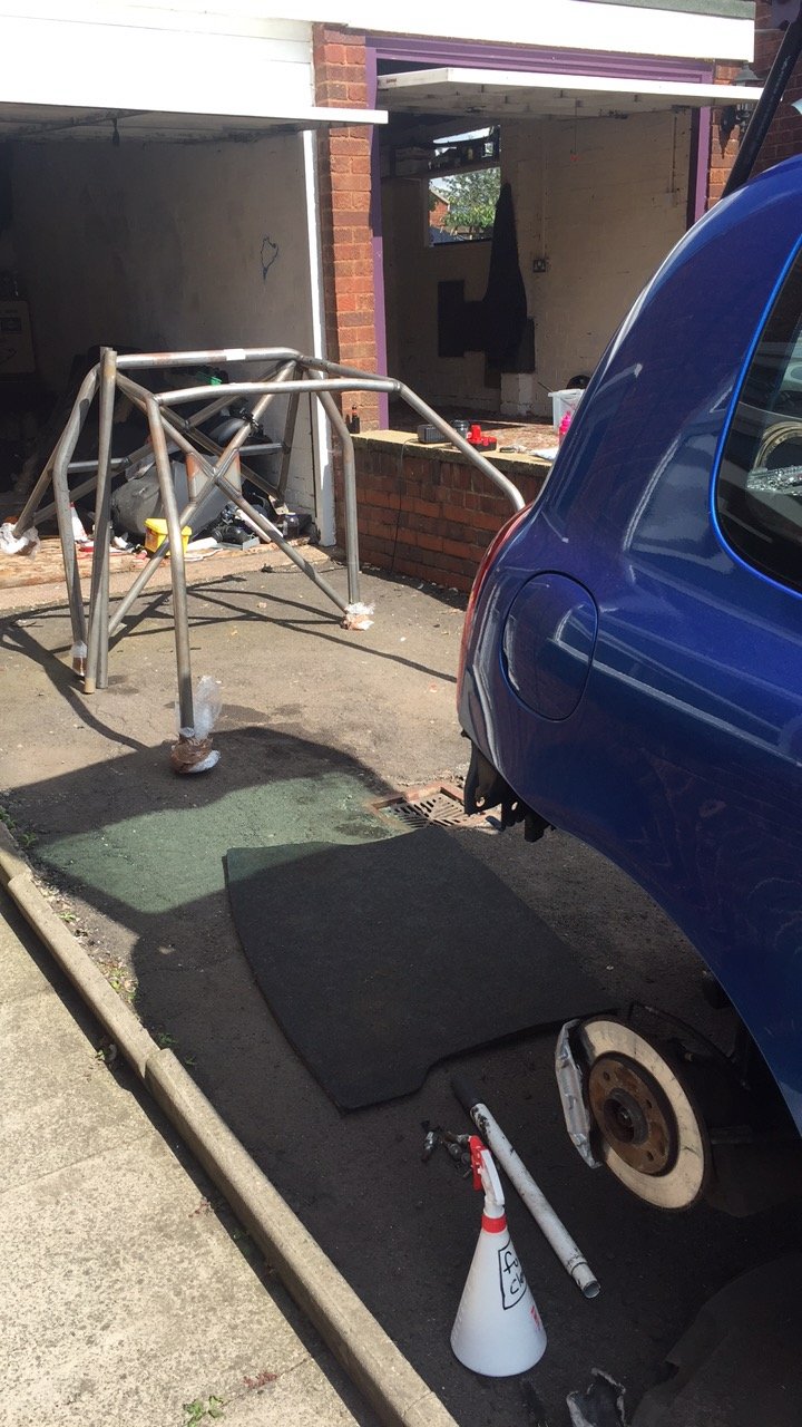

So, had abit of an impulse buy, Sassa 6point bolt in cage.
Rear halfs painted now, will be painting the front over the weekend and getting it in and modifying the dash which im dreading incase i make a hack job of it :hushed:
Also got some clio cup racer door cards of CMComposites (still unsure how to mount these best, suggestions?) and PBS front and rear pads waiting to go on, need to buy some brembo HC fronts and oem rears when i get paid this month. Purchased a lonely mans brake bleeder kit today (gunsons easy bleed, the one that attaches to a spare tyres and pressurises the brake system)
Seats will be next. Been told iv been a good boy and ill be getting a steering wheel for Christmas so thats another thing ticked off the list to :innocent:
Had a happy helper pitch in the clean it the other day to (golfs my next door neighbours that wev been doing a full strip down and rebuild on over the last year, new engine should run 440-450bhp if all does well, full cage, recaro pole positions,CAE shifter, pedal box...lots of sexy bits)
Looking good.
Liking the progress mate. Coming along nicely.
Thanks guys, cage isnt bolted in yet, (yes its a bolt in:sweatsmile:) the front (A pillar) feet seem to sit ok the rear stays sit okay but the B pillar feet are about 14mm off the floor, the distributor i brought it off assures me it should sit flat on the floor but i cant see how. Currently mocking up brackets to mount the fusebox and UCH. Ideally need the car back on the road before Saturday so need to get it sorted. Harnesses and seats on order. Already got foz seat subframes so just waiting for delivery....and to figure this cage out:sweat:

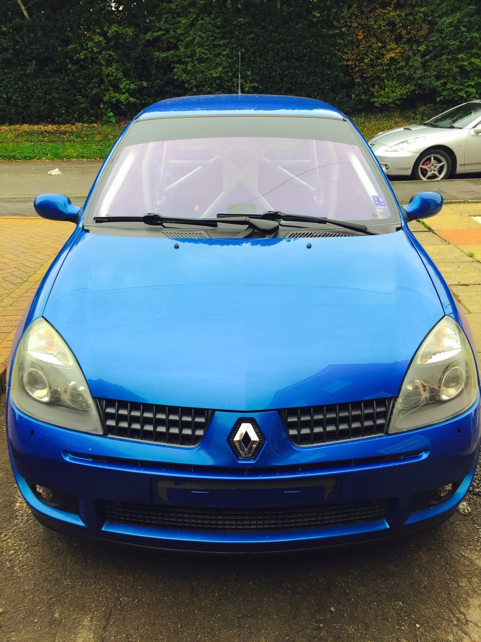

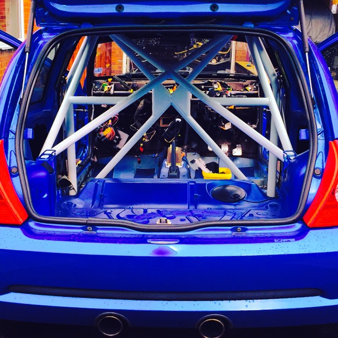

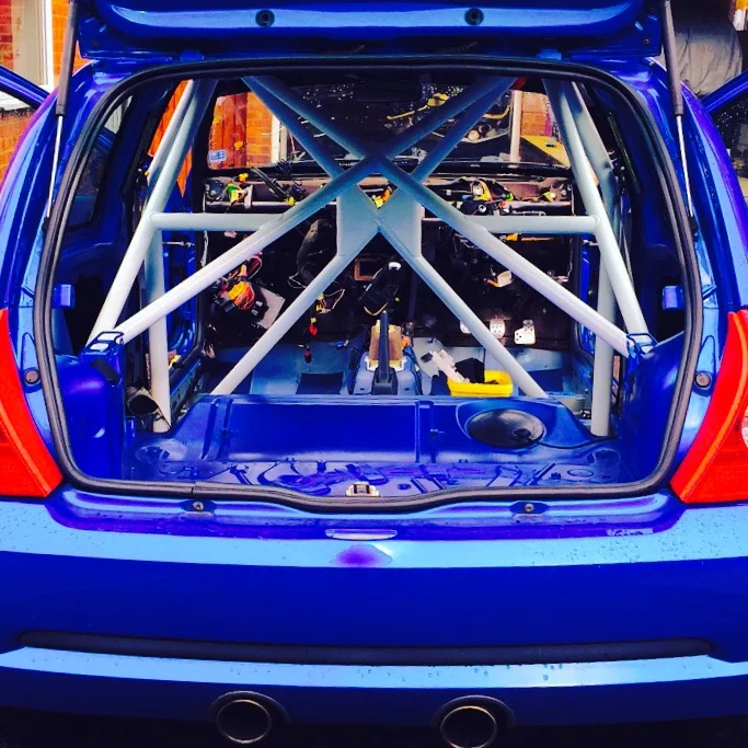

So, Clio’s just had its first voyage caged up.
Seat delivery time had put a major stall on getting it all finnished. Will try and get some decent pics tomoz and try to write somthing interesting
So, ill start from the beginning.

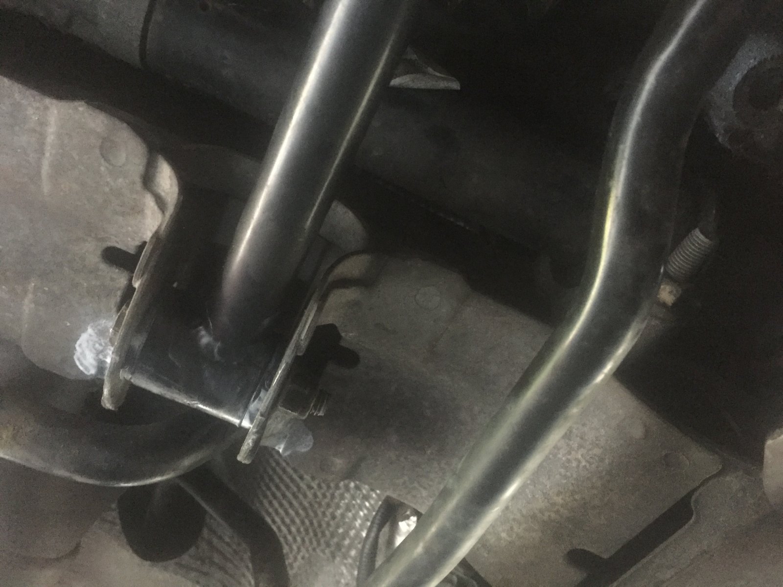

I had bee toying with what cage to buy, full, half, different brands. I had pretty much decided id have a half cage with harness bar. well as you can see that decision didn't last long. Seen the cage advertised on facebook by the distributor and for the price it was being sold at I had to have it.
Just a warning for anyone who may buy one in the future, I was told that it would fit in with full interior plastics in the front and with headlining etc (it was coming out anyway so didn't matter to me) but there is NOW WAY in hell it would fit with it. clearance/tolerance is very tight and was an arse to fit frankly.
whilst I was getting the cage painted and car ready to install the cage on the nights after work,

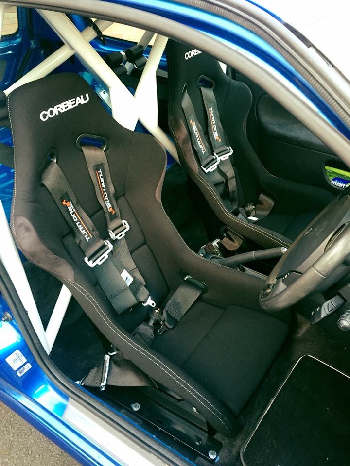

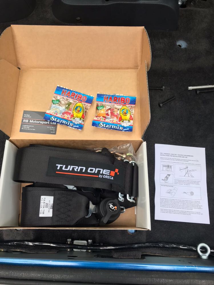

I ordered a pair of TurnOne (Oreca) 4 point harnesses which iv had my eye on for a while. I managed to find them (and a lot of other bits) cheaper through RB Motorsport. iv added his business card in the pic below, he deals with everything from seats, wheels, HANS, helmets, race suits, they are at a very good price and hes a nice bloke to deal with....plus he sent me haribo
Ordered my seats which were a nightmare as they was sent out with a courier service and the seller went on holiday, the courier service was 8 days late and I had no tracking number/info or even which courier service was being used. panic over, they got delivered eventually.
Had abit of a head scratch moment with UCH and fusebox, Thankfully after a convocation with @Ads29 and @Tomotek about how they have done theirs I had a game plan so thanks again guys.
I was going to only run the top dash and no carpet but with the long journey to the Ring' in June I decided to wimp out and refit it 😅
All in all im happy with how its turned out, iv currently got ABS, ESP, Airbag and Serv light on my dash, Iv used 3.3Ohm resistors for the airbags but still on, so if anyone has CLIP or can Re-prog my Airbag ecu give me a shout.
Next is to get my doorcards on and fit the new discs and pads (PBS pads)

Clubsport seats-Done
rails -Done
harnesses-Done
full cage -Done

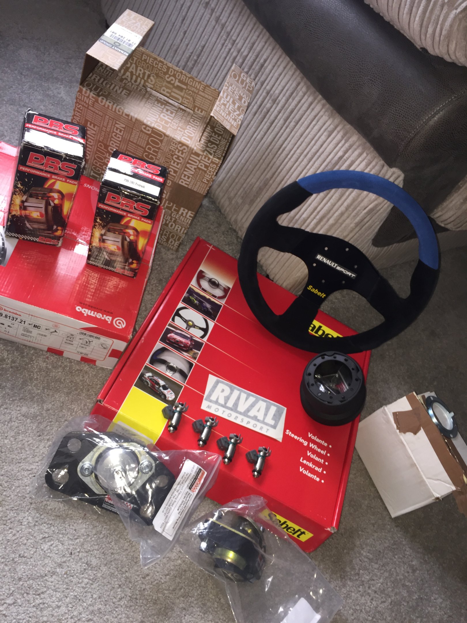

Sooo the Clio has some Christmas presents. The Mrs brought me a sabelt wheel and i treated myself...i mean the clio to some new bits. Had mega running issues which I believe to be down to an injector so orderd 4 new. New vibratechnics mounts, correct boss with tabs for steering wheel, brembo HC’s, OEM rears and PBS pads front and back. Im off to go fit injectors now in the snow. :tired::up:
Spent some brass there mate :smile:
Tell me about it :smile: think owning this since june iv spent the most iv ever spent on a car in such a short time, service, cage, seats, mounts, all the recent goodies. Still genuinely in love with the lil clio though.
Injectors fitted and flashing engine light, pop pop bangs have all gone so hopefully plain sailing now for a month or 2.

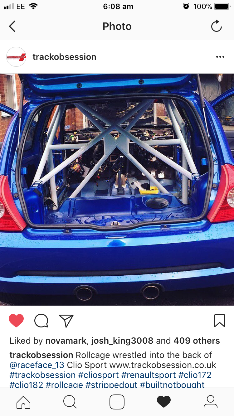

Just looking back now at the cage, how the f**k did you get it in with it all welded together 😂
Must have been a right puzzle?
It was a proper nightmare But it does split just before the B pillar.
We ended up cracking my window screen (can just make it out in the pics above) and putting a gouge in the top of my dash just above the clocks.
it was a proper tight fit but I won :smile:

Since last update iv fitted the
Sabelt wheel
MOMO boss
PBS pads and brembo/OEM discs
4x injectors
Ordered braided lines and superblue fluid (not fitted yet)

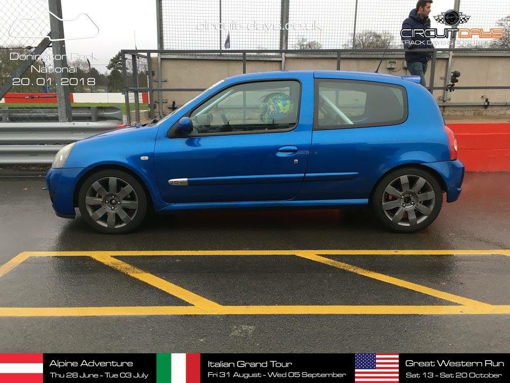

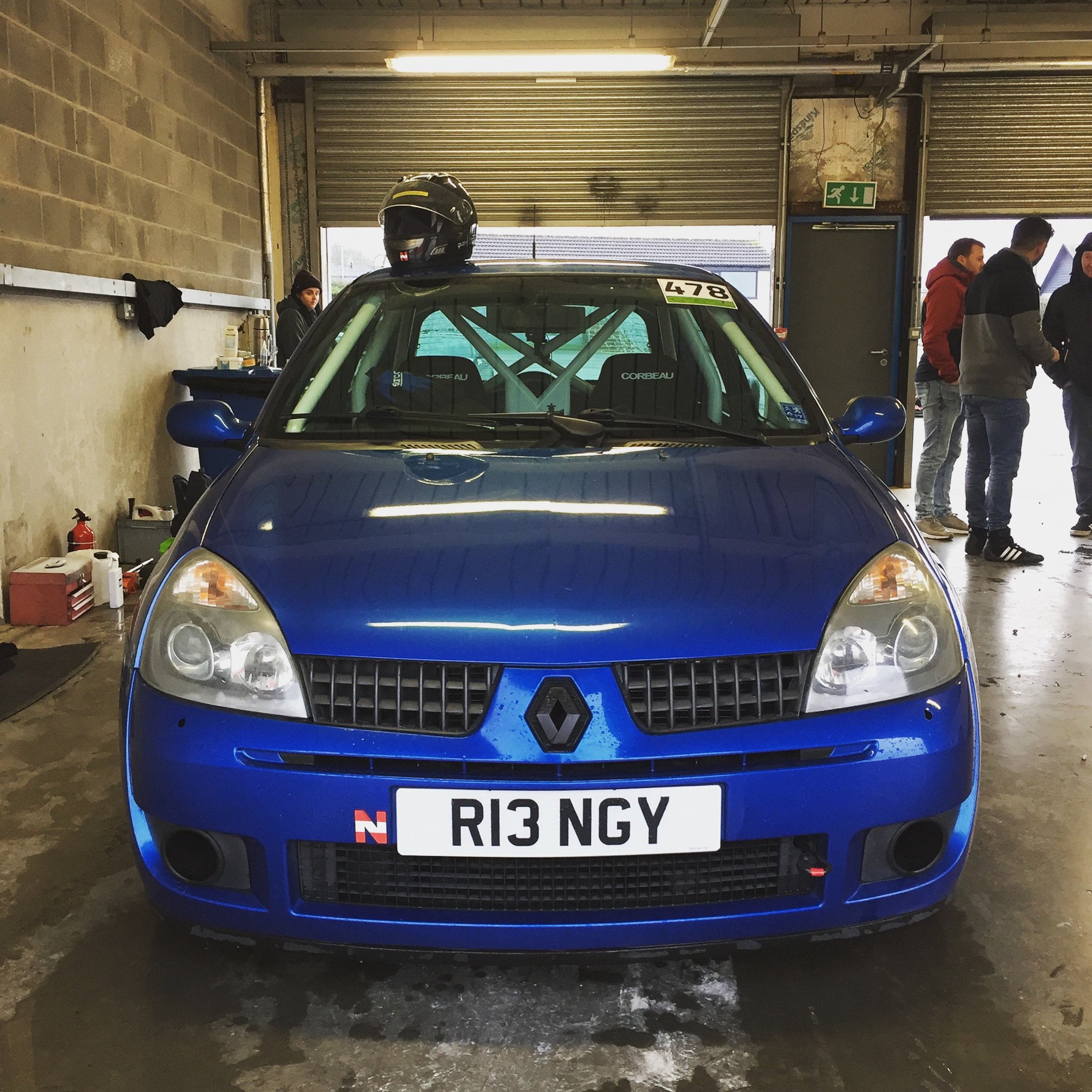

I booked on with Circuit days for Donington 20/1/18 Praying to any god that would listen that it be dry...I must have been doing it wrong as it belted down all day.
I wanted to use the day as a base to start from. I tend to go all out with parts and then do a trackday, but I wanted to see what it was like from a start point. obviously it has a cage and buckets but it is on Very non trackday tyres, standard geo/old cup suspension and bushings and as I didn't get time old brake fluid and lines.
This was my first track day in the Clio, First at Donny, first TD (other than the ring) in 3 years and First Wet track day.
Needless to say I was very nervous, I did have a cracking time though and itching to do more as I feel iv gotten very sloppy, although the rain and Some of the other drivers didn't fill me with confidence if im honest. overtaking on the left on a straight didn't seem to apply to some.
What I took away from the day was I need lots more seats time/tuition, change brake fluid and get some better tyres (which I already knew)
Felt I learnt a lot about how the car acts in certain situations better due to the rain and poor tyres though.
I have got some footage but Gopro's seem to hate me and either don't record, only record for 5ish mins or die.
Ill post the vid up once iv pieced it together.
All in all, Cracking day, roll on the next.

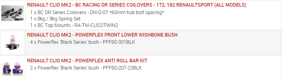

Also done a lot of buying recently, got BC DR 8/8kg coilovers with solid top mounts and a Tessa Motorsport (SM) inlet, along with various polybushes
