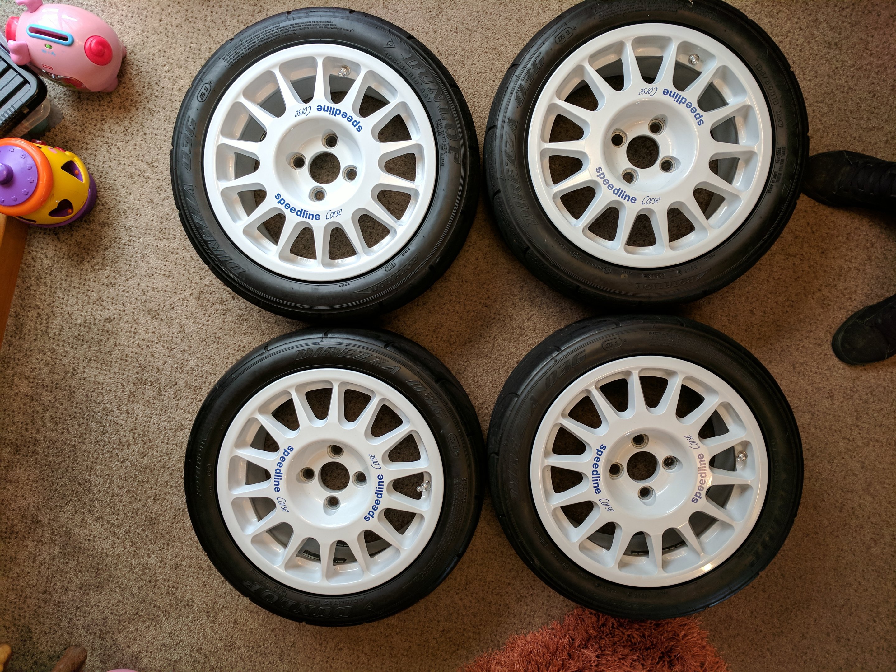

for a weight insight see below for my wheels, well some of them anyway:
1: 15" Speedline Maracanã, Nankang NS2-R Tyres (195/50 R15) - 17.3Kg
2: 15" Speedline Williams, Toyo R888 Tyres (205/50 R15) - 15.8kg
3: 15" OZ Superleggera, Michelin Slicks (205/50 ish equivalent) - 11.3Kg
major savings to be had! yet to weight the 675 with AD08r's and the 2118's with R888r's or the F1 and Williams sets with PS3's :-)

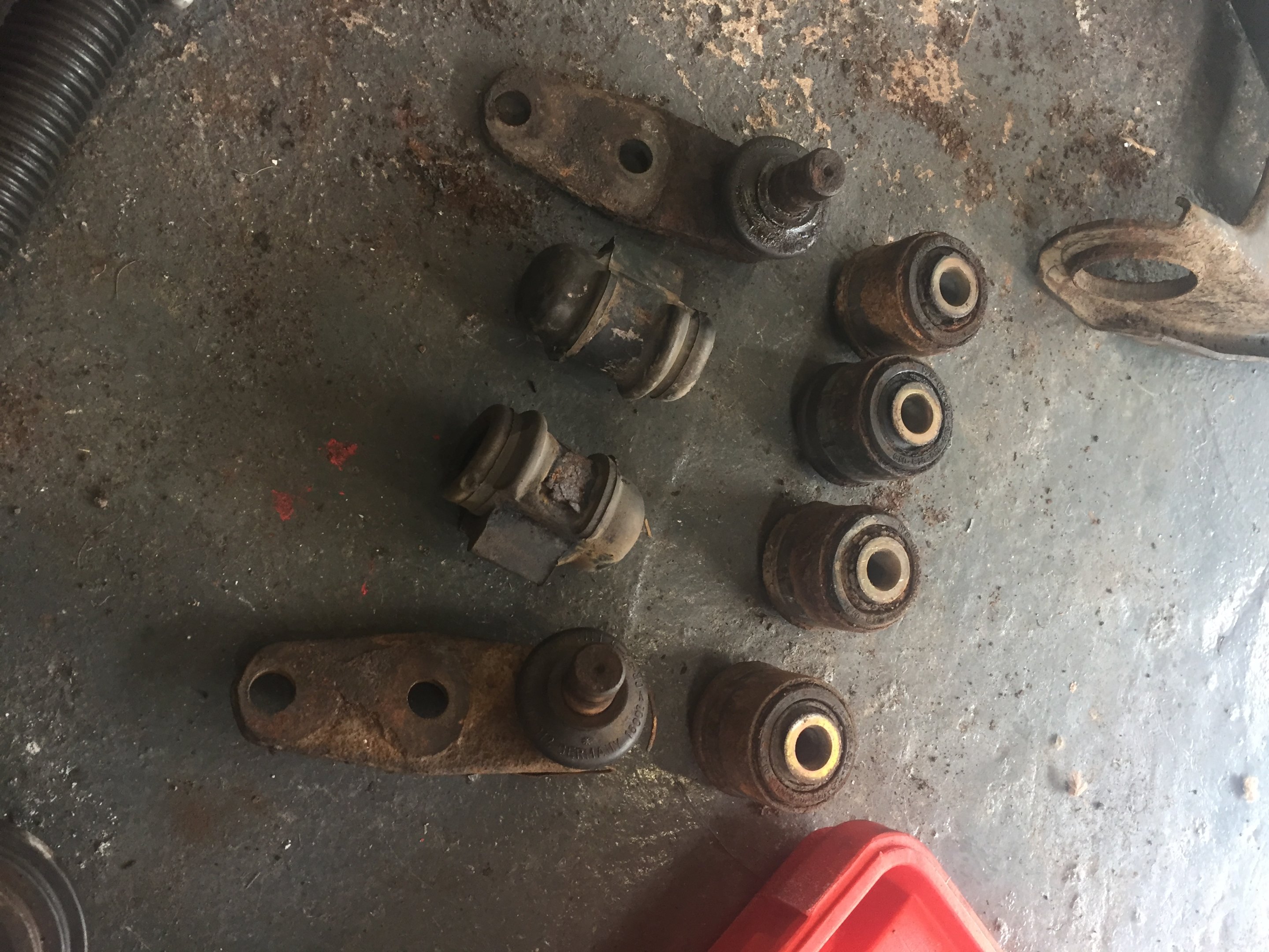

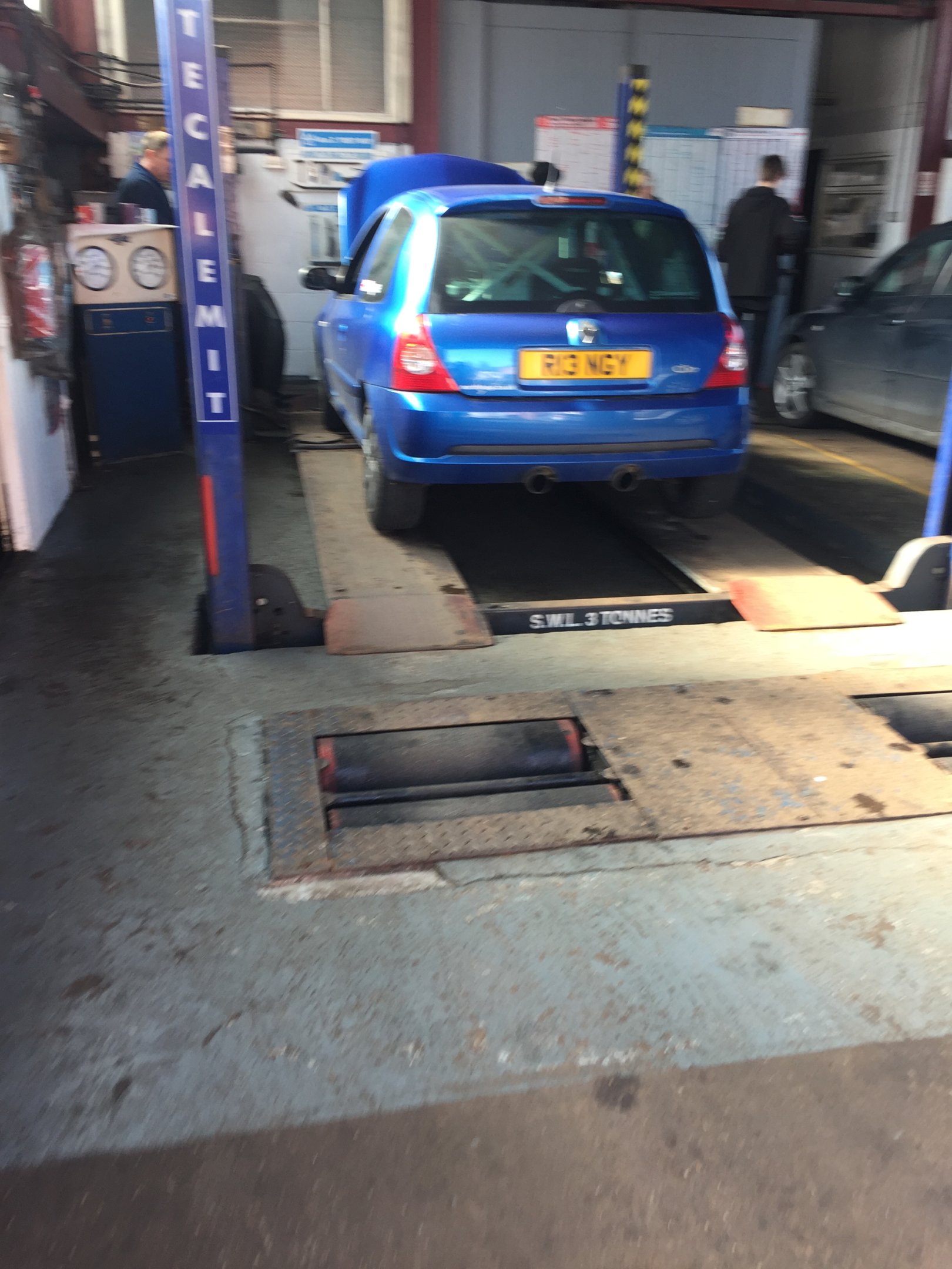

Clio got MOT’d last saturday without any issues, i did notice that the inner and outer Arb bushes have some signs of wear, i already have some powerflex black series outers and lower arm bushes so just need to get some inners and set at it.
Que aweful picture

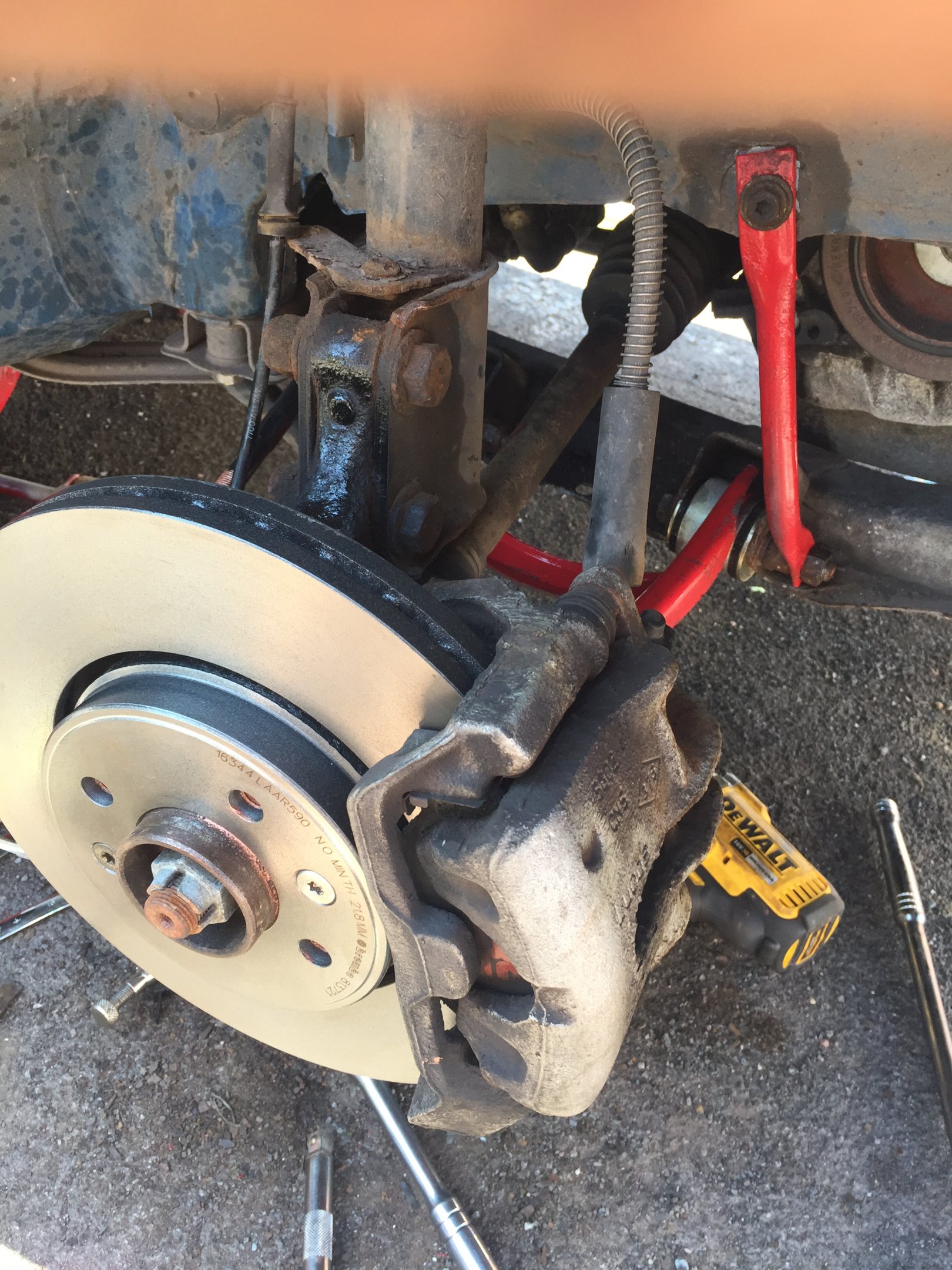

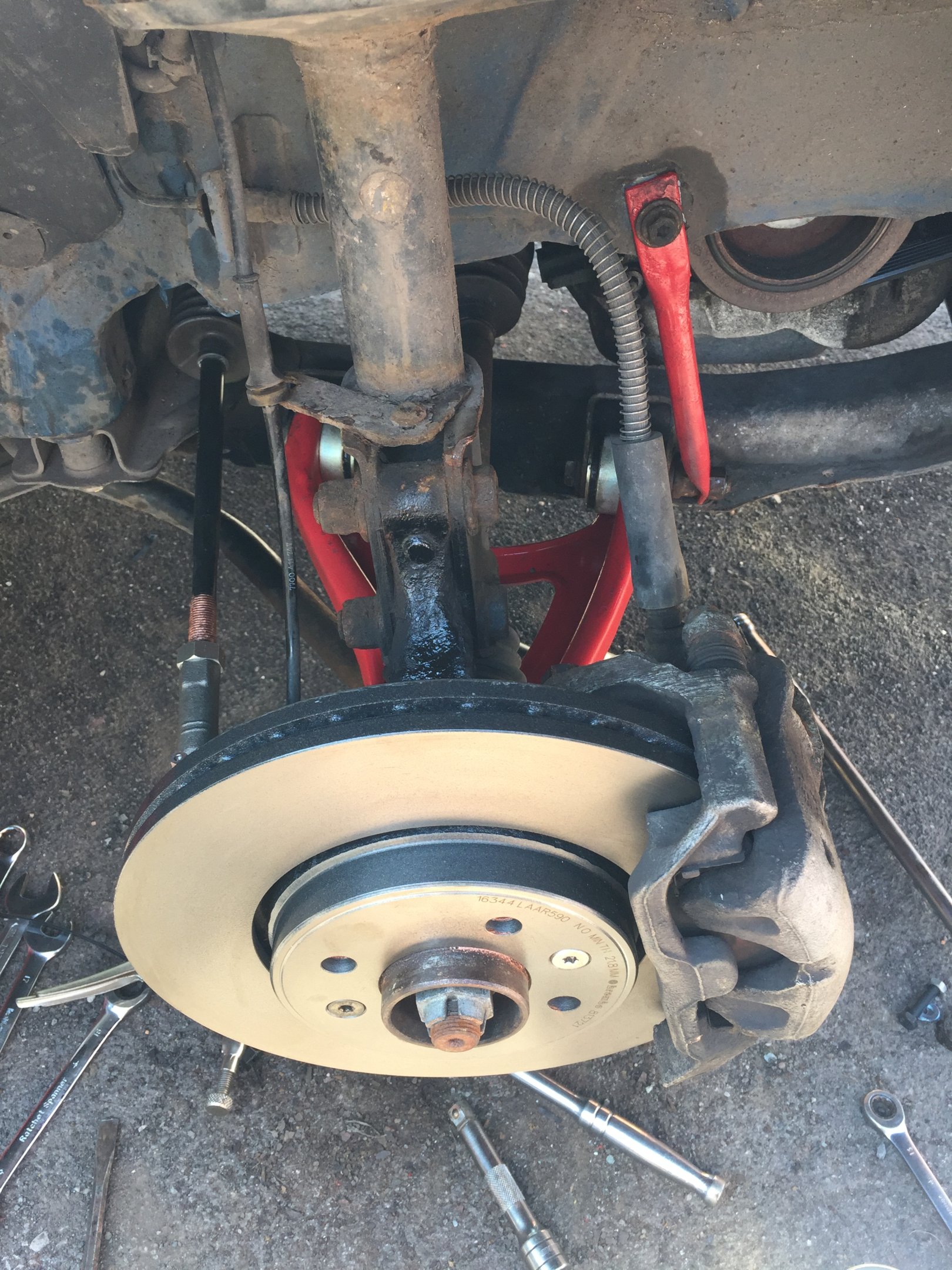

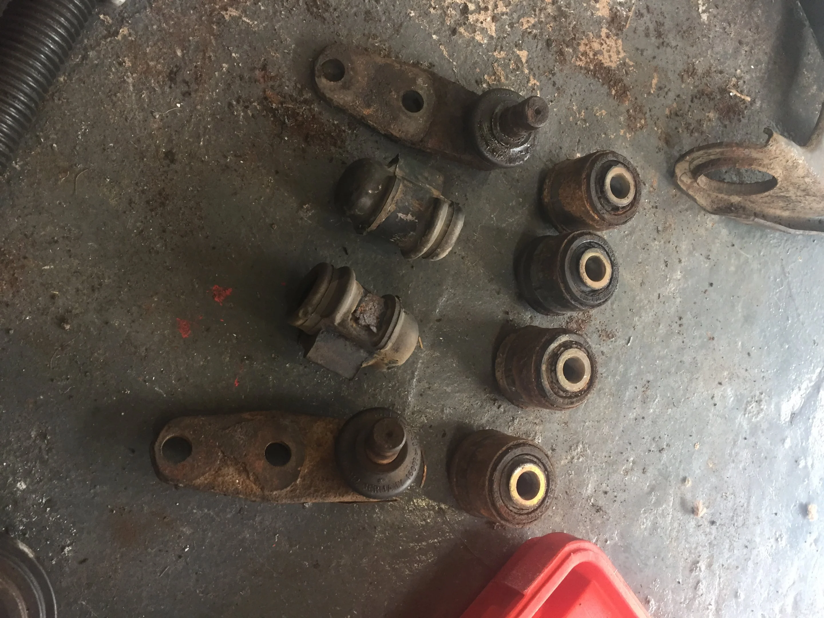

First job was to get these buggers out and replaced with powerflex black series arm and outter arb bushes and aftermarket balljoints.
Also changed front discs for some brembo’s and replaced track rod ends inner tie rods and gave the arms a lick of paint...only had red so race car ?

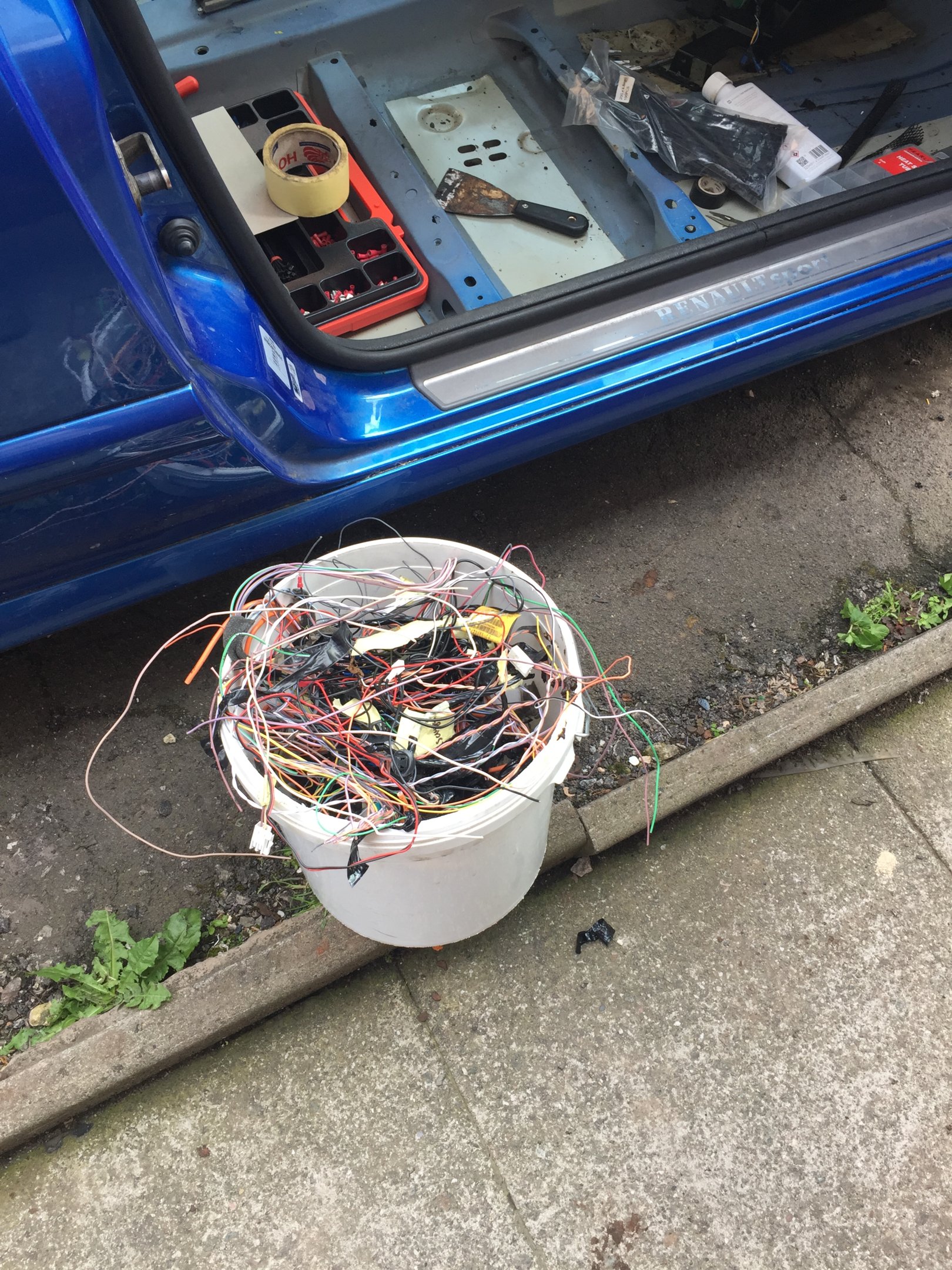

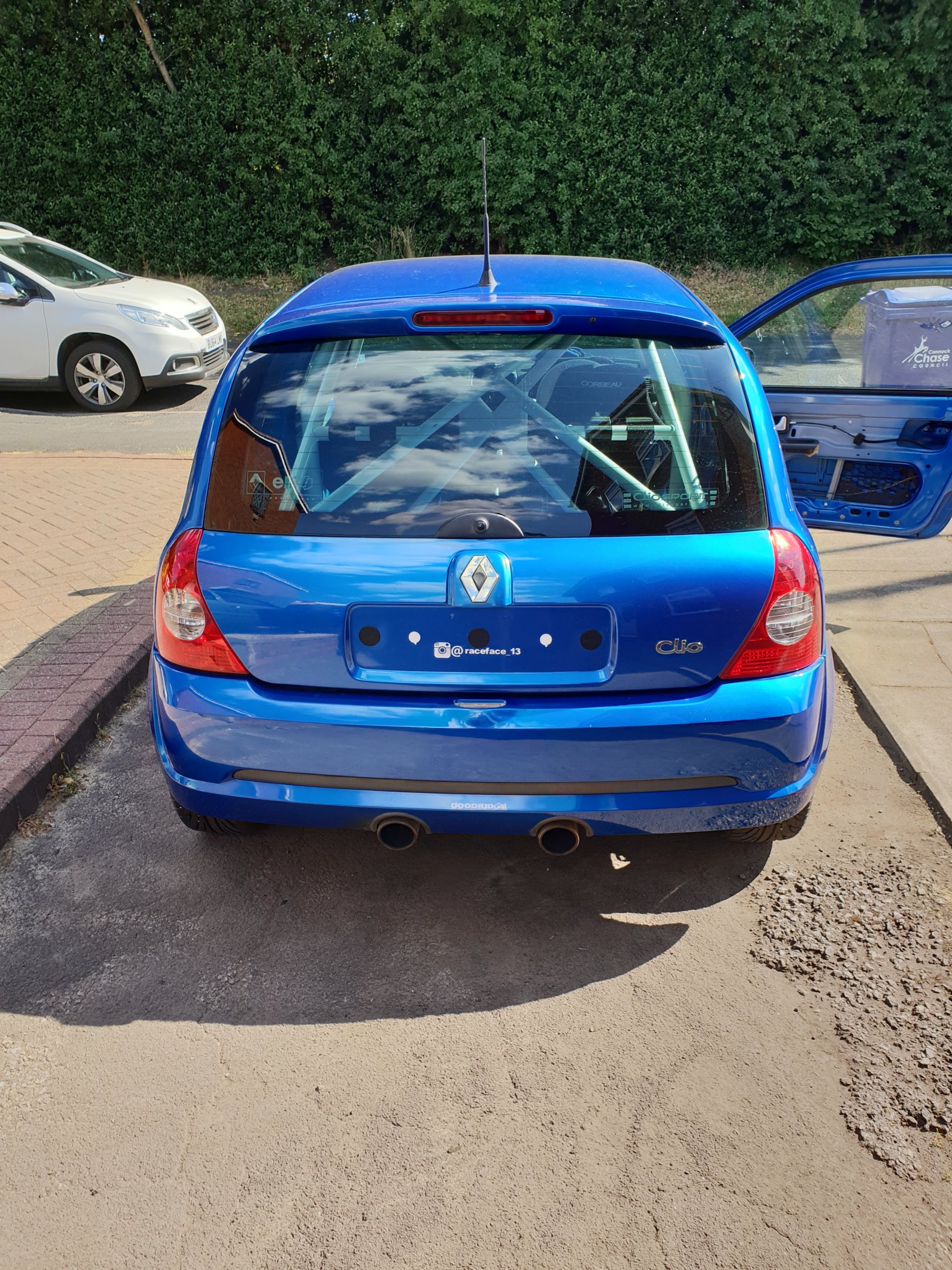

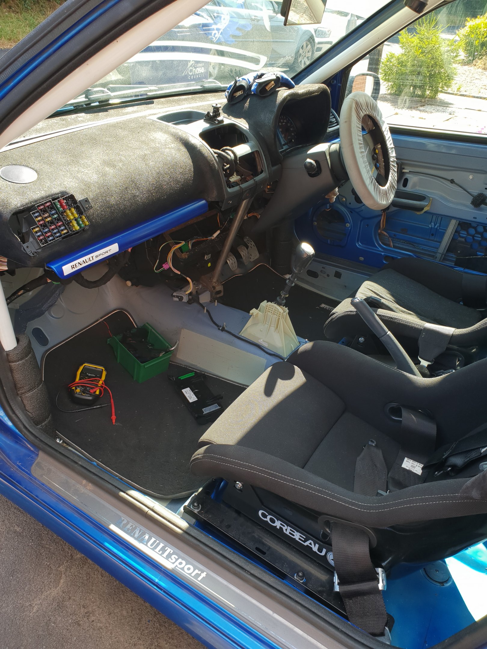

Not very good at keeping this updated. Had a good day on the Clio today. Got it all back together and feeling abit more positive about it after having afew weeks of having no love or motivation.
Got half dash now, all sound deadening gone (bar some firewall foam crap)
Re fitted rollcage as i wasnt happy with the bolts. Chopped hella unused wires out (still runs thank god)

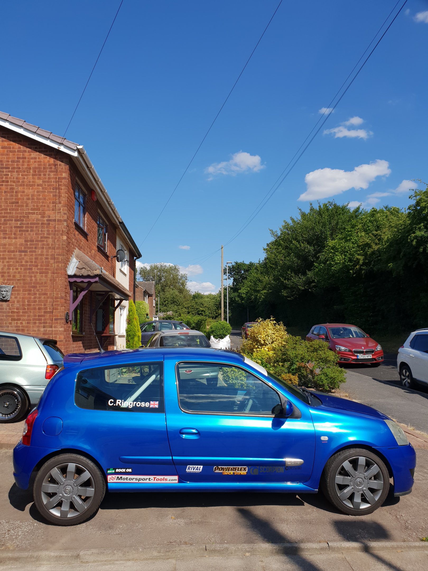

And as i had a stack of stickers being unused i slapped some on...unsure of it. Maybe will look better lower on new wheels...
