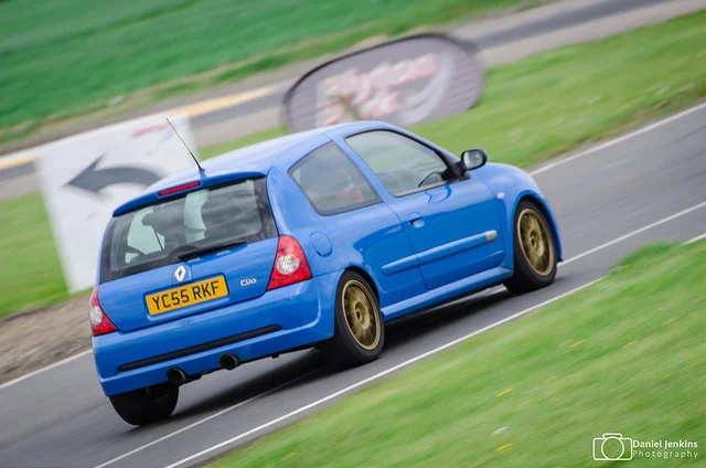

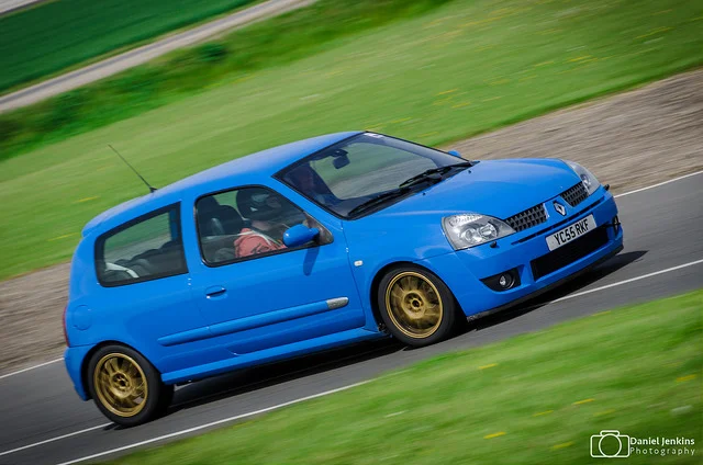

So it started off as a lovely lowish mileage RB 182. Added a few mods
Cooksport springs with suspension refresh
Pure motorsport strut brace + solid top mounts
Powdercoated my OZ F1s gold with RSRs
Ferodo DS11.1 and Godspeed discs

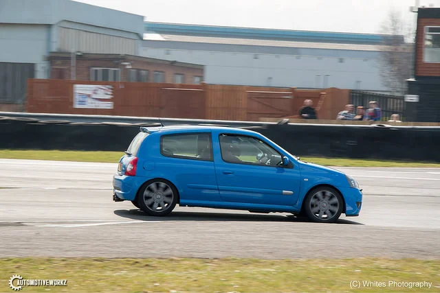

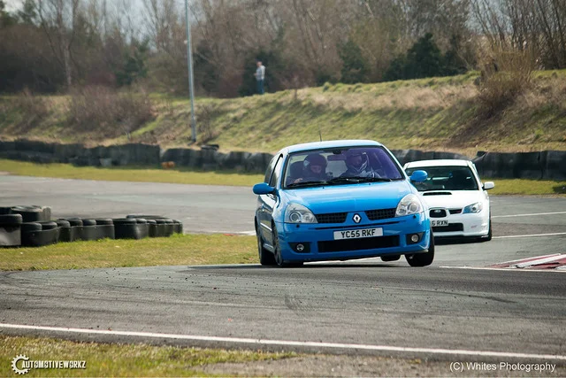

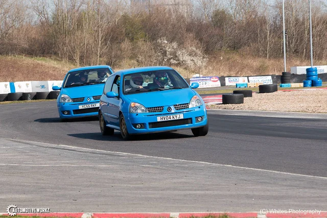

Time to abuse it around the track so hammered a few track days out in it. Got annoyed by people thinking because their car was the slightest bit quicker down the straight they didn't have to move over even though the clio was a lot quicker else where so had 197 cams installed. Made just under 190bhp with the cat still in situation. Heres some photos of it on track.
One of my favourites -

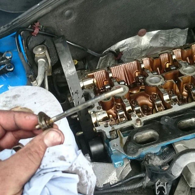

Then this happened, oops!

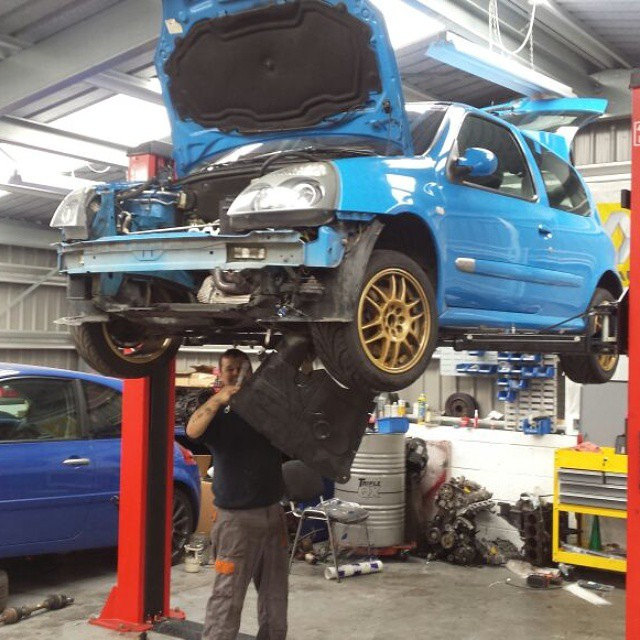

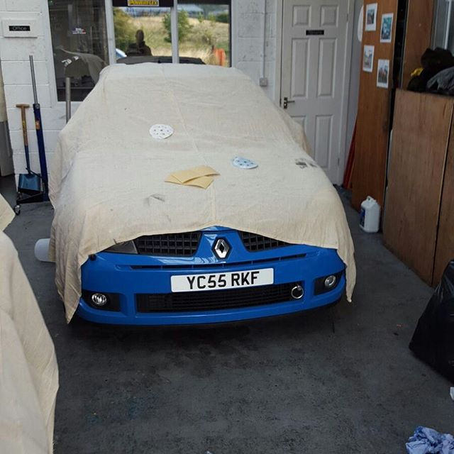

So I sulked and left it sat in the bodyshop for a week or so while I decided whether to fix it with the cammed engine or bang another standard engine back etc. Then got talking with a few mates about boosting it for a laugh so gave Andy a text to discuss a few options, more just to see what was what at the time. We discussed low boost etc and that was the plan. So trailered it to ClioTurbo for low boost. For some reason by the time I had got there I thought it would be even better to go for a fully forged engine and a GT2560R turbo in the aim to crack 300bhp but with minimal lag.

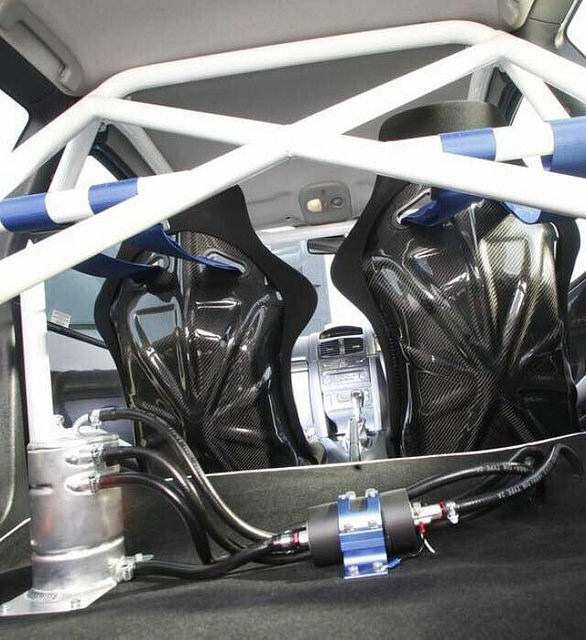

So thats it for now really. Plan was to have it back around a month ago so I could take it to the Nurburgring and Spa but sadly as we all know things never go to plan with cars so I've had to cancel my trip.
Will have to draw up the final list of what the actual spec will be when it hits the road, I can't remember off the top of my head.

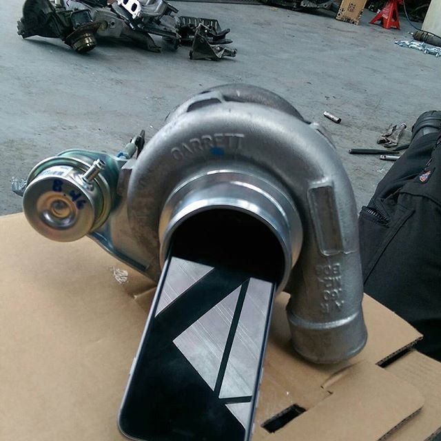

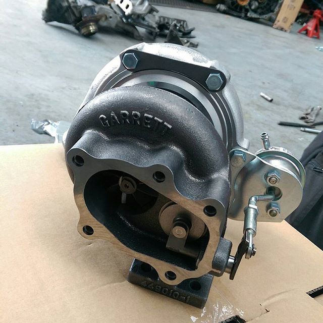

I've also opted for Apexi AVCR Boost controller so I can run it at around 240-250bhp when I want.
I don't like having gauges all over the dash either, plus there isn't anywhere in a clio for them to go really so I have also added to the spec a Zeitronix Wideband ZT-2 and LCD which I can monitor a few things with.

What actually happened to the engine originally? Bent valve?

Yeah was a bent valve. Should of put supertechs in when i cammed it and learnt my lesson from my 1st 182 lol. But owel live and learn i guess.
Supertechs are going in this time though with boost!

Does a bent valve usually f**k the entire engine? Or is it a just case of new head, maybe cams, then all is well?
My knowledge is quite basic.....
You do hear of quite a few "dropping a valve", is it down to poor timing or just one of them things?

Yeah the head was ruined on mine so he sourced me a better engine to put in. I think mine was just down to abuse, living up in the high revs all the time. It has never had an easy life. Was starting to get quite thirst oil wise as well.
My last one dropped a valve because I was a chav with a silly pops and bangs map.

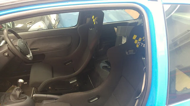

Man. Those seats!! This is going to be an epic car. In my 2nd favourite colour too
