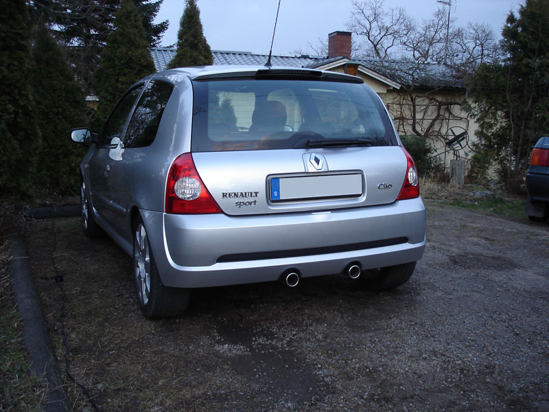

I would very much like to get the artticle numbers for the V6 spoiler and the special tailgate struts. I have got hold of the articlenumber of the V6 Spoiler package (described below) but according to Renault France this package is no longer avaliable.
Artikelnummer: 7711421152
Description: Spoiler V6
Price: €167.22
Technical description:
As fitted to the Clio V6, this longer, higher rear spoiler prolongs the roof-line of your Clio; it reduces rear-end lift appreciably at high speed. In addition, its Renault Sport branding reinforces its sports character.
Vehicles concerned:
All Clio 2 (Phase I, II, III) 3 or 5-door
this kit comprises:
· Rear Spoiler, primed, non-painted
· Central stop light
· Washer jet
· Unique tailgate struts
· Fixing screws
I think I only need the tailgate struts and the spoiler since the stop light seems to be the same used on the V6?
Sorry for OT in your thread.
