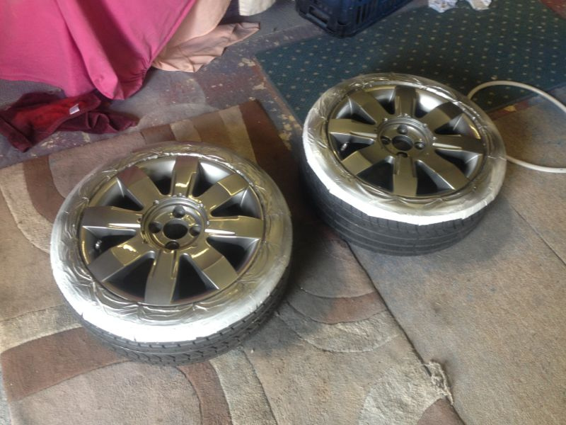

Wheels are going to start getting refurbed this weekend too.

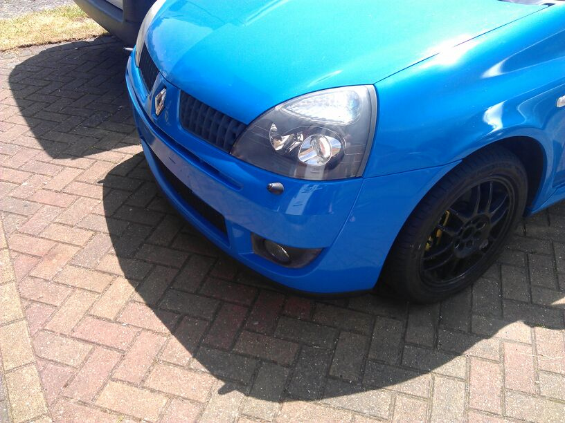

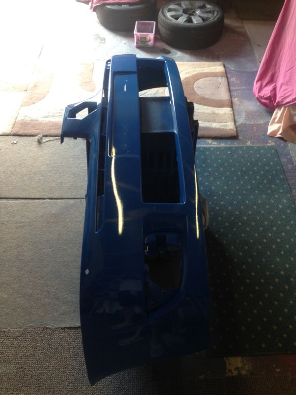

Bumper is now painted and ready to go on!
Untitled by sbridgey, on Flickr
I'll swap front bumpers? Lol ;) keep up the good work fella this should be mint when you've done with it.
Looks great! I have some bumper insert decals you can have if you like mate.
Thanks, I have some decals, Just forgot to put them on...
I have bumper OCD with the black bits so had to buy them! lol.

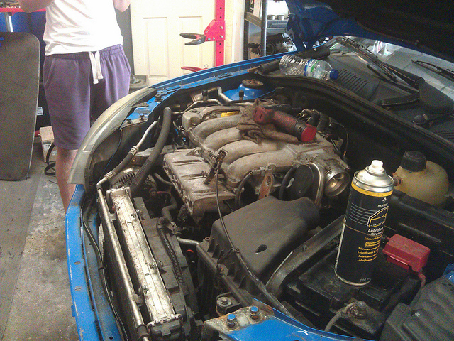

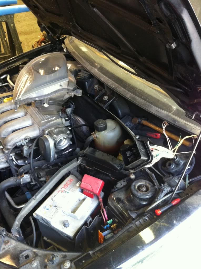

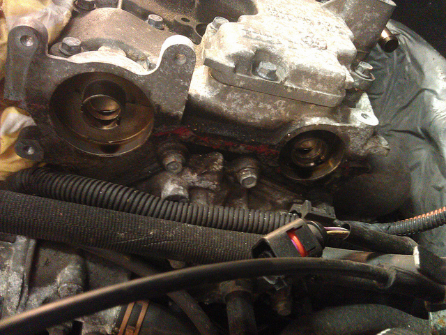

So today was the day I had been dreading. The cambelt change. I took it to Mick@Diamond in the end and was pleasantly surprised how well it went and how many little issues Mick fixed along the way.
Got straight onto it.
IMG_20130820_133427 by sbridgey, on Flickr
Quickly found a bit of a problem with the previous belt change... The exhaust timing was massively advanced.
IMG_20130820_100800 by sbridgey, on Flickr
No way you are going to get the horse shoe in there!

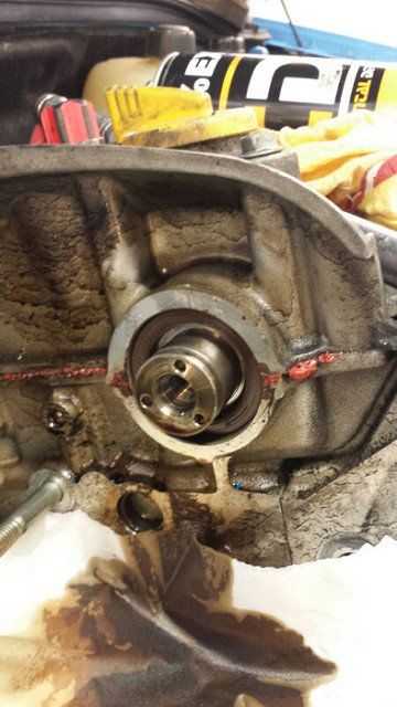

And the source of the crazy bad oil leak!! (dephaser oil seal thingy I think its called)
IMG-20130820-WA0000 by sbridgey, on Flickr
Got it all back together and she is running really, really well. Couldn't believe the difference.
IMG_20130820_141229 by sbridgey, on Flickr

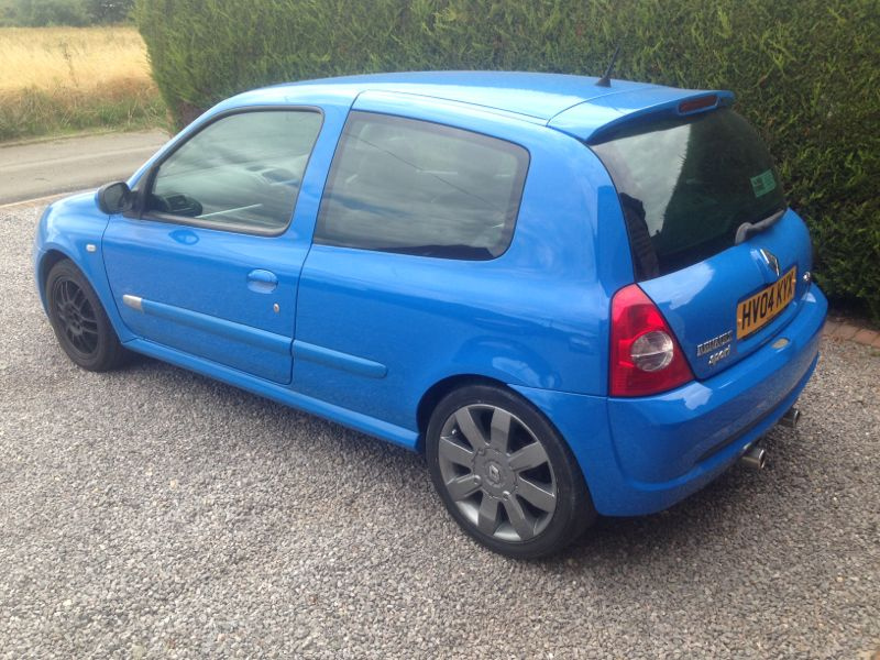

Cleaned it and clayed it for the first time today. It look so much better for it.
This has come along tremendously well! And it's nice to know that there are people out there who are willing to save rather than scrap cars. Great work!

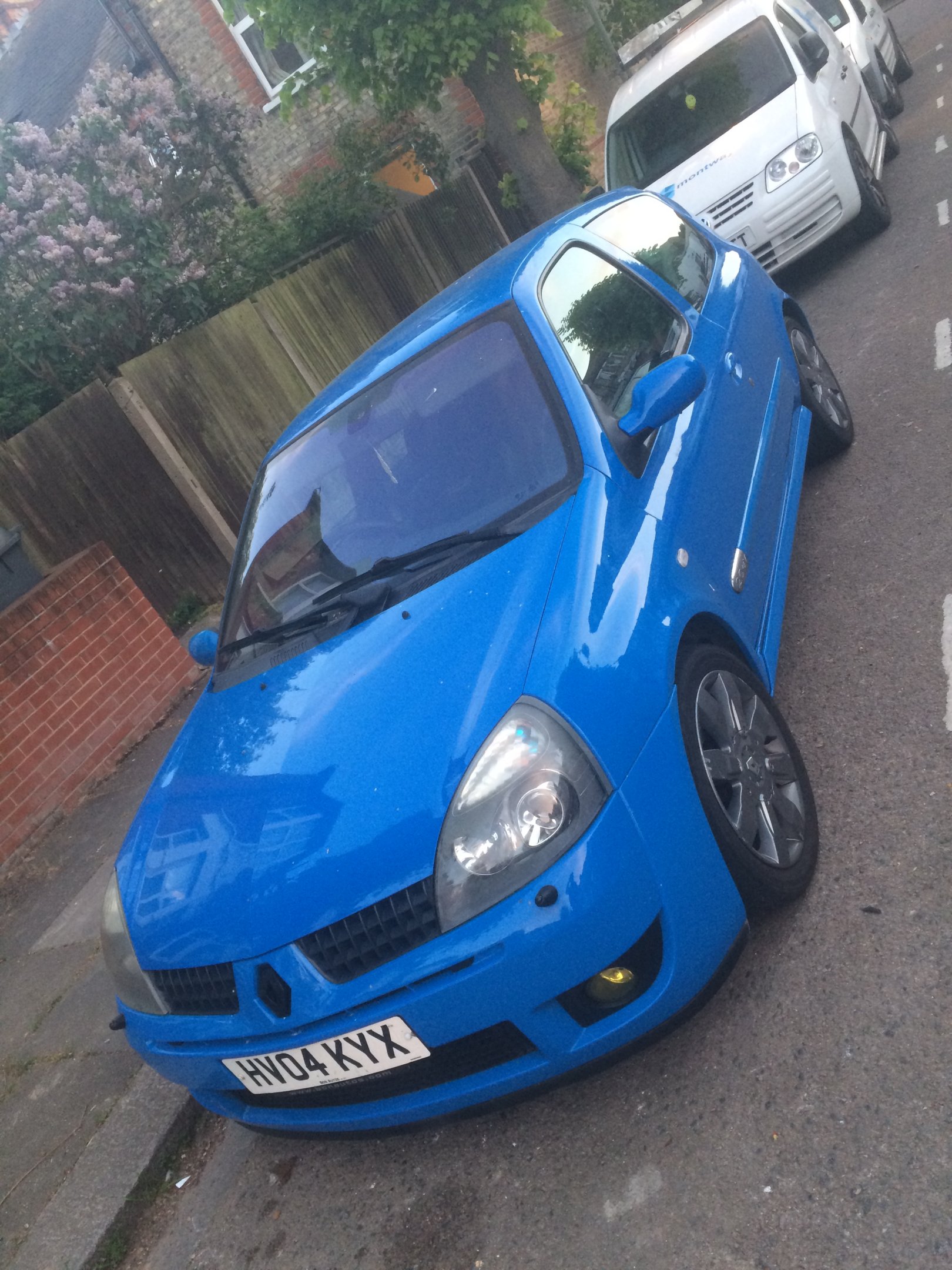

And Daniel, what the hell have you done to that poor 182? Looks like a jigsaw to put back together again!
Wow. This is my car now, I've had it around 5 months now and it's been faultless. Amazing to see it here like this! Bought it off a bloke in Essex.
Just rolled over 130k last weekend. Pulls really well! I love it!
