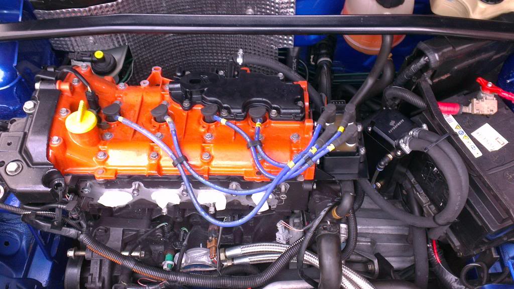

If you want to move the coil pack due to fitting a different inlet manifold, has anyone made their own bracket? I have a breather filter on the rear cam cover outlet but what about the oval breather on the top that feeds into the base of the stock manifold? I see several pics on the net where this breather just looks 'open' with nothing covering it...and then the rs2 kit seems to fit the coil pack ontop.
Any advise appreciated!
  RB 182
Quite a few people have placed them on the right hand side, there are three M6 holes to pick up on.
Ignore the leads being untidy, they have since been re-arranged ;)

Yeah I had the bracket laser cut and welded in work. We binned the carbon canister so didn't need all the piping, for the 172 you just need to blank off the small breather hole.
