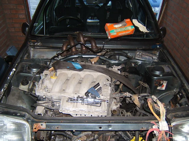

I set about it, cleaning out the inside, fitted bucket seats a roll cage and harnesses. Next came the engine, I decided to go for a 172 engine for reliability and power... so set about sourcing one and dropping it in.
The first engine had a dropped valve so that had to come back out and was replaced with engine nuber 2!! I fabricated the manifold to suit, and ran it on a DTA ECU
The bonnet needed a bit of a lump in to clear the taller engine

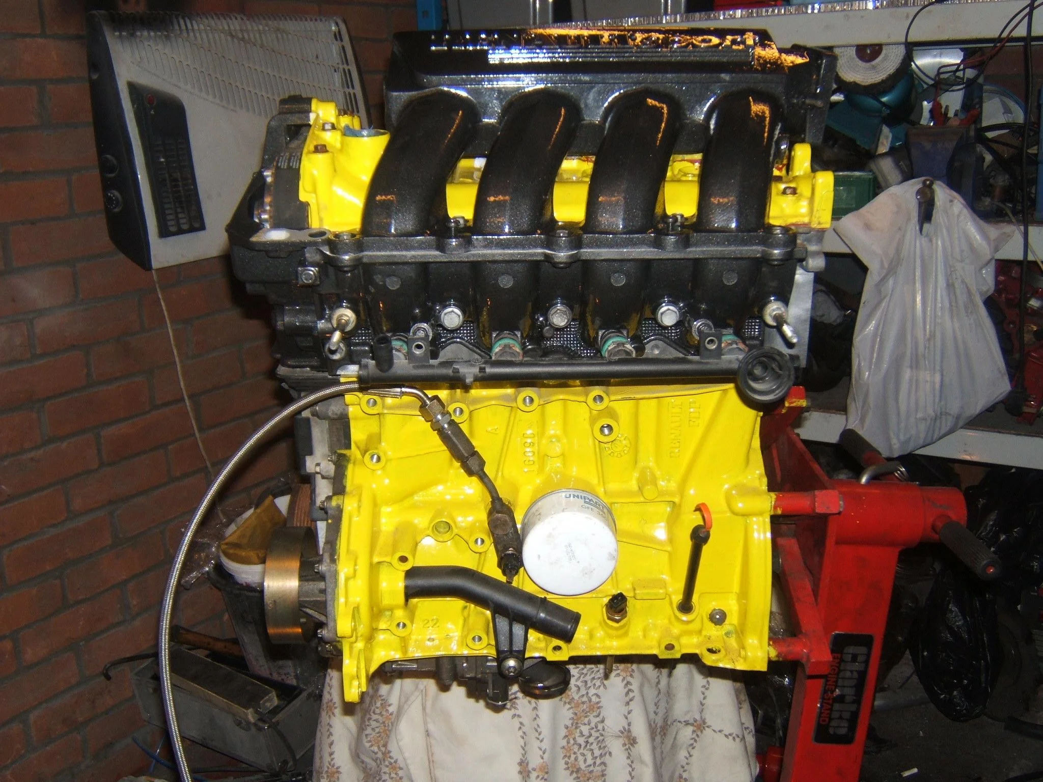

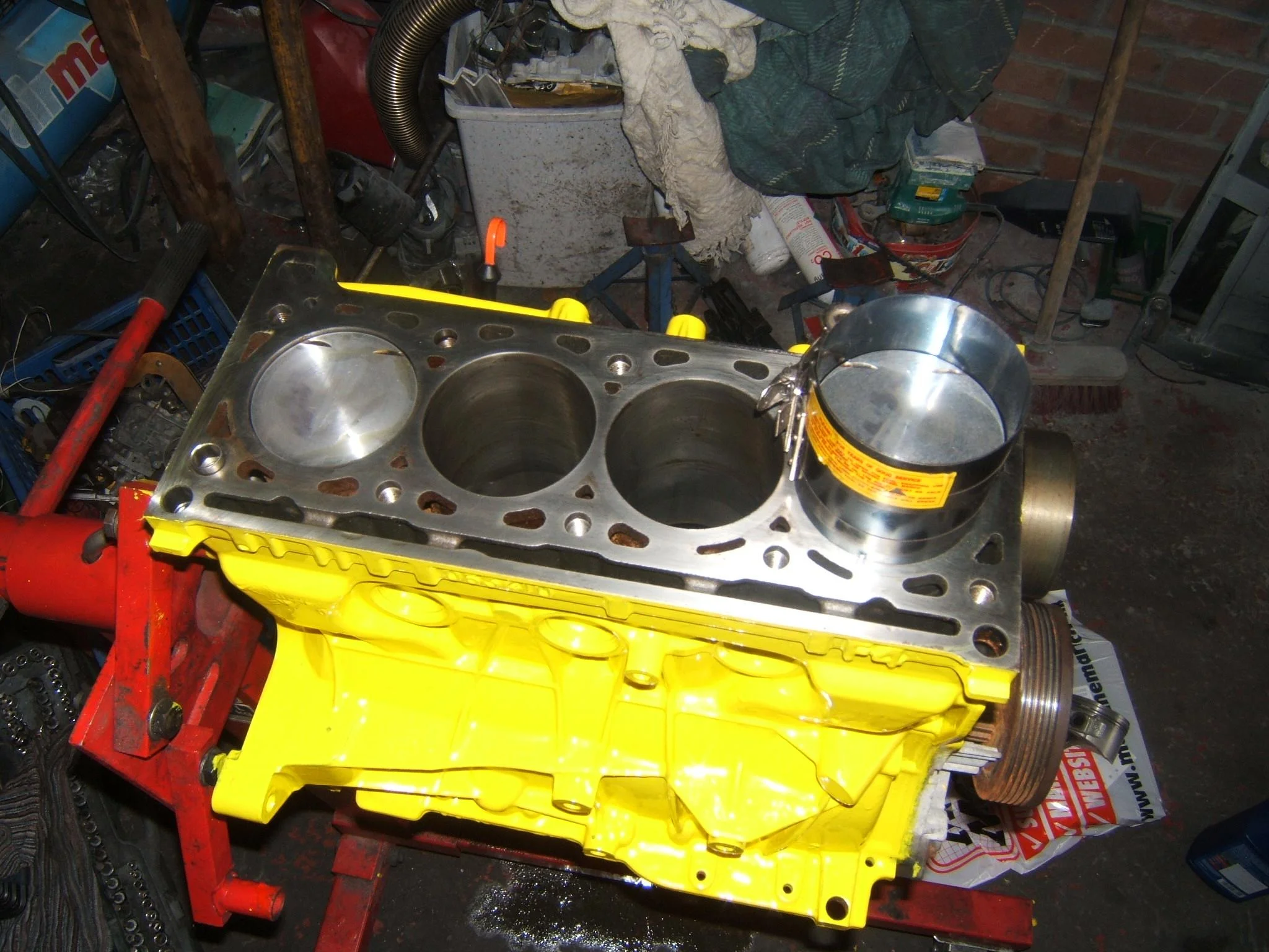

So I set about re-building engine number 3

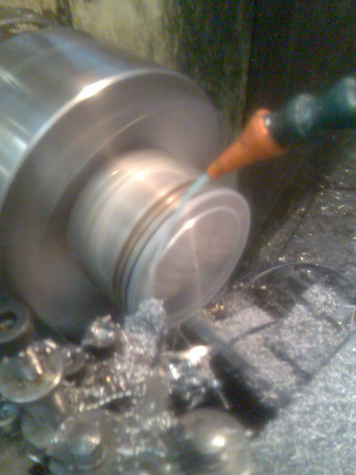

Machined the pistons down to drop the compression -

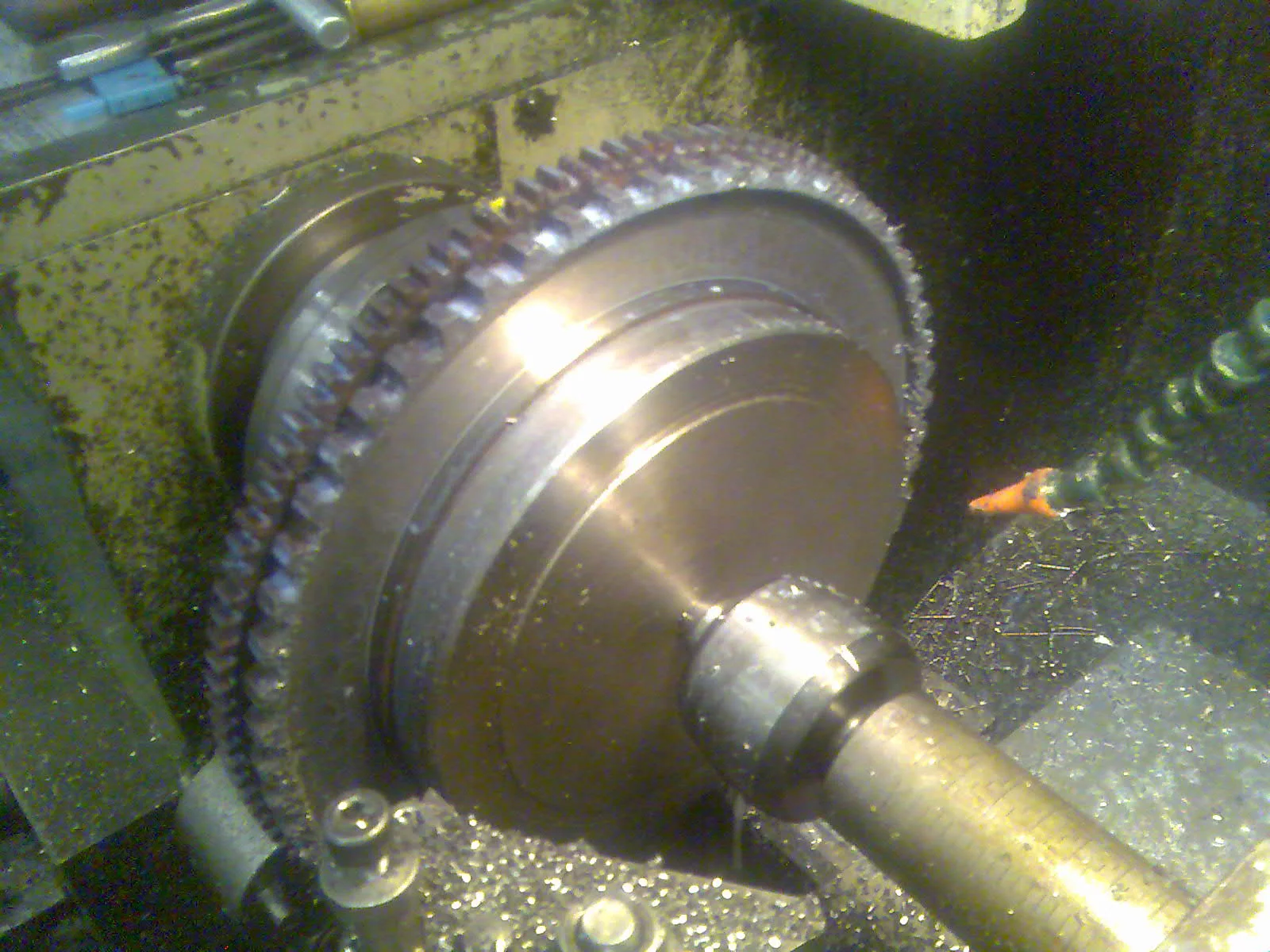

Machined the flywheel to take my multiplate clutch -
Stripped the block & Painted it yellow :dead: -
Blasted and powder coated the inlet manifold and plenum - :evil:

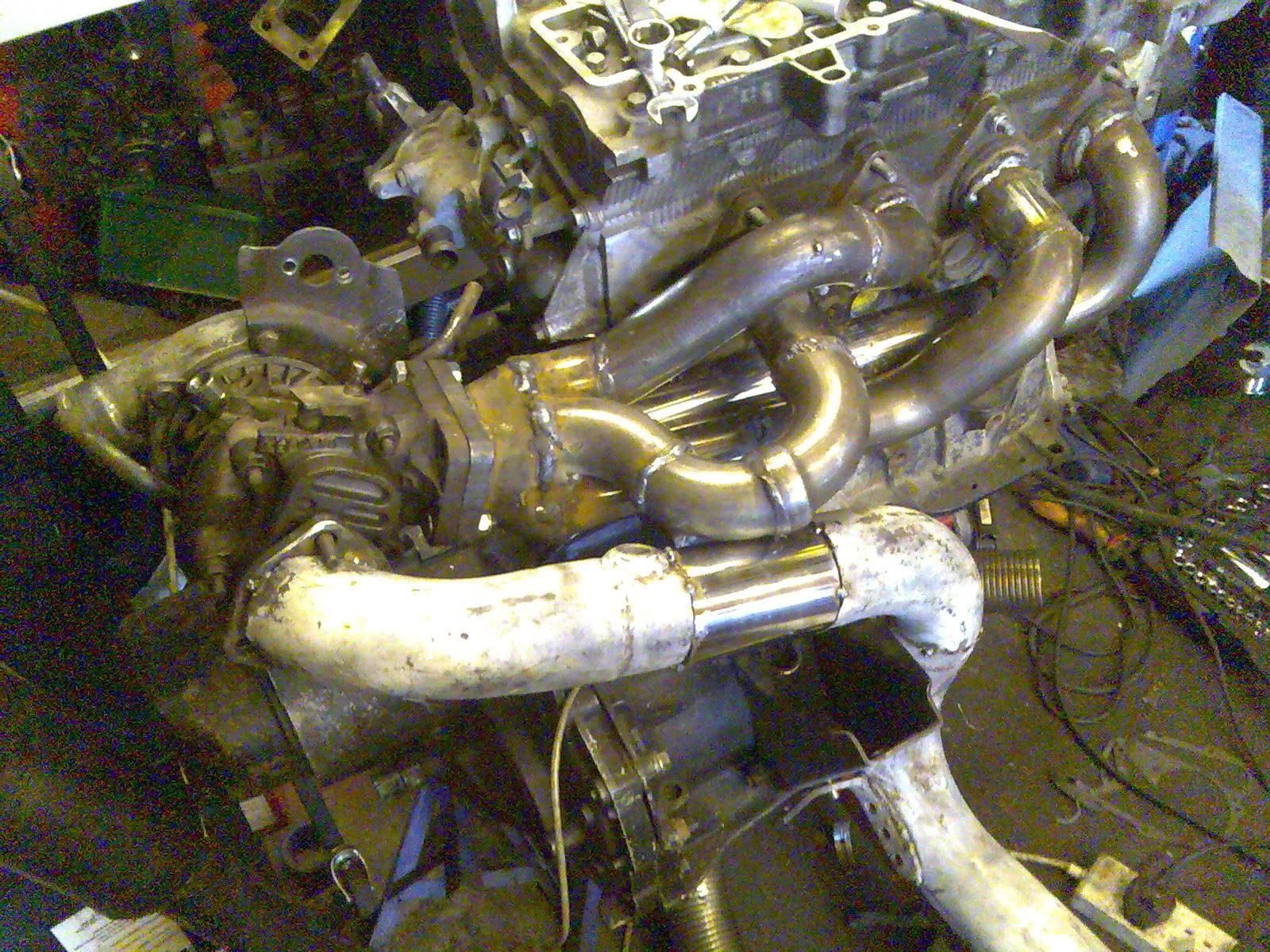

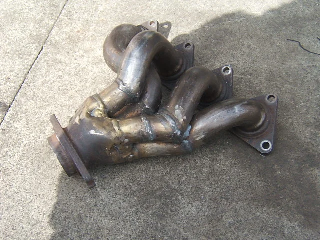

Knocked up a manifold and downpipe to suit a T3

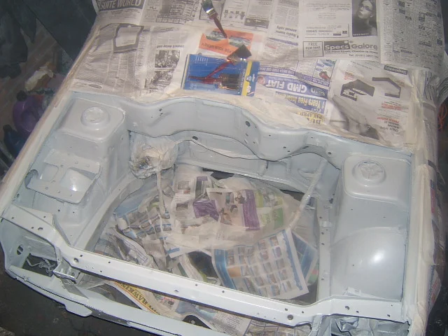

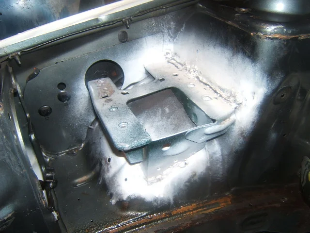

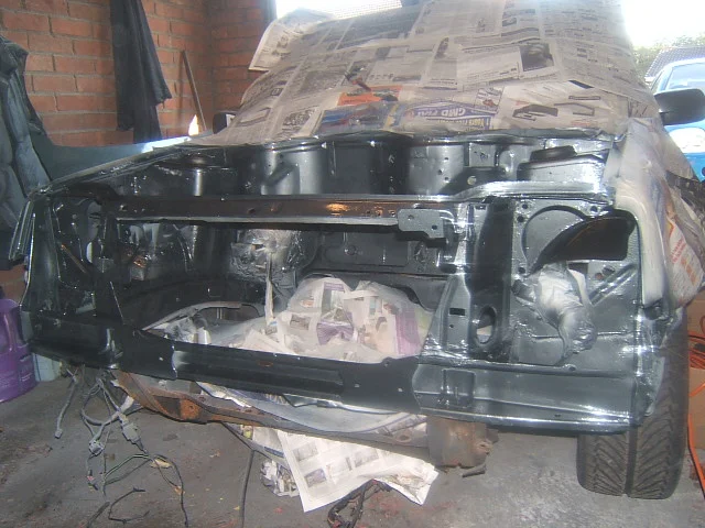

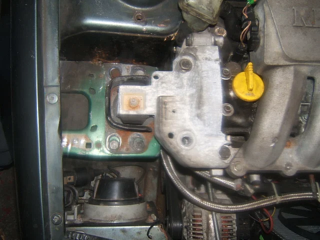

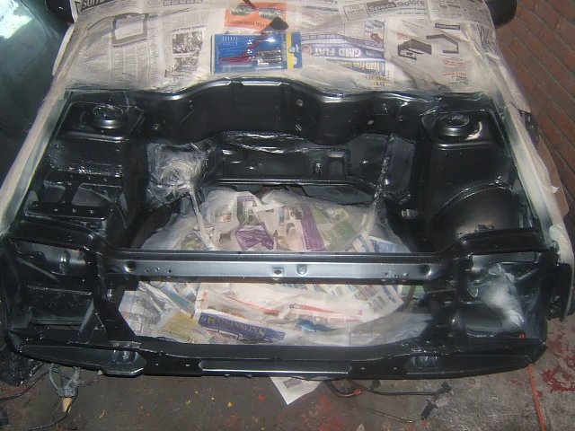

One of the problems with the NA engine was movement, it rocked about too much on the gtt mounts, so I had to brace it with a bit of a pikey stabiliser bar onto the strut top.... So once the engine was removed for the turbo conversion I decided to weld in a clio top mount...
Here it is primed -
And painted -
Sorted, now to drop the engine in....:quiet:

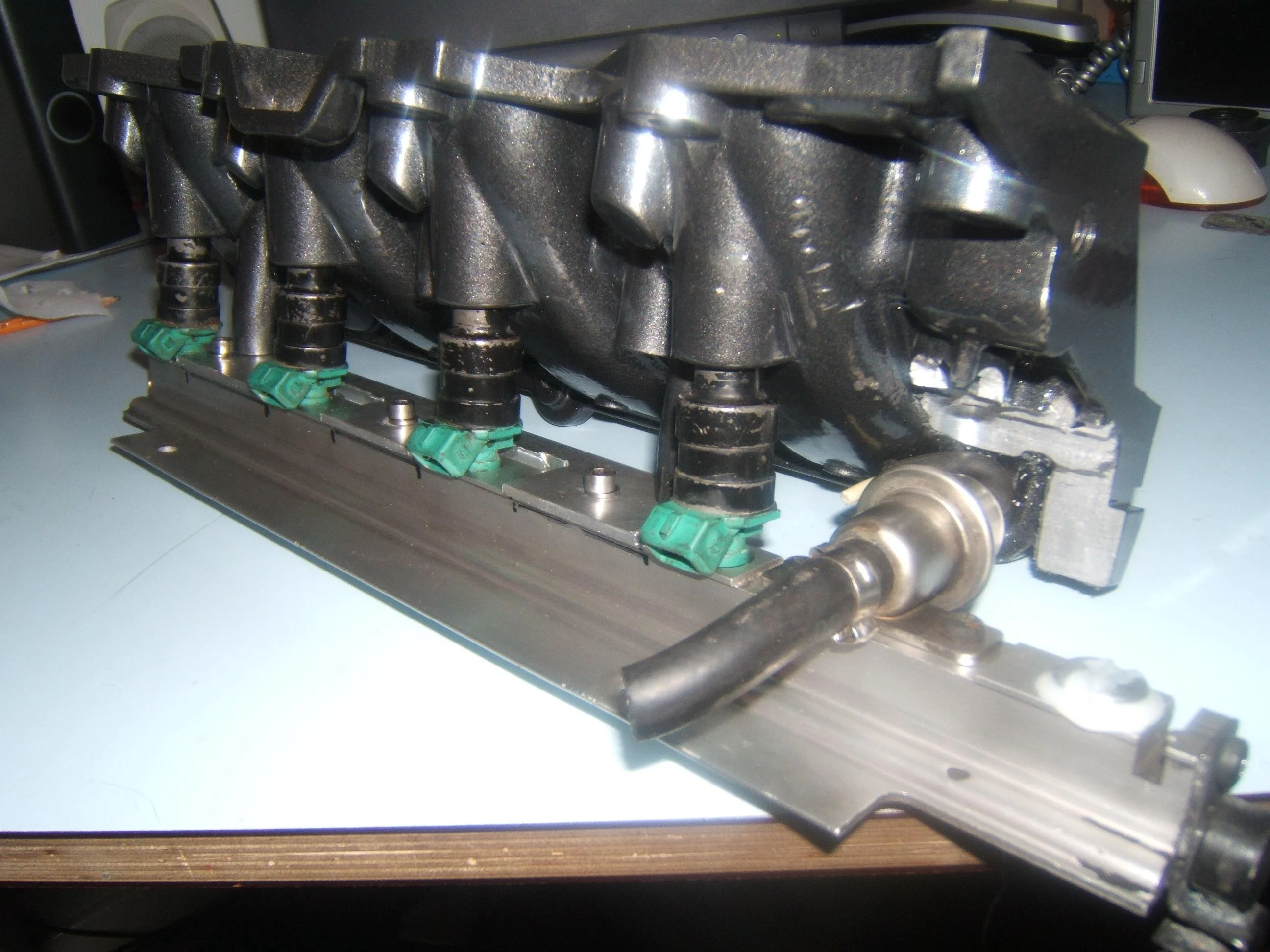

so, new engine needed a better fuel rail and FPR that could cope with a bit of positive pressure, so instead of re-inventing the wheel I stole Scoff's idea of using the volvo T5 fuel rail... with a bit of machining i made a bracket to mount it to the inlet manifold.
and fitted that to my engine

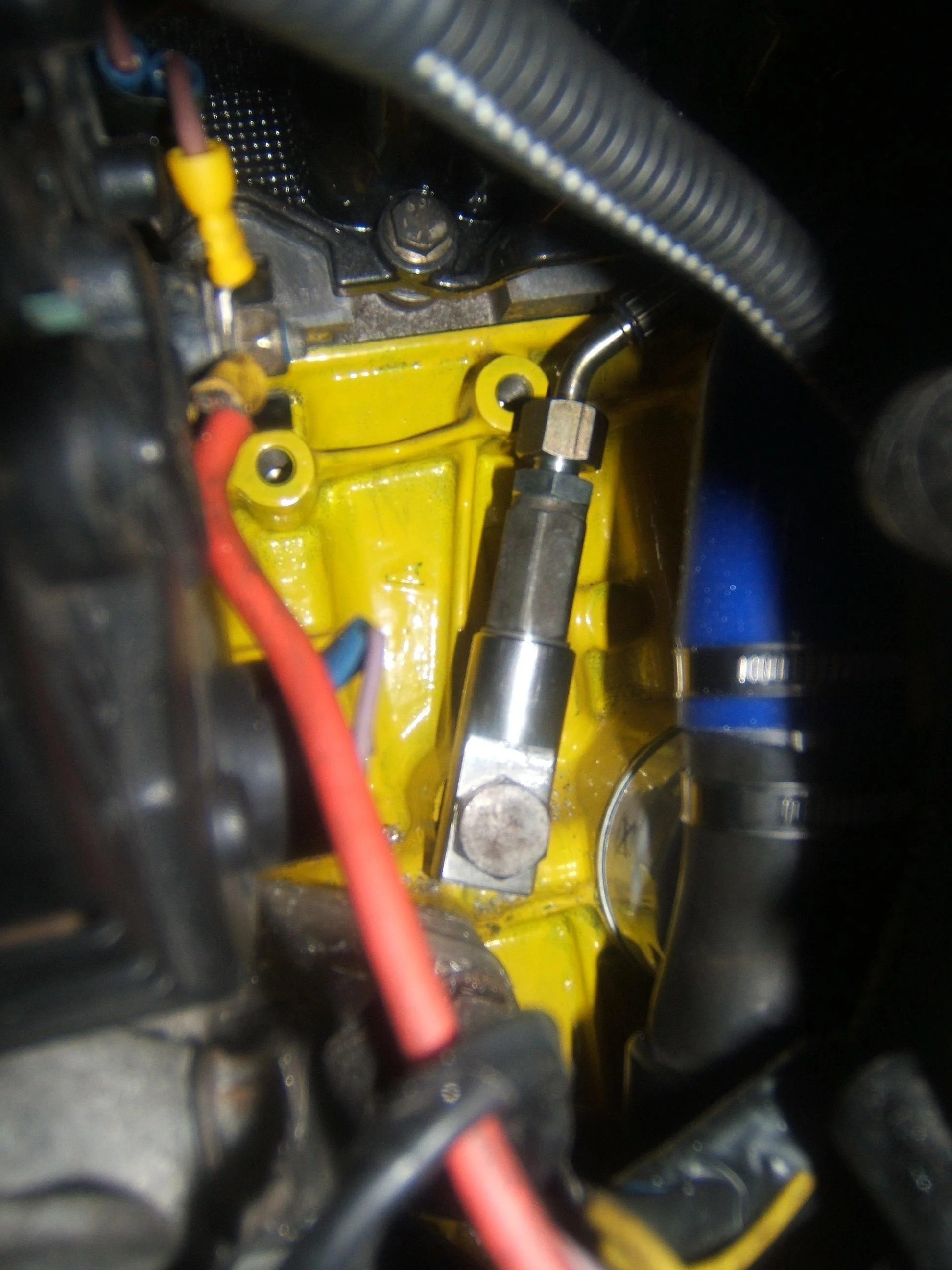

I also machined a new turbo oil feed banjo as the gtt one I was planning to use wouldn't fit properly...

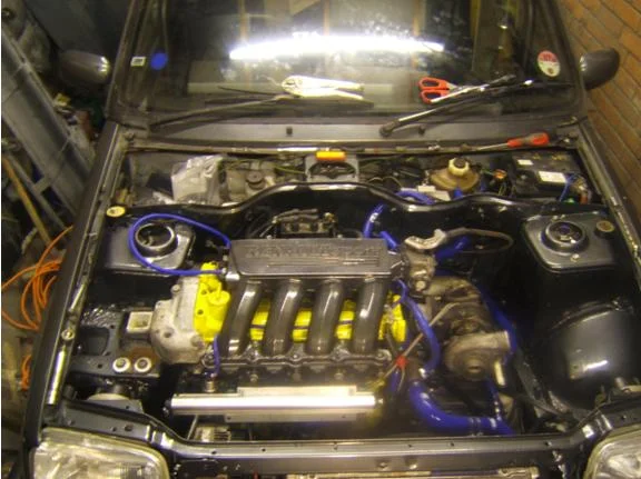

Well what a weekend, after burning my starter motor out yesterday I managed to find another one in the garage today
Slapped it on and tried again to get her to run... Found that the pressure compensation map was all over the place (dont use USB to serial converters when uploading saved maps to your ECU it screws all the data up!!)
Anyway long story short, I got her running for the first time
well happy
Heres a vid....
http:// www.youtube.com/watch?v=QBumHOeqKow
Just needs an oil change then a good mapping session!!

that manifold looks, errr, well balanced. Praps cylinder 3 (from Cbelt) will experience a little more back pressure than the others!
I can't talk tho, A nice project and if it works and shifts, then thats all that matters!
good luck mate
A
ashy_gtt
Why would it need to be ballanced? have you seen a gtt manifold?

Wouldn't of thought so m8, I nearly halved the weight of my flywheel, took a lot of meet off so the Clutch didn't foul inside the bell housing!
