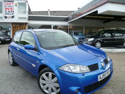

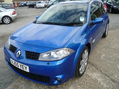

Whats to know about these? One has popped up local to me. Nice spec and colour, and a very good price. 3 owners, 92k miles full years MOT. Whats the tax like on these, average MPG? Anything to look out for? The car in question.

Belts been done? Things to look out for are seized steering hub bearings & faulty window regs off the top of my head.
Ben
No mention of belts but would make that the first thing I asked. Are they expensive to be done if they need doing?
Ben
Cheers Steve. Should I be out off by the 92k on the engine? I suppose the best thing for me to do is to go and take it for a test drive.
