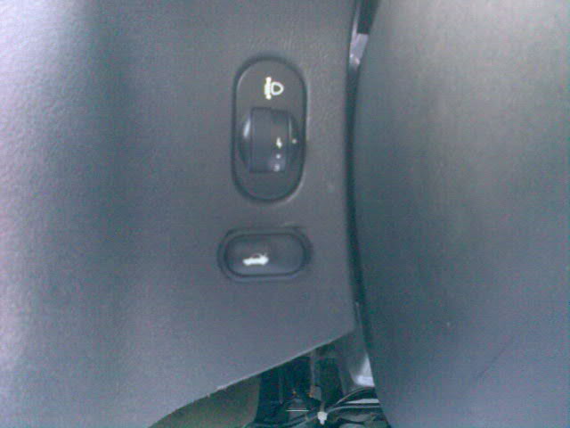

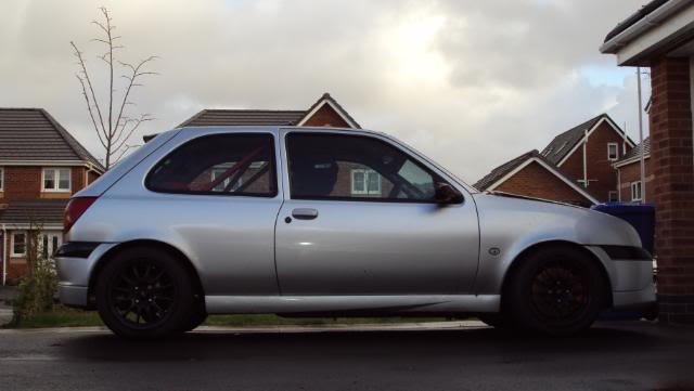

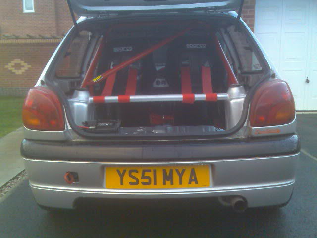

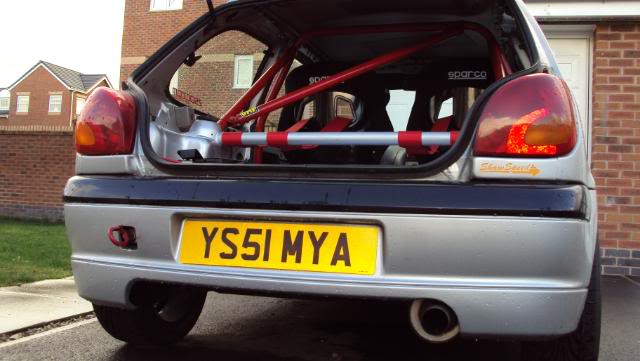

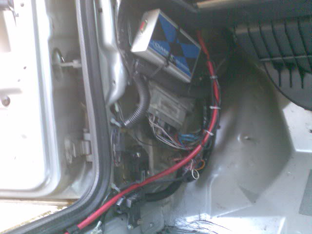

finished tidying everything up and this is how it looks -
still doesnt look THAT tidy but its so much better than it was -
new position for the boot release -
also took the lagoona splitter off too!!

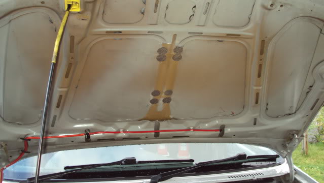

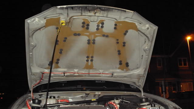

Quality Job your doing there, dont see enough fiesta's on track.
Only constructive critisism i will offer is the bonnet, drop it because it does nothing! Its a negative airzone so no air will be drawn from it.
Thanks! :D
and ive only got the bonnet like that cos i like the look of it and it lets all the hot air out of the bay when stationary

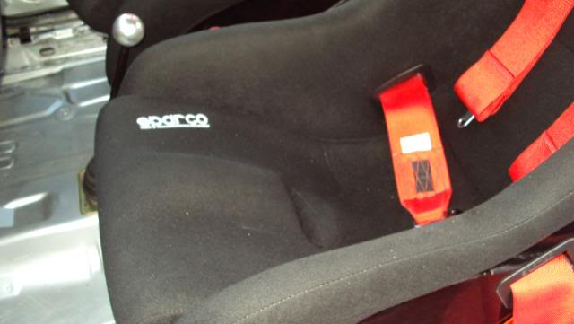

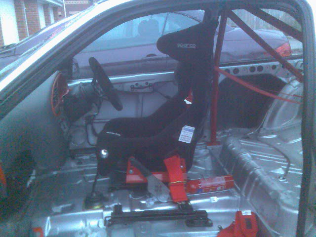

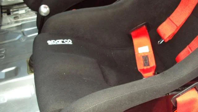

well picked some new seats up earlier (whitleleys)... did 50mpg over 250miles in the 1.25 lol...
one in for tnite as i cant be bothered fitting the other in the dark and rain -
in that bottom pic looks like the seat has got its lean on to the right, will have a look at it properly tmoz
could do with a smaller steering wheel now lol

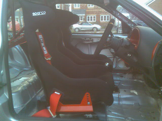

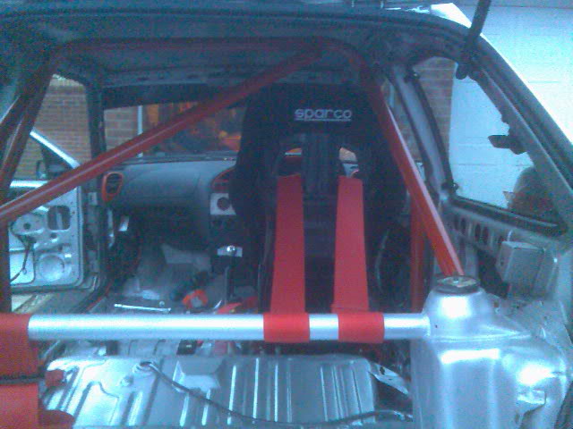

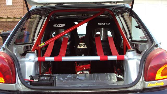

both in -
just wish they could go a touch lower... forgot to say they are Sparco Circuit VTRs on Fiesta Mk3.5 subframes and sparco side mounts
Just do it properly and weld four bars into the floor, sack the runners off completely, its height that does not even need to be there.
Set it up and weld the bars in so its how you like drive it position wise, then bolt the side mounts to those. If you need to move it forward or back slightly, the sidemounts give enough adjustment, but if you do it right in the first place you will never need to. "Do it once, do it right."
Give a f**k about anyone else driving it and not being in the right position? No. Its not their car!
  JDM Dc2
yeh may do in the futre.. see how these feel to drive in/with first... its the pads on the seats lift your legs right up unlike the old ones, looking over the steering wheel is exactly how it was about right... just that these are so much more deeper than the others

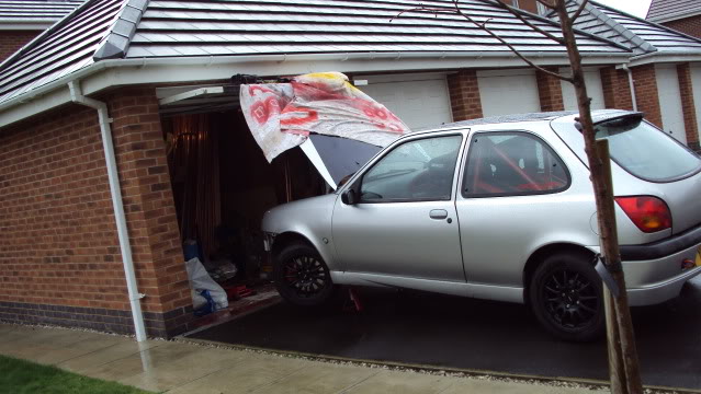

New camera came through the post today so couldnt have asked for it to arrive at a better time tbh...

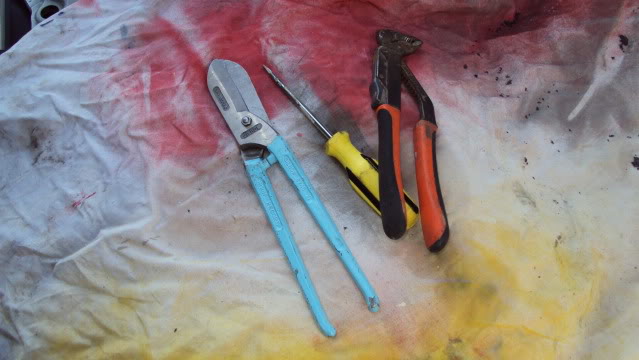

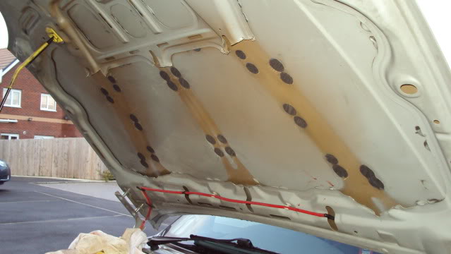

Been meaning to do this for a lonnnngg time...
the tools -
Started (blood everywhere lol) -
Progress -
Finished -
thats as mush as im going to do as i cba fitting bonnet pins (yet) and dont want it to flap every where on the corners.

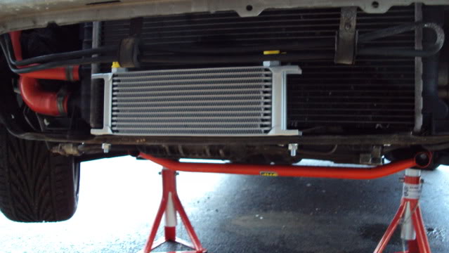

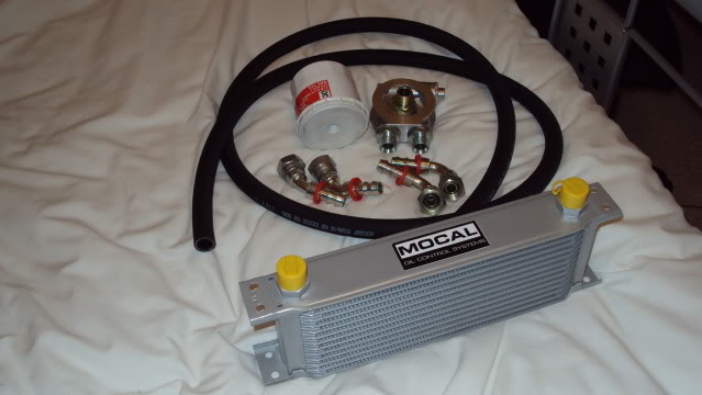

Picked up some goodies from jon last night... Mocal 13 row oil-cooler, 2m of hose, fittings, thermostatic sanwich plate and a focus oil filter -

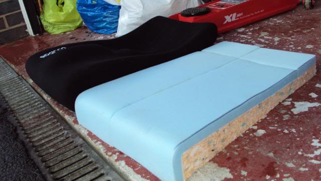

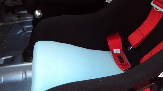

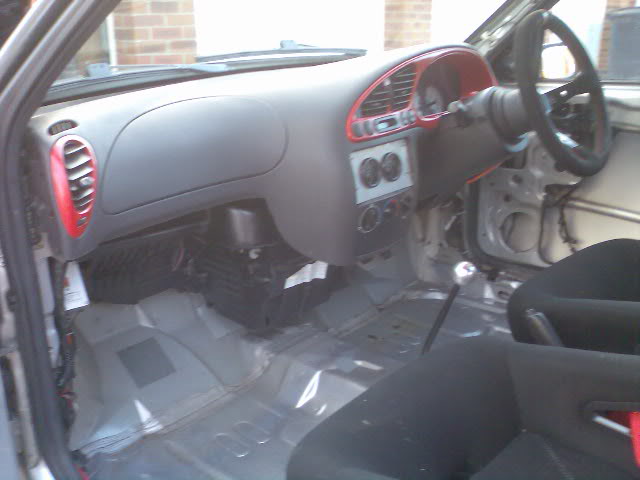

For temproary till i get bars welded into the floor ive had these cushions made instead of the standard ones which kick your legs right up at the front of the seat...
before -
now (still need to get used to this bloody cmaera lol) -
the difference -
gonna get them covered in some black cloth of some sort next week but the driving position is sooooooooo much better now sat a little more lower down and my feet feel perfect at the pedals now pointing right at the instead of from like above as it was with them sparco ones on... also makes the seats deeper with these new cushions in

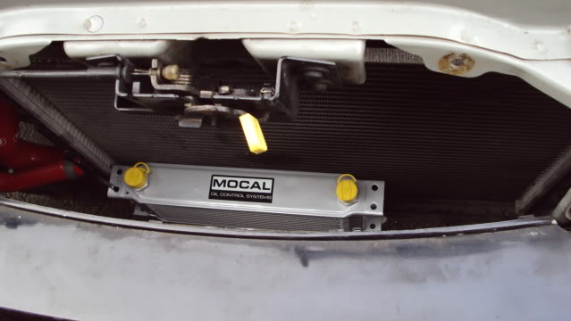

Went to the scrappy and there were no mk4/5s with AC so i thought id take my bumper off and find the best place for it... mounted with trusty 5mm tie wraps lol gonna get some 7 or 8mm ones tho soon, also removed the lower grill from the bumper too -
hopefully by sunday itll be all in and piped up etc

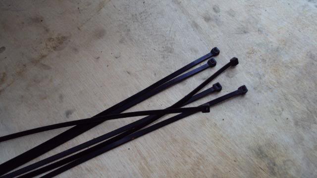

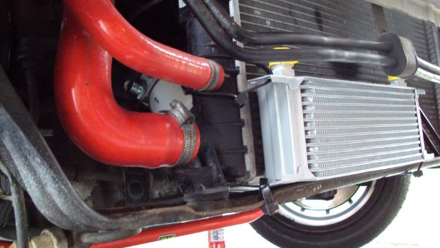

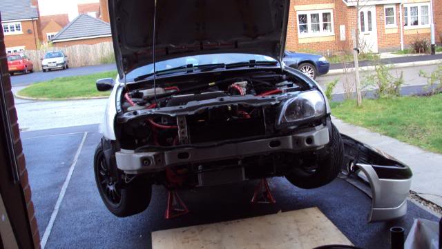

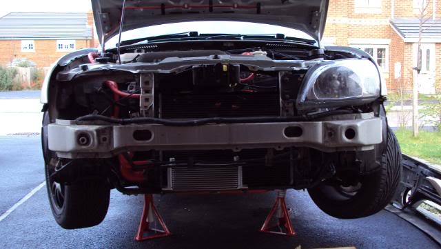

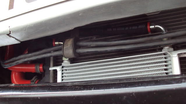

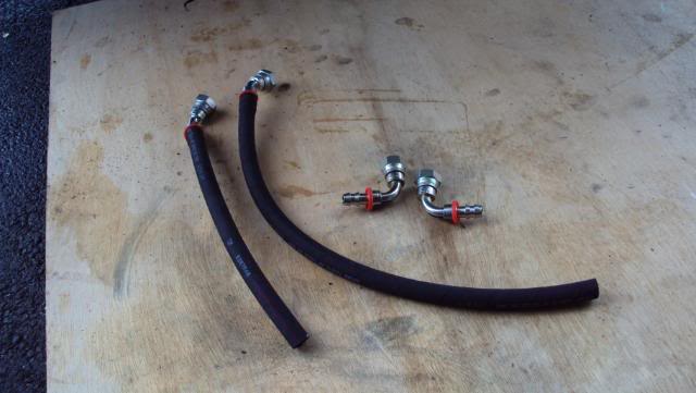

Thought it'd be best to remove the bumpere to do the sandwich plate, redo the oil cooler and size up the hoses... so off AGAIN...
New 8mm ties -

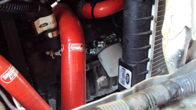

Sandwich plate and new focus oil filter fitted -

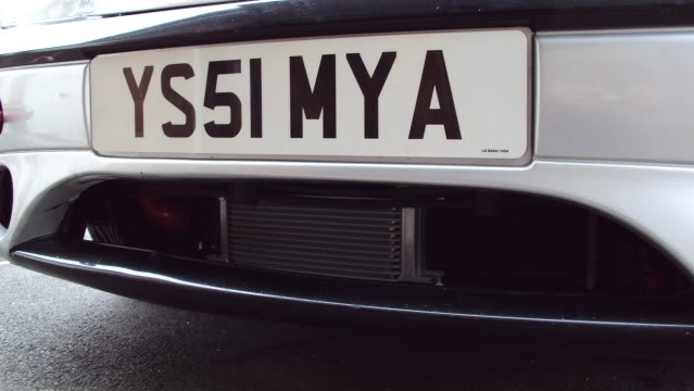

Got 2 of the fittings on last nite, cant do them withput a vice there that tight, also cut to shape and ready to do the other 2 later -
  JDM Dc2
working in the rain ftl!
hoses all connected, crap pic like as i forgot before i put the bumper back on lol -
Started car up for like 15-20mins let it get upto 85ish degrees, letting it cool down now atm before i check the oil again as itll probs need topping up another 1/4litre or so as the oil doesnt start flowing through the pipes and cooler until the stat opens at 80degs, no leaks so far anyways!
  JDM Dc2
Oil cooler is great never goes over 80degrees once on the move, cant wait for the trackdays next year now, will be able to do proper sessions now lol...
