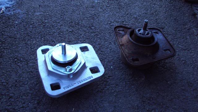

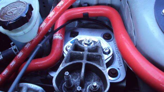

Had ago at doing the engine mount earlier, tried slacking off the 10mm bolts where they go into the chassis, 3 came out fine but theres always one isnt there 10mm socked slipped on it, then wacked a 3/8 socket on and that rounded it too, so its like totally round now lol, gonna drill it out tmoz as thats the only way or to either gring the head off the bolt but theres not enough space for the grinder to fit in the space so drill it outs is the only way me thinks.
Done the mount.

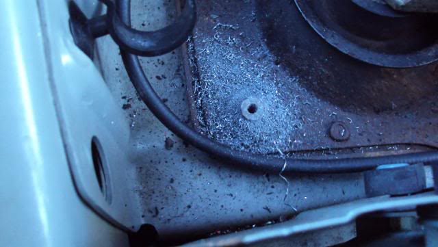

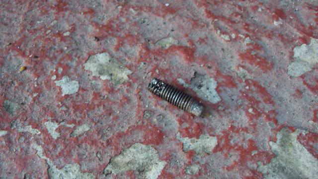

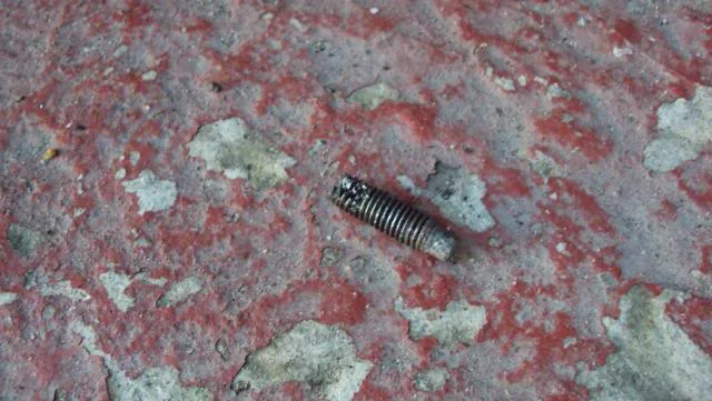

Fistly drilled the head of the bolt that was rounded off starting with 2mm then 3mm etc etc -
once i snapped the head off i undone the arch lining and undone the rest of the bolt -

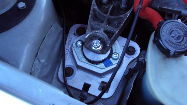

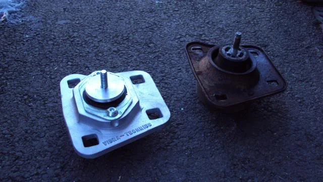

Old vs New Vibratechnics one -
Done -
Just need to get another bolt now which ill sort tmoz.

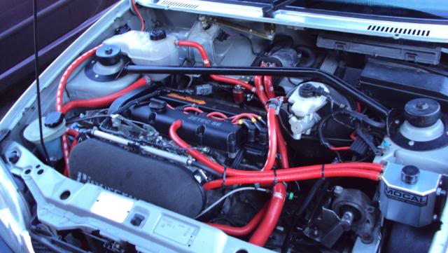

What's this running now?
  • 1.6 Zetec SE Phase 2 engine;
  • Jenvey throttle bodies, 40mm bodies, 40mm trumpets, 20mm trumpet spacers;
  • Shawspeed Inlet Manifold;
  • Vauxhall c20xe injectors;
  • Omex 600 ECU with rev limit set at 7.8k;
  • Shawspeed SS4 cams;
  • Big valve head;
  • HD Piper valve springs;
  • HD ARP big end bolts;
  • Shawspeed Baffled sump;
  • Webber 3.5bar fuel pressure regulator;
  • Magnacor 8.5mm HT leads;
  • Denso iridum spark plugs;
  • Pipercross 600 series filter;
  • Mocal 13-row Oil cooler;
  • Mocal Oil catch tank;
  • Kenlowe lightweight cooling fan;
  • Samco hoses all round;
  • FRP gearbox;
  • Shawspeed lightened flywheel;
  • Helix Organic clutch;
  • Miltek 4-2-1 manifold;
  • Custom De-Cat;
  • Piper Cat-Back with mid-box removed and custom 2.5" tip;
  • Vibra-Technics Upper Engine, lower engine and gearbox mounts...
When mapped at Mikeanics - 155bhp @ 7250rpm... 119ft lbs. @ 6700rpm...

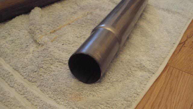

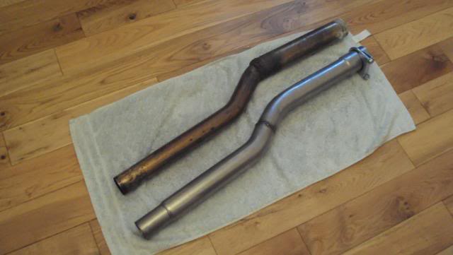

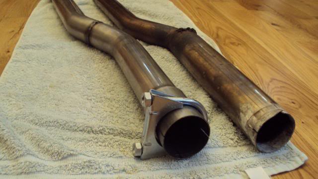

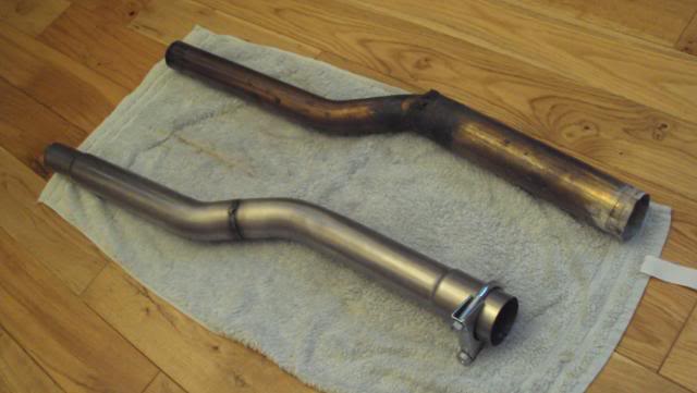

Just got back from Pipewerx in Ormskirk, had the new de-cat/mid section pipe made...
Old (2.5" bodged to the 2" piper) Vs New (2.25") -

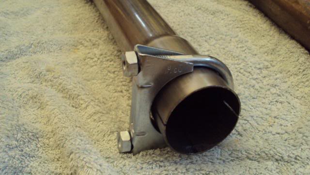

Opened out to 59mm for it to slide over the Milletek manifold -
Reduced down to 2" to connect to the piper system -
Mint job
Cant wait to fit it... id go outside and fit it now but ermmm -
Thats what I mean. 2" Piper? Might aswell fit the standard system, lol.
whole system isnt 2 " tho really is it now, half of it 2.25, then about a mater of 2" then the back box, still good for 155bhp so meh, to get the 2.25" system you have to get the full piper system inc. manifold through pumabuild and i aint forking out 600quid just for the sake off a meter of the system 0.25" bigger lol

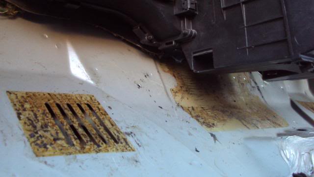

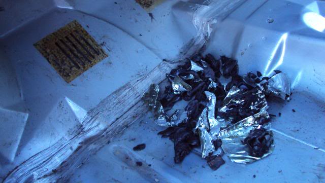

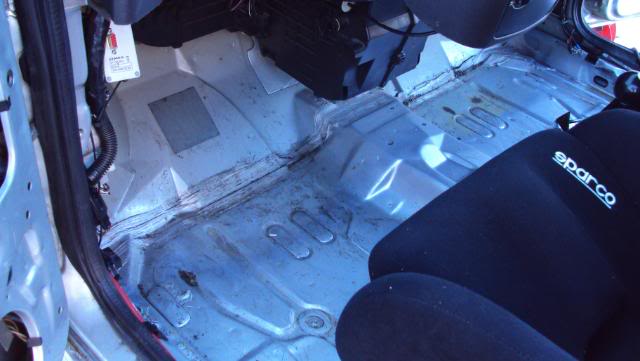

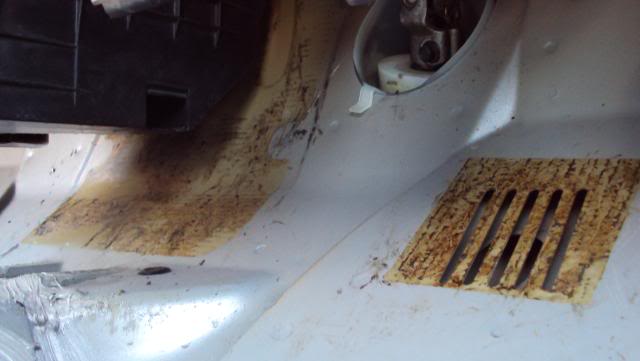

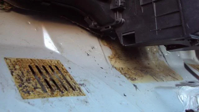

Also the interior floor is in abit of a state so thought id remove the rest of the sound deadening, what i can get to...
after them pics i wiped away the excess with white spirits and will give the rest a good clean and paint it when the weather gets a little better as it will only just get full of crap soon enough anyways.

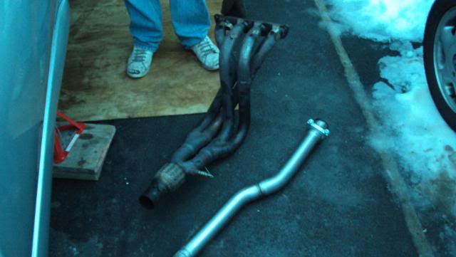

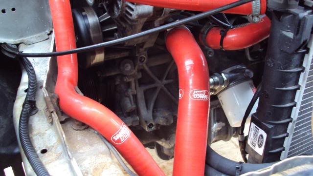

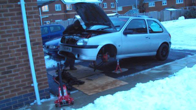

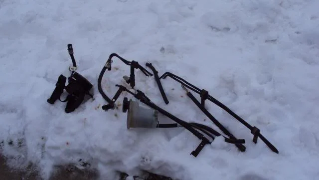

Well today...

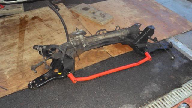

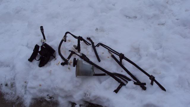

Started by removeing all the PAS pipes and the aux. belt and the pump inself -
Then whilst waiting for f0xy to come round i removed the anti-roll bars form the coilovers and the track rod ends... then when he arrived we got on with removing the exhaust de-cat pipe and milltek manifold -
then dropped the gear linkages then removed the subframe and rack -

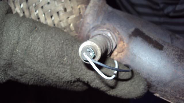

as we were removing the manifold both the bottom nuts were loose and the lambda sensor was snapped -
so im gonna nip pipewerx to get the de-cat pipe reduced 1mm and to also get a new lamba sensor one afternoon this week.
