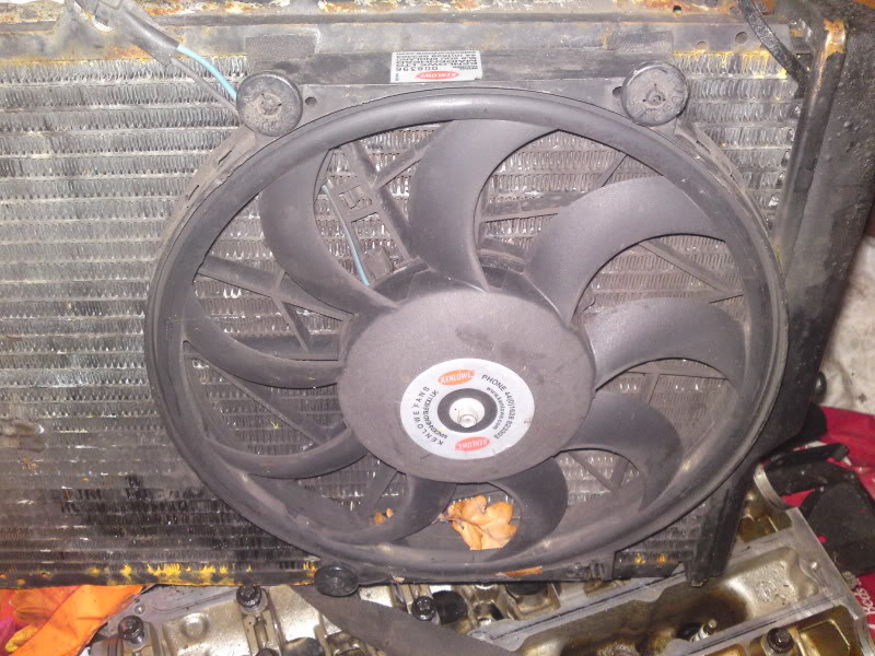

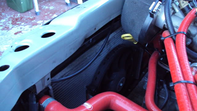

getting this off a mate soon, Kenlowe fiesta RS Turbo lightweight cooling fan.

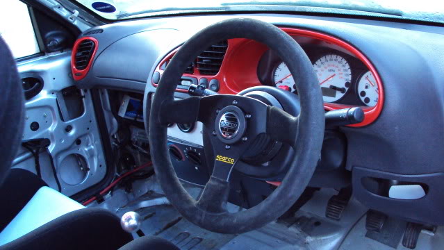

Just took the boss and wheel off, one of the wires connecting onto the boss area had like been weared away at and was shorting out against the boss, simpley turned the wires around, taped everything up, jobs a good un'

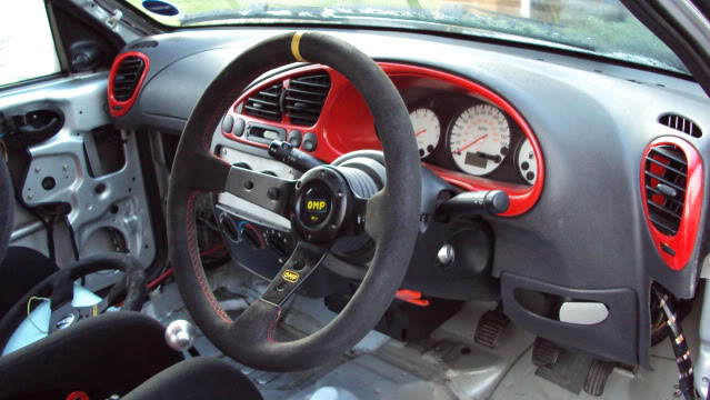

  • Picked up adams old sparco suede steering wheel last nite as its slightly smaller and has no dish so should be perfect on the extended boss i have atm... will be fitting that inabit...

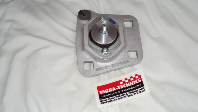

  • Vibratechnics upper engine mount (only one i need now)...

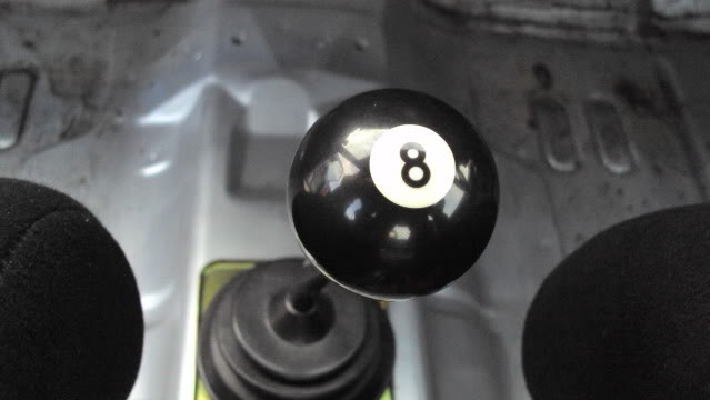

  • 8 ball gear knob again too lol...
  • Kenlowe fan off andy...

old wheel -
new wheel -
old one might look better but new one certainly feels much better driving position... when i had a wheel this size in my black zs i couldnt see 2-4k on the tachometer but with this boss can easily see it all

oh new gear knob arrrived this morning too

Just ordered the last Vibratechnics mount i need, the upeer enigne one, hopefully thatll be here tuesday then i can get cracking with that, the wiper when that arrives tmoz hopefully and also do the fan :D

Fan and wiper all done anyways...

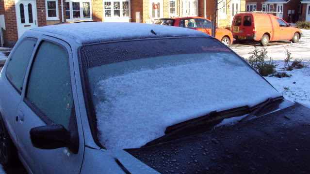

Wipers before -
How the single is sat now -

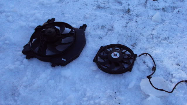

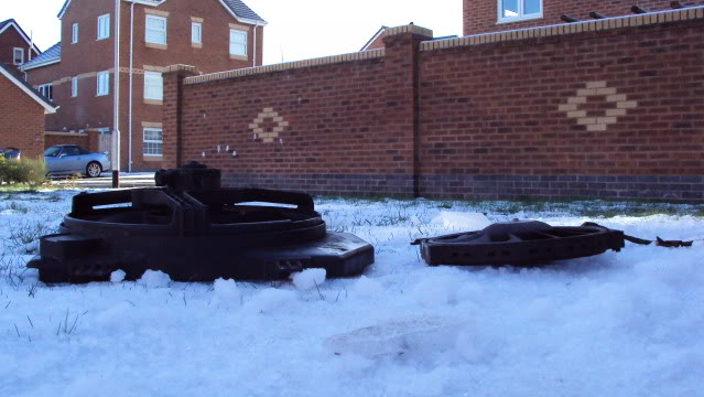

Standard fan -
Compared together really shows how tiny the Kenlowe one is -

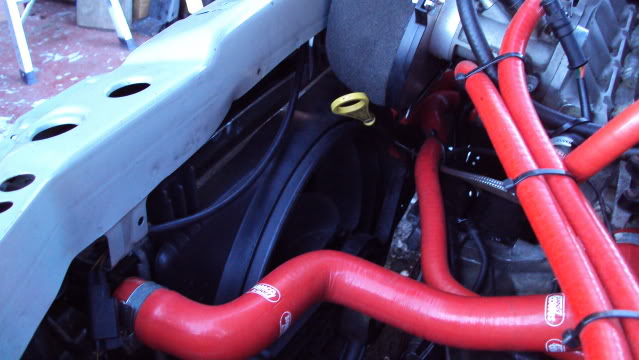

Kenlowe one in -
Sooo powerful for how small it is!

The engnie mount arrived yesterday too -
Hopefully do that tmoz, if not sometime between crimbo and new yr
