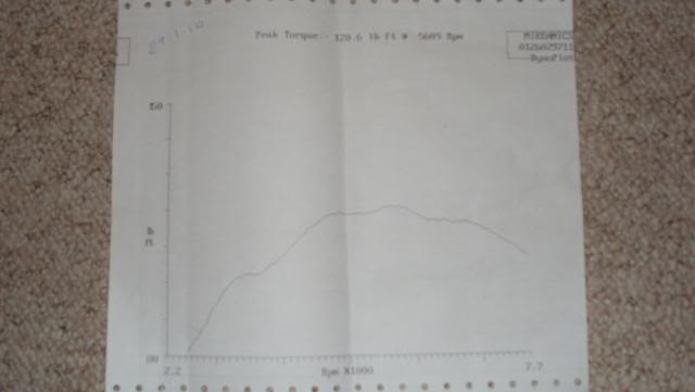

The graphs from today -
Couple of randomers from me, Riad and one from Ian...
This image has been resized. Click this bar to view the full image. The original image is sized 1024x620 and weights 263KB.
This image has been resized. Click this bar to view the full image. The original image is sized 1024x542 and weights 283KB.
