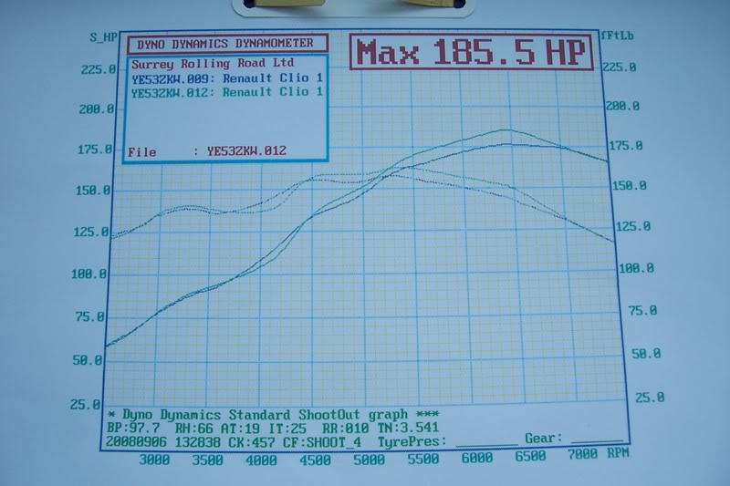

Rolling road proof - homemade Maxogen and no power steering = ?

Blue line was from January, green line from Saturday just gone. Shows a peak gain of about 10 bhp. Charlie (RR man) says he regularly sees about 7bhp coming back from losing power steering, so that would mean I got 3 bhp from my homemade 'Maxogen'.
Not bad, very happy.
185.5 bhp / 904 kgs = 205.2 bhp/ton :approve:

Mark, the look on your face when the rollers came out less after you'd messed with the filter was priceless !
Sorry mate, it had to be said ;) Trial & error all the way. At least you know that your set up works well :cool:

Aye...my ram-air effect CAF theory has been vindicated :approve:

Nope. Did 3 runs with CAF connected, then I took it off and turned the airbox to face behind the NS headlight.
What that did to the top end curve was very strange...and it was I think 3-4 bhp down compared to having it connected.
But then mine does pick up from behind the upper grill so gets a massive blast at speed (or from the f*** off huge fan they use at the RR).

Other mods were all on for the previous run...
R-Sport ECU
ITG panel filter in standard airbox
Yozzasport decat
K-tec stealth exhaust
That lot got me to 176bhp which was the last figure (blue line) then off came the steering pump/rack and on went the 'Maxogen' to give the latest figure (green line).
So according to Renault, each of those were worth 1bhp a pop hehe :)
