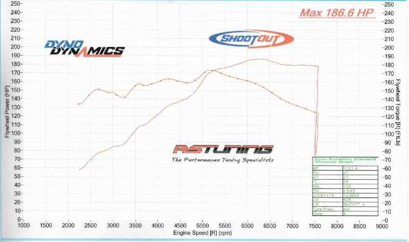

Here's mine on its old spec 4 years back running regrind cams, headwork, matched inlets and mapped up. Roughly about the same cost as a RS2 starting from scratch
I logged on the forum on my phone just to see the graph in the first post (I can't view the pics on my work's computer).
I want to call bullshit, that is a fantastic torque curve. Why do uprated engine mounts stop this fouling the rad?

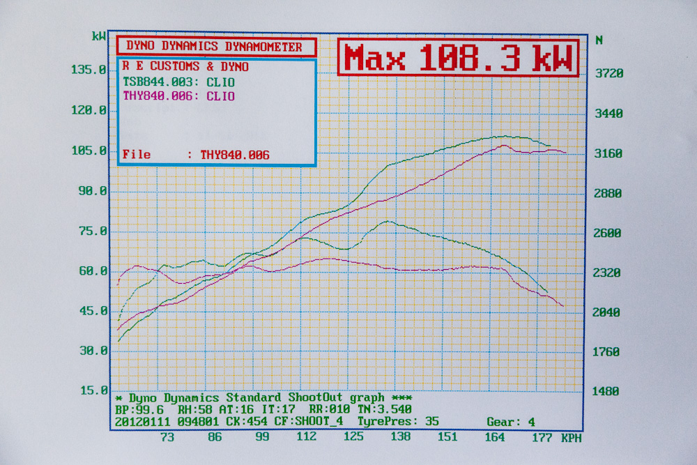

What you're looking at is a stock 182 (green line, 111.8 fwkw) vs my RS2'd 172 w/ 100 cell metal cat and K-Tec Supersport Recessed exhaust (red line, 108.3 fwkw)
Tuned by Henk. My car is pulling a whopping 1 kW at the wheel more than it was when stock and a cool 4 kW peak less than a stock 182 (and almost 15 kW in the midrange, awesome!)
Basically, my gains over the stock car are below 2900rpm and that's it! Also, I can assure you my cam timing is spot on. This car pulled 6.1 fwkw more than a similarly tuned 172 on the same dyno, same day, half a year ago.
Henk has said from the first data log that he can't see the manifold making any difference and that it was flowing *less* air than the stock manifold. The AFR on his stock fuel map was tipping into the 10.5:1 range at some points and sitting around 11:1 for most of the rev range!
Don't take this as a bashing post of the RS2, far from it. It's an amazing looking kit and sounds fantastic too... I just don't think it works on every car. I know there is more than one person on these forums who have gotten lower than expected results.
