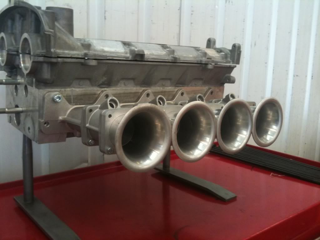

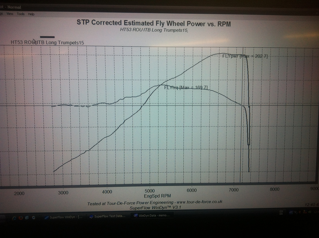

This is a bog standard 172 cup - freshly mapped on Jenveys with an Omex
It makes 202bhp and 169lb/ft
I agree the torque spread isn't as nice - it's all top end - which as you say is ideal on track but not great for a daily drive

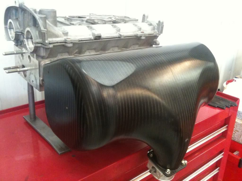

What's in the unduction sound anyway with the carbo plenum?
