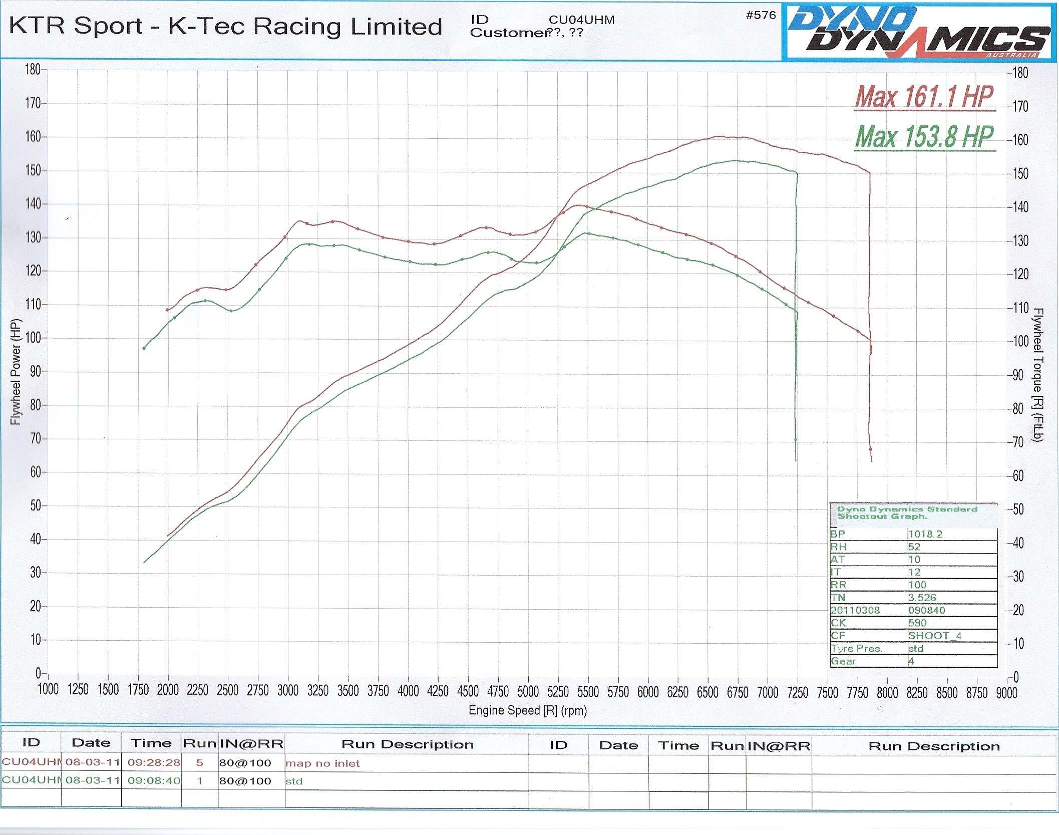

Virtually proving my point with that graph about you pommies and corrected flywheel power. 133 hp atw somehow translates into 187.3hp @ the engine? Please...

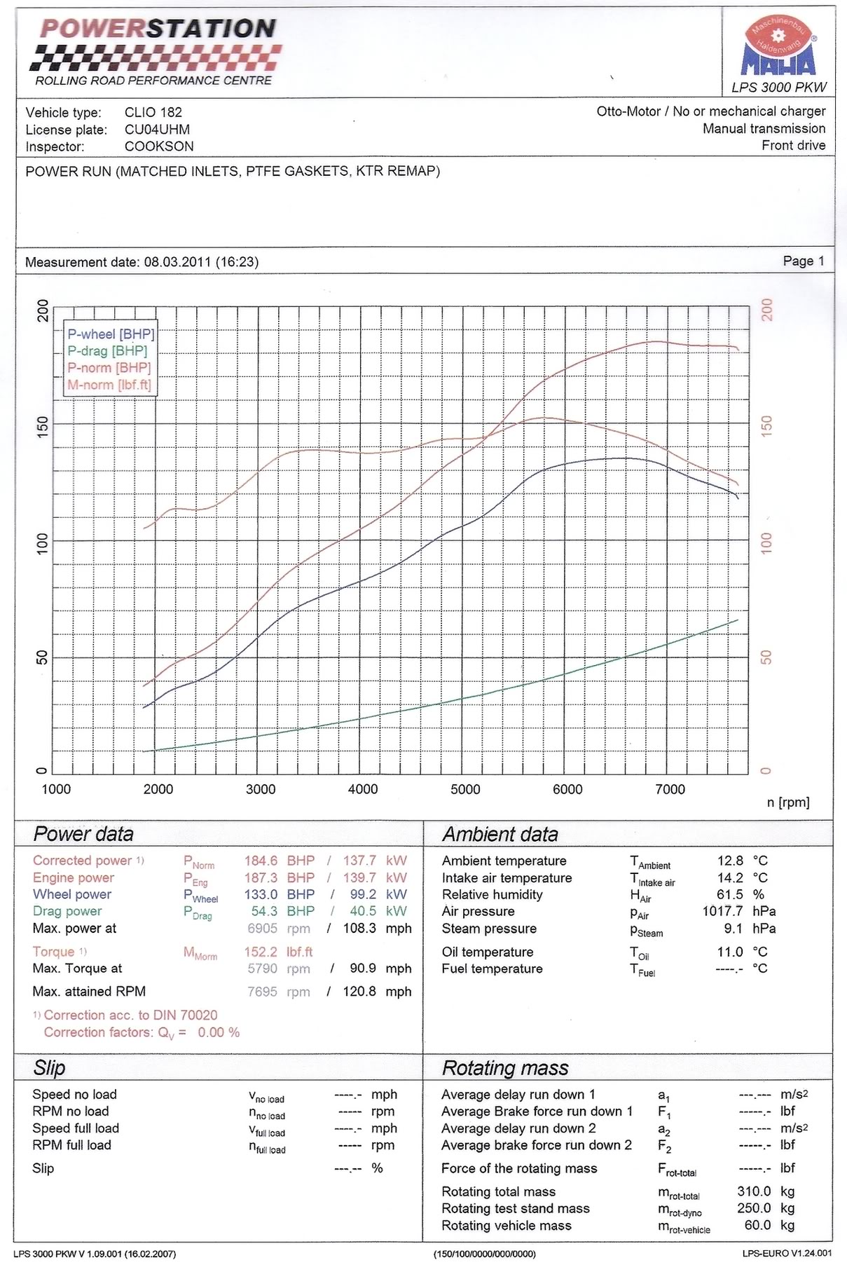

Just to clarify, Powerstations rollers are well known to be a long way off with flywheel - wheel hp correction
Irrelevant to the disucssion TBH when comparing 2 car on the same dyno, but I agree with you about some of the losses, total nonsense, and this is why it is SO pointless comparing cars from different dynos that dont work in the same way.
b****cks ok the there correction factor is a bit strange but the fact is the outcome does add up to a decent figure
Dyno lottery or you could use ktech rollers which is way out
This was taken before I went to power station
Why not post the graphs and ignore the figures, the graph isn't just for "pub-bragging", it tells a much bigger story.

Steve, just to add, it is always the atw figure that is down at powerstation - yours should be more along the lines of 140-145 bhp at the wheels :)

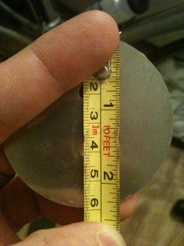

Have you seen the size of AT power throttle plates, about 42mm*28mm IIRC, total area smaller than the standard throttle body.
And you are STILL missing the fact that 4*48mm of which only ONE is being breathed through at a time isnt bigger than 1 60mm throttle.

People can **** power station off all they want I've always used them for everything I've owned and so have a lot of other
people as I said its dyno lottery shame they can't map clios as I would use them each to there own I suppose
The way they display wheels and flywheel figures is clearly very flawed, my mates escort cosworth apparently lost 200bhp in the transmission according to them, LOL
Doesnt mean their rollers are not still a useful tool for tuning though, they are, but just dont take any notice of the transmission losses or start trying to compare to other rolling roads.
