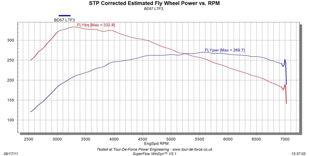

Looks to me like either you've got a mapping issue at 3200rpm, or your cam timing is wrong, not every car is going to give the lovely perfectly steady torque that -J- has got but you certainly shouldnt see a sharp dip of over 10lbft like you have there.
Torque is tailing off at the top end too far more than it normally would on an RS2, again, cam timing seems a likely suspect.
Shame you dont have a before graph as I think that would have the same issues if it is the cam timing for example.

Personally, id get the cam timing checked as well, might as well - only 50 quid or so, but removes that as the possibility of the power loss.
If thats fine, then get the mapped looked into i guess? Timing is easier to check than a map though - i would have thought?

Lots of things it could be, might even be something as simple as a dodgy plug which is breaking down at peak torque and really that should be the strongest part of the curve, lol.
Very hard to try and diagnose over the internet.
First place to go logically would be MWM as they map and fit on the RS2 often and work very closely with Stone Automotive (ie James from JMS's new company) and as such know more about the RS2 than anyone else really. But probably not convenient for you geographically!
Go to your nearest set of rollers and get a wideband reading taken through the rev range seems the simplest first step.

Overlayed with another RS2 car on my dyno this car makes 7lbft more at 2500 and only 4lbft less in the dip, everywhere else is pretty close. AFR is 12.5 at that point, same as the others we mapped. I also showed Tom and James how much a full AFR difference makes, which was not a lot! Judging by how the mani works with cams i'd suggest the intake cam is advanced a couple of degrees causing the extra torque and then the dip.
Also you need to remember that every car JMS tested as SRR ran more there compared to here.

It might not be that but looking at the stock graph it's quite possible. I always find they tend to make the same curve on the stock map they are going to end up with when mapped but with more all over....
TBH though you wont feel that on the road anyway, correct me if i'm wrong?

The trophy that this thread was on about altered by 1 AFR point and a couple of degrees of timing, and it gained 10lbft for almost the entire rev range, so while fuelling alone might not make a big difference, fuelling and a bit of timing together certainly does.
Like you say though, the slight extra peak before and the tail off at the top end, do look like advanced inlet cam timing than anything else.
This issue now of course is that if he has the cam timing corrected, it will then throw the map out if you have mapped it correctly based on incorrect cam timing.
As im sure you know, really every F4R should have it's timing checked before its ever mapped, but customers dont generally want to pay 100 quid or whatever just for someone to look at their cams and possibly not need to alter anything so I can see why you wouldnt insist on doing it as it would make you uncompetitive if you did.
Yes but if it's in the "sweet spot" it won't make much difference.
You can throw timing at them lower down and it does not do too much and unless you have corrected ALL the functions inside the ECU the car will never be the same on the road and it will more than likely knock it's tits off.

Its surprising how far out an engine needs to be before its really obvious when driving, rolling roads are a lot more detailed than any person feels generally.
That was directed to the owner of the Clio with the dip. a Dyno will highlight EVERYTHING and of course I know that
