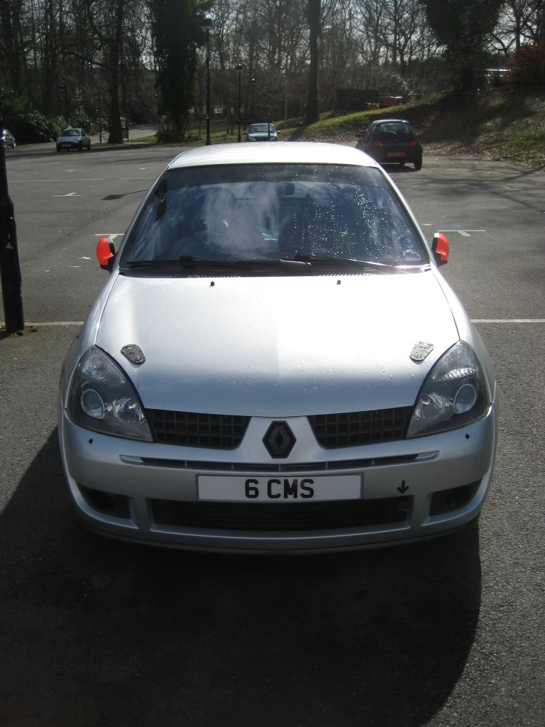

Crisp, not get wind noise without any interior mirror covers on? How do you adjust the mirrors? :/

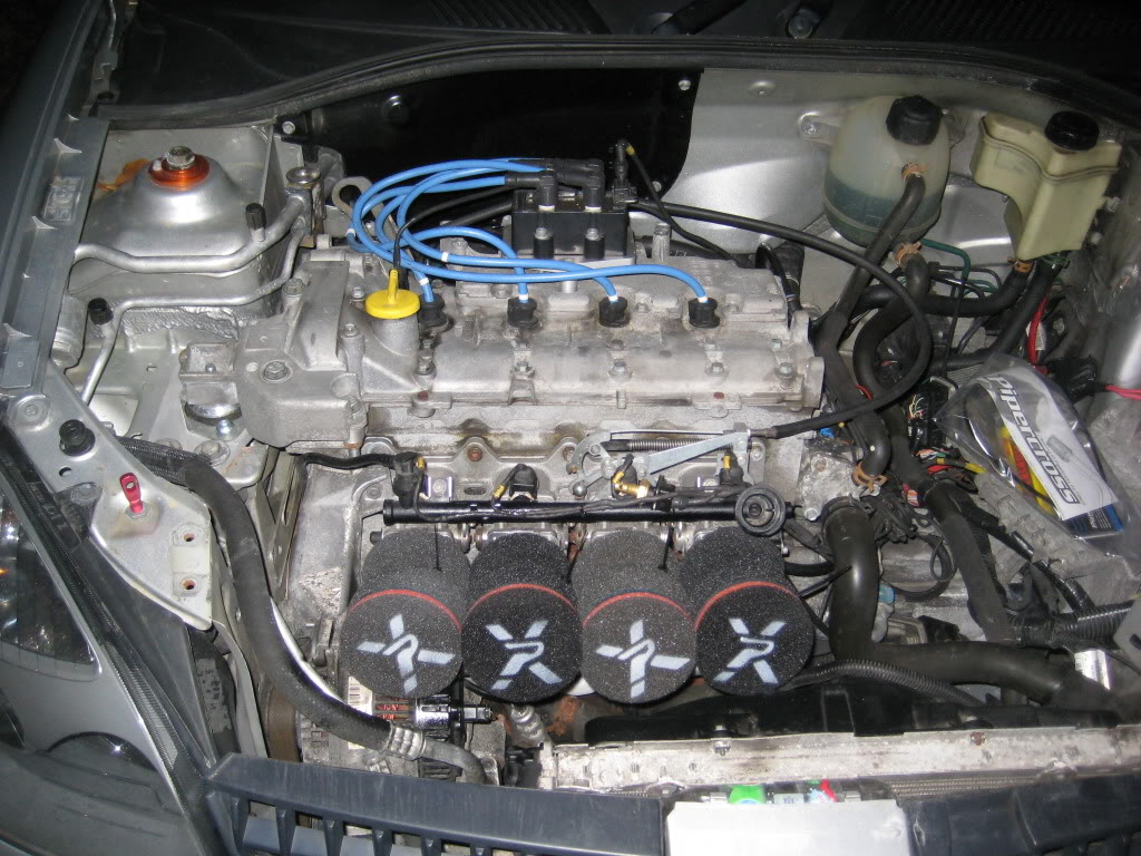

nice! B Road drive with bonnet off ??
One video was a B Road Drive with the camera on the front of the car. The other video is just a drive in the car part with the bonnet off to see the engine movment.

Are both you boys happy with your ITBS? Worth losing the trip computer/CC etc for?
Theres more positives than negatives.

Think I will be ringing KTEC within the next couple of months :O f**k it!
Re: One Year on & £**** spent
You won't miss the trip computer or cruise control. You'll enjoy the noise at WOT too much to care.
I miss my cruse control a little, I actually used it when travling up and down the country going back home. But you will deffently love the ITB's when they are on. Everything is amazing.
Blimey if that's all you're worried about the Gen90 is right up your ally :)
tbh I wouldn't go back to the standard engine
Nope me nither.

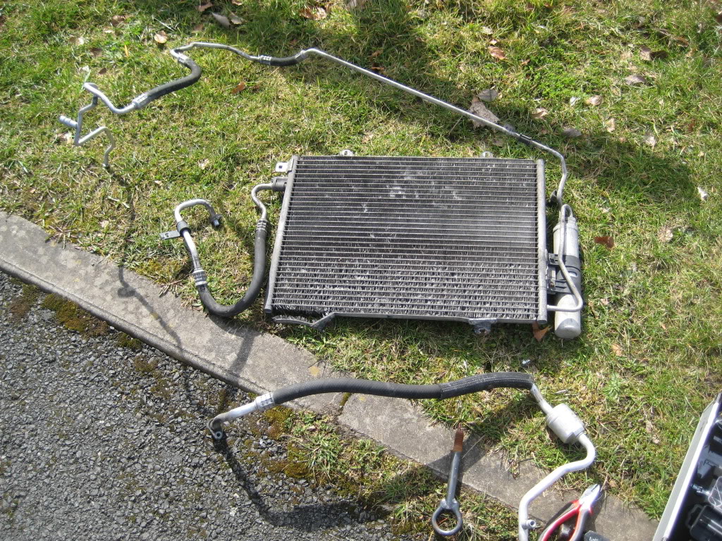

Update AC Removal
I've recently become a man and decided that AC is for girls. So its coming out.
I havnt yet got all the brackets so i can remove the pump but that will be sorted soon.

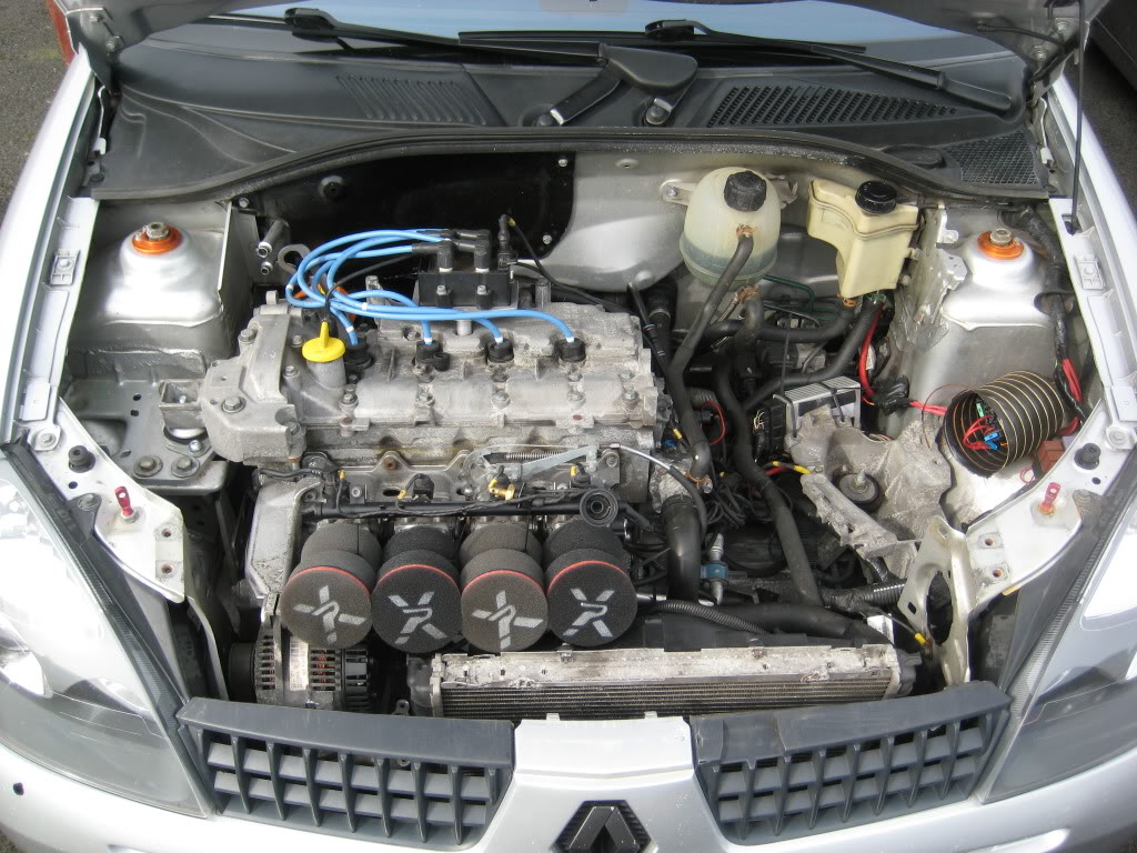

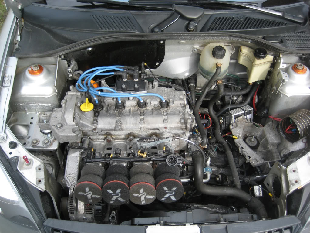

Started with this, lots of tubes on the left and the mini radiator thing infront of the actuall radiator. The radiator is as far forward as it will go and it has allways bothered me that the heat it pumps out is right next to the trumpets.
One of the pipes had a small hole in so all the lovely gass had seeped into the o-zone layer a while back so when i removed them no de-gassing needed to take place.
Pipes and small rad thing removed.
Here are the bits of weight saving
Now i cable tied the radiator out of the way and because the AC bits wernt there i could move it further away from the ITB's. Just waiting on some Nimbus Motorsport Heat shielding from a good friend (if he gets his finger out of his a*ss :rasp: ) and it will look much better.

I presume you're going to remove the air con compressor and get the cup alternator / aux belt setup as well? The compressors are very heavy. I picked the one up in K-Tec's reception and was shocked at how heavy it is - much more so than the one from my old 306.
Yep the AC compressor/pump will be coming out, just thought i'd start it today as i had my tools in the car :)

If you can find a base model Clio you can grab the blower to loose the big aircon unit under the scuttle panel (saves a further 2kg) and also get the full metal cover where the aircon pipes go through :)

good job mate, looks like your condenser is as fooked as mine, you could blow it and it'd fall apart
Yeah you can see at the bottom of it that it just fell apart when i took it off.
Does your car run cooler now that it doesnt have the condenser sat infront of the rad? I know you have the new rad but with mine when i'm driving along the engine temp gauge now sits lower than it used to.
When i get it some stick it goes back up but then after crusing for a little bit the temp drops again! Think its fine.

Yeah its like a snail shape, you'll know when you see one, super light compared to the aircon crap ;)

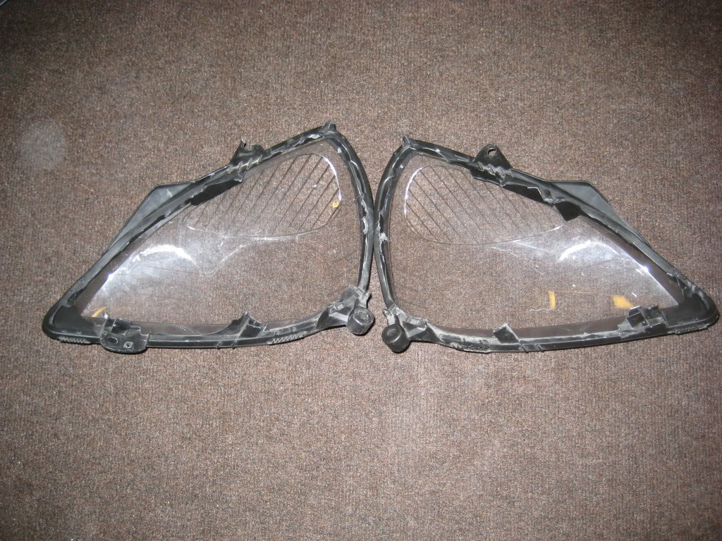

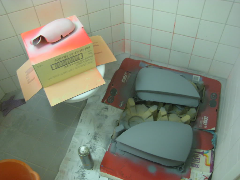

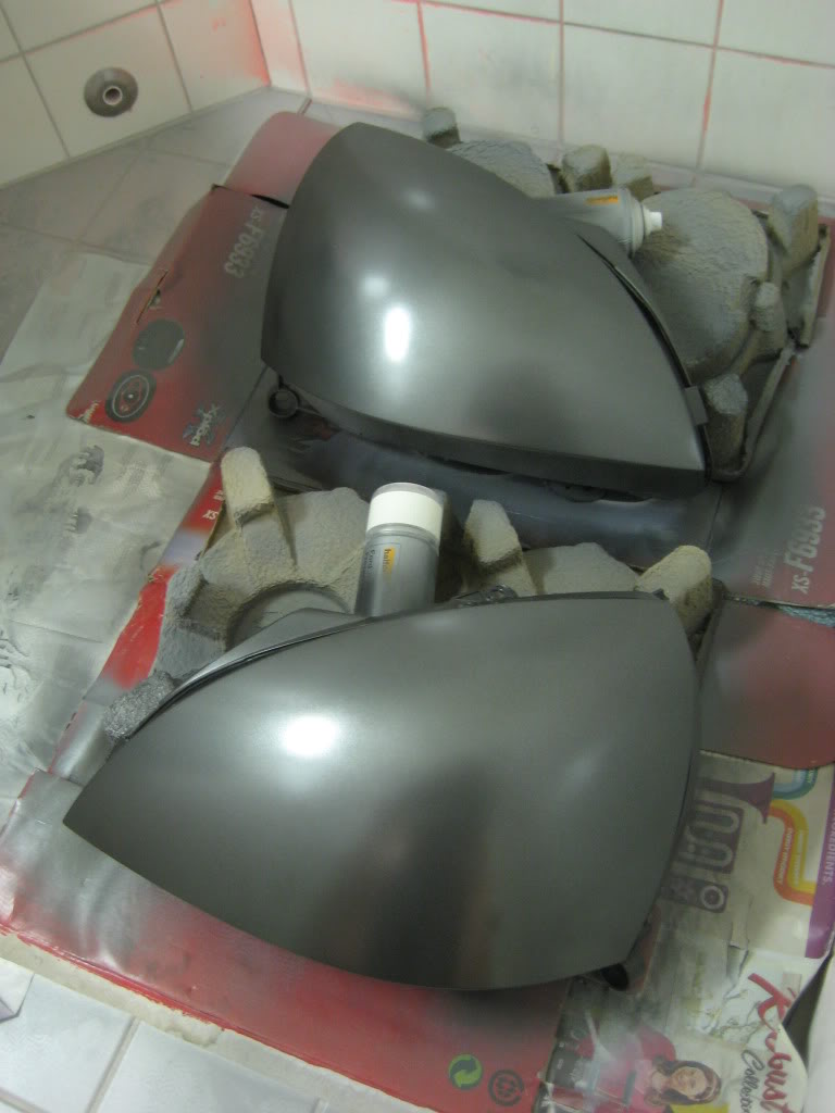

Update - Cup Racer Lights

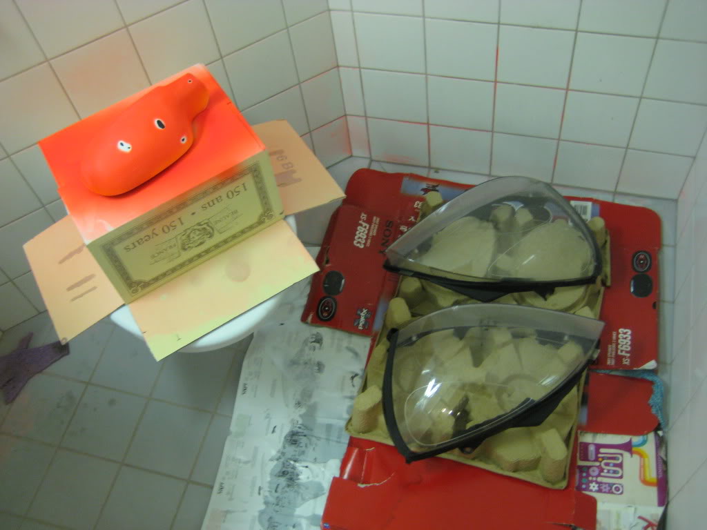

A little while back in this thread i bought some tatty lights with the intentions of making them into a cup racer type lights.
I gutted them so i was just left with the outer plastic frame.
In the flat's spray booth
Bit of primer
Bit of Ford Graphit Grey
And then sprayed a bit of clear coat to make them look a bit nicer.
So here are the old lights, really heavy xeons
New ligthweight lights

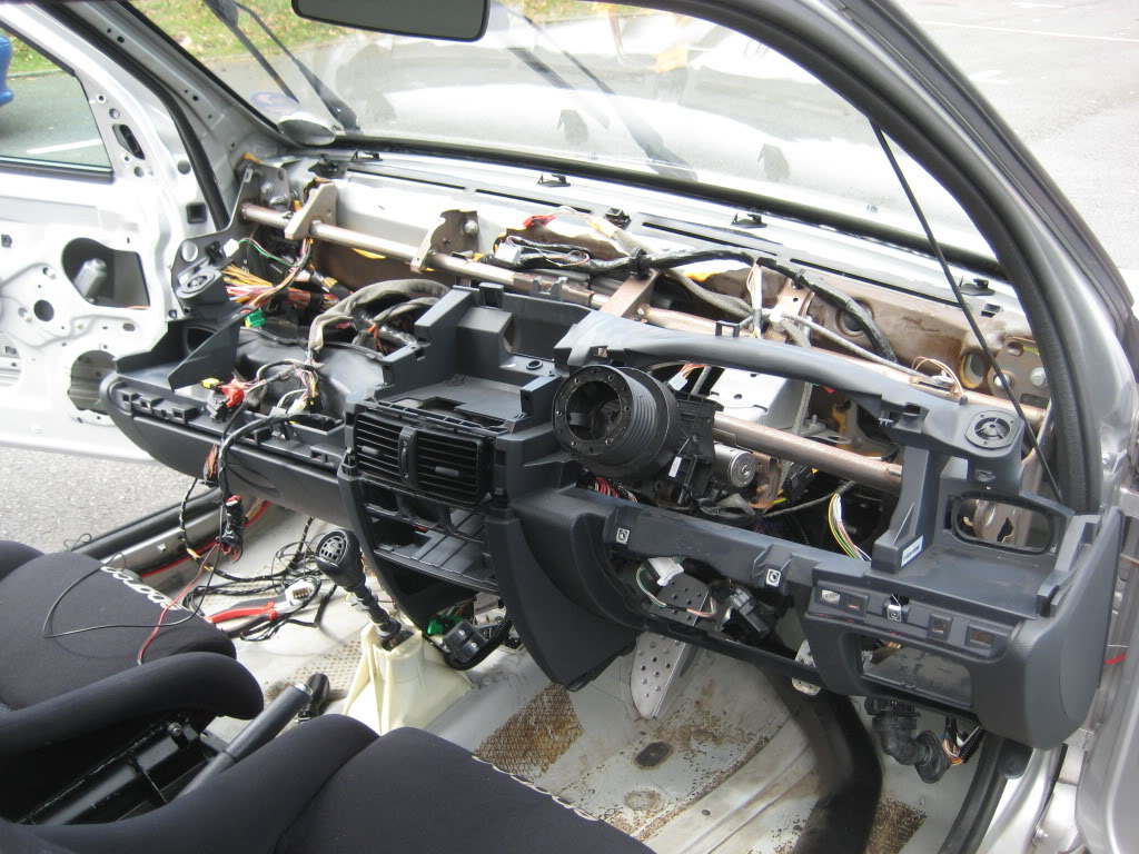

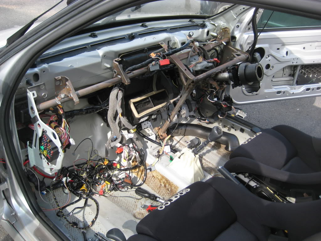

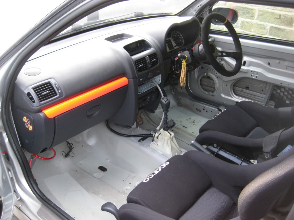

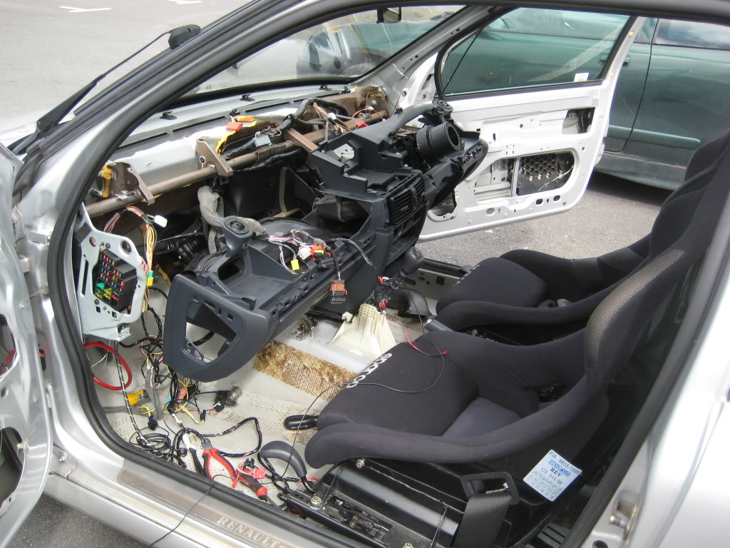

Decided to pull all the dash out so i can get the rest of the brown sound deadening out.
then started to put it back in and then got bored so this is how the car looks lol
Saved quite a bit of weight :)

Looking mint mate, very posh having a spray booth in your flat lol :P
nice lights :)
i'm guessing they don't actually work though so you'll have to keep swapping the lights in between track days and road use?
Are you gonna need to remove the bumper every time you want to change them dude?
Its in the posh part of Huddersfield
nice lights :)
yeah i'll be swapping them when i get to trackdays.
My bumper comes off really quickly. Only took me 5 mins to remove the xeons and put the new covers on :)

looks good mate. half my dash is missing at the moment and need to get round to removing whats behind

nice booth ;) To answer your question it does run cooler without the condenser in the way yes

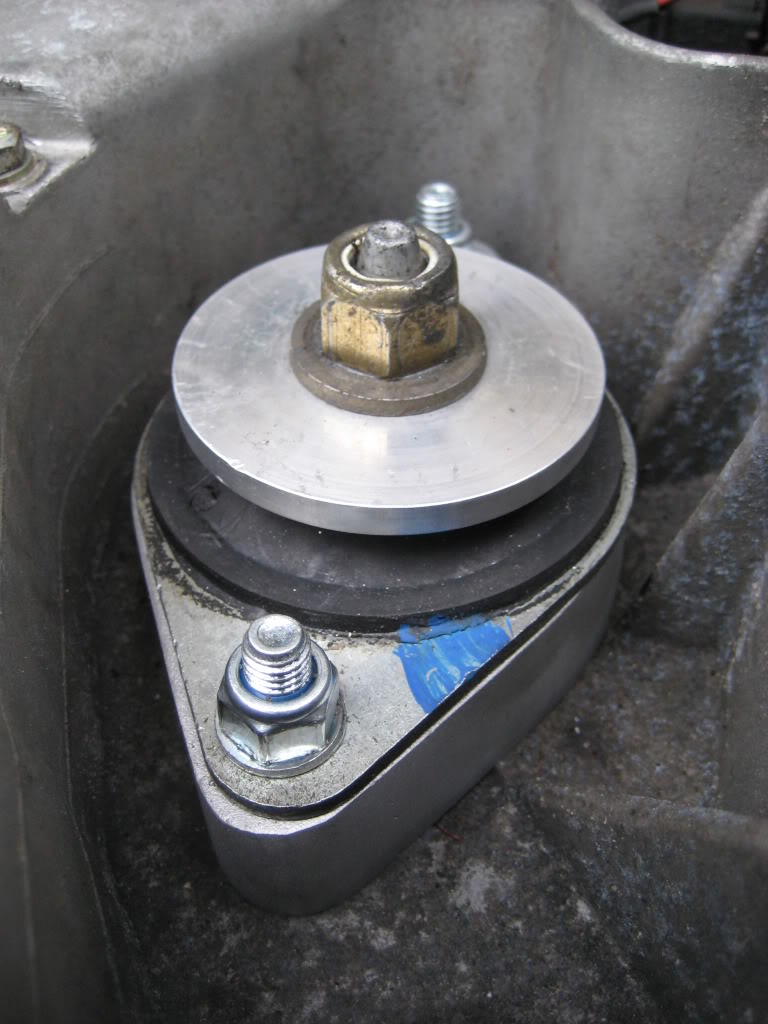

So i ordered K-tec Racing's uprated Gearbox mount and found through a little it of digger around i found out that the batch had been machined incorrectly. The top hat was too tall so i went to teh work shop and bashed it in the lath and took 4 mm off so i could fit it. Its still not perfect as the bolt is too big but hopefully i'l be getting a new top hat anyway from vibratechniques and a new bolt.
Here's the new mount with the rubbish bolt as the nyloc doesnt get touched.

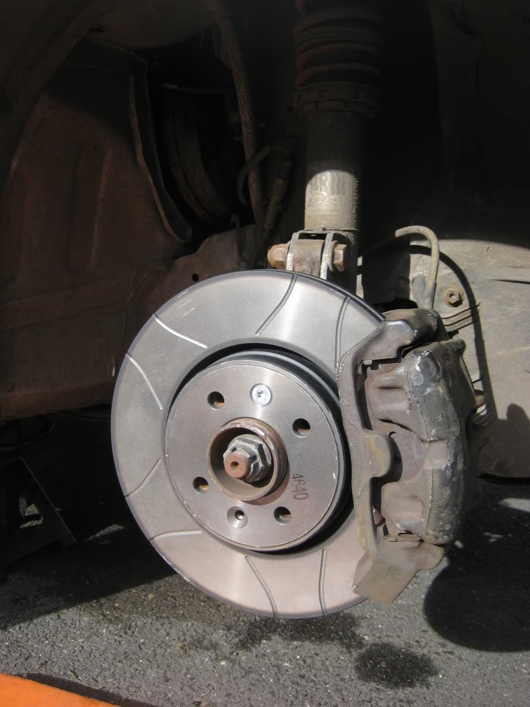

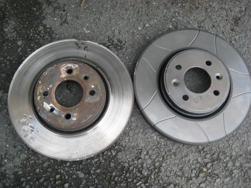

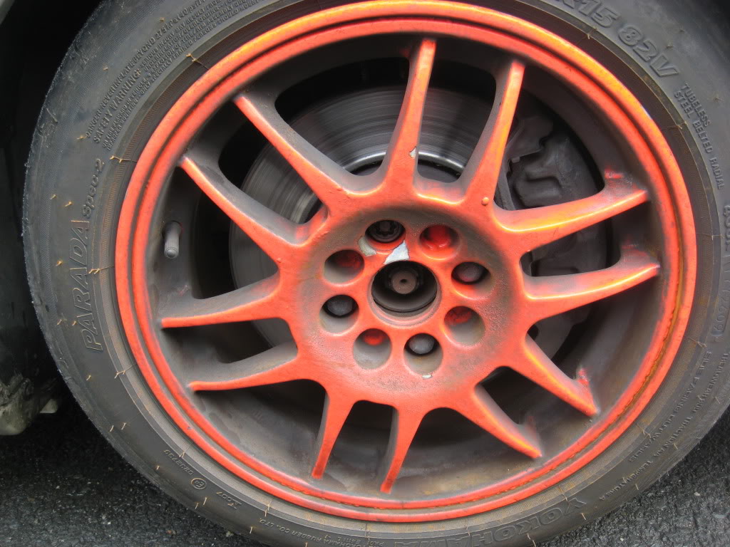

Anyway todays efforts were just changing my front discs as the grooves had gone a long time ago :S
My fully mullered wheels and my old groovless Brembo Max's

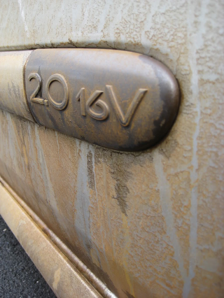

After the discs wearing low it started to make the paint down the side of the car very rusty.
Old Vs New
I gave all the brakes a much needed bleed after fitting everything back together and they feel much much better :)
Also got rid of all the glue from the removal of the tar ages ago.

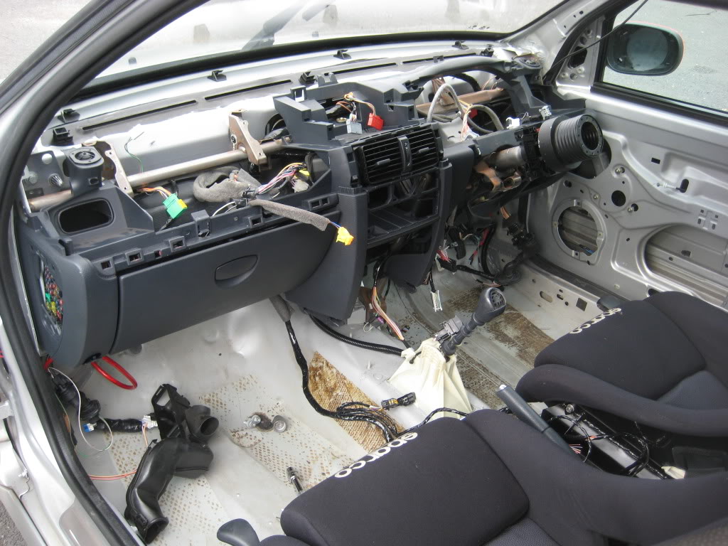

Lookes much neater now so i'm a little happier about the interiour.
So now its ready for the Cage to go in and then i can get it sprayed :)

How long to get the dash in/out dude?
Bit odd seeing the car park near enought empty in the above bits!
Can't wait to see the cage in and sprayed etc dude, will be cracking.

LOL at the grinder marks all over the old disc, dont you just love them torx retaining screws?
Cheese retaining screws?
I need to speak to yo about these lights dude. You saw round the backing to leave the clips on them but have the front part on at the same time?
I snaped two cheap torx pieces then mullered a drill bit so got pissed off so i got the angle grinder out and a big hammer lol
I actually just bashed the sh*t out of the back with a hammer and the back bits just broke off. I have left all the mounting points allthough when i trial fitted them the other day i only really needed to put the top bolt in to hold it is place.

Shame about the problems with the gearbox mount! I must have been lucky with mine, as only got it a couple of weeks before yourself and there was no problem at all; I'm assuming mine must have been from a different batch :)
