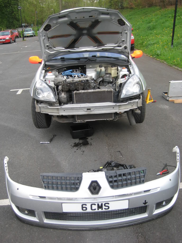

First thing to do was an oil change. MY firend got me some discounted Race Oil so i did that the other day whilst fitting my Oil cooler

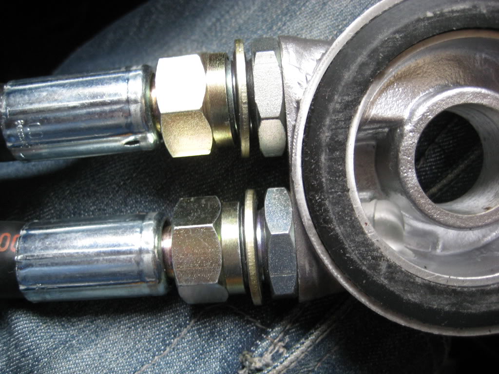

Upon fitting my oil cooler i noticed that the pipes didnt meet the thermostate washer! Can anyone tell me if it matters that the pipes dont meet the washer? It was done up nice and tight but didnt look right

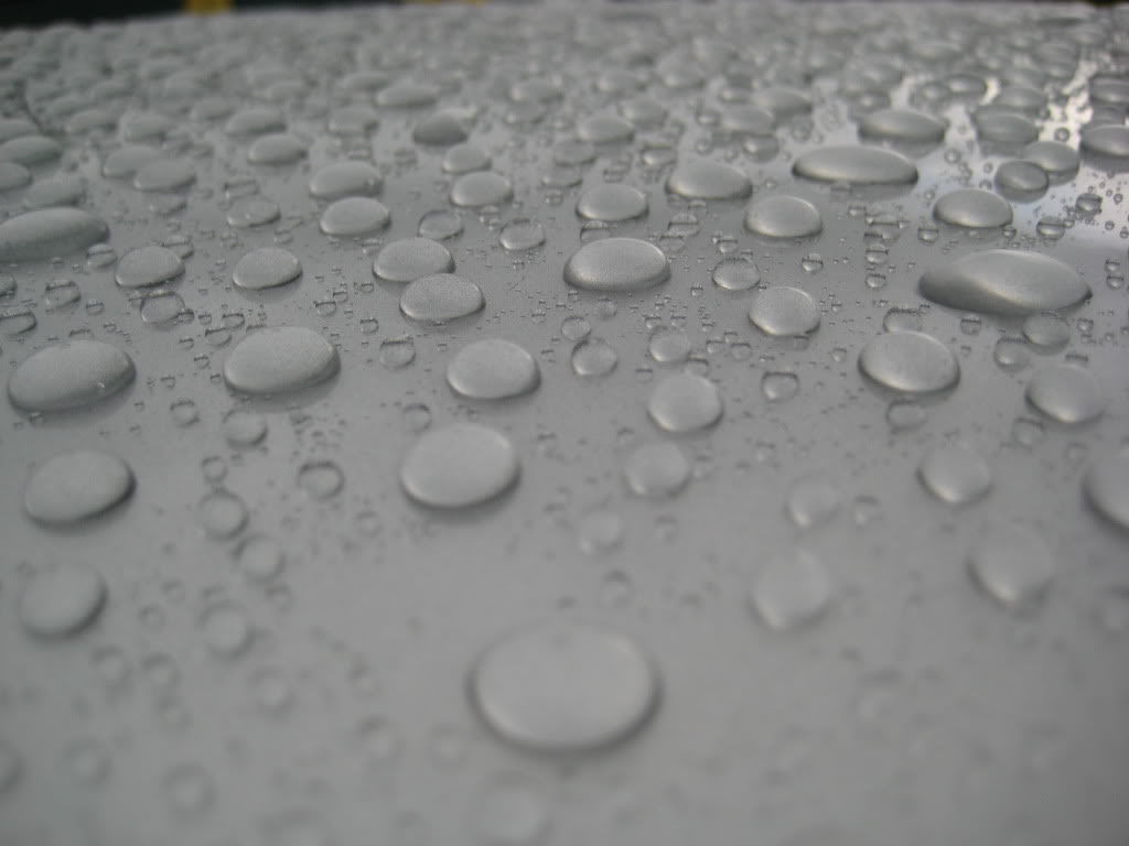

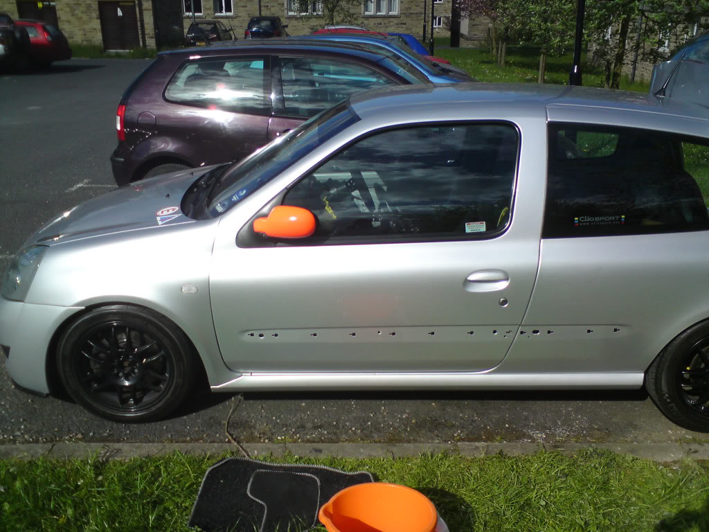

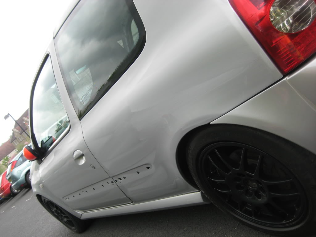

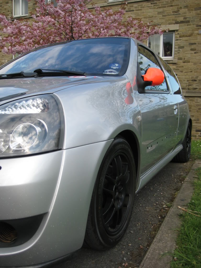

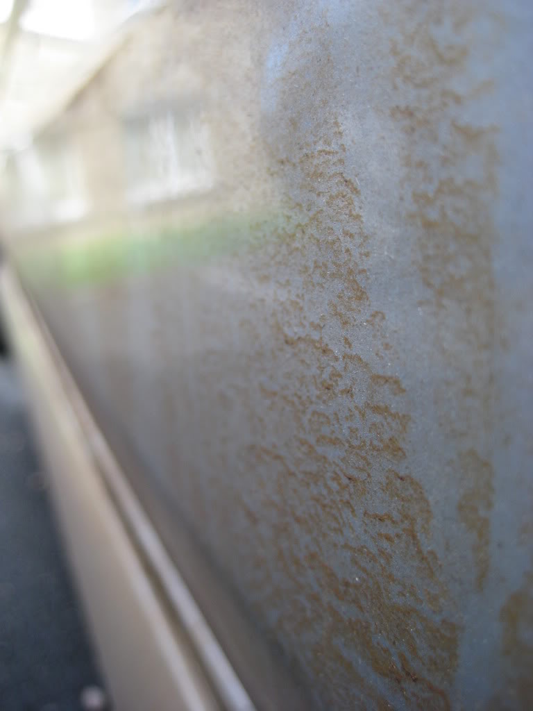

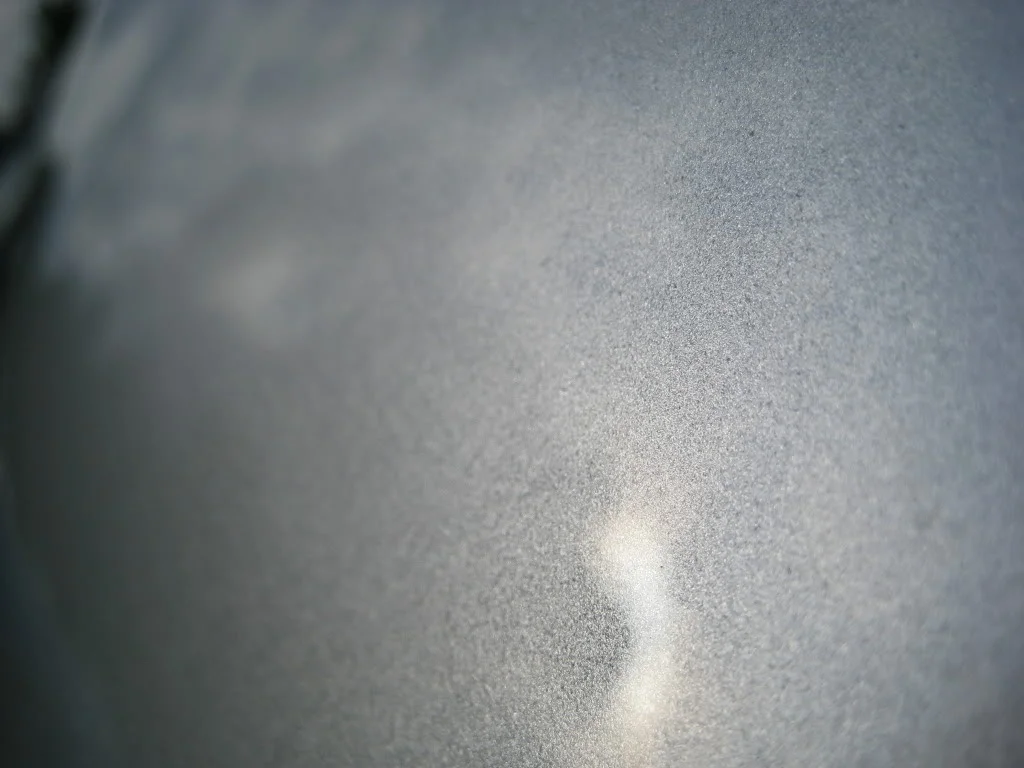

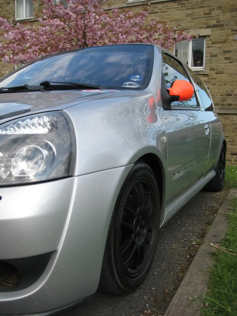

The winter had been very very harsh on the paint and with the car running Carbone Lorraine pads and the salt on the road meant the brake dust would not wash off. Even with wheel cleaner on the paint work it didnt come off.

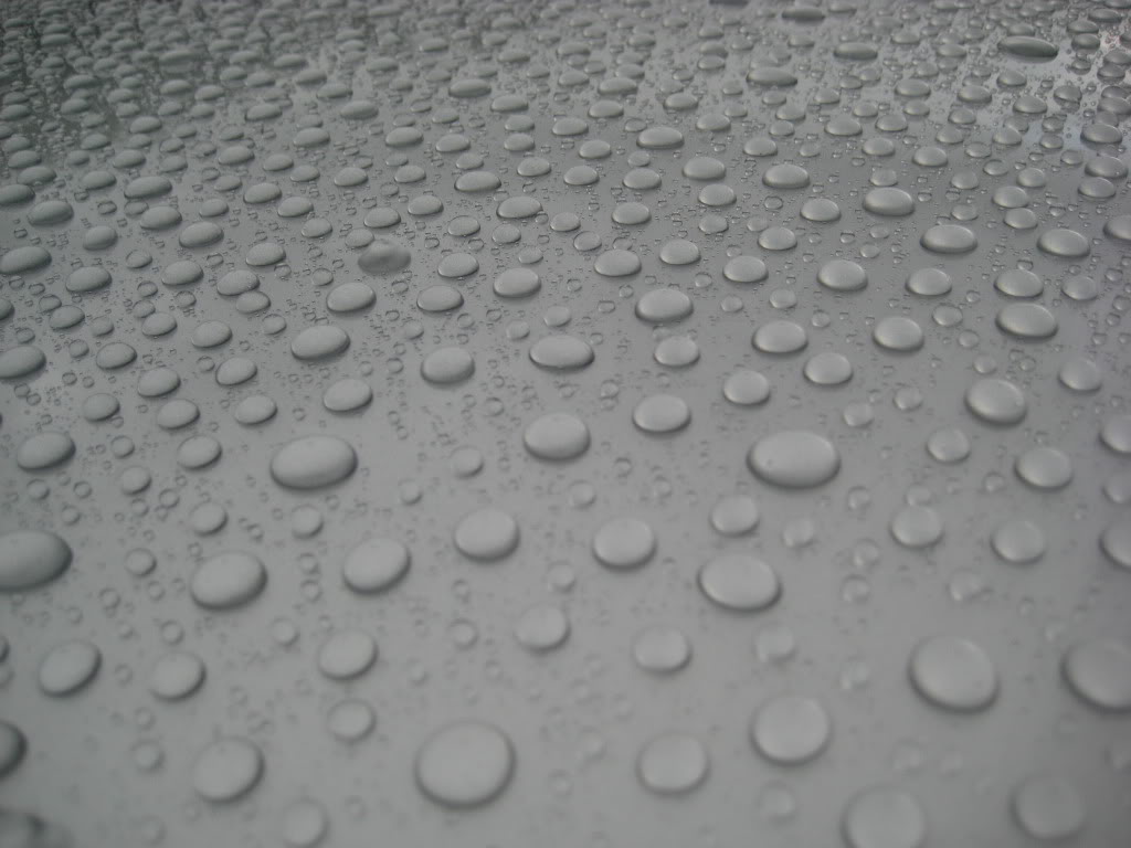

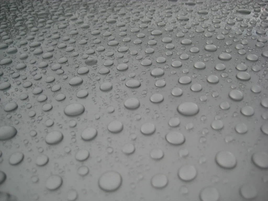

So i decided to get my OCD back for a few days and spent 3-4 days claying, polishing, sealing and waxing the sh*t out of her and she is back to how she use to look like when i bought her.
Pitcures dont really do it justice but....
Bit of beadage

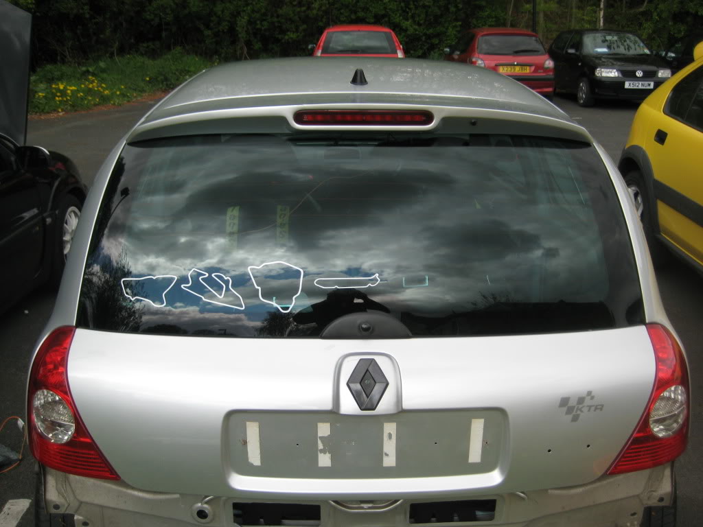

So now the car was clean i put my circuit stickers i got from F0xy (cheers mate)
The stickers are a little bigger than i thought but he did give me dimentions so its my fault.
Before
After
I'm quite pleased with them, I'll have to buy new ones when my Poly windows come but that wont be for a few months.

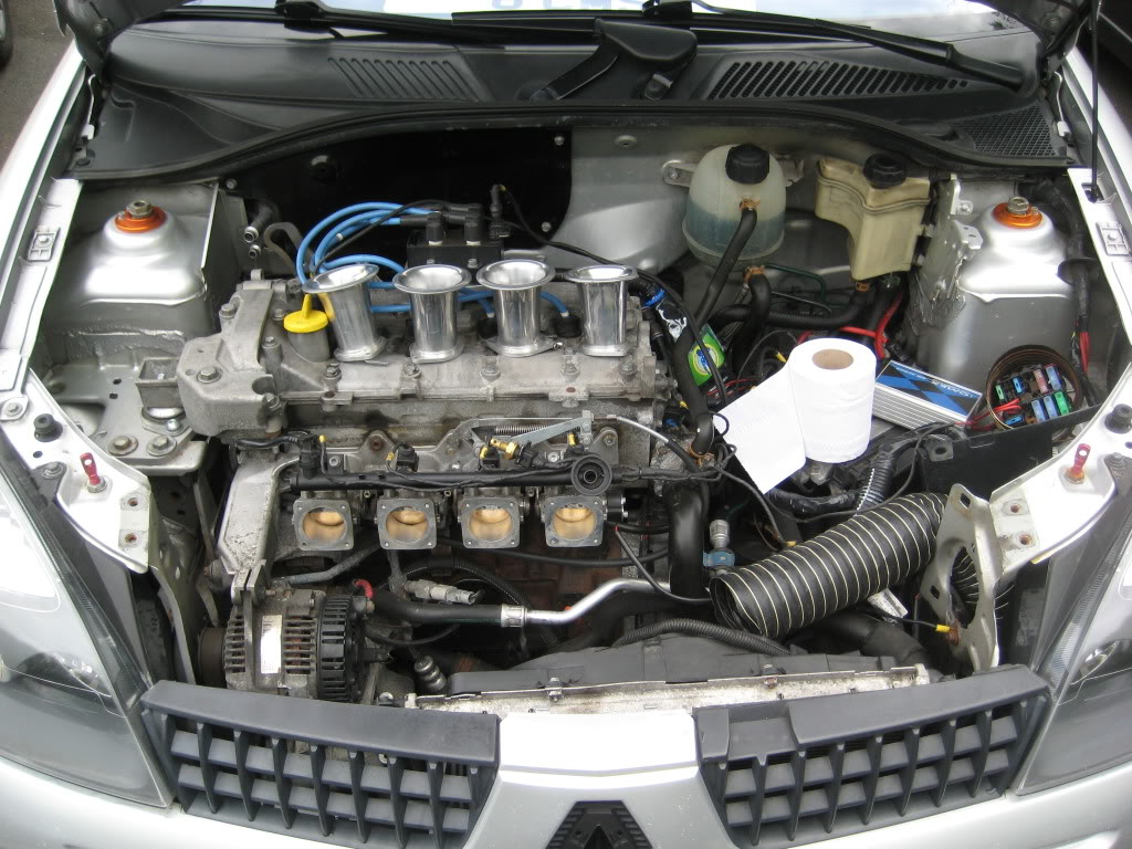

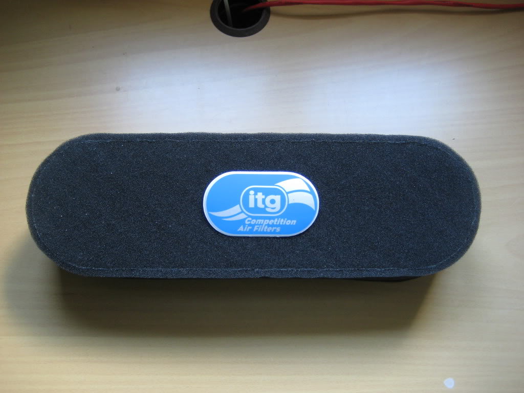

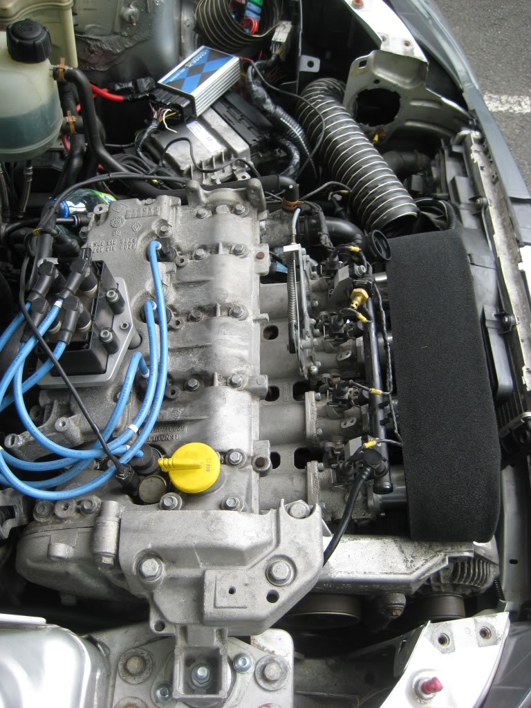

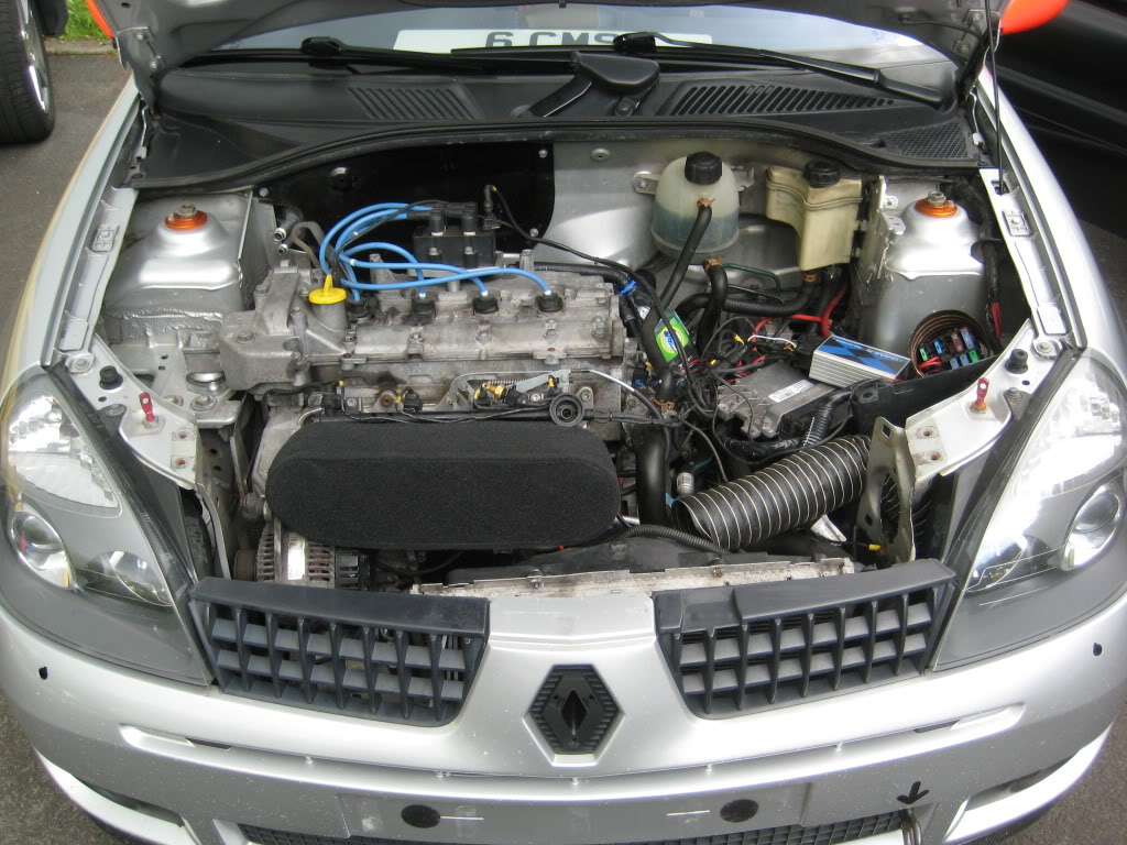

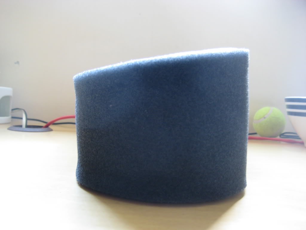

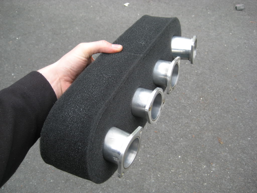

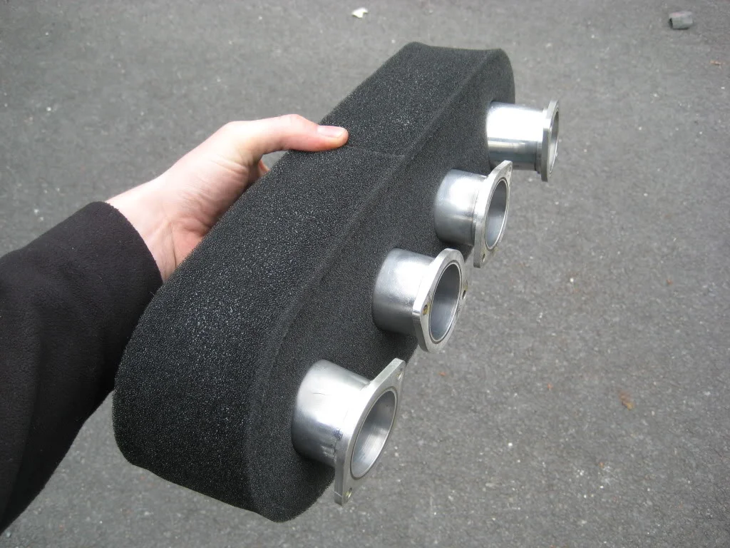

As i pulled the socks off for the RR day it was time to fit my New filter that K-tec sent me as a replacement for the first one. Its much much much better than the Pipercross one. The new filter is by ITG and everything about it is better than the first one i had
So good work K-tec and ITG
Bit of a taper which the old one didnt have

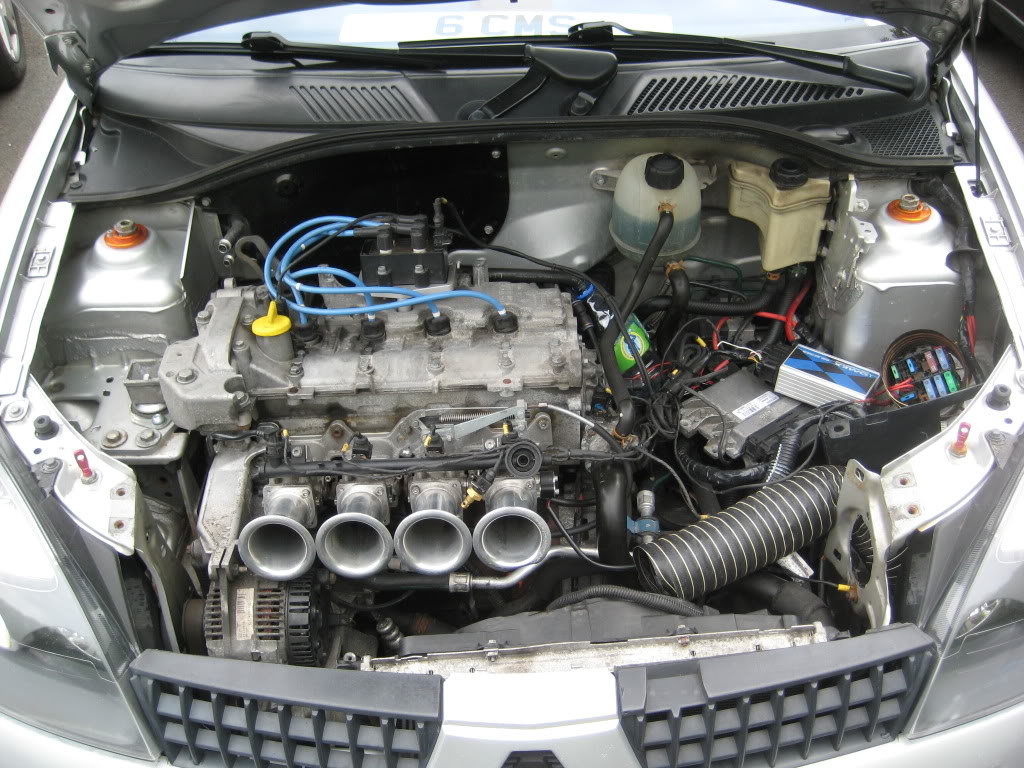

I noticed that down the trumpets there was quite a bit of grease/dirt
So i pulled the trumpets off and gave the ITB's a clean and the trumpets too

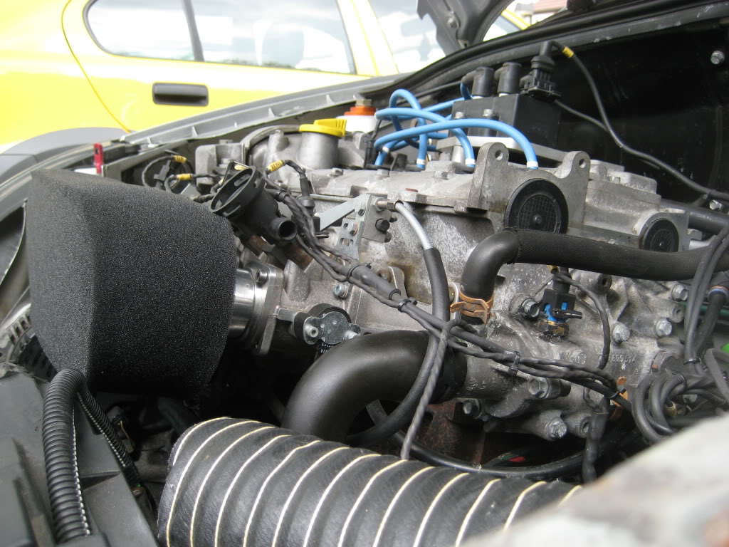

With the new filter you have to stretch the filter over the trumpets first
Then you have to fit the trumpets to the ITB's. I'll be honest and say its quite a ball ache but i'm sure the new filter is easier to fit that the last one. But maybe thats because i know know what to do and the fact i now dont have AC and bits.
Bit of a shame the filter is bare and has no name on the front like ITG or KTR or anything but function over fashion i suppose.

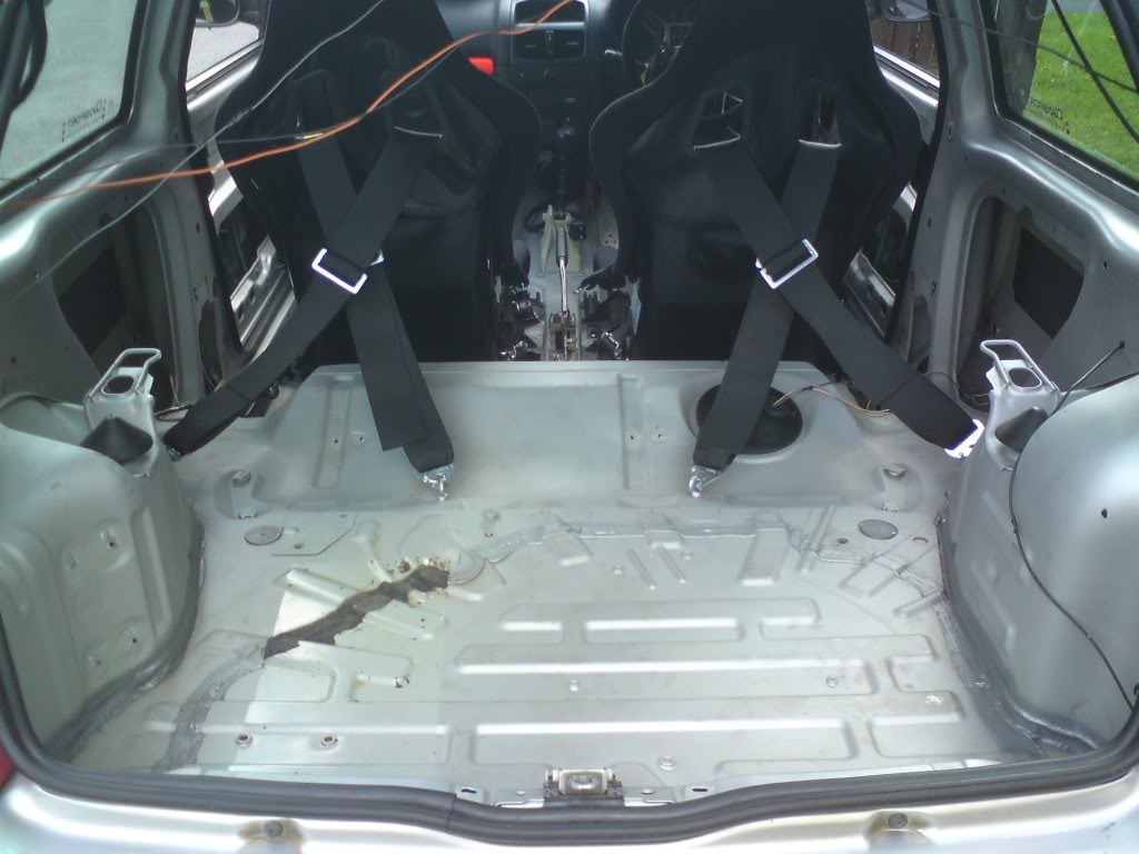

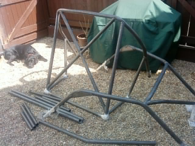

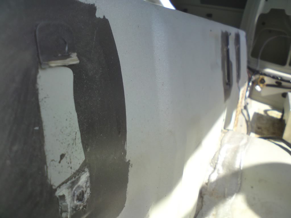

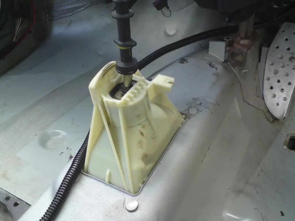

That basically it for now, i'm still trying to find a local metal fabricator to make me some gussets for my cage which came on Monday
Bad quality phone picture as its at my mates house and not in my flat.
So we'r going to be welding in the cage in a few weeks and i've decided to have the interiour sprayed in Titanium and the cage sprayed Black.
