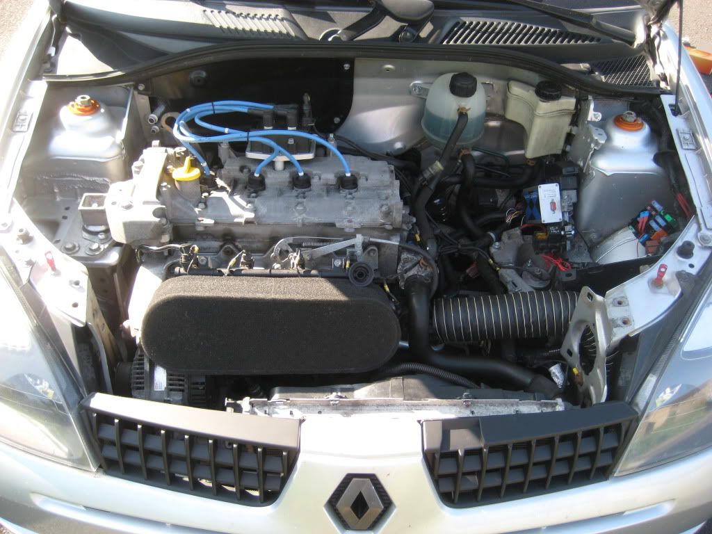

Right, well the last week or two has been quite scary and nerve-racking.
The problems started when I took the car to RS Tuning for the RR Meet. The car kept cutting out at 6,500rpm on the Dyno and then wouldn’t start and then randomly after random fiddling with bits and bobs the engine would then start when the key was turned.
The initial thought from a few people was that the jerks and loss in power was because of detonation and that the map was to blame. But also there could have been a problem with the Loom.

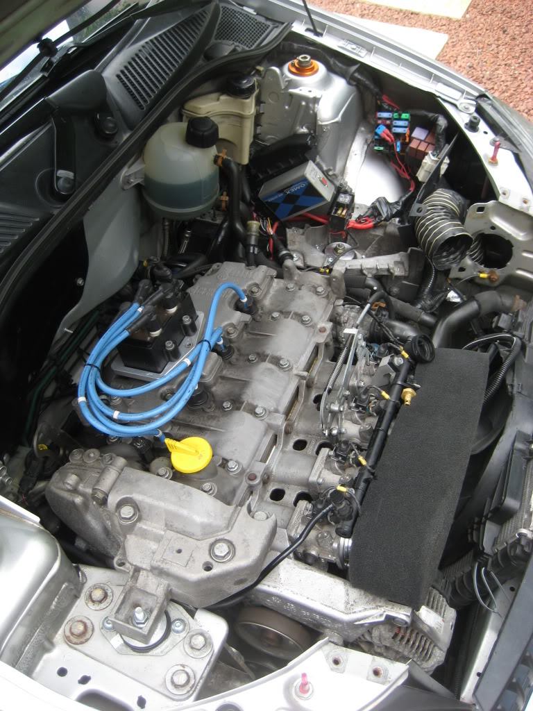

I took the Omex loom out and had a good look at all the connections and I couldn’t see anything wrong. So I made sure every connection was clean and put it all back together. It started straight away and took it for a nice country thrashing. It was revving all the way to the top of the rev range and everything was fine until I decided to turn around and come back. The car then spluttered at 6,500rpm again. And then was spluttering all the time.
Shortly after this had happened the decition was made to get it back to K-tec 253miles away. I phoned the RAC and asked if they would be able to tow me to the garage I wanted with the policy I had, they said yes. So the next day the RAC man turned up at the time I had booked it for and when he asked where I wanted taking, he then used every excuse he could think of to get out of taking me. Bit of a wa**er really.
Anyway, I phoned K-tec and they told me not to worry and that they would sort it out. The next day K-tec picked my car up and gave me their little Renault Twingo GT. Great little car, all the little K-tec bits on it are really good.
Anyway, a few days later I found out my car was all fixed, I was expecting them to tell me I needed a New Omex ECU or an engine rebuild. But no it was just a loose connection from one of the wires in the end of the loom, the block connector which connects to the ECU.
So the K-tec team fixed that loose connection, tidied the loom back up much much better that I could have and put the car on the dyno to 100% make sure it was all running as it should do. And it was which I am obviously happy about.
So once again I just want say a big thank you to Andy and David for picking the car up and to everyone who was so helpful and played their part in getting my car looking and running nicely.
I just can’t fault K-tec at all. Always happy to help and the products they sell are really great. The mapping that Andy originally did on the car is great and it’s such a joy to drive.

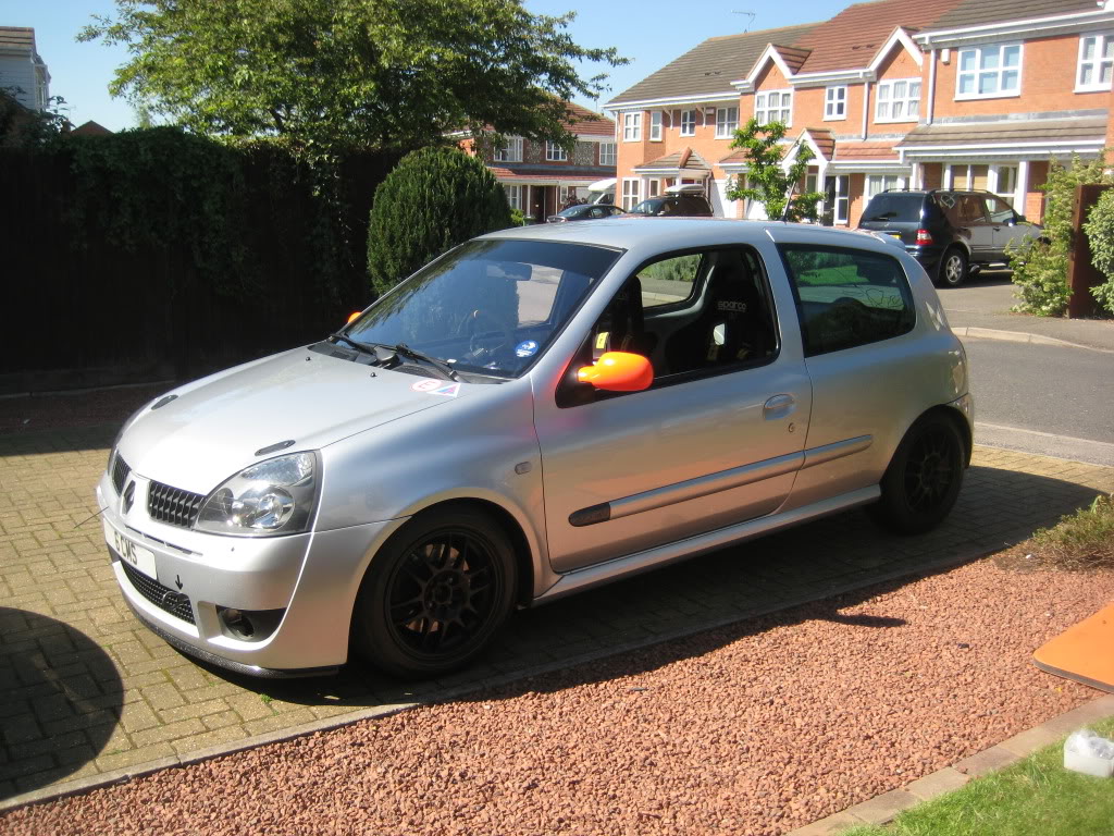

Anyway now the car is back at home I decided to give it a wash

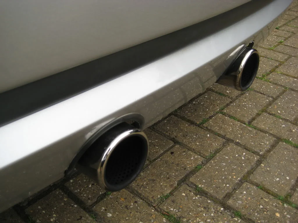

Gave the exhaust a little bit of autosol to

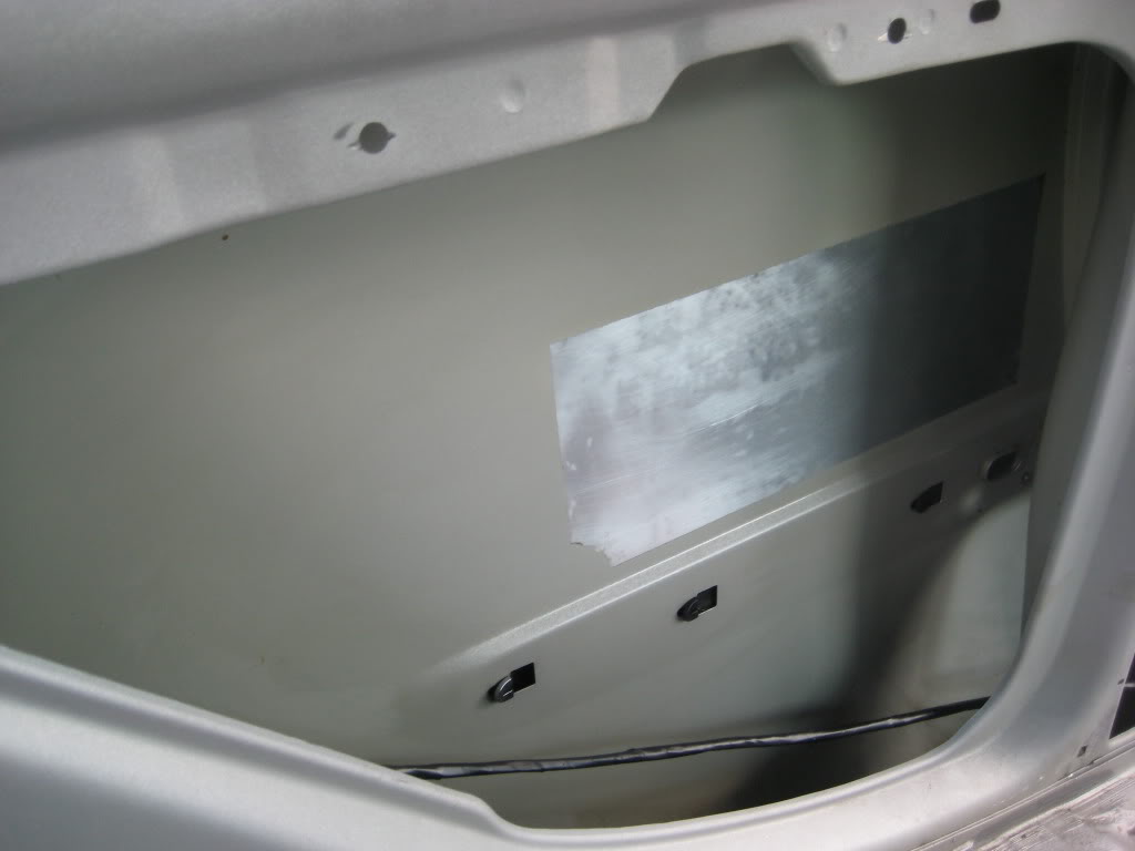

I had to get a few little jobs out of the way as the cage it going in at the end of this week or the begining of next week.

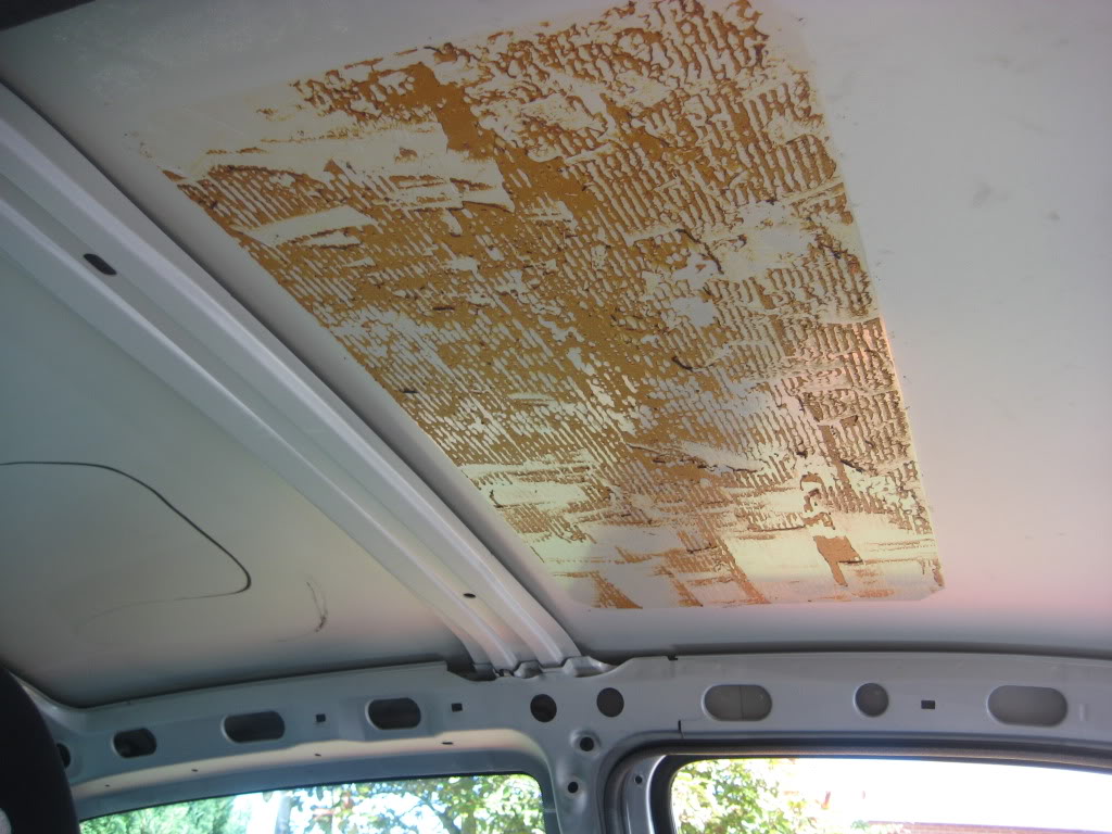

So i borrowed my sisters hairdryer and chose to get the rest of the tar out.
The huge bit of the roof
and the two bits on the 1/4 pannels
I had left my white sprit at my flat so the glue will have to stay on for now.

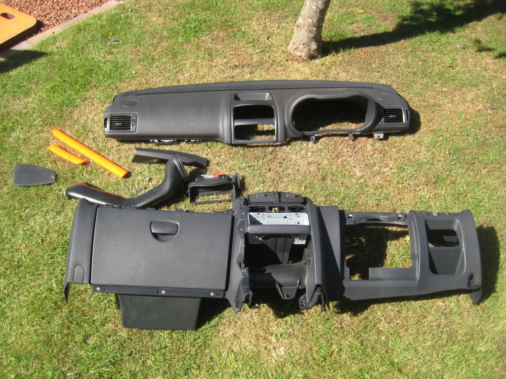

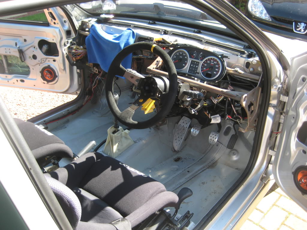

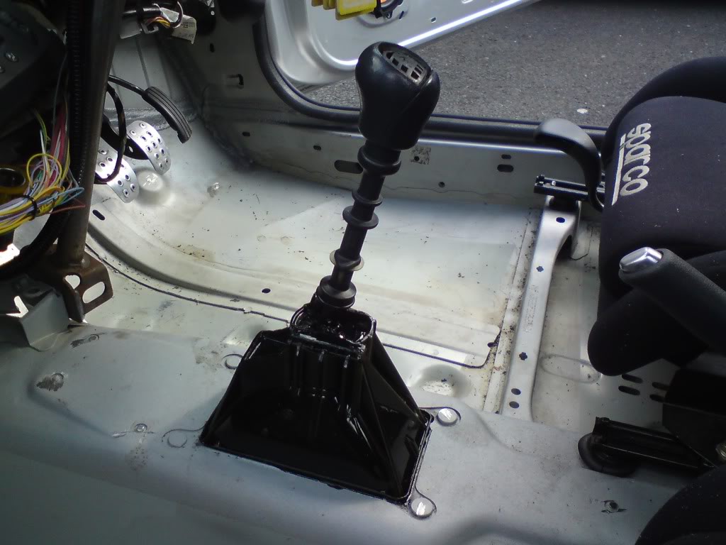

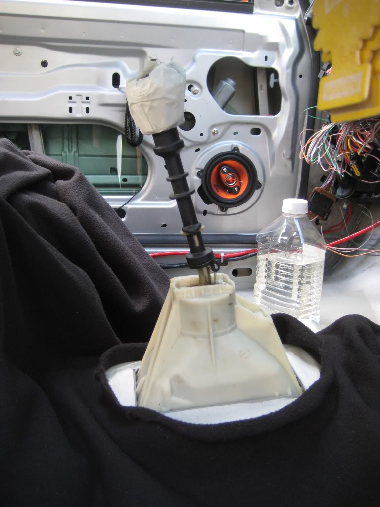

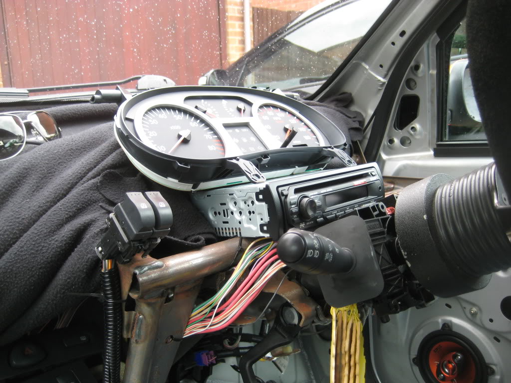

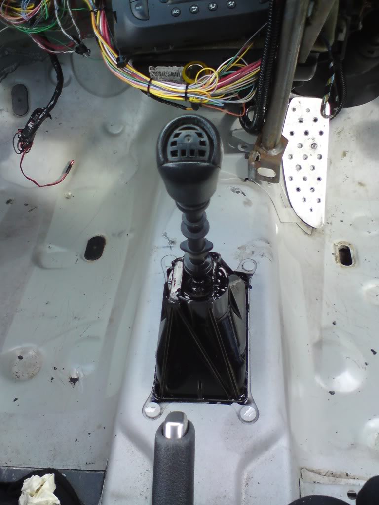

As the cage follows the A-Pillars down through the dash i removed it now so i have less stuff to do on the days of doing the cage.
So dash out
and then set about getting rid of more of the loom
I managed to get a big carryer bag full of loom and everything still works apart from the Hazzards so i'll have to find a way to fix that :S:dapprove:

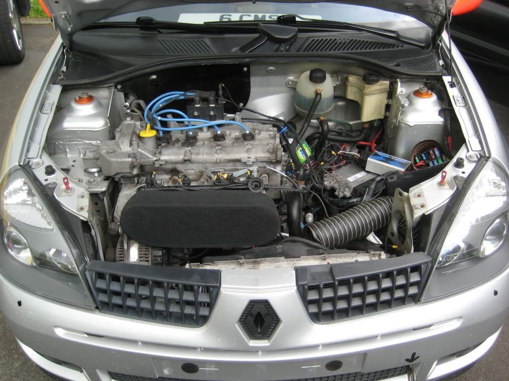

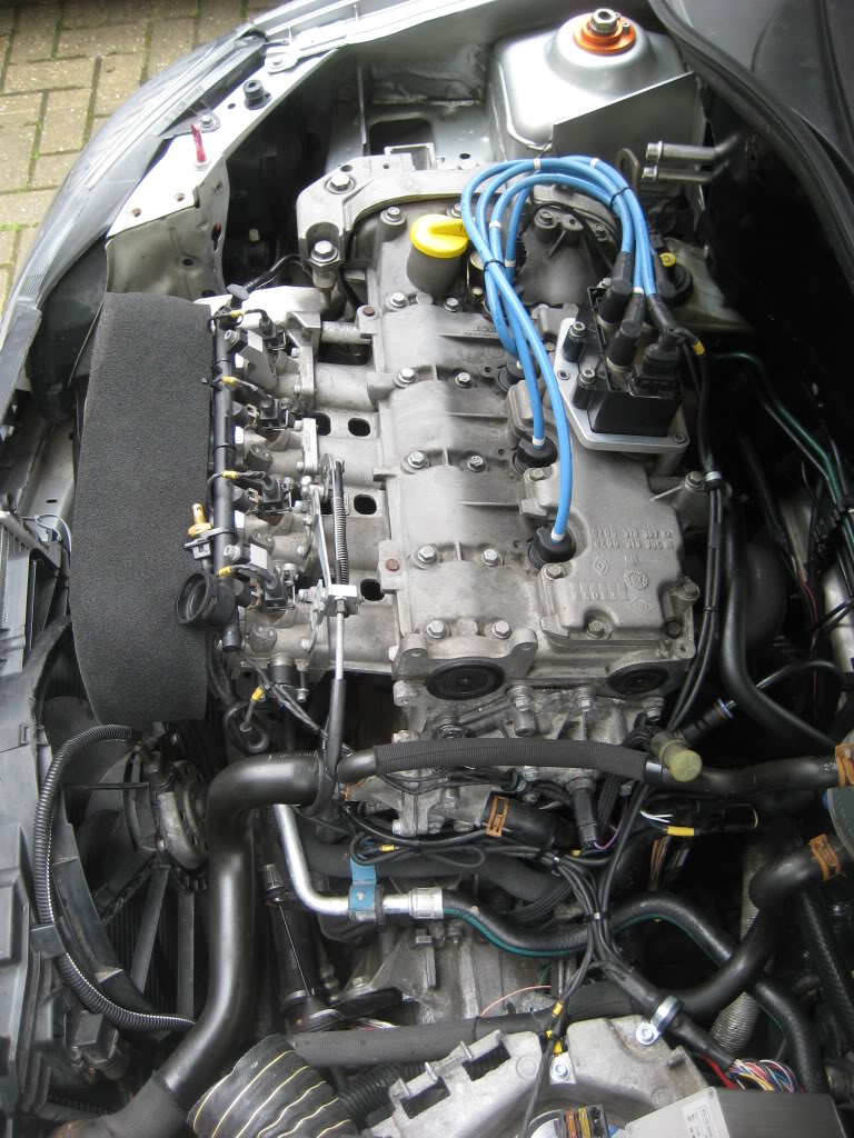

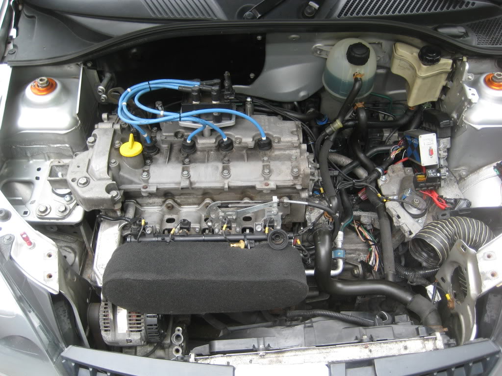

Here are a few picture of the tidy engine bay that k-tec did for me.
Before
After

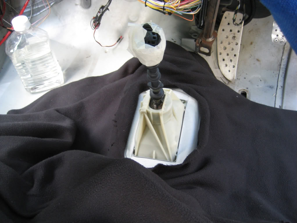

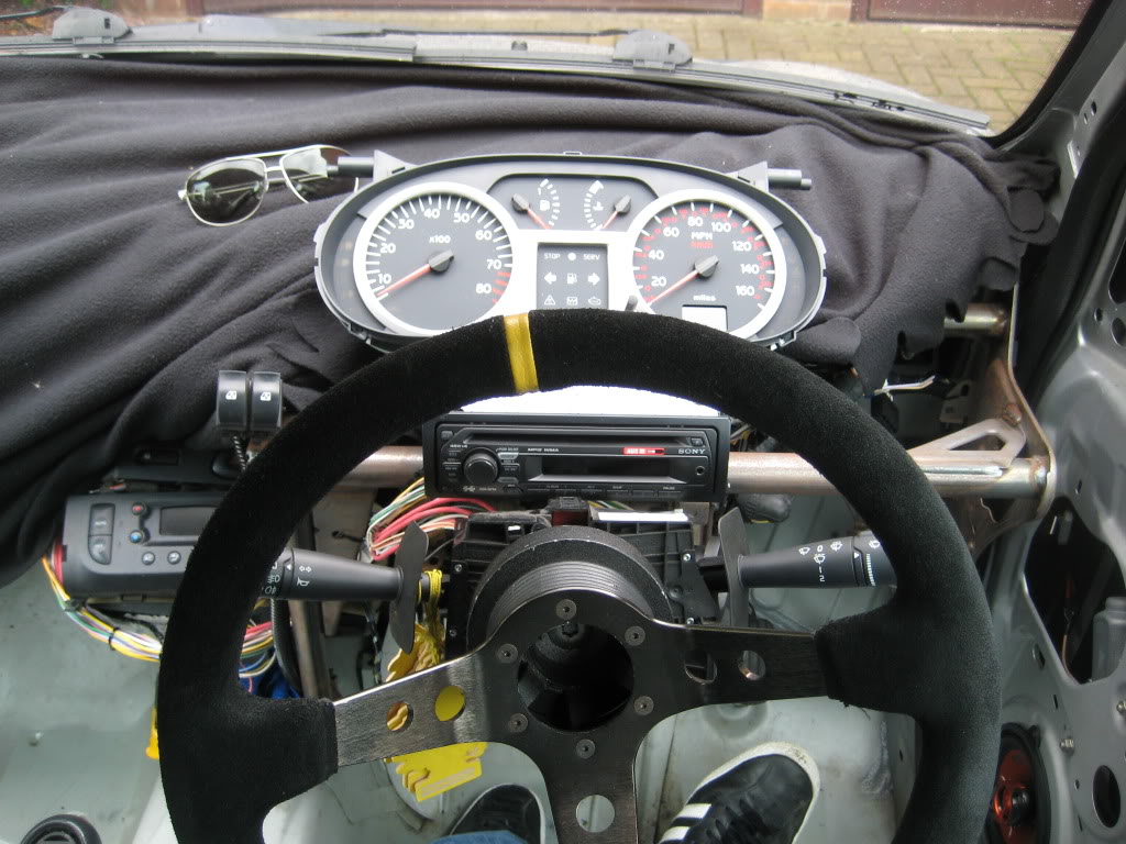

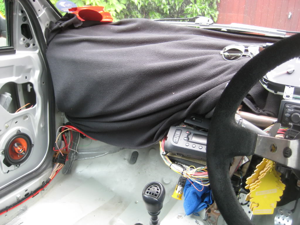

After taking the dash out and took it for a drive i remembered that i can see fook all from the reflection of the loom and silver bulk head.
So i've put the black blanket there for the time being and at least it covers the wires.
Also mounted my sterio in a different place so i can now reach it and attached my electric window stitches to the little tubes.
So i just need to wrap up my loom in some tubing so it looks a bit nicer, get the cage welded in and get it all sparyed.

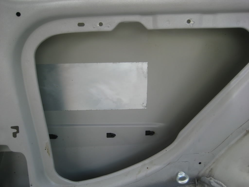

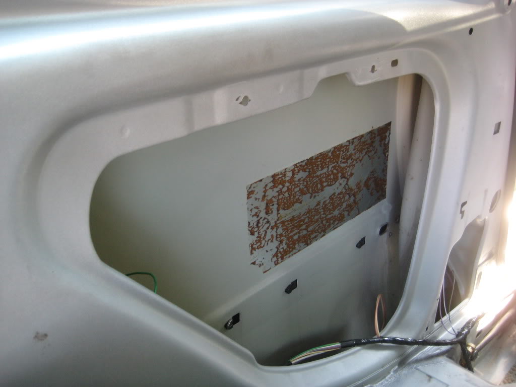

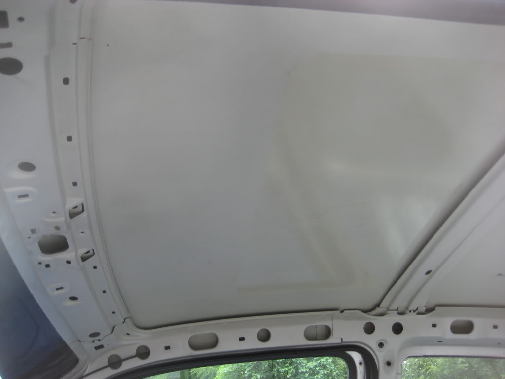

So as i had removed the rest of the tar the other day i cleaned all the glue off
Befor
After
And the other side
And cleared it off the roof too
I used the angle grinder a little yesterday to grind off a little screw which the K-tec filter gets caught on. I had also mounted the filter upside down so i turned that round too. I also trimed the gearstick mount so it looks a little neater
Gave it a quick spay or black paint as i didnt really like the colour.

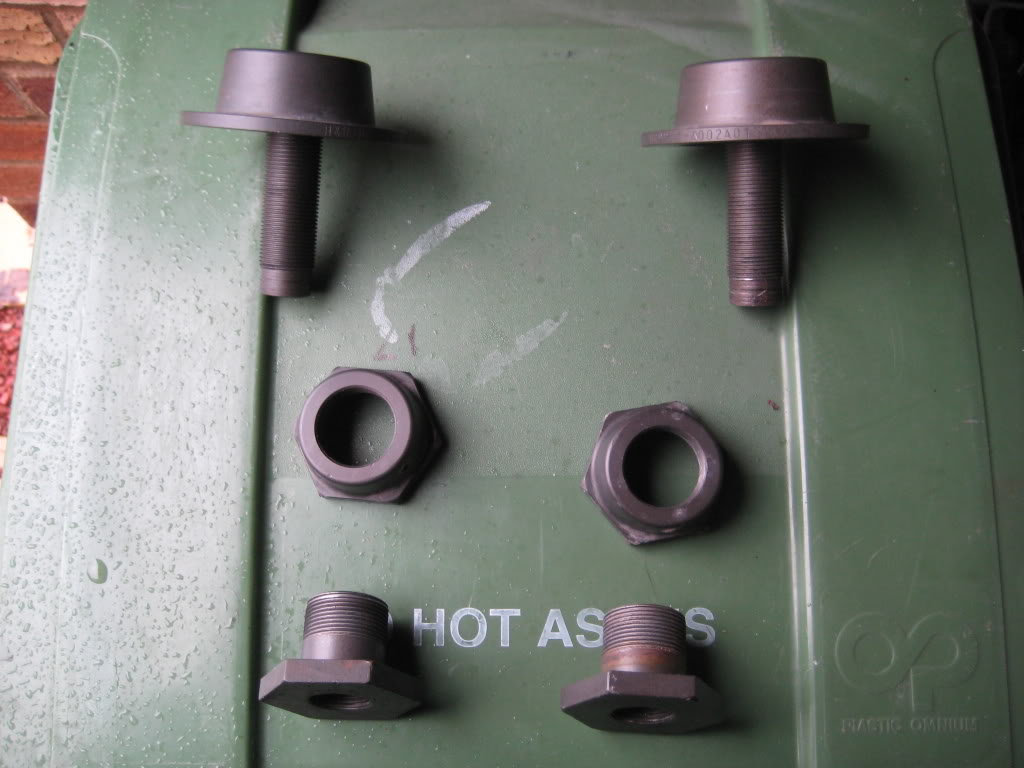

Very nice Clio! One Question: H&R Coilovers, right? Is the back only totaly down, or have you done some other "TRICK" on the back for this lowness? ;)
  TrackCar & F30 330d
Re: One Year on & £**** spent
I've removed the adjusters (the bits to the top of the picture) So the spring sits on the beam and the to smaller bits make sure it doesnt fall out.
You could also put a few bit cable ties on the spring attaching it to the beam :)
  TrackCar & F30 330d
LOL at the picture above!!!!
HOT AS S ;)
haha, the picture was from my Coilover fitting guide lol
is it not better to put the middle parts out? and screw it down? work?
Hmmmm yeah that could work, then then the spring will be roughly 3mm higher to if it was sat in the actual beam.
To be honest mine has been just sat on the beam with no zip ties and i have had no problem.
Maybe try it your way first but if it not quite low enough then do it my way :)

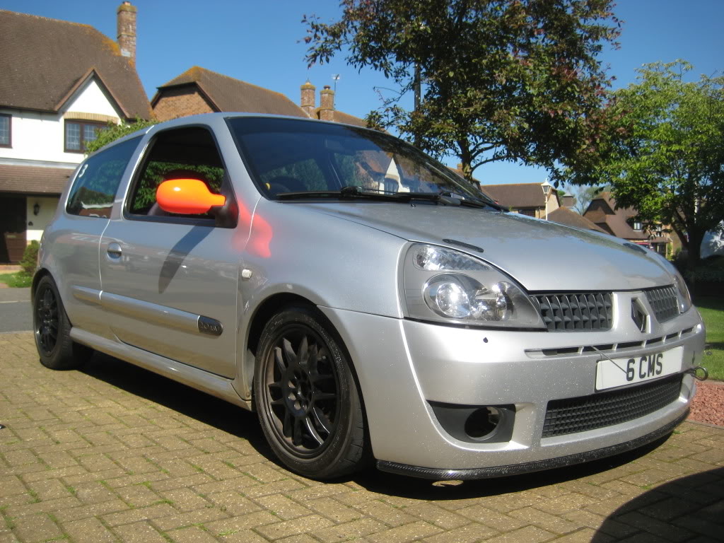

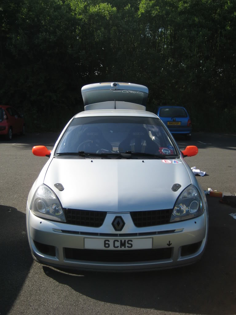

Another small update:-
Fitting the cage has been put back a week so today i did a few more little bits.

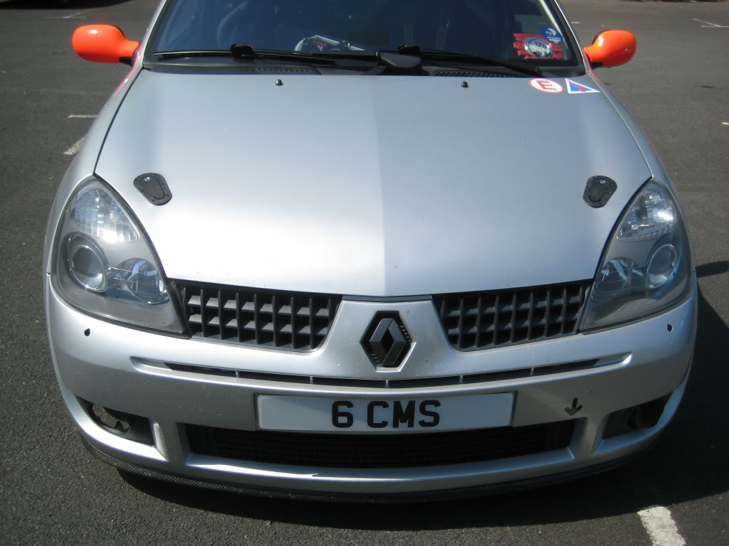

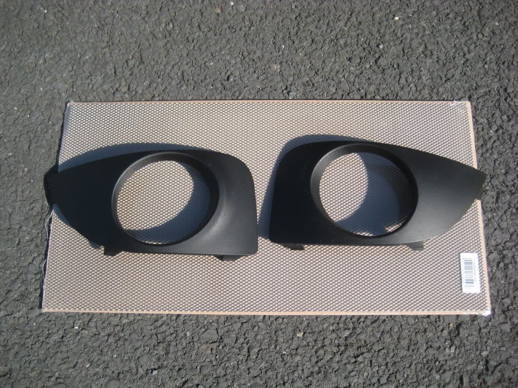

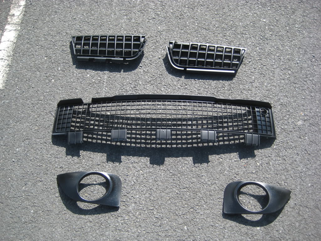

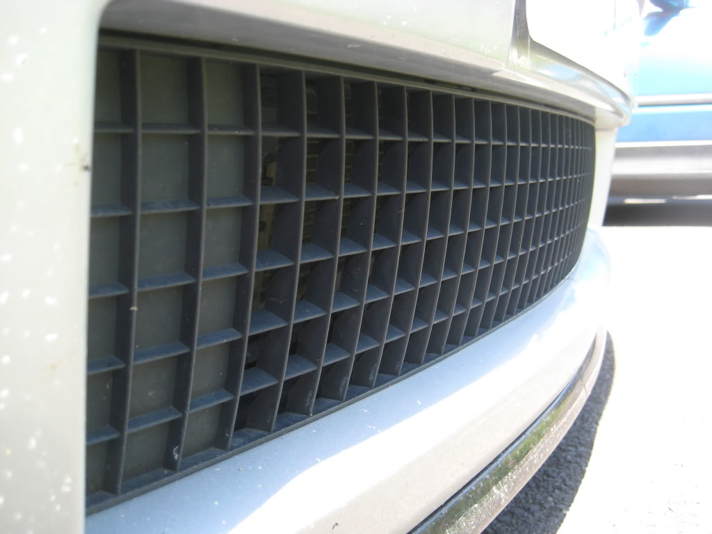

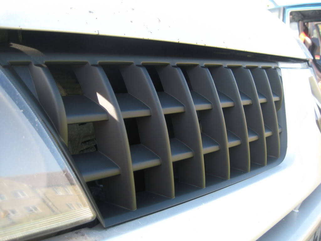

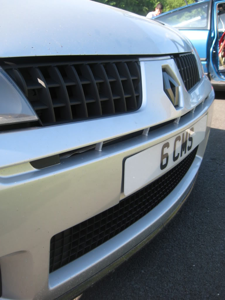

The main thing i did today was to tidy up the plastics on the front bumper.

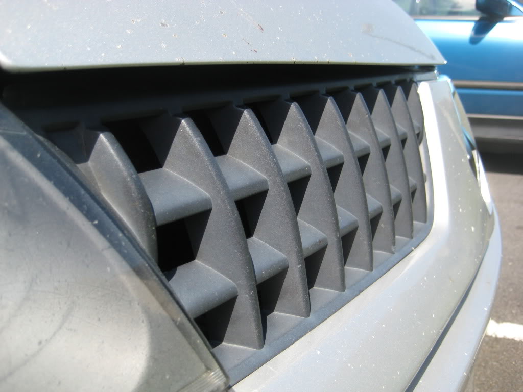

This picture made me realise how untidy and run down the front looks.
I cant do anything about the stone chips, so i went to Halford bought some grey primer and some matt black paint.
So this was how it looked earlier this morning
Faded plastics
After a bit of roughing up and spray paint
Bought some mesh for the CAF's but will have to do that at a later date
All the plastics back on
Looks much better imo
So all back together and it looks much cleaner and neater
