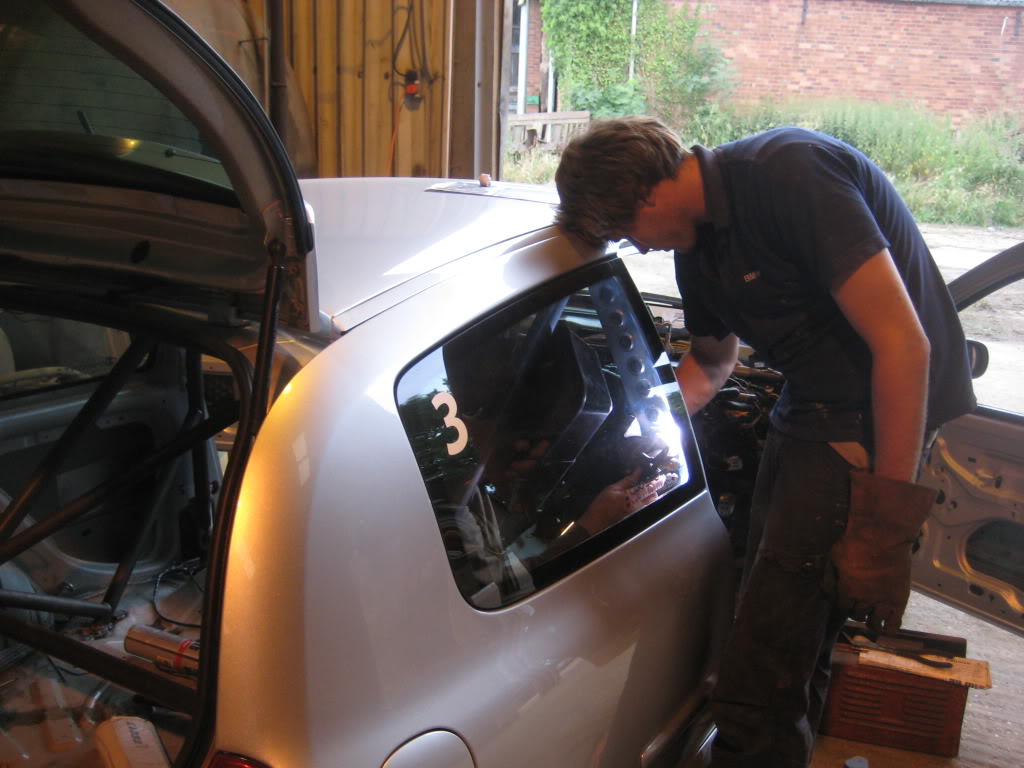

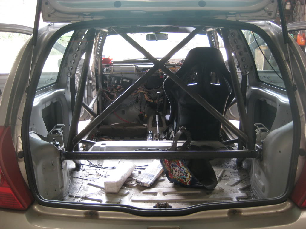

So last week i drove from huddersfield with all my lifes possesions in the back of the car and got to somewhere in the middle of no where to a barn thing.

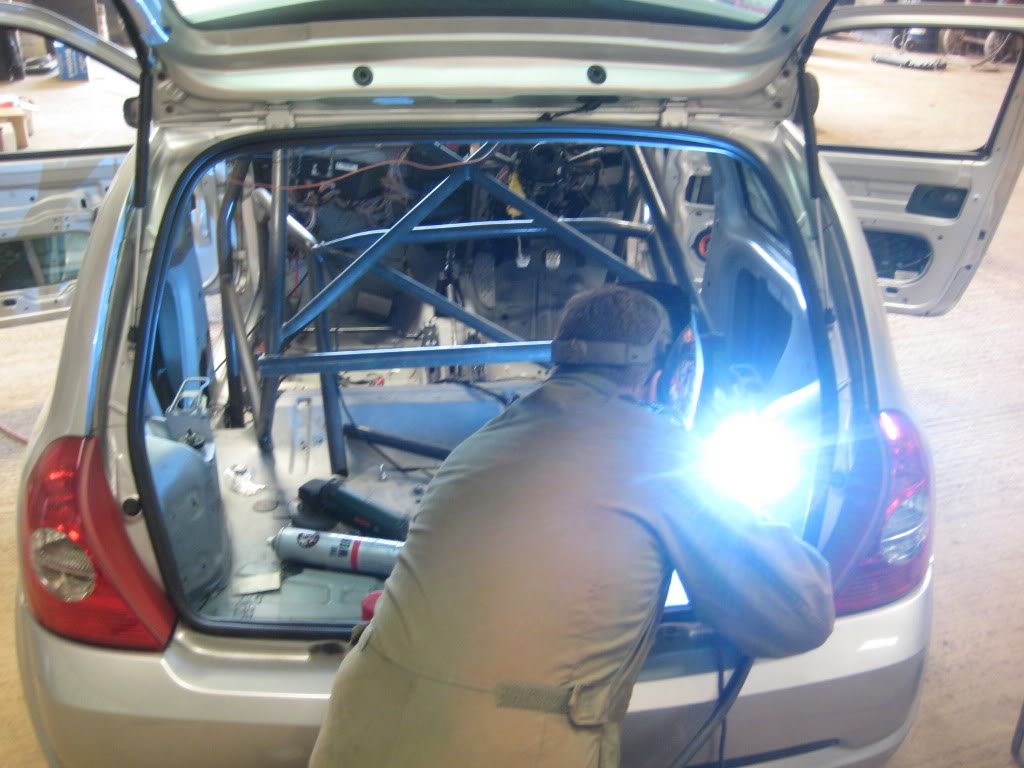

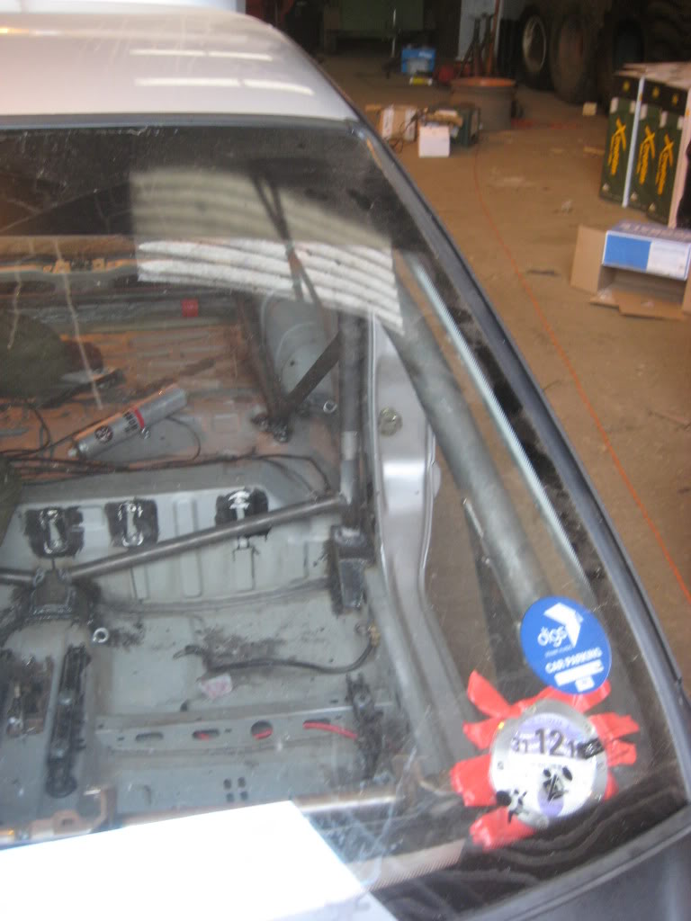

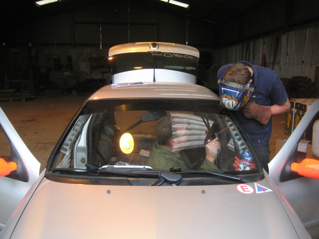

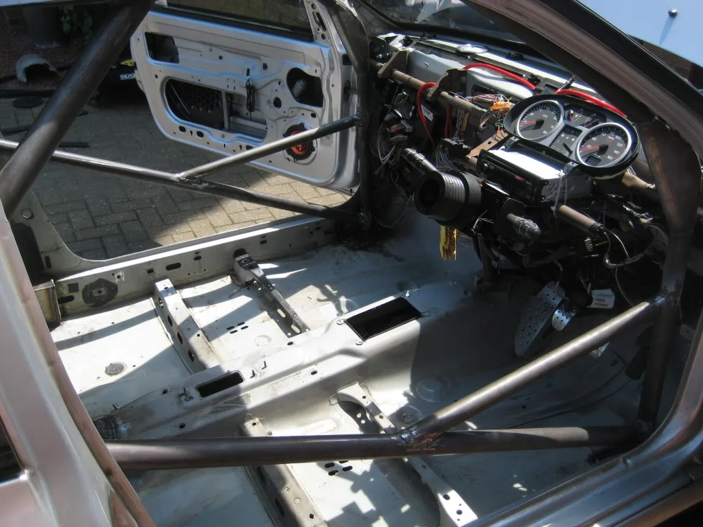

Got straight to work and pulled the seats, harnesses, wheel and battery out, and wiggled the cage into the car to see how it fits.

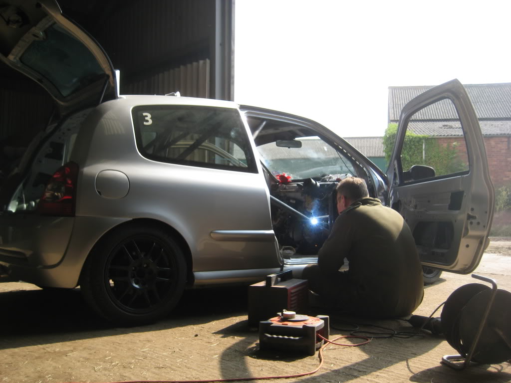

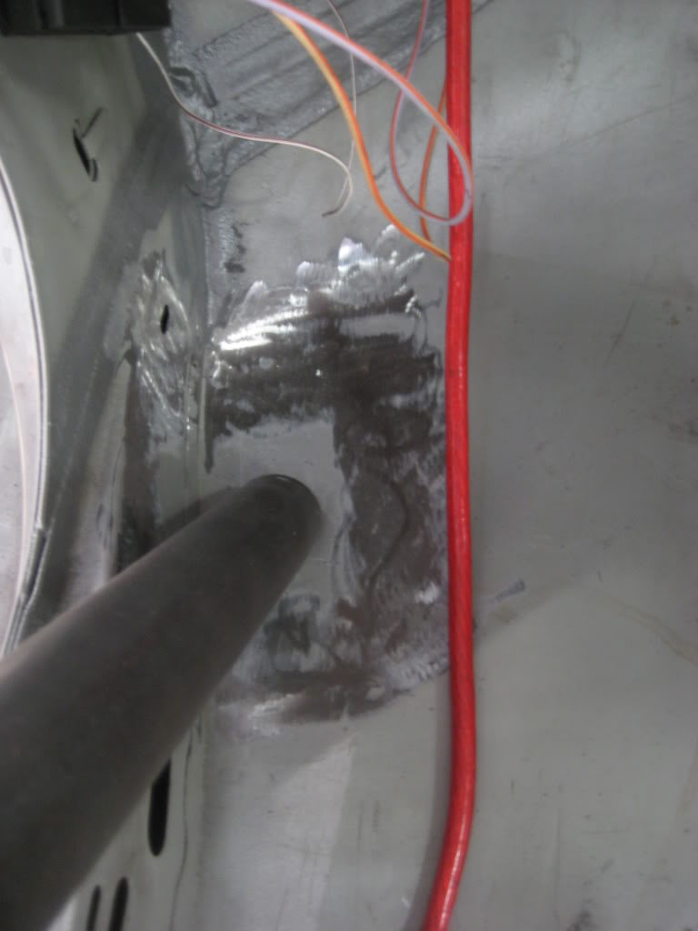

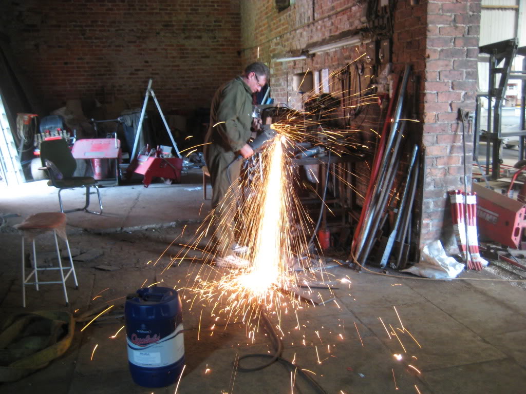

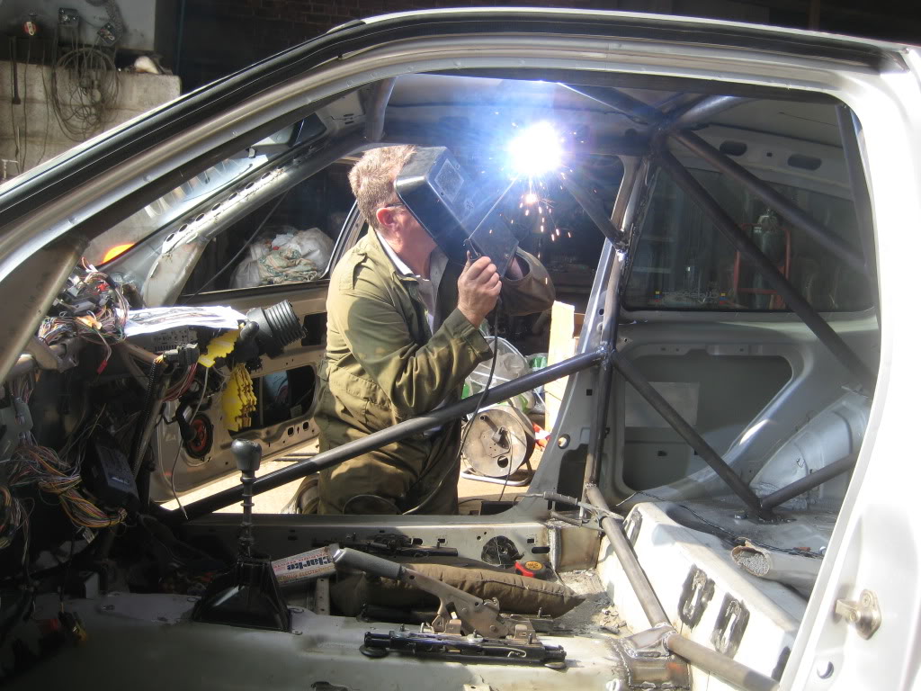

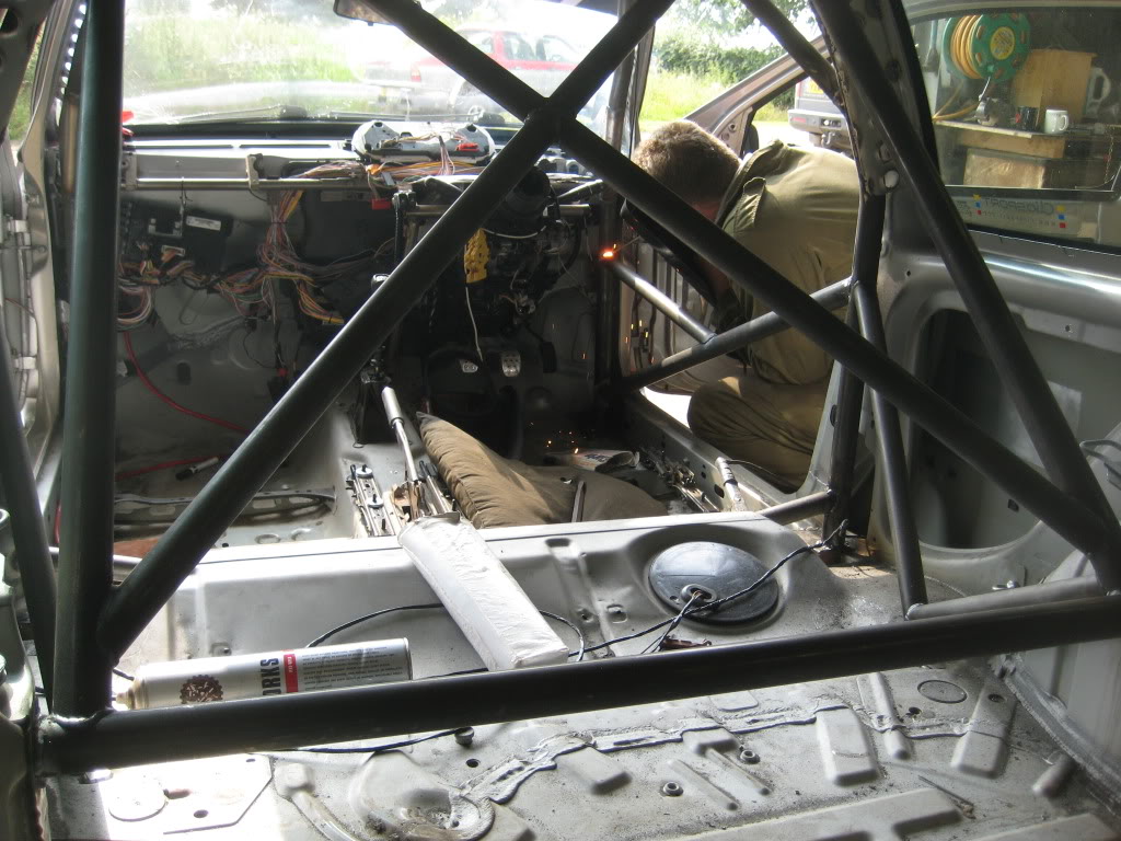

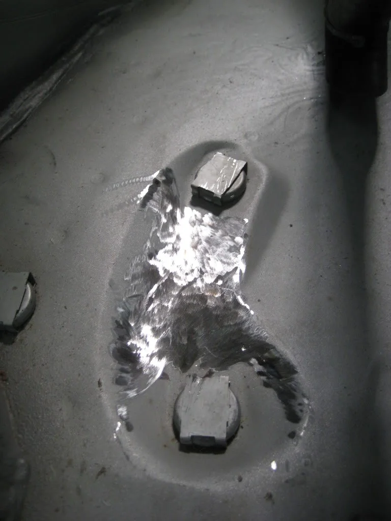

After we found out where it mounted we took a grinder to get all the paint off the parts where the plates were going to be welded.

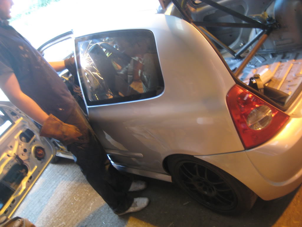

Then a bit of welding of the plates

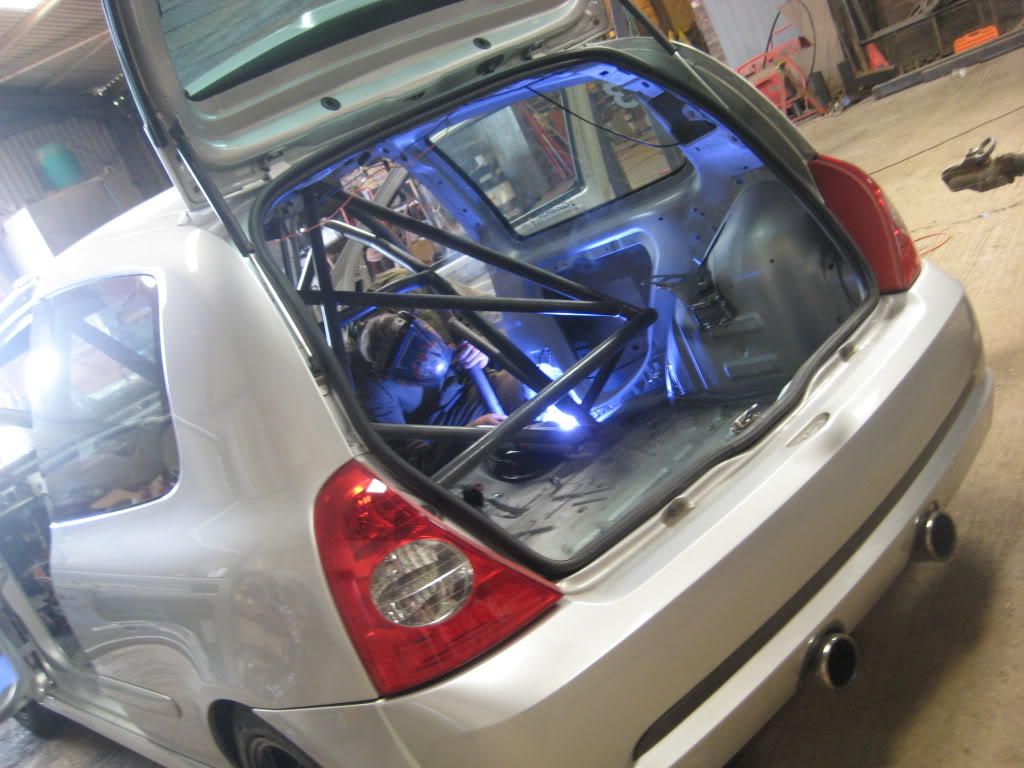

So after all 9 plates were welded in the cage was welded to the plates

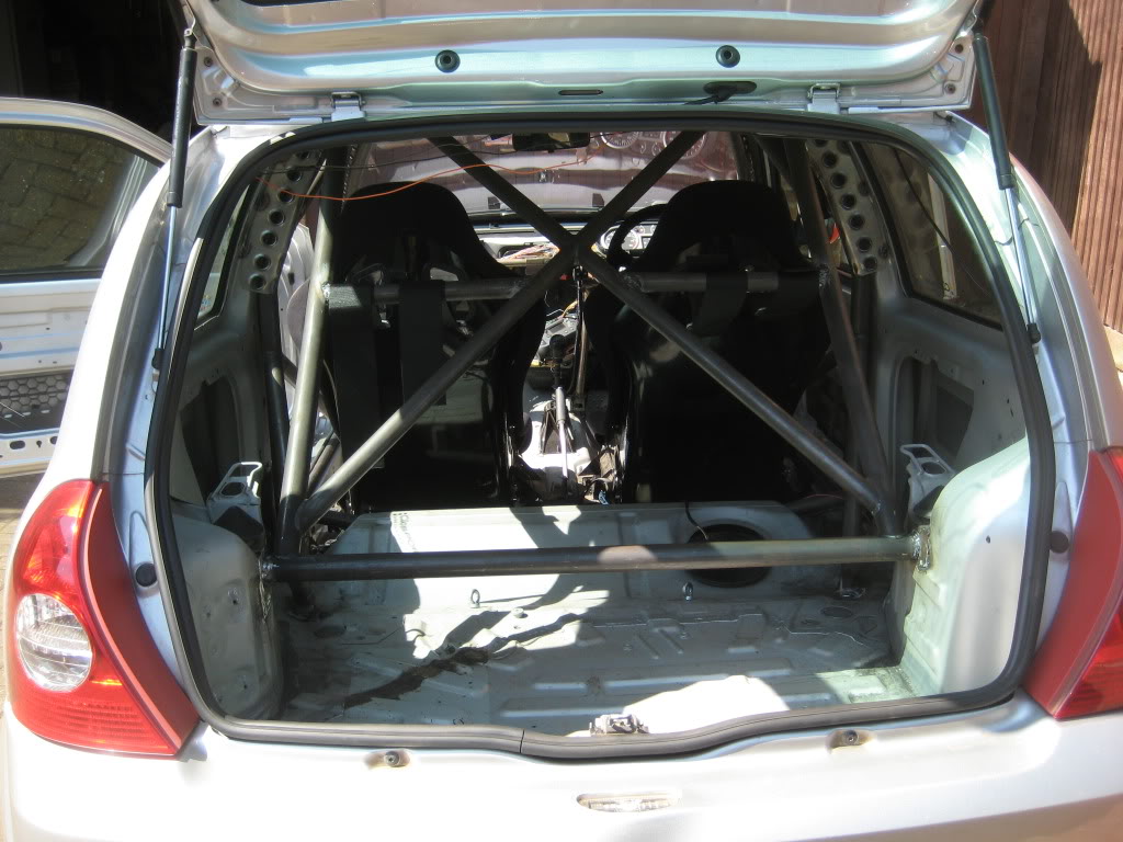

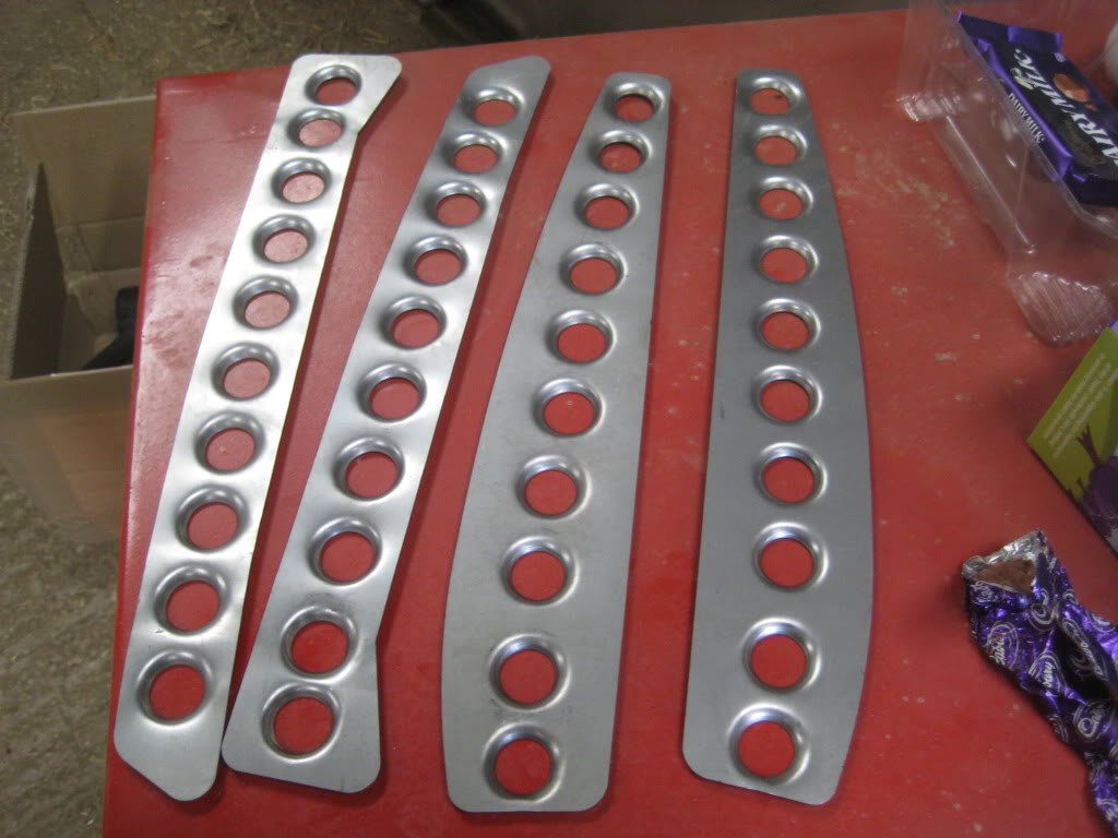

Here are the gussets i bought
Before the gussets
And then whilst welding then on

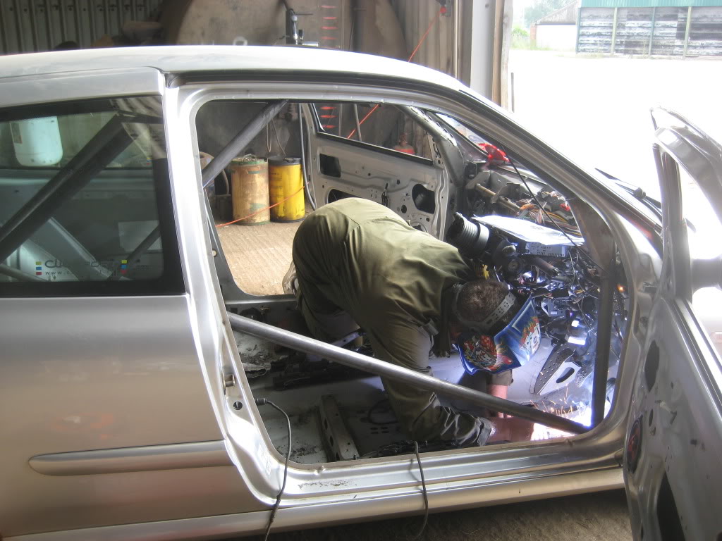

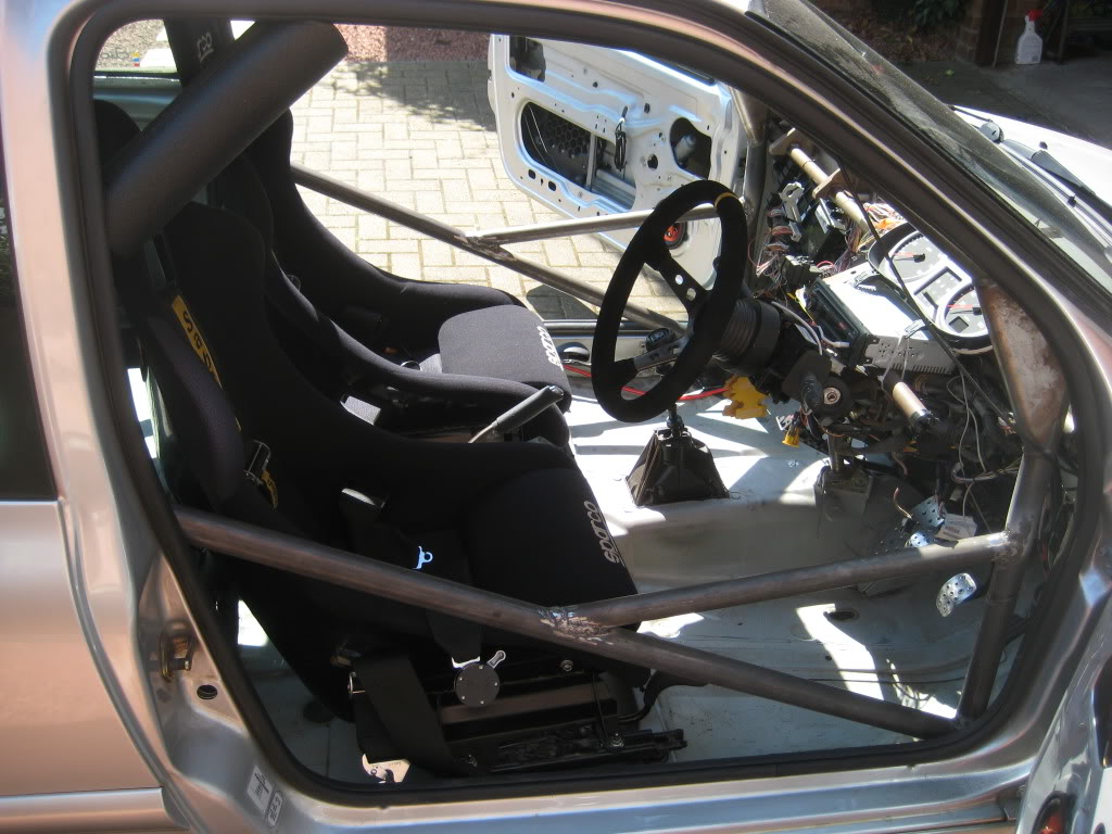

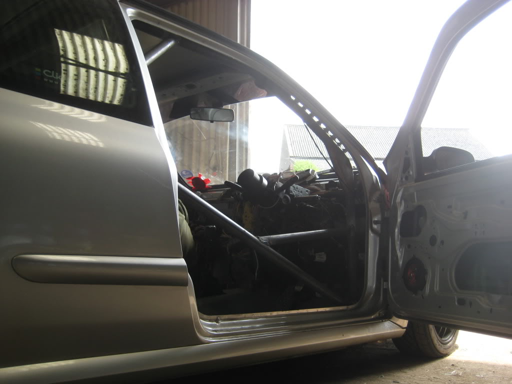

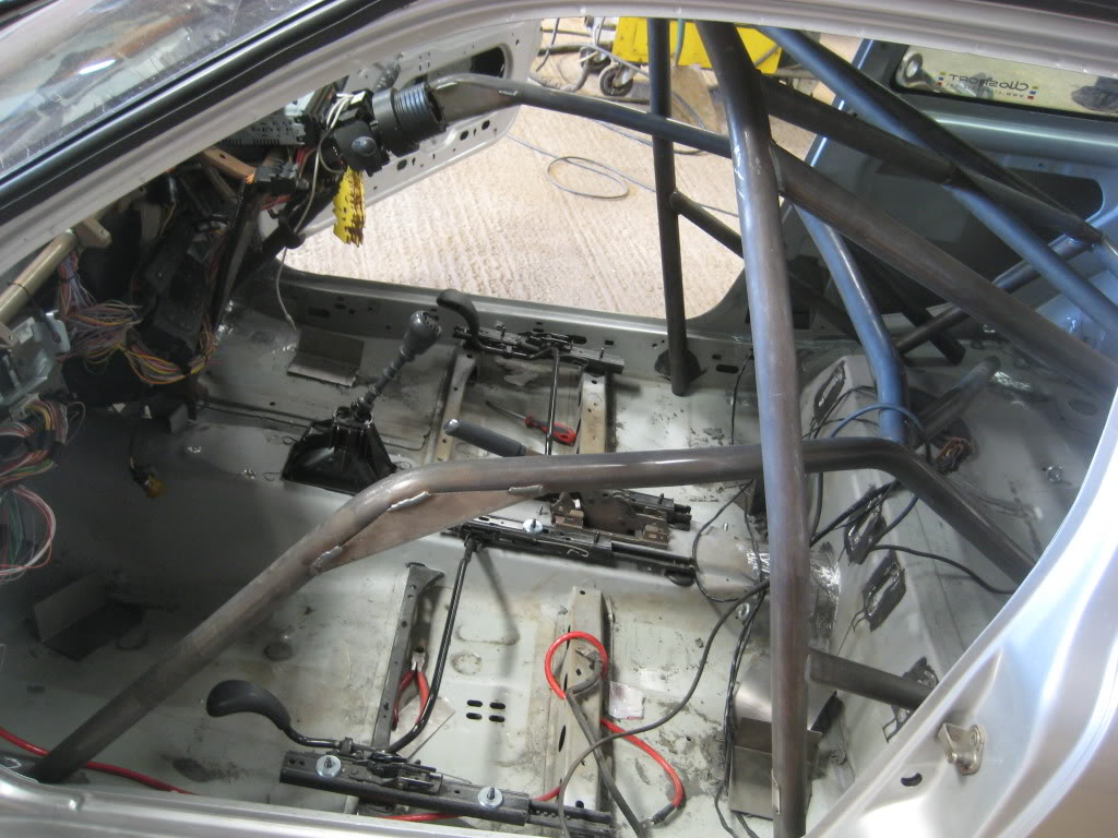

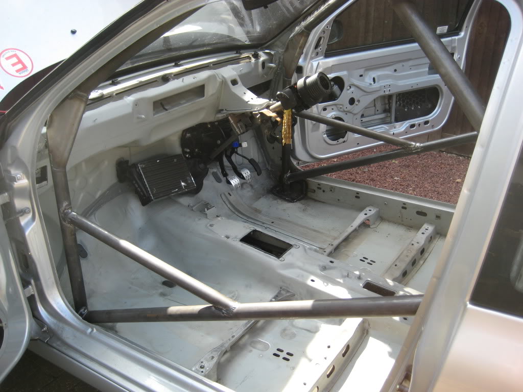

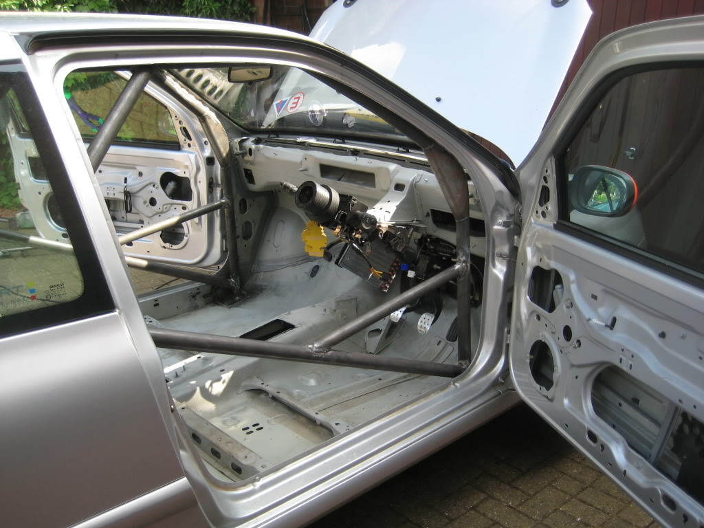

Now time to weld the door bars in

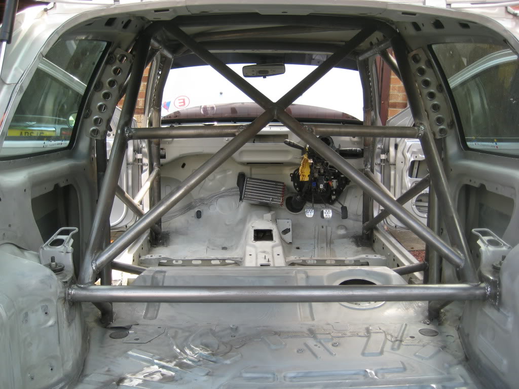

All done

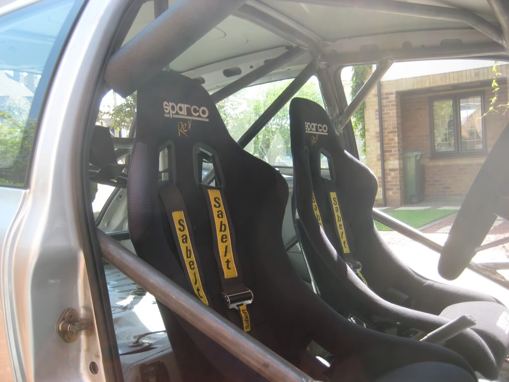

I poped my seat in so i could see where to mount the harness bars
Cut them to size
And then they were welded in. Then i put all my stuff back in my car and set off on my 180mile trip back home to Aylesbury

Just wana say a big big thank you to Daddy, Mummy and Baby Seagrave for putting me up, feeding me and welding in my cage

Really pleased with it and it really has stiffened up the car and its even better to drive

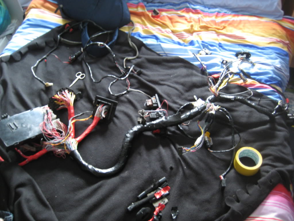

So yesterday i pulled the seats, harnesses, battery, wheel, gear knob, handbrake, rear loom and rear lights. And started sanding away

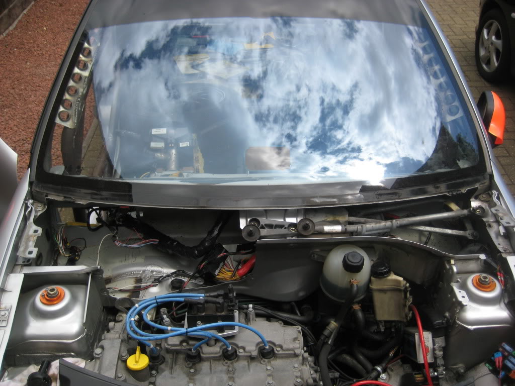

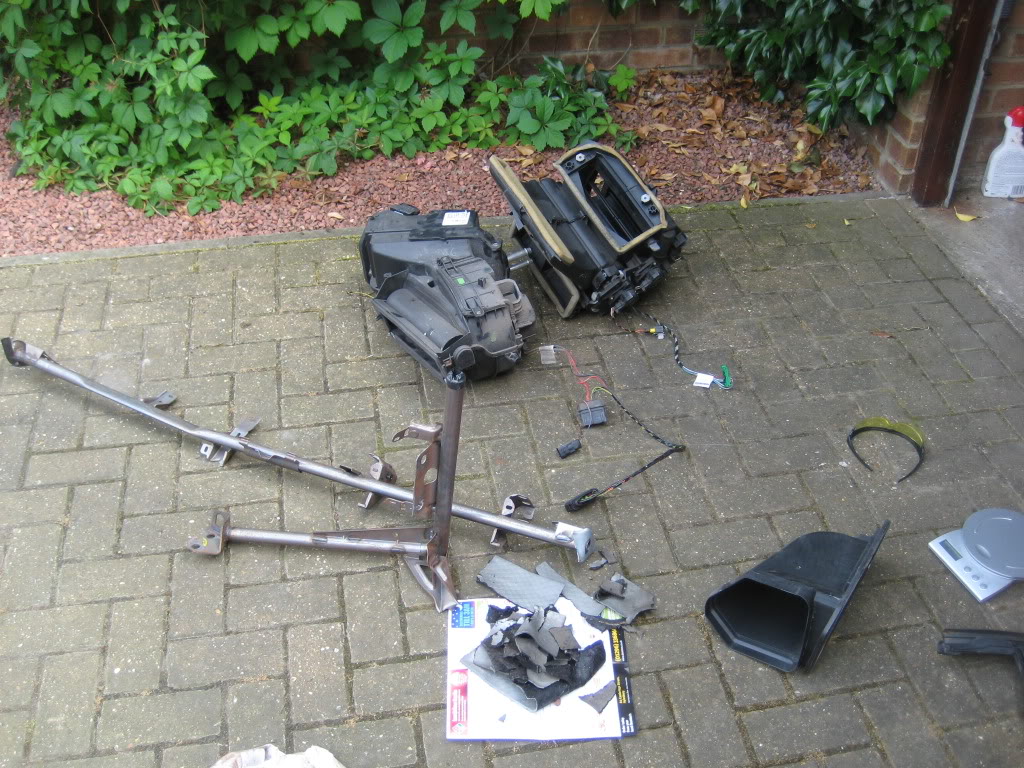

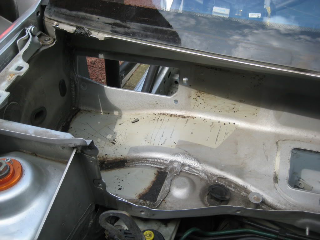

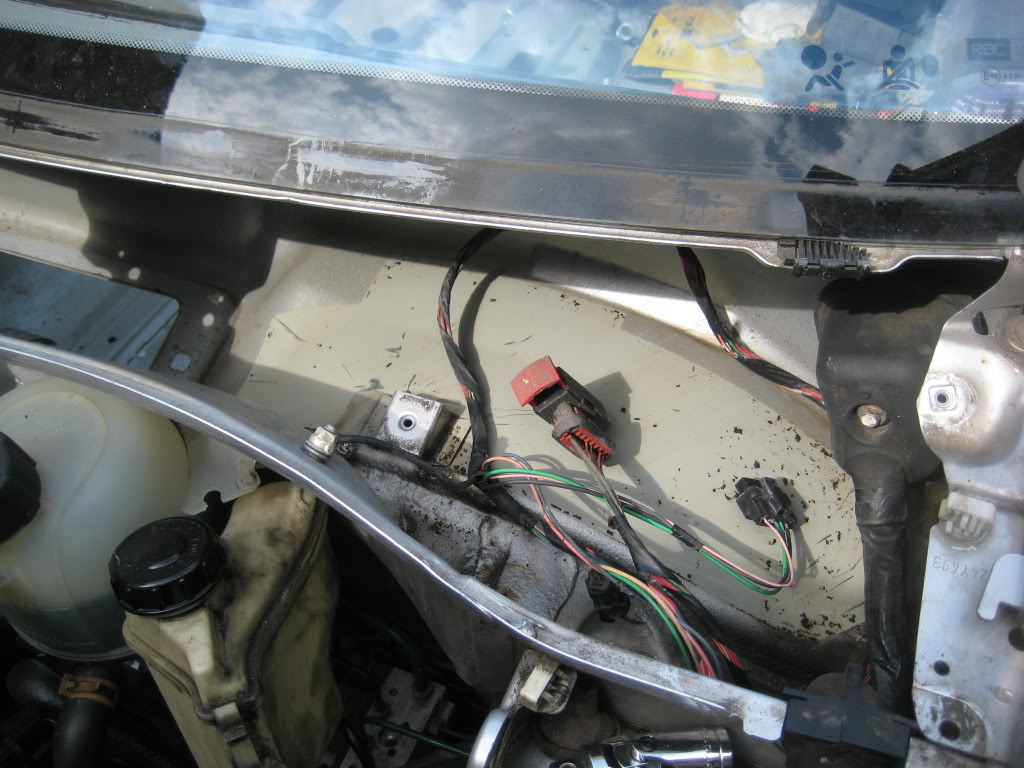

Today i stripped the front of the interiour out.

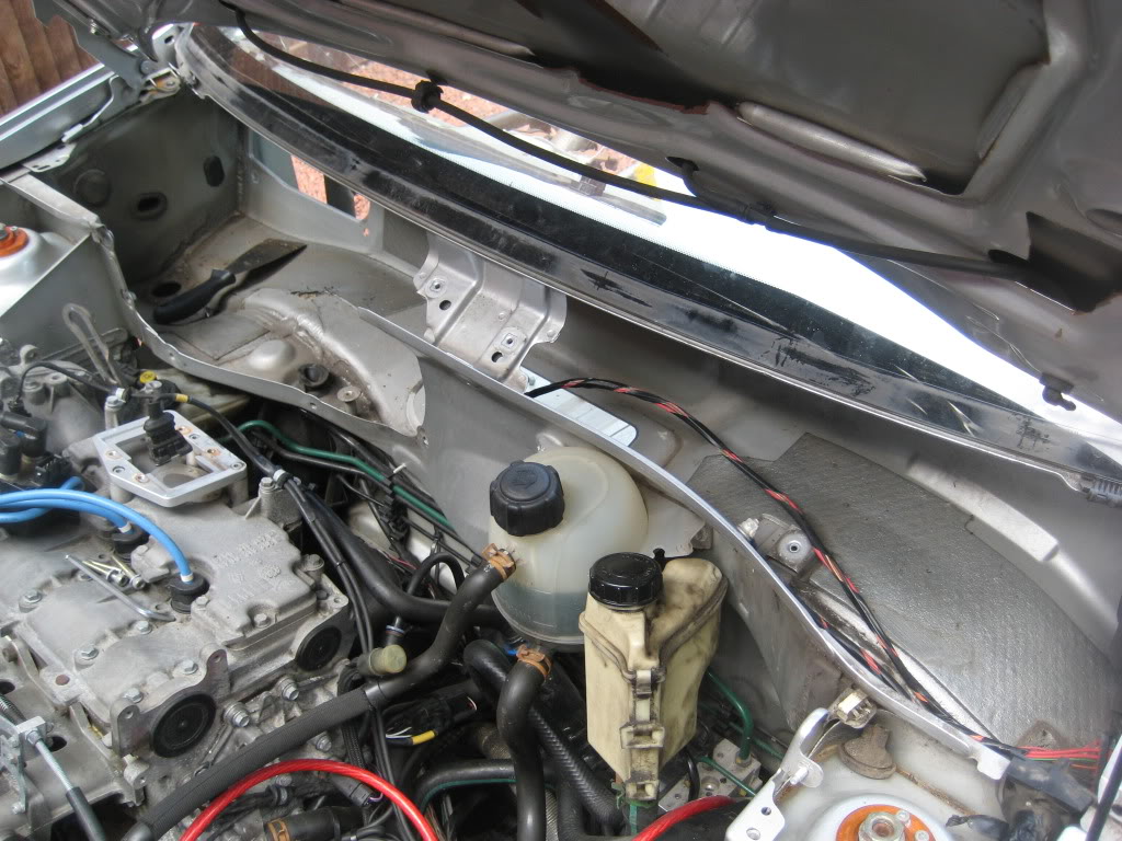

I am trying to get a heated front screen so i can delete the blowers and bits and that means i can keep it basically like it is.
