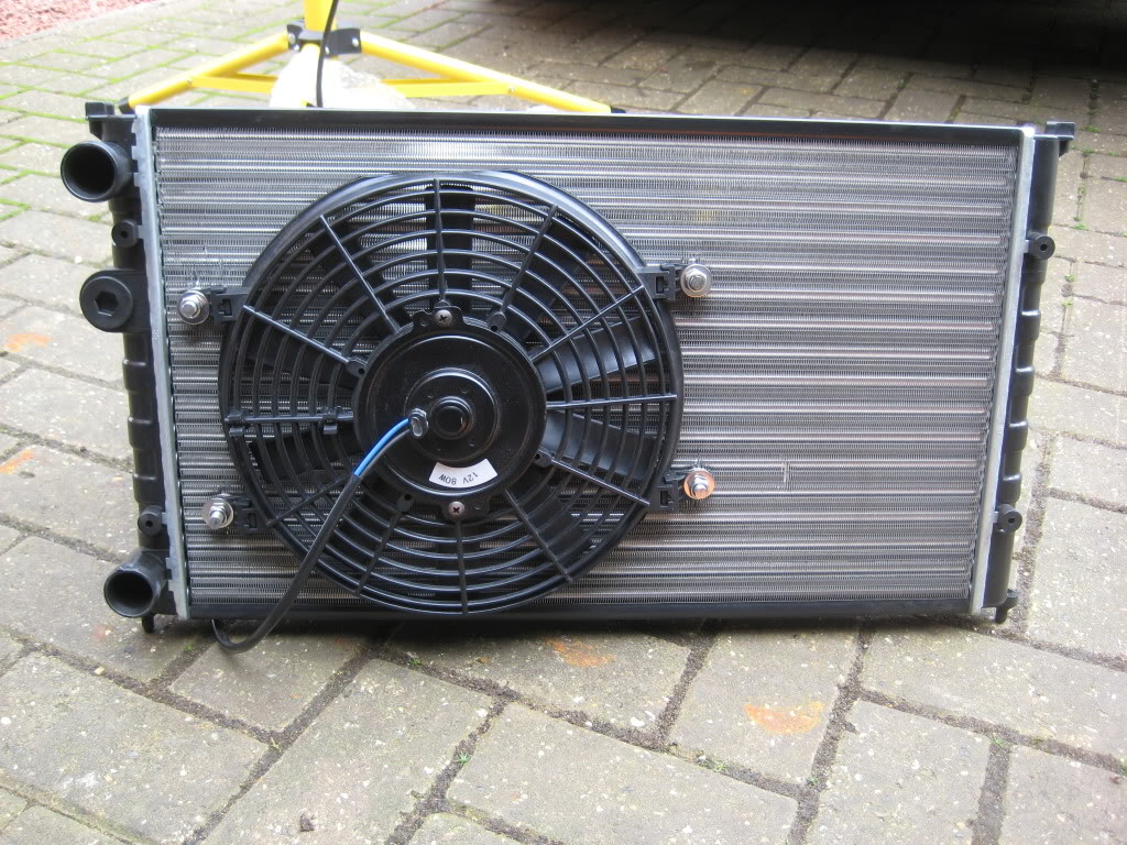

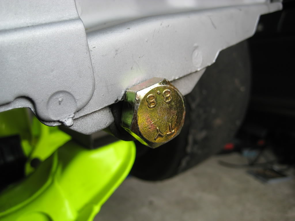

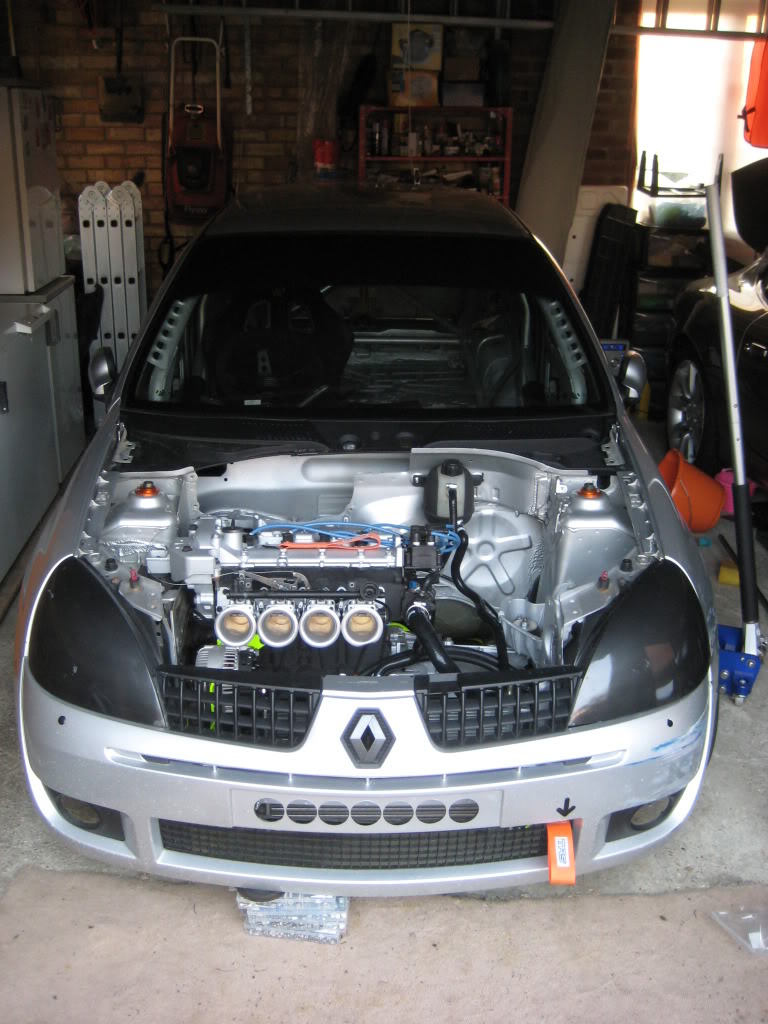

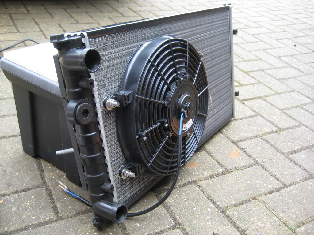

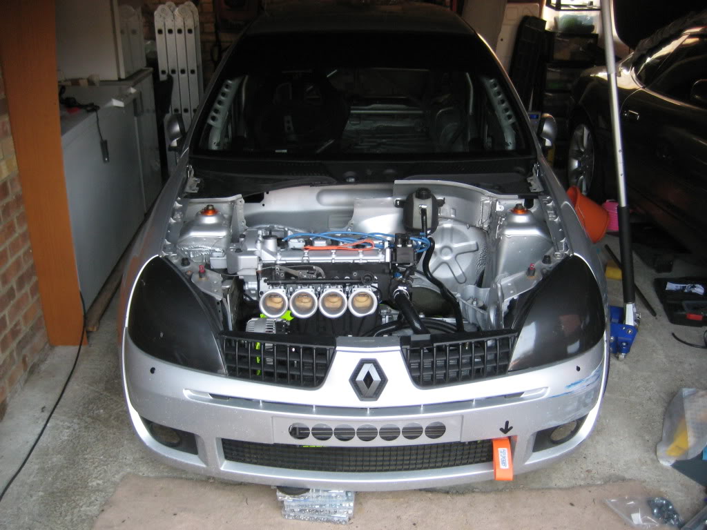

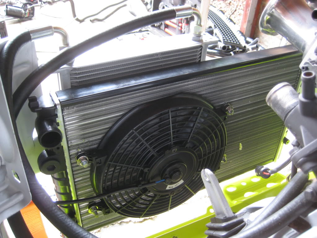

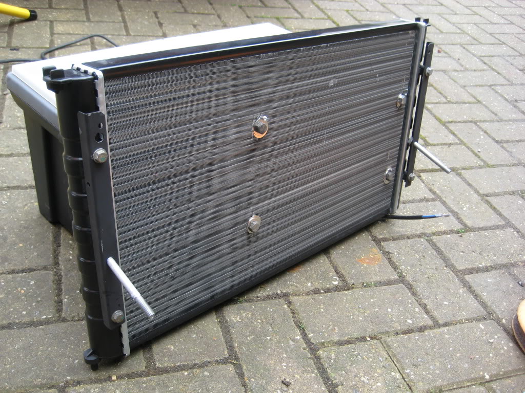

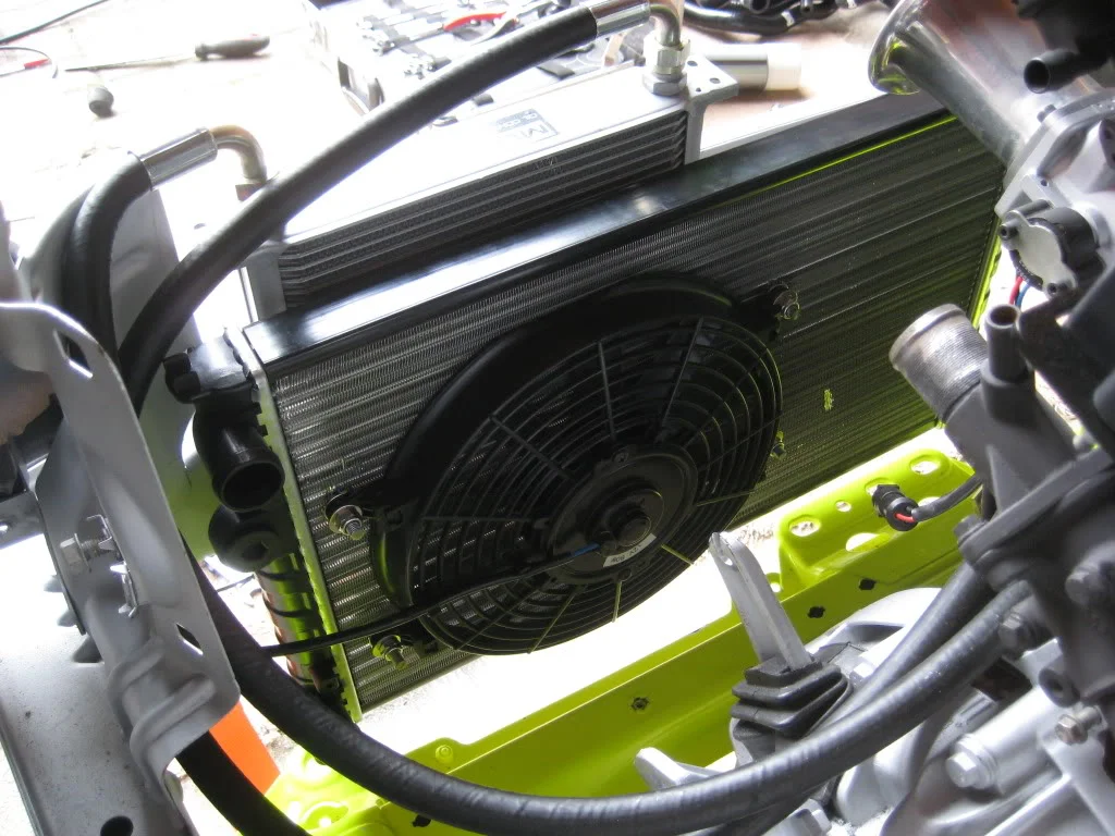

Right so first thing i did the other day was to remove the Radiator so i could fit the slim fan. After hearing that the fan fitting kits were pretty poo i decided to put bolts through the rad so the fan would stay put and not fall off when smashing the car over curbs at trackdays :)
Fitted back to the car

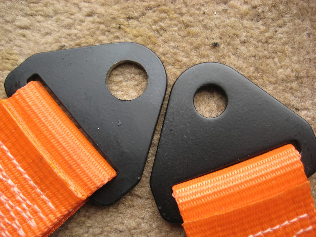

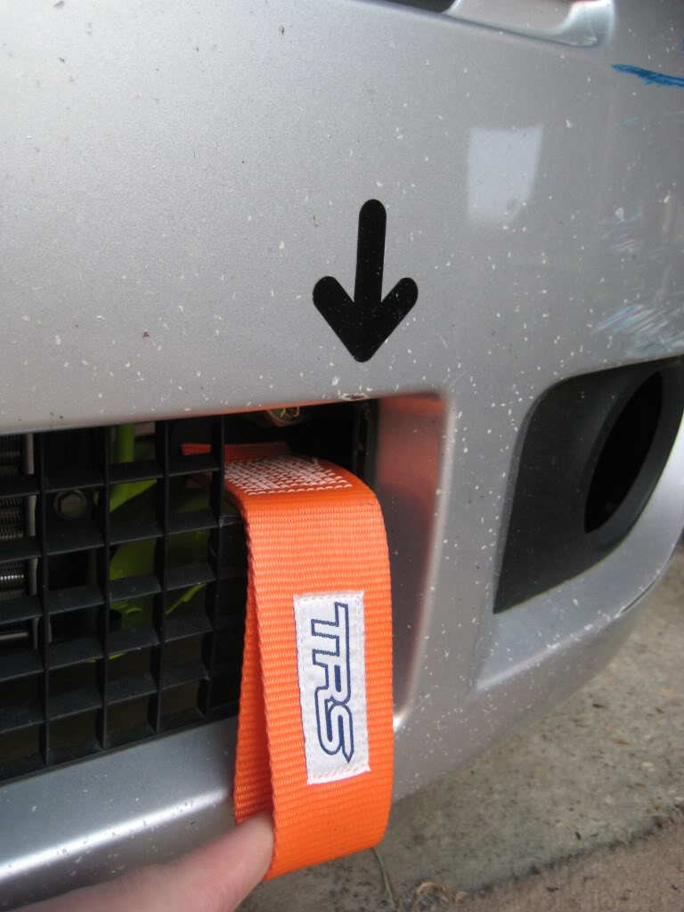

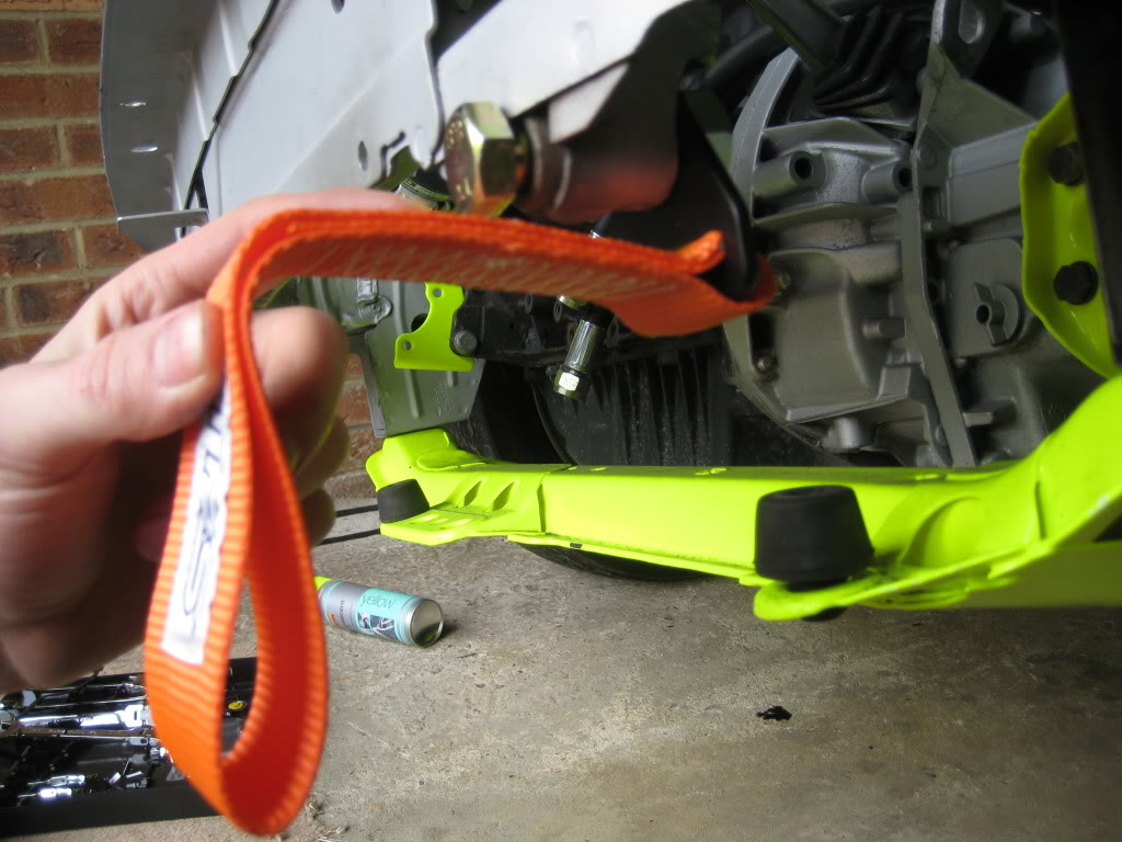

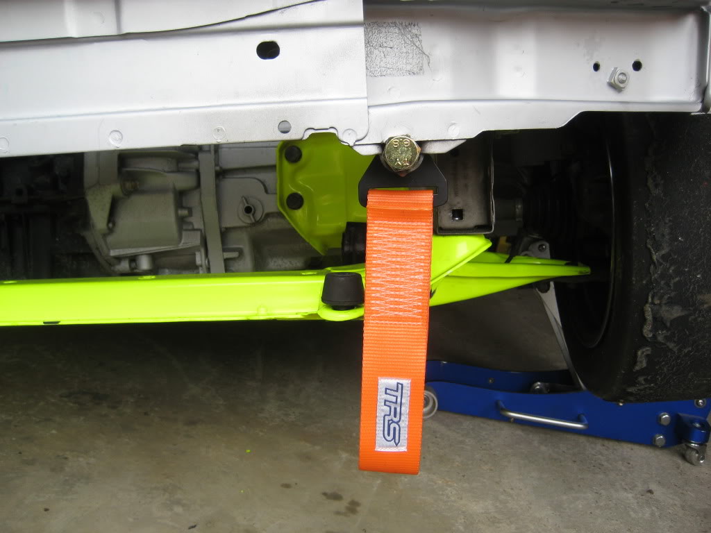

Next thing to do was to enlarge the Tow strap hole so my new bolt would fit through
Enlarged one on the left
Bolt through the standard place
I had trimmed a little bit behind the towing hole so i could get the bolt on
So it looks like this now
I then just needed to trim the grill so the strap could reach through
Few holes drilled
And then cut the rest out.
Done :)

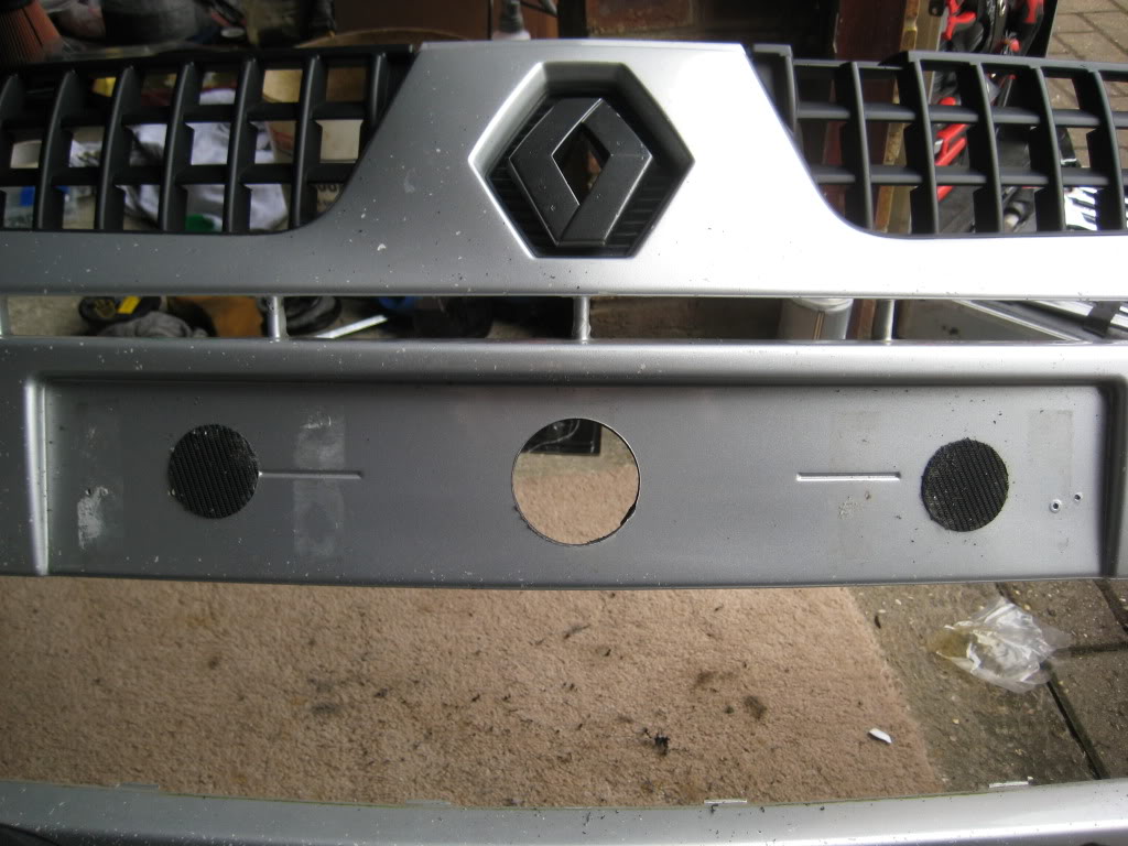

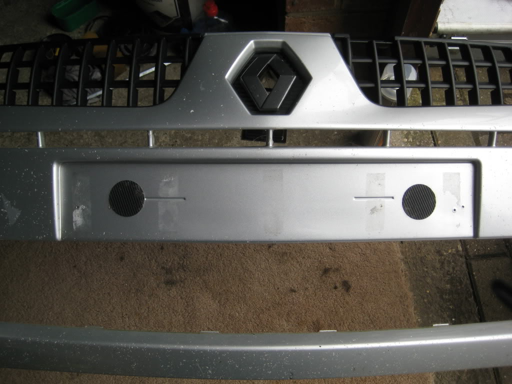

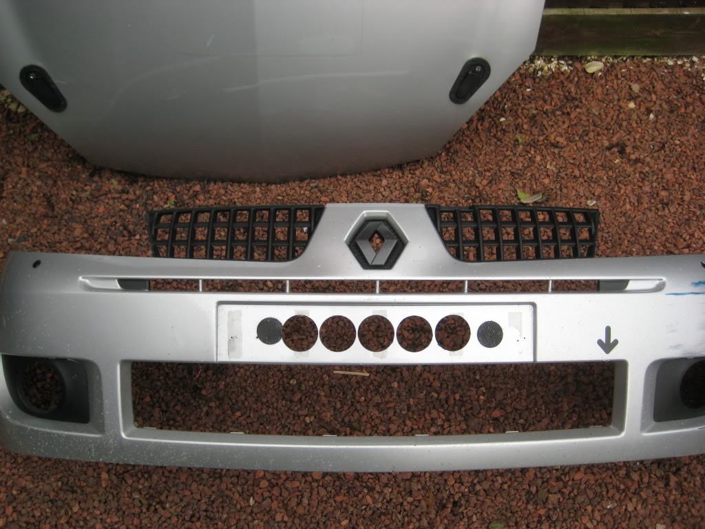

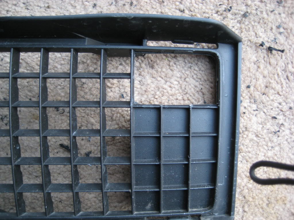

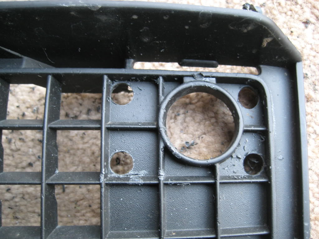

Bought a 60mm hole saw the other day and attacked the front bumper
So before
Starded off with one in the middle
Then did a bit more
And then all finished and back on the car

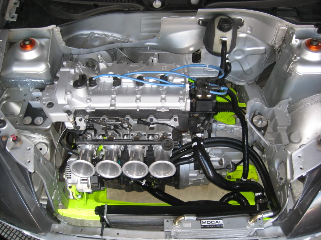

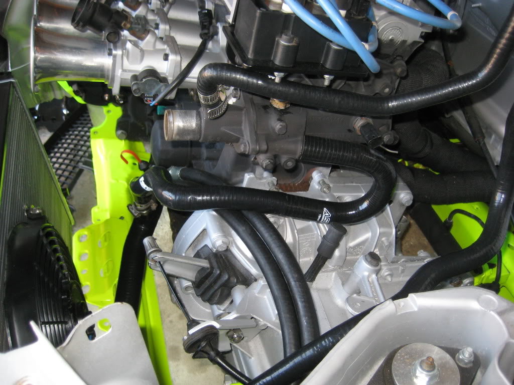

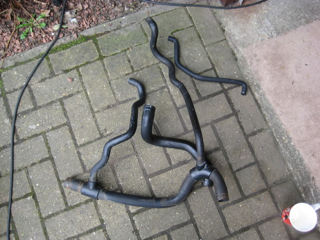

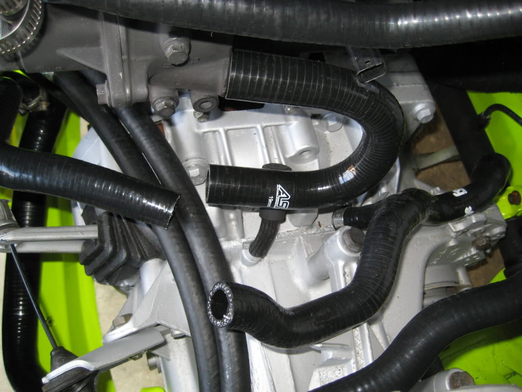

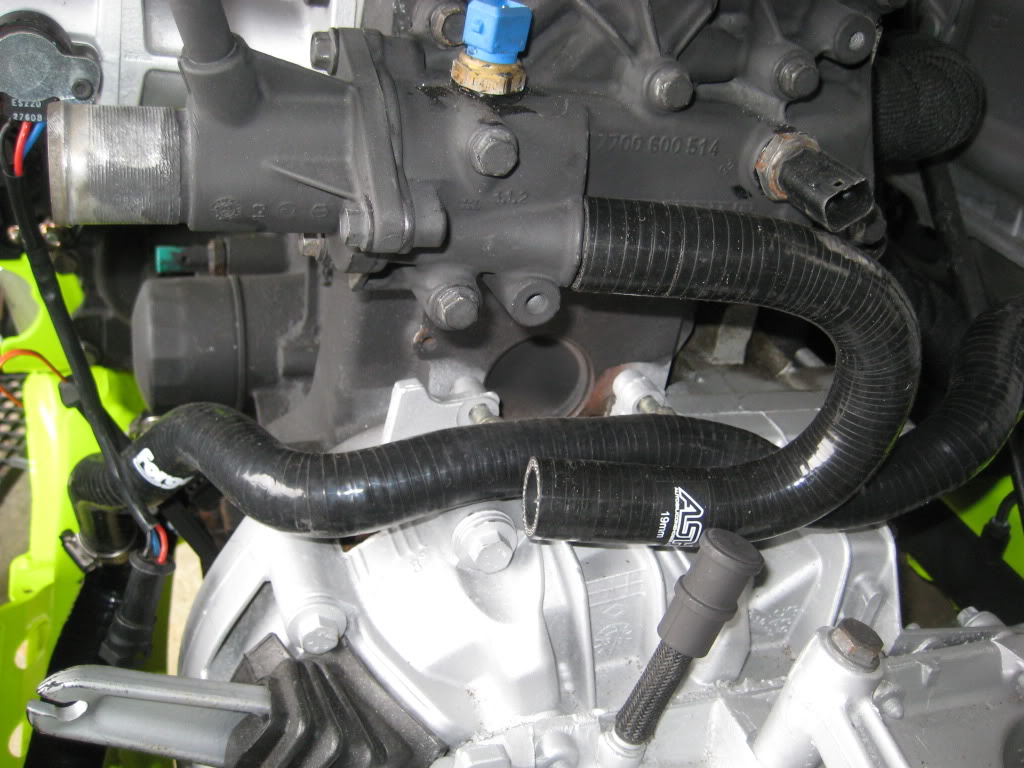

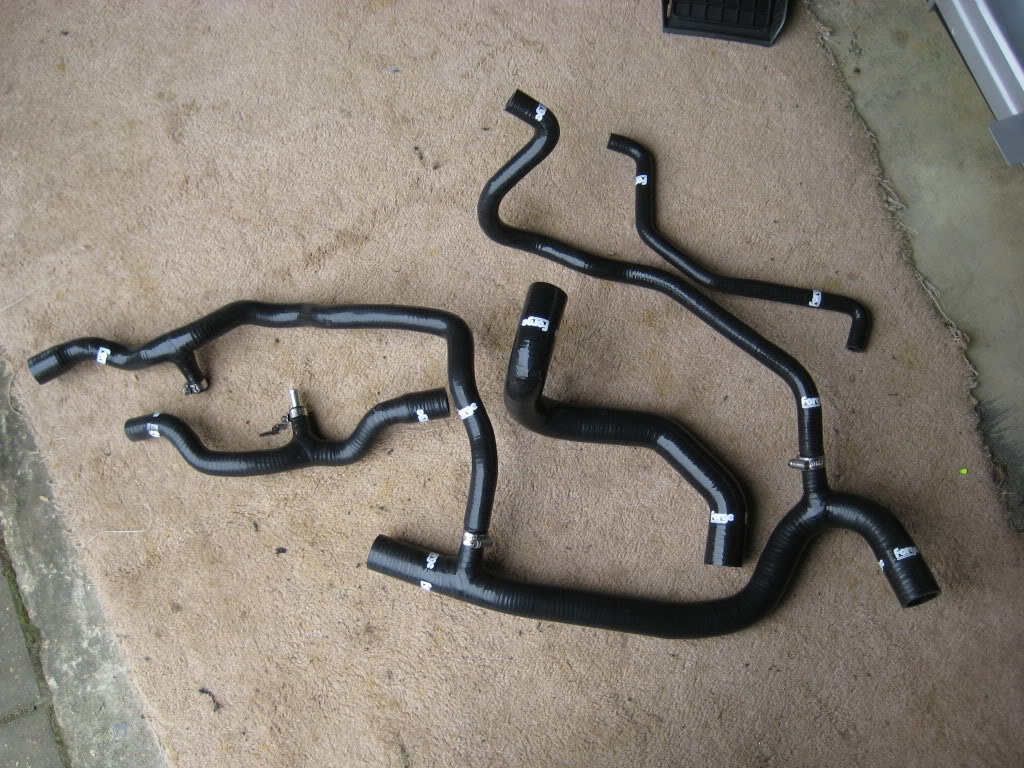

Next I started to fit my new Forge Silicon coolant hoses
Old
New
Bought stainless steel hose clips too :)

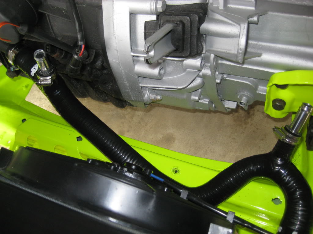

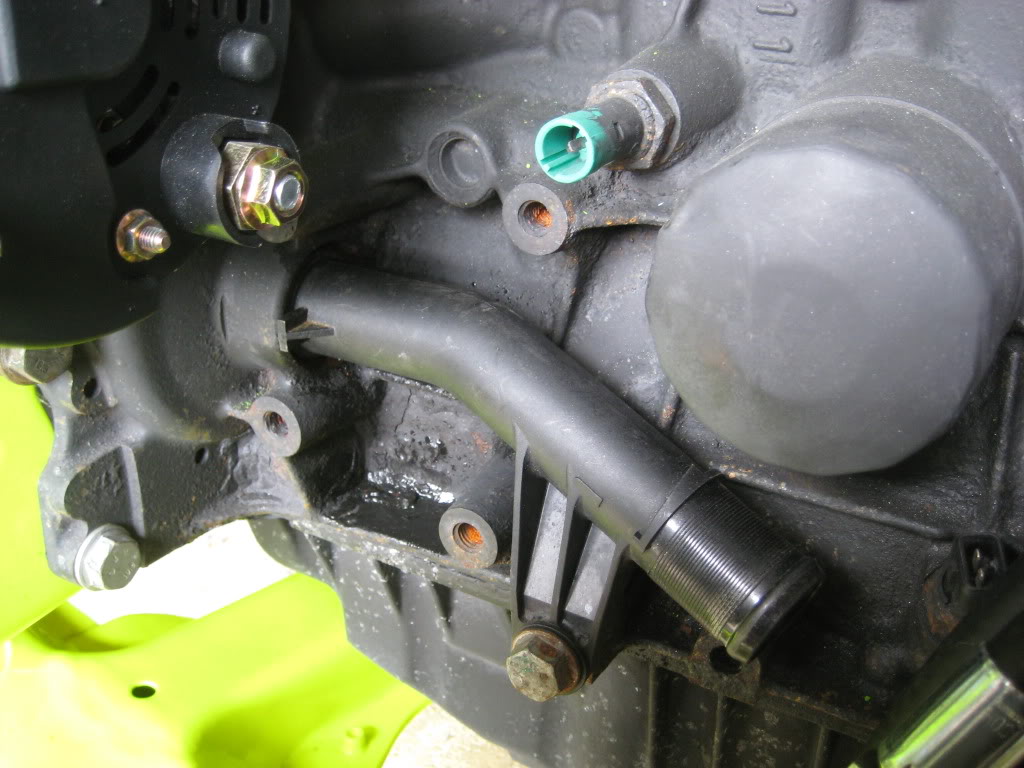

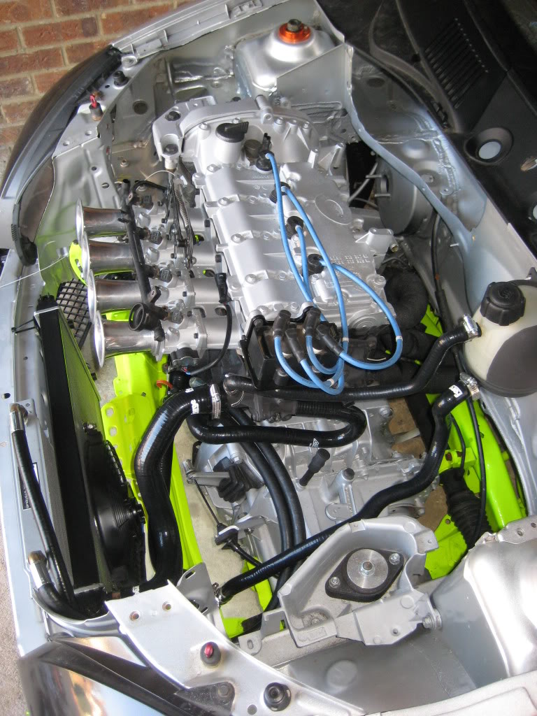

So i refitted the hard pipe
And started to fit the rest of the pipes

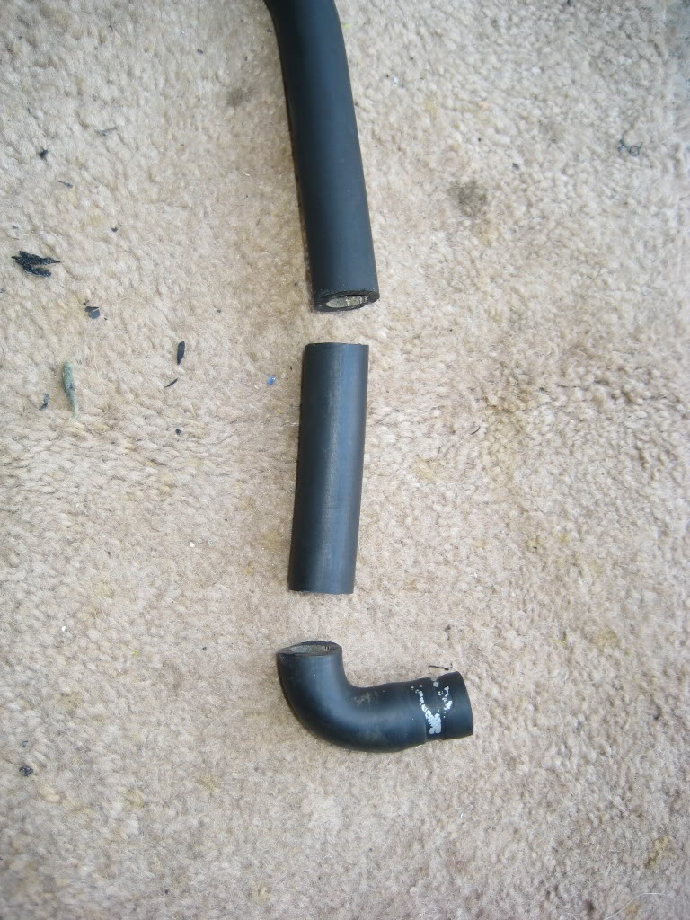

As i dont run the heater matrix i bought a 180 deg 19mm bend as the old coolant pipes used to kink when trying to just bodge it on.
So new pipe and and measured where to cut the forge pipe
Trimmed it
And used an old piece of pipe to connect them
All connected up, just need more hose clips
So thats the engine done for now

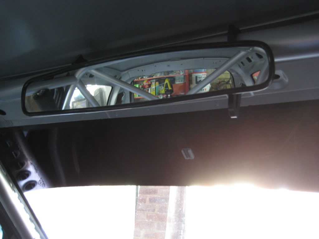

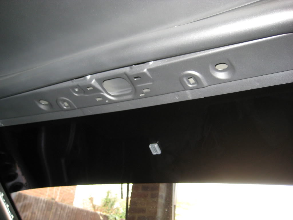

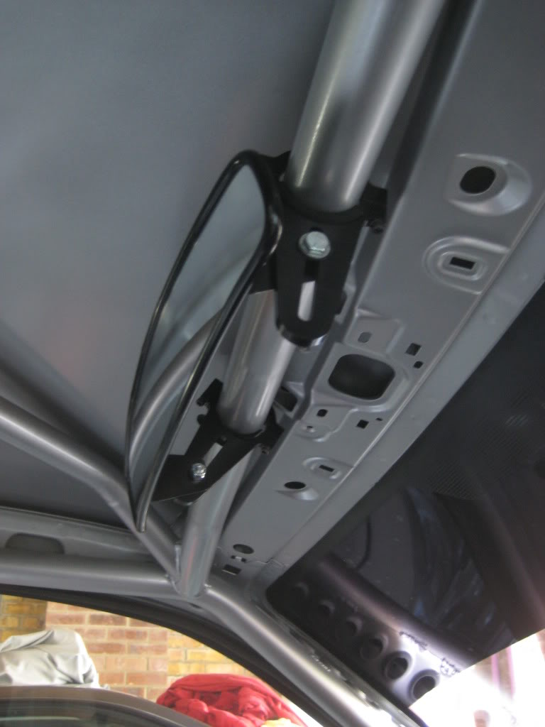

I then fitted my new motorsport rear view mirror which mounts onto the roll cage.
It was so tight getting it to fit because the roll cage nearly touches the roof in the place i wanted to put it.
Its really good because you can see out of the rear window and rear 1/4 windows so i would have tought it will be good when i eventually go racing :)

It's like a showroom race car, everything so clean at the minute. You'll look back after a few trackdays and wonder how it was ever this nice :)
  BMW M6 & 172 Phase 1
This thread just keeps getting better and better.
This car is almost too perfect, it really is a work of art right now. :)

Nice as always chris. You may as well cut the whole number plate bit out now. Holes are to messy by your standards ;) plus the additional cooling would help.
