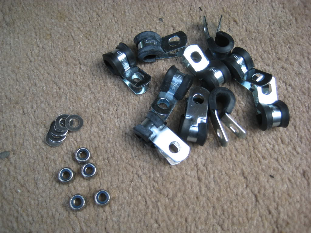

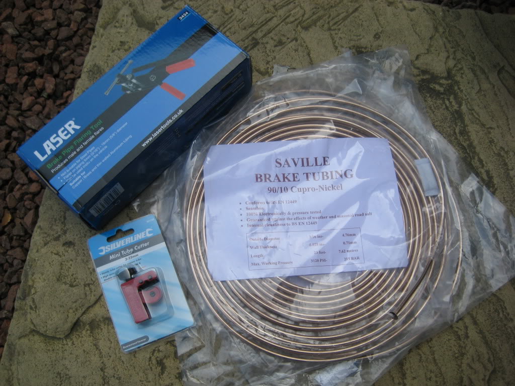

So today i got up nice and early to watch the GP and straight after it had finished i went outside to start work on the car. 9:00am start was quite nice and i started with pluming all the brake lines

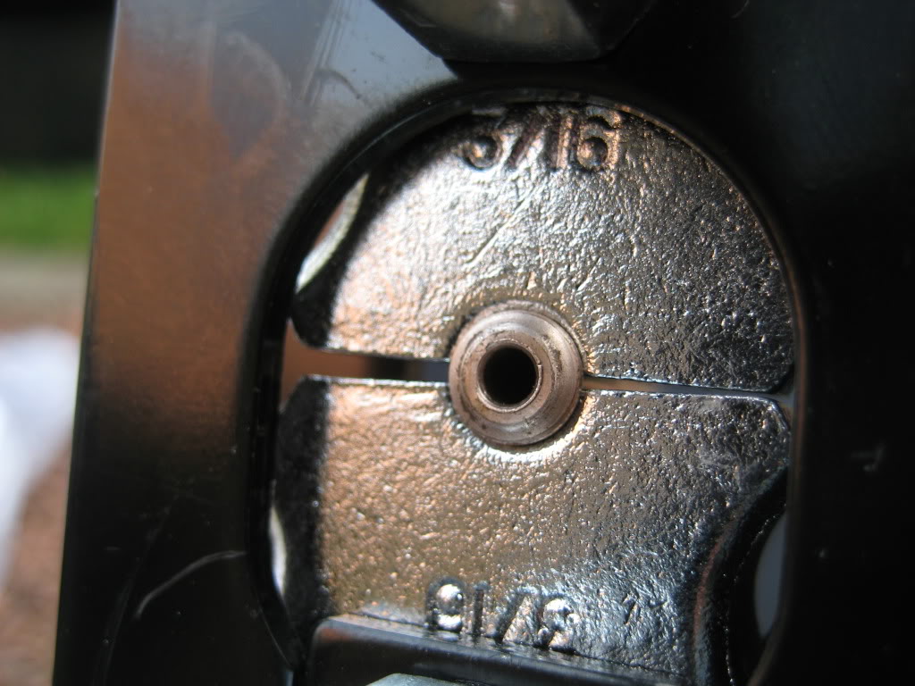

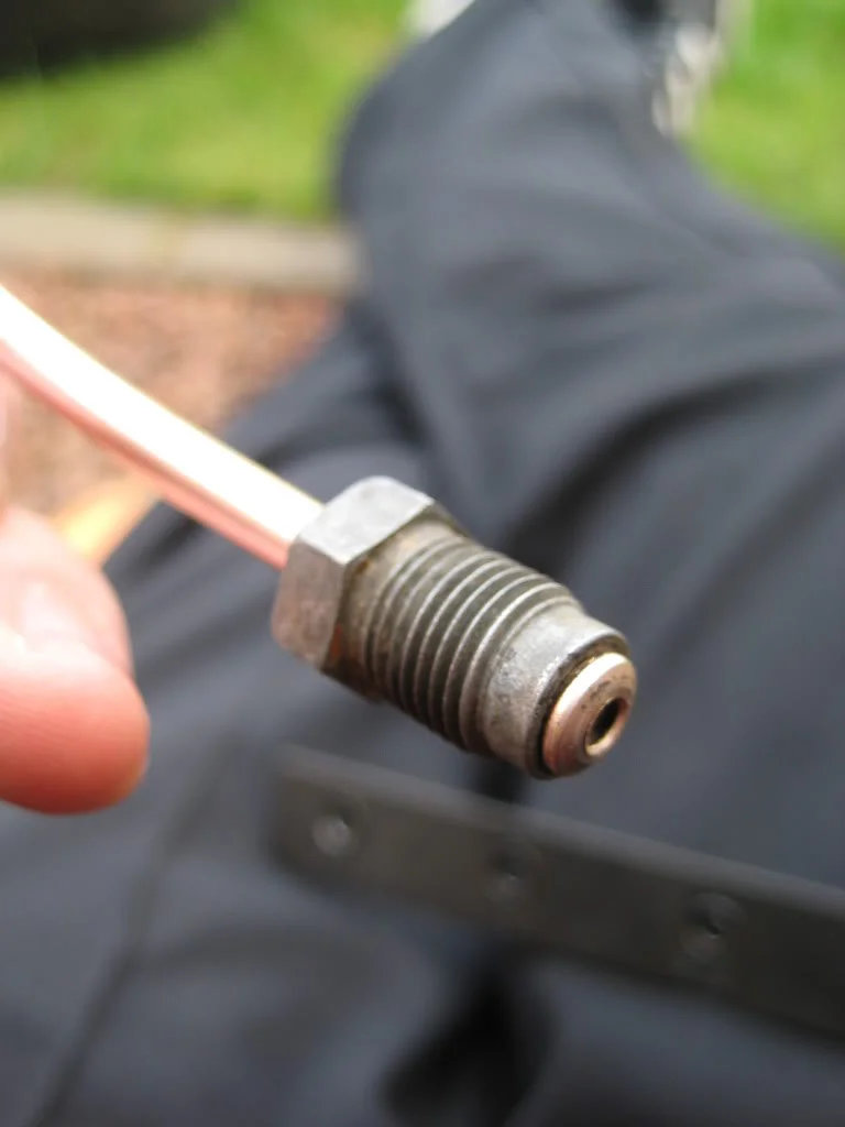

Here's the bits i had bought so i could cut the pipe & flare the ends with the standard fixings i had taken from the old pipes

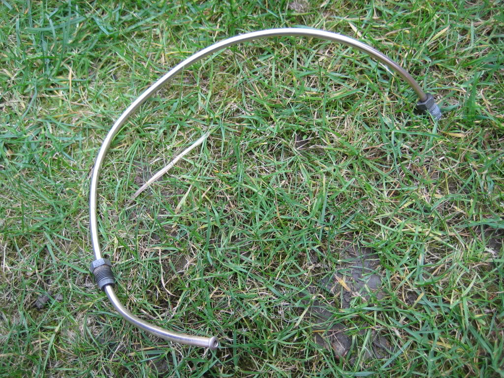

I measured how long the first one needed to be and cut the pipe and bent it so it would fit.

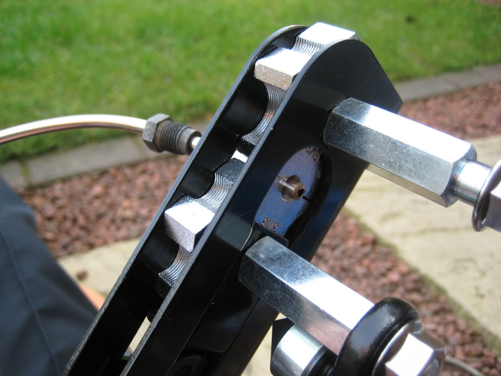

Placed the correct fixing on the pipe and started to flare it

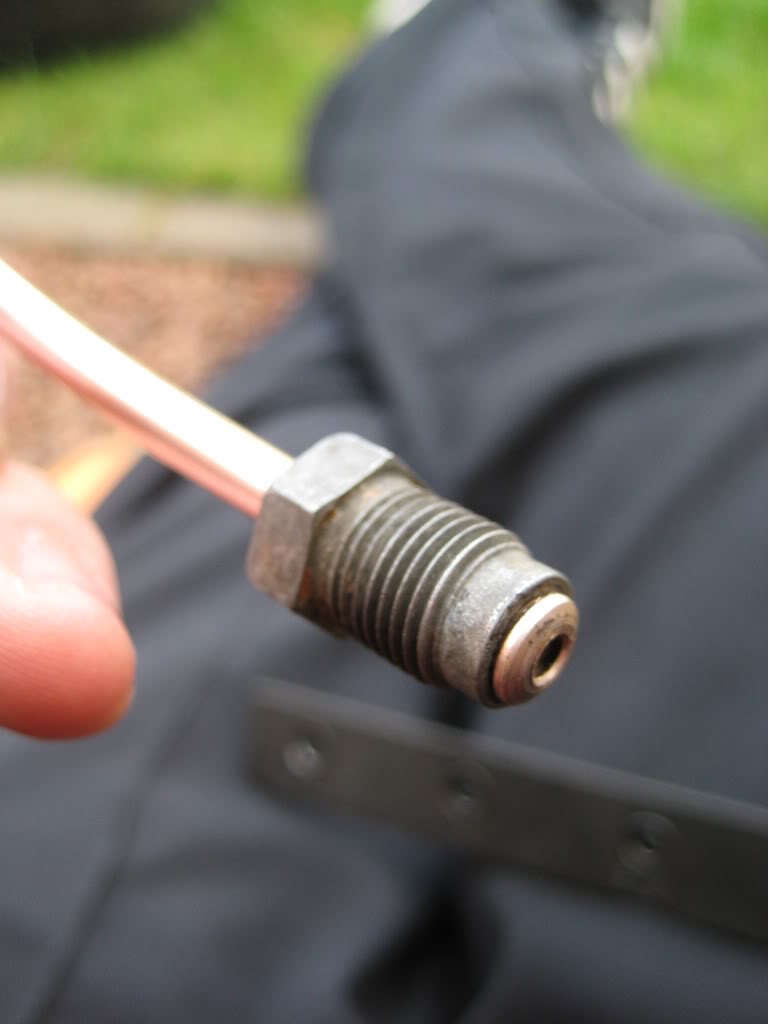

After flaring
And my very first bit of brake pipe

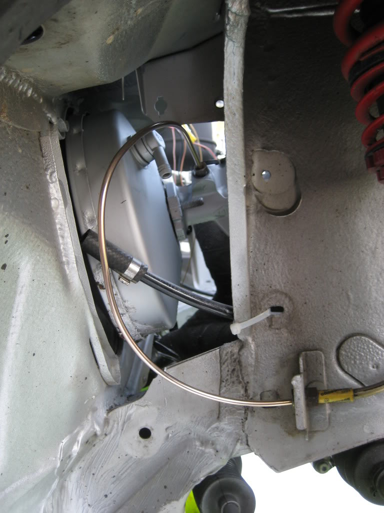

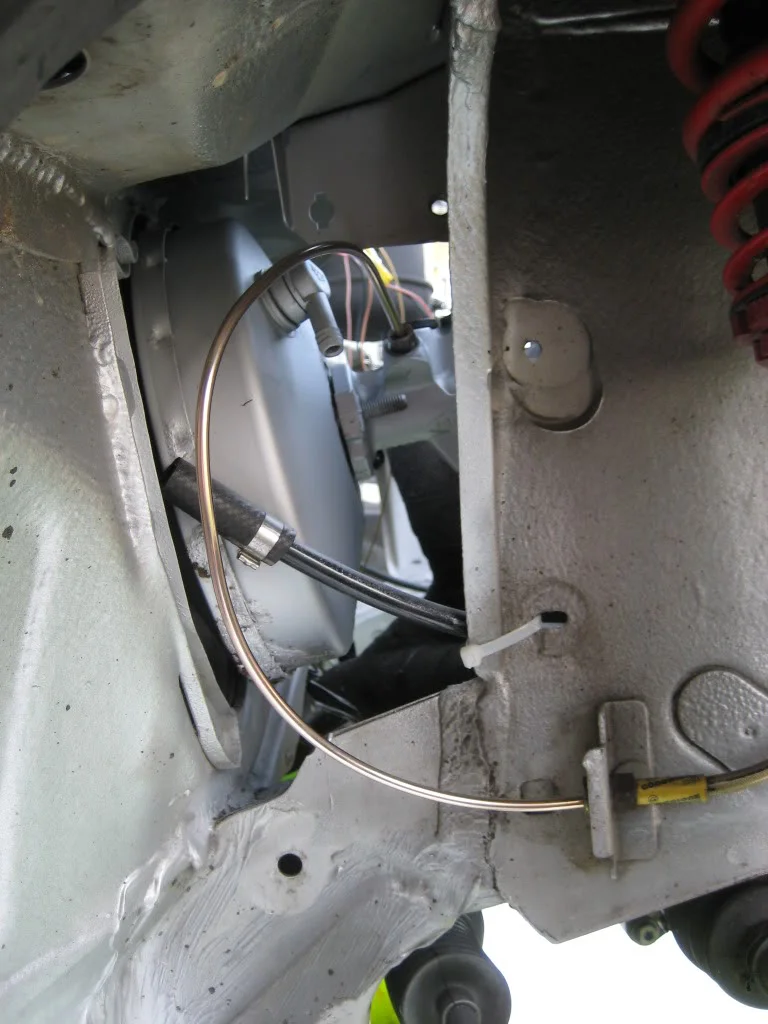

So I then attached it to the car :)

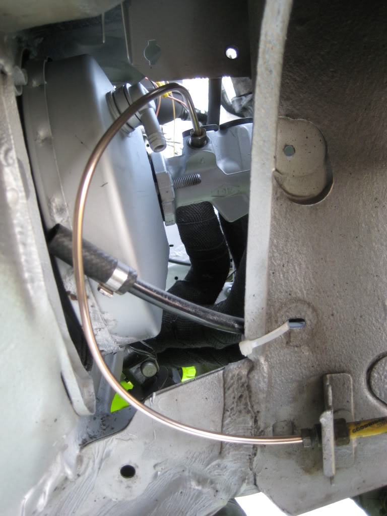

I then did the same for the front left brake
Ran the pipe along the crease so it looks nice and neat

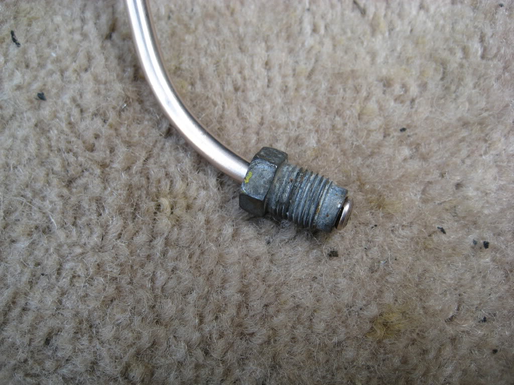

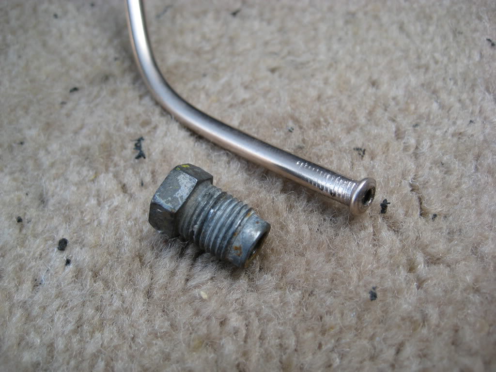

Went on to have the first fail of the day
DOH!
Chopped the end off and re did it
Happy days

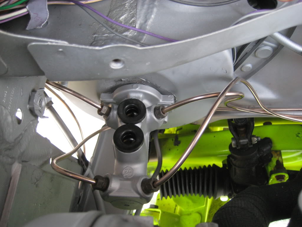

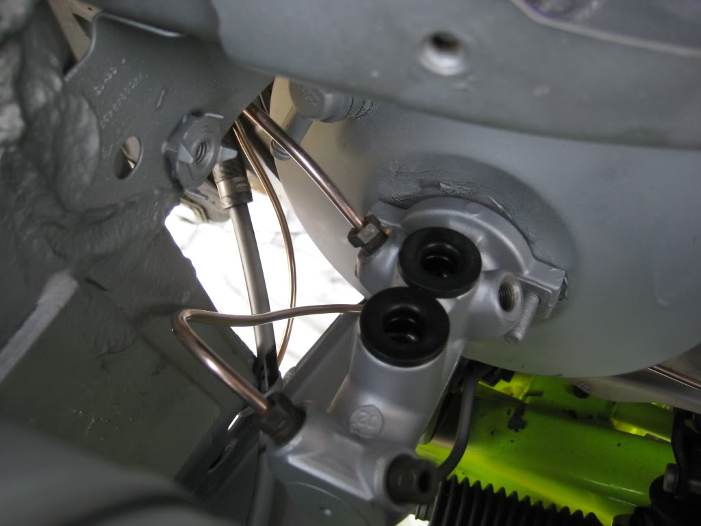

So all pipes coming from the master cylinder were done

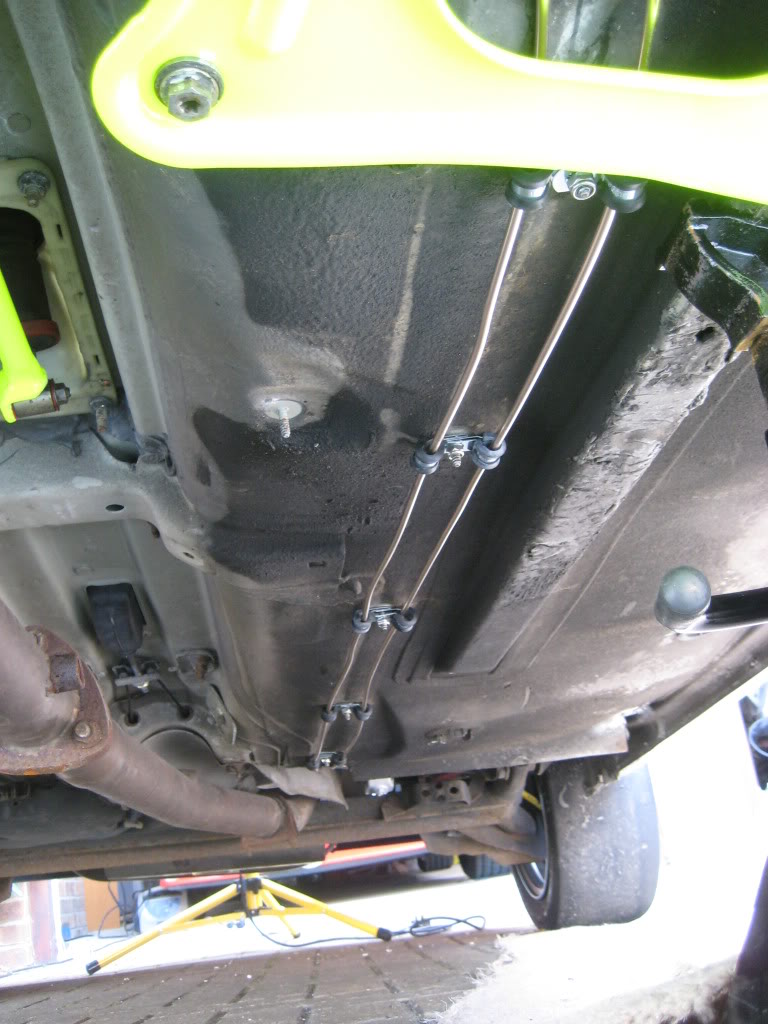

Now i did want to run them on the inside of the car but i really dont have time to be farting round with things like that so i ran them under the car
As you can see they just droop down as i had got rid of the crappy little fixings that used to hold then old pipes in place
Bought these ages ago

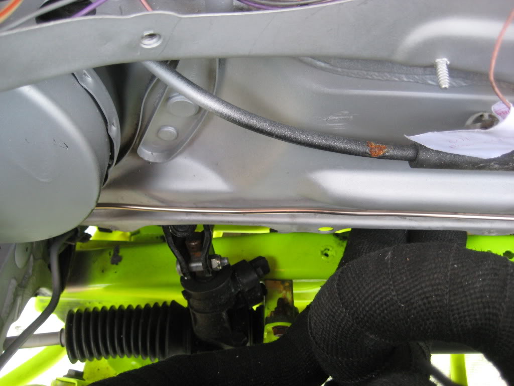

And now it looks like this

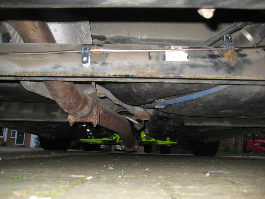

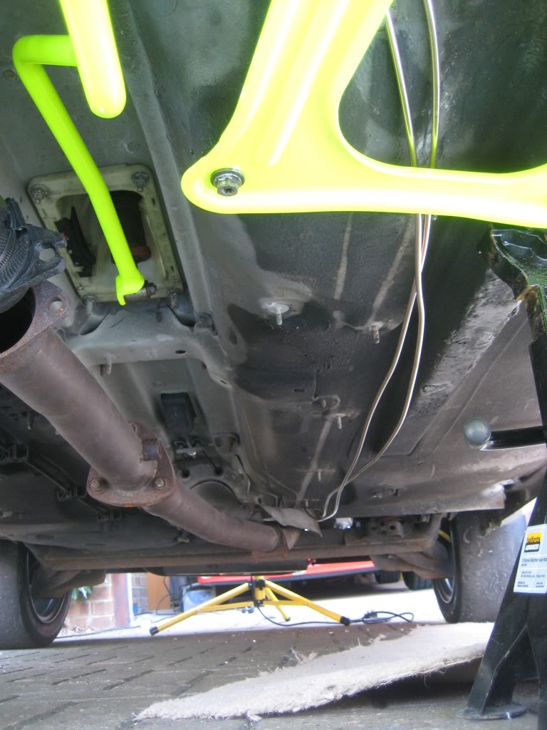

Oh and a shot of the rear line. Still need to get fix it to the beam.

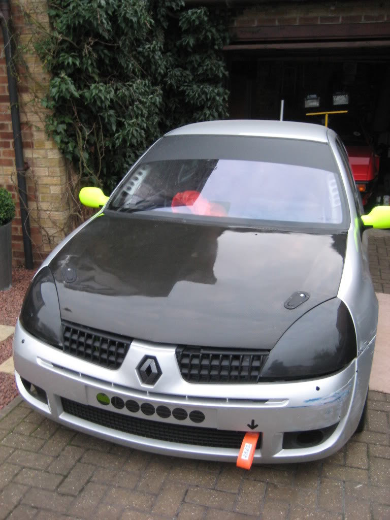

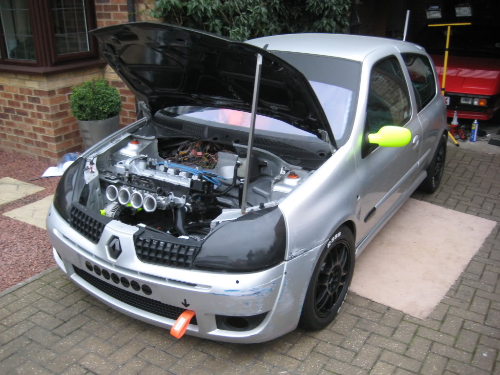

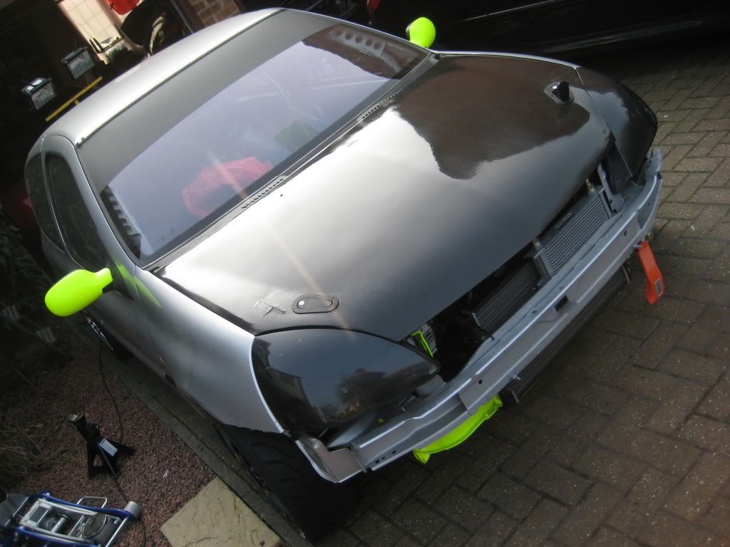

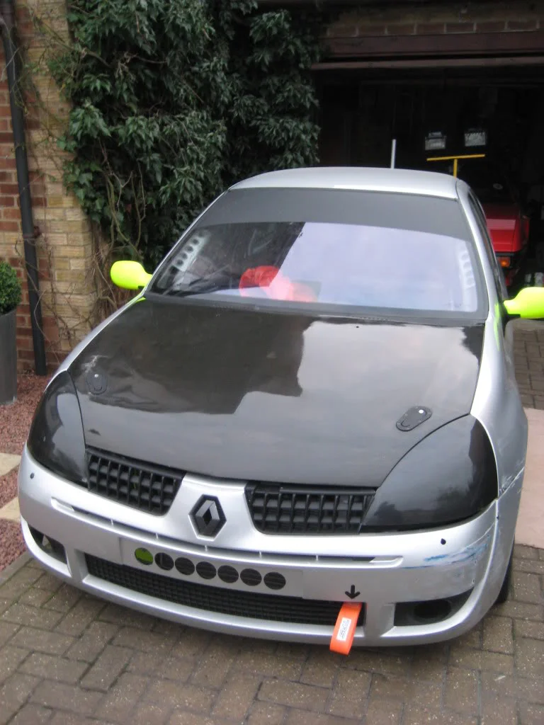

I also fitted my Carbon Firbre Bonnet with the areocatches. And swapped the wheels as i was getting bored of looking at the ultras lol
Took all the old glue marks off the boot where the plate used to be. I think i may end up hole sawing the numberplate section to help the air run through the car to help demis the windows and cool me down when driving.

why did you replace the brake pipes?
EDIT- no ABS
cup setup i guess? you shouldve fitted an incar bias valve, WAY better
EDIT- no ABS
I was going to use an incar bais valve but i just couldnt make my mind up with how to plum it all in so i've gone for the 172 cup set up yes.
I've used somthing like 30 feet of pipe because of having to repipe the hole system.
