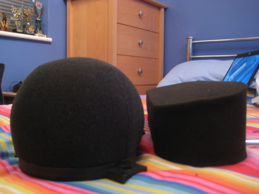

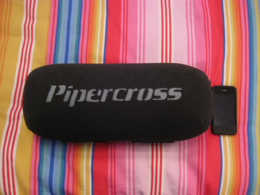

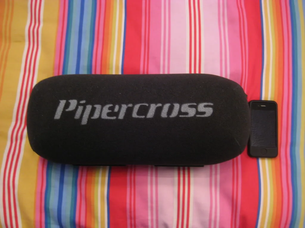

My new Pipercross C604D Air Filter which I bought through Dan at 519 Automotive, top bloke and he got me a great price on the filter http://www.519automotive.co.uk/
Its HUGE!!

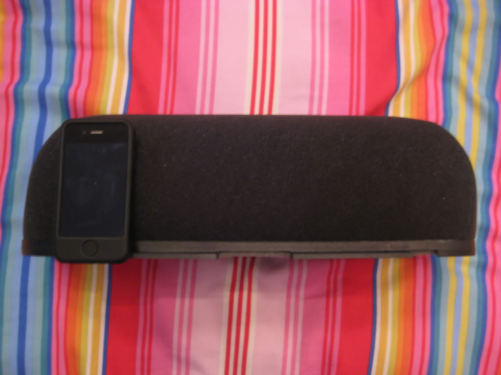

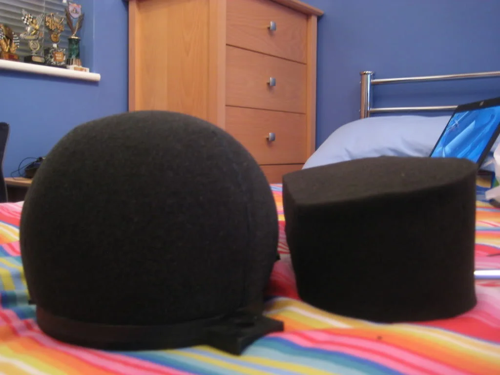

And a pic to show how much bigger it is compaired to the old ITG filter

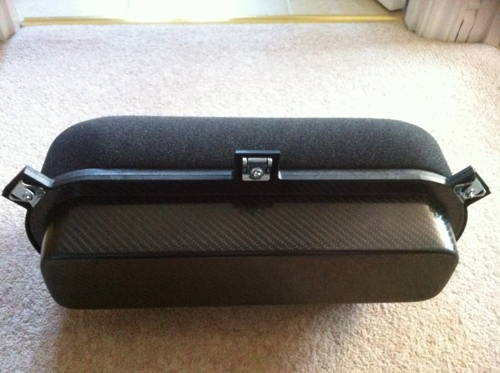

I have ordered my Carbon Firbre Backing dish from Reverie but as they dont have any in stock they are making on so it'll take just over 10days untill that turnes up :)

is that going to fit with the dished back plate?
Well I belive the filter touches/very close to the inner skin of the bonnet. So once i have fitted the backing plate i'll do a bit of neat cutting of the bonnet and hope it fits.

Yeah I wanted the filter I have because I may get bigger trumpets in the future. And bazzon & barron have this set up and it just fits in their car! It's a track car so if I have to gash open the bonnet then I'll just do it.
  ITB'd MK1
the one above fitted with just lopping off the studs for the bonnet catch, then bending it very slightly to stop it being under strain all the time. yours should curve just right to dodge the bonnet. Just.

how much bigger can you actually go with the trumpets? You must be at the limit there? Unless you remove the grill all together.

Mine fits and is a 604. Originally it did touch the fibre glass skin on the carbon bonnet but trimmed it back and it sits nicely.

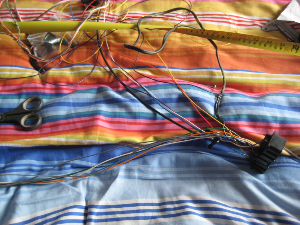

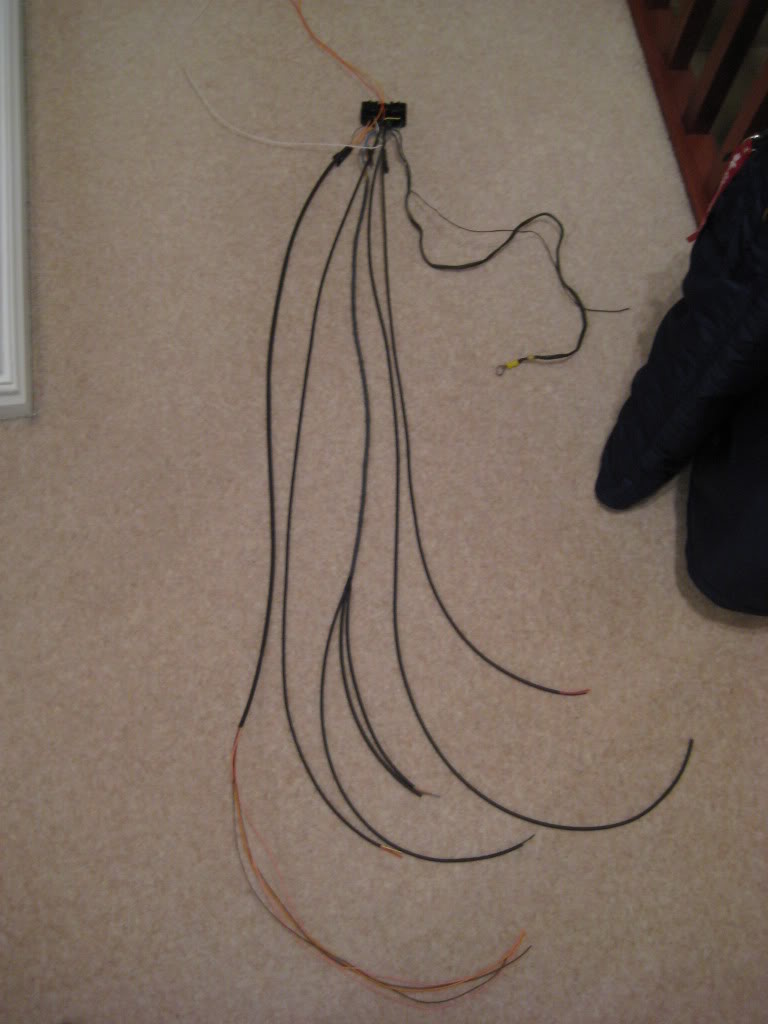

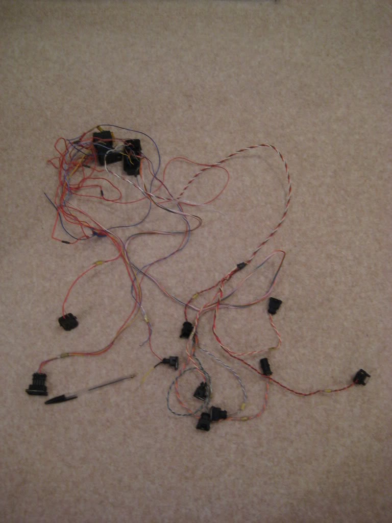

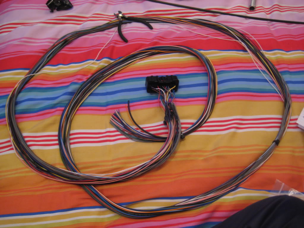

No the car doesnt start, but i have started to make my new engine loom. If you look back over this project 90% of my problems have been to do with electrics. So as the engine loom is very important then i have been taking my time. Measure twice, Cut Once.
Still have a bit to do but at least i know that if the car doesnt start then it wont be due to the engine loom.
So I bought this directly from Omex with all new connectors.
Then i started to find out which wires needed to go to which connectors.
So after lots of measuring and careful cutting i slid the heat shrink over the wires that needed it.
It needs a little bit more work before i put the connectors on the end but its a lot neater and better wired compaired to the old one
So I will hopefully get the loom finished this week :)
ALSO does anybody know what resisters go in the wires which spline off into the standard loom from the Crank Sensor?
Cro
  Meg'd r27
10k resistors to the standard ecu, not omex. I havnt fitted mine but that's what I've been told

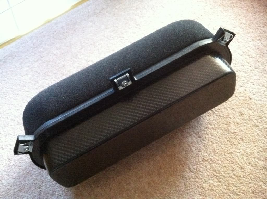

Not a great deal to update but I now have my dished backing plate from Reverie. It didn't take as long as they said it would take which was nice.
