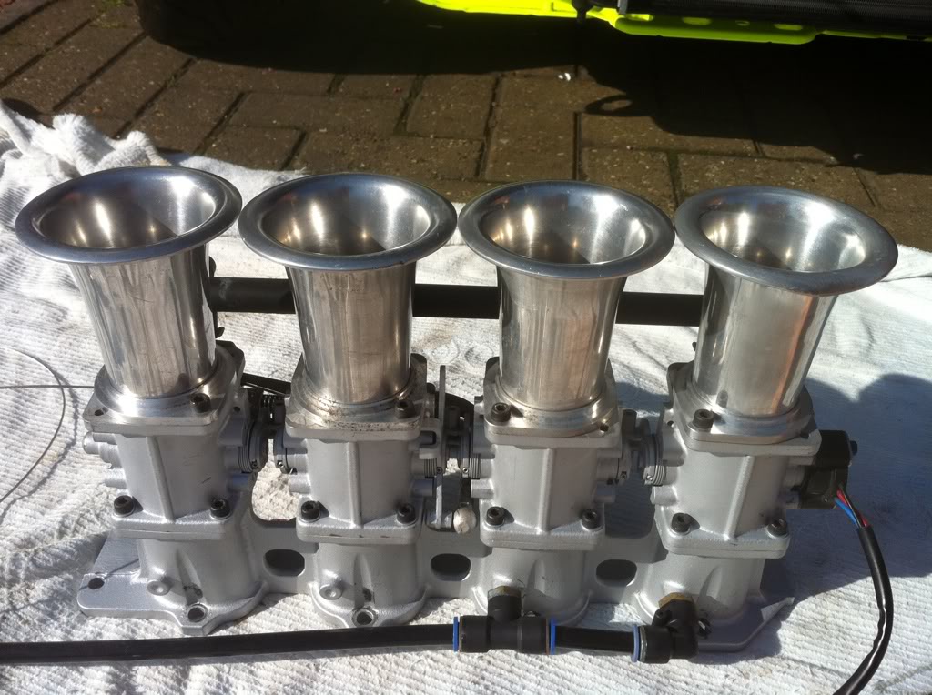

So first i had to remove the Throttle Bodies as i had to use them for my template. So after i had remove them i this is how they looked.

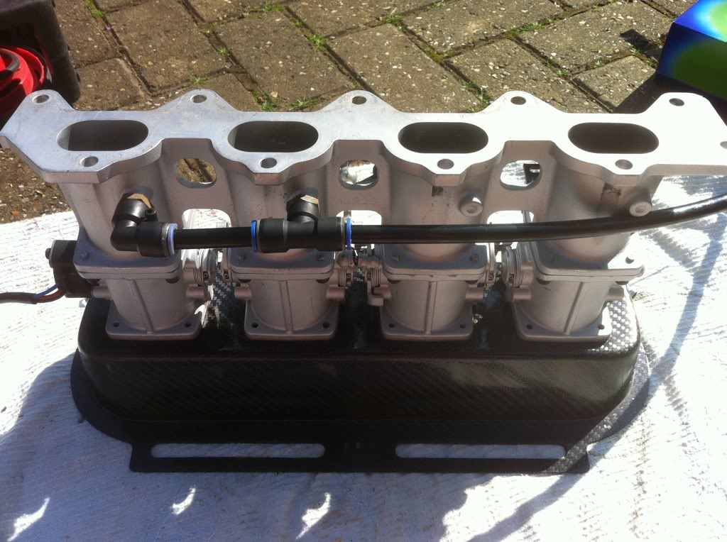

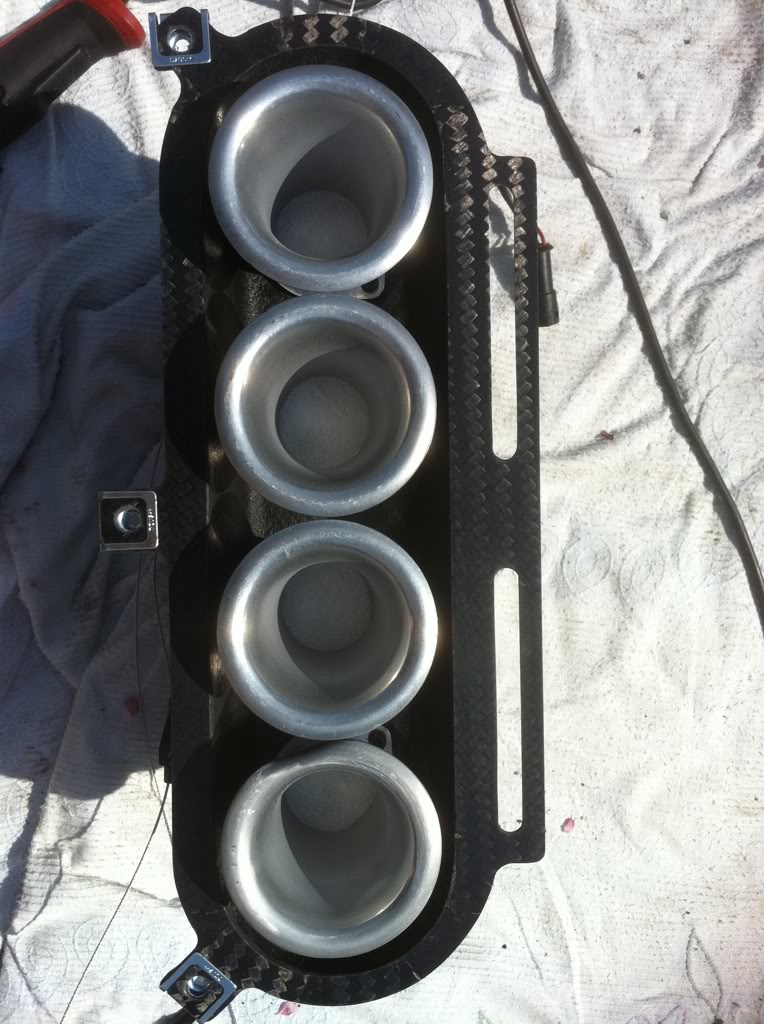

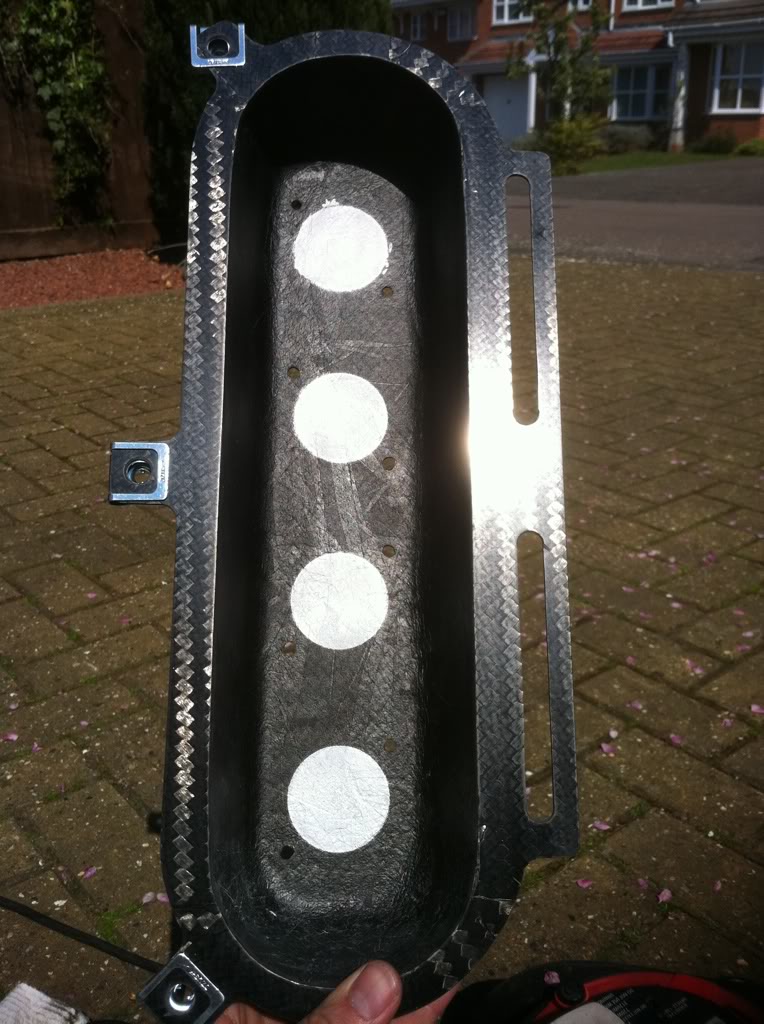

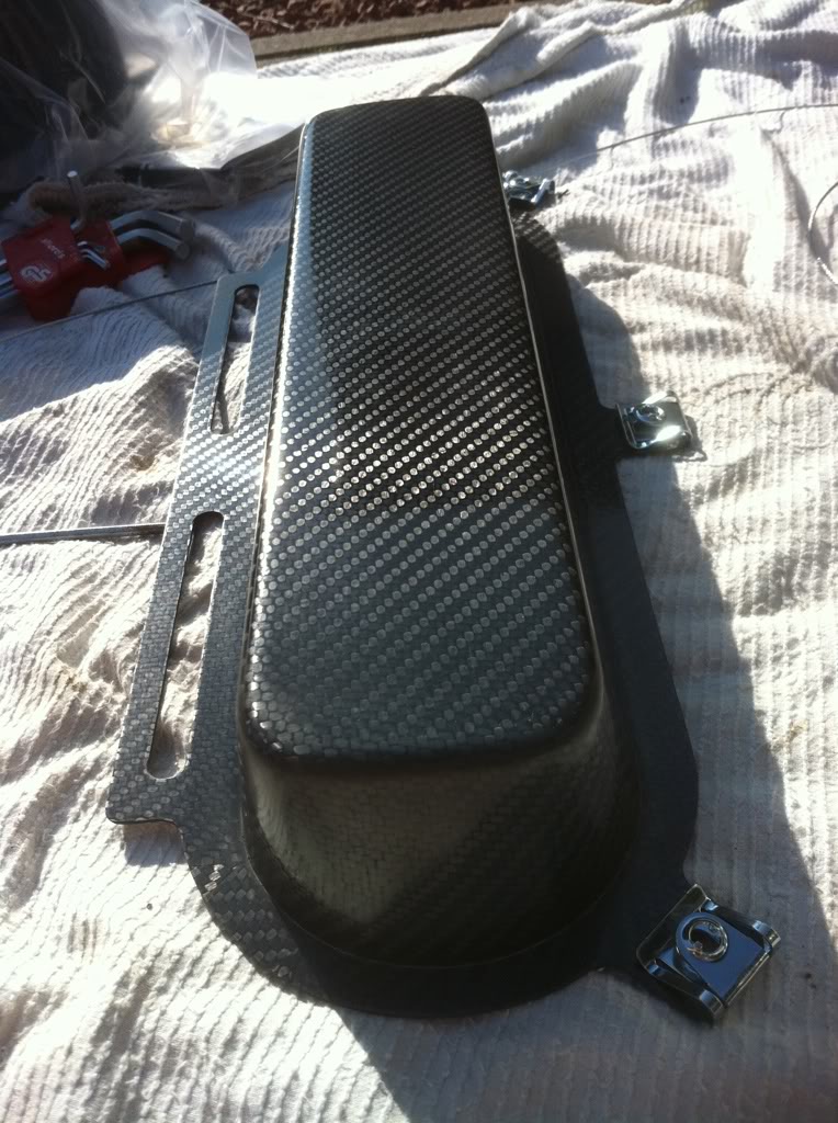

This is my backing plate that i got from Reverie, oooooo carbon firbre!!!
So i removed the trumpets first and placed the backing plate ontop with the trumpets to see if it fit.
The backing plate is literly 1/2 mm away from the fuel rail so that was a relife but a small part of the jenveys was catching it when opening the throttle so i had to bring out the angle grinder and quickly sort that out.

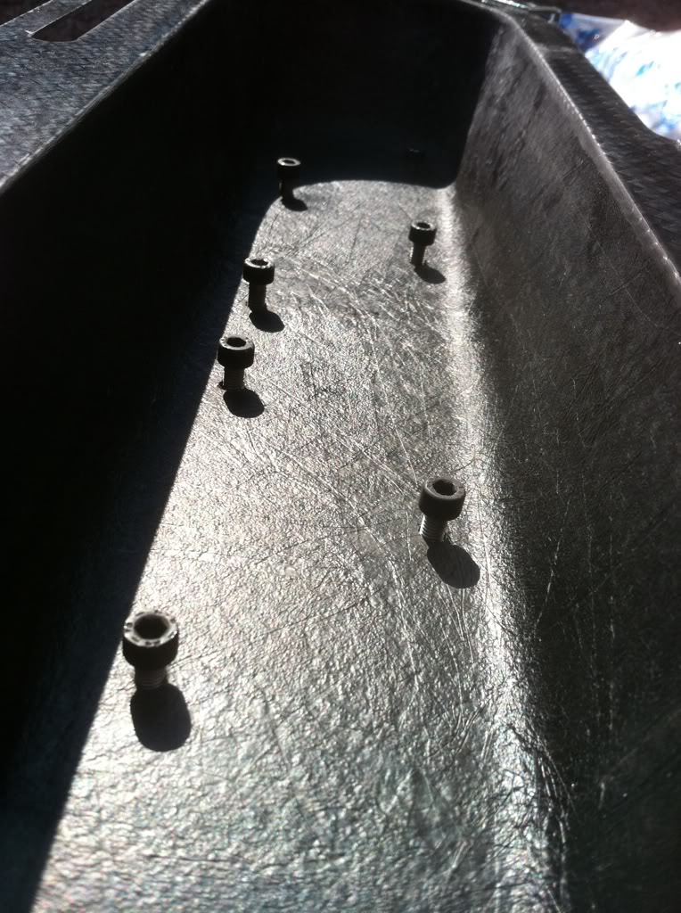

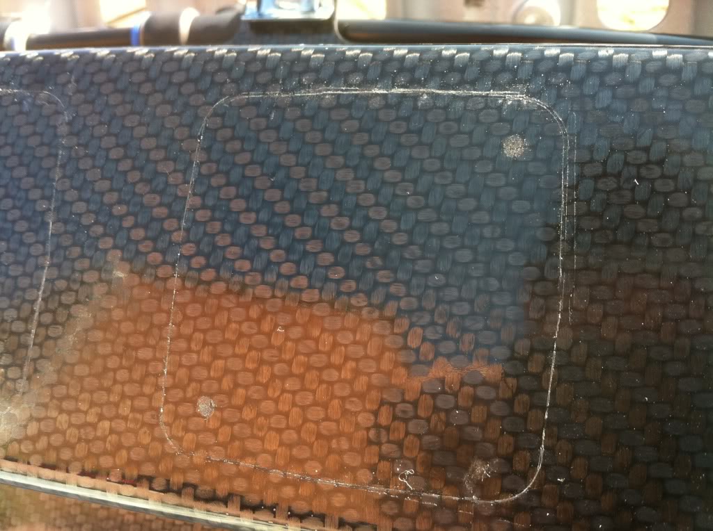

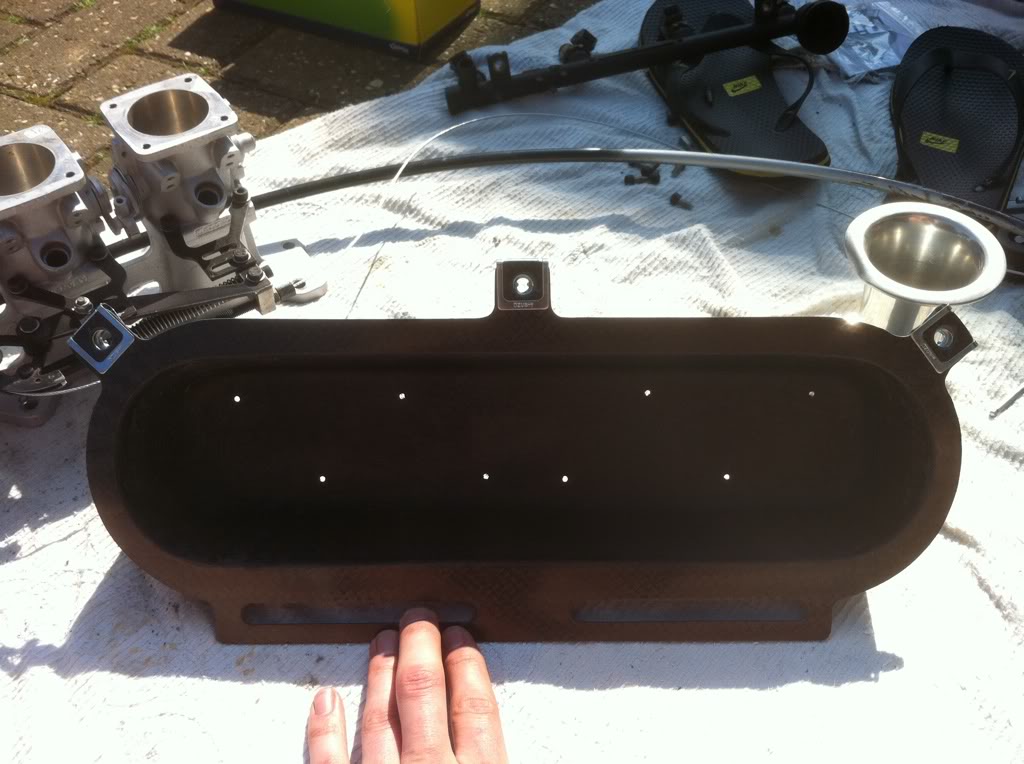

So i then fliped it all around and started to mark out what needed to be drilled.
All marked up
I used a small drill bit first incase so leave room to slightly enlarge the holes to get a perfect fit.
And then enlarged the holes to fit the bolts perfectly.

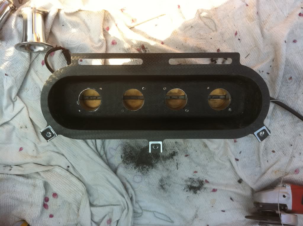

So after I had drilled the holes i then attached the trumpet so i could mark out what needed to be holesawed.

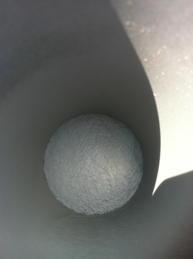

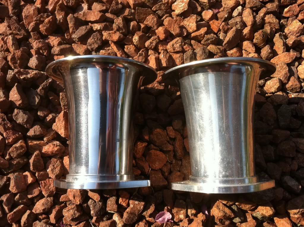

I decided that the best way to mark it out was to spray some spare silver paint down the trumpet and it would show me excactly what needed to be removed.
Here you can see the paint down the trumpets
Trumpets then removed

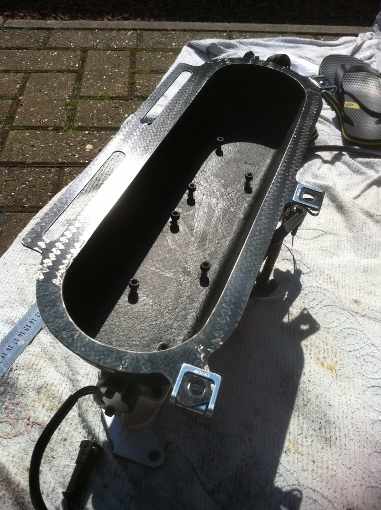

Then with the correct size hole saw i cut the hole and filed off the little bit of excess material.
Now obviously there was some paint inside the trumpet and i simply removed it with some metal polish. The trumped needed tidying up anyway

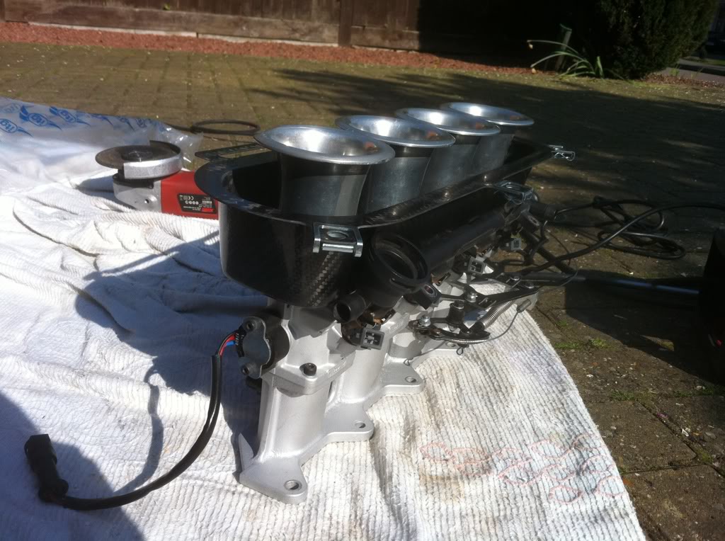

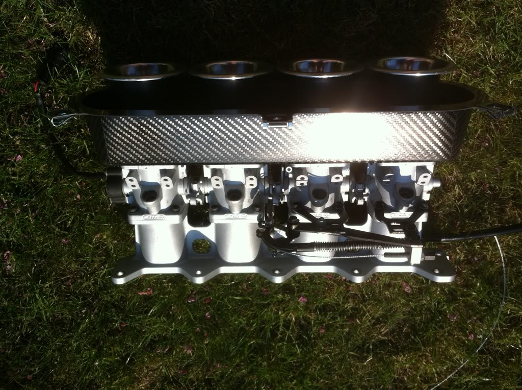

After that was all done i rebuilt the backing plate and trumpets

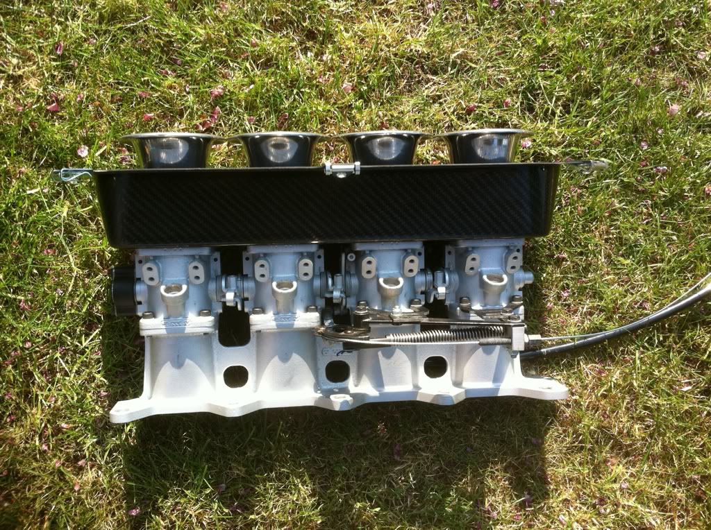

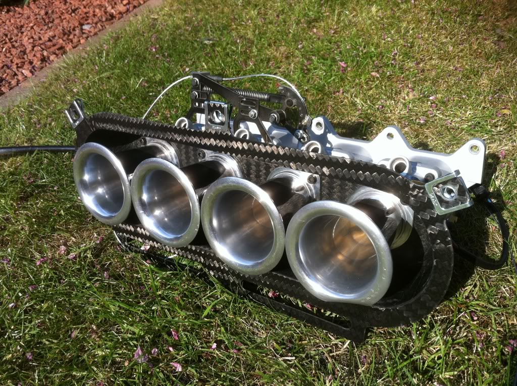

And then I attached the ITB's to the car for the LAST time i hope!!!!

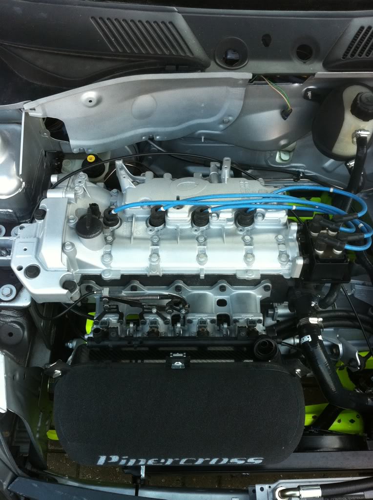

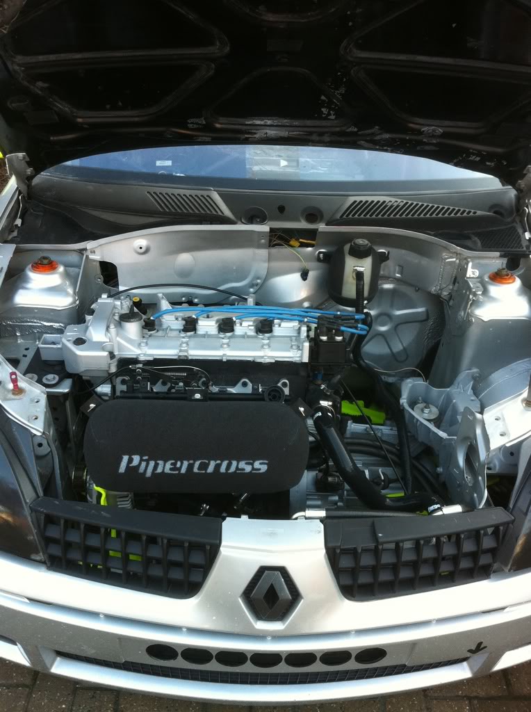

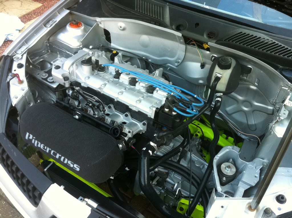

I then poped the new filter on
I took some decent pics on the DSLR so will post better pics of the engine later (pics taken on I-phone)

So yeah very nearly finished :)
Epic, cant wait to see it on track. Be careful not to get it dirty ;)
Thanks :)
I have 8 trackday to fit in this year so its going to get as much use as poss. I only planned to tidy up the engine bay a little but its turned out quite nicely now.

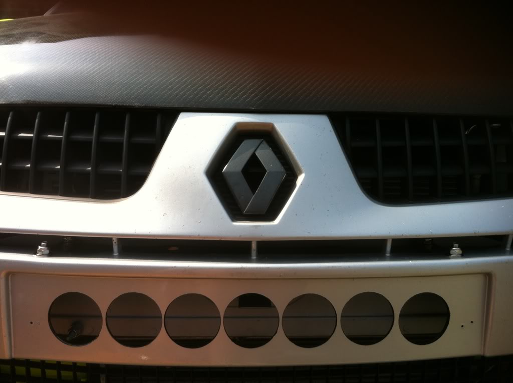

proper filter!
Yeah its HUGE, i had to cut quite a bit off the bonnet :S but its all neat which i'm pleased with and its still strong :)

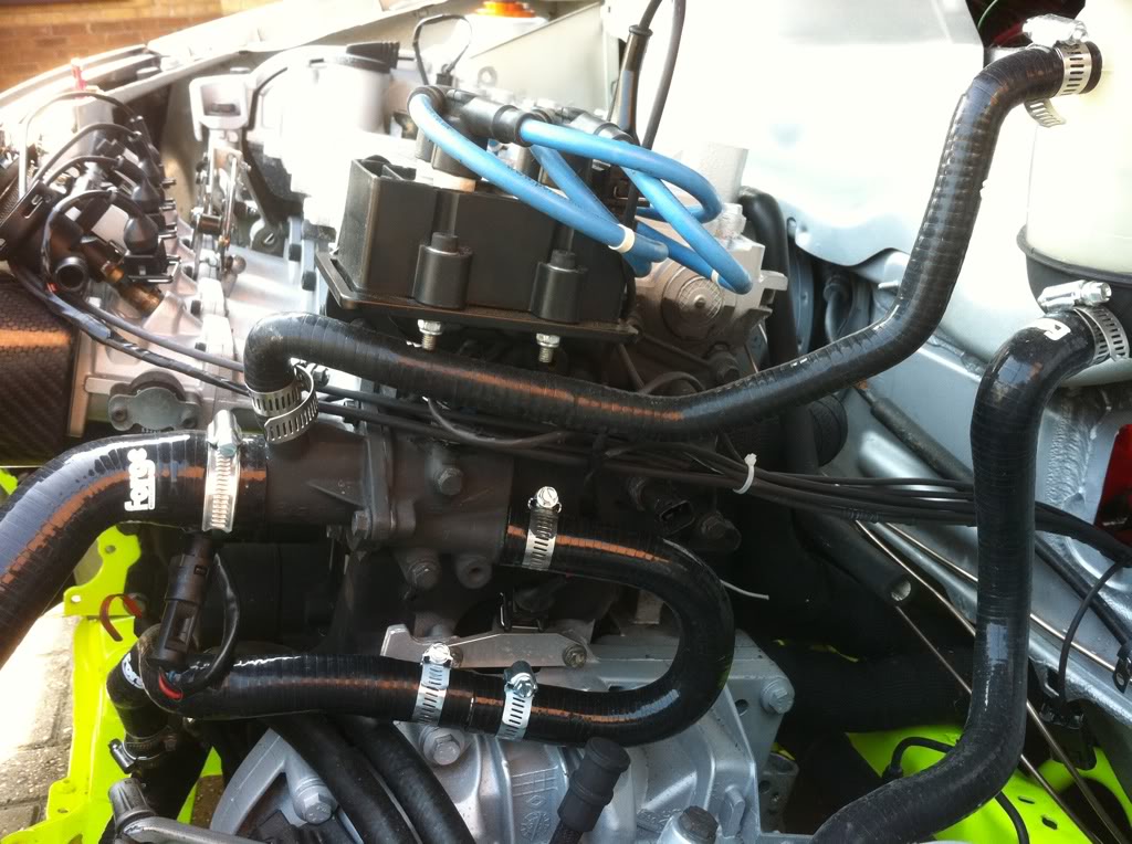

Another update.

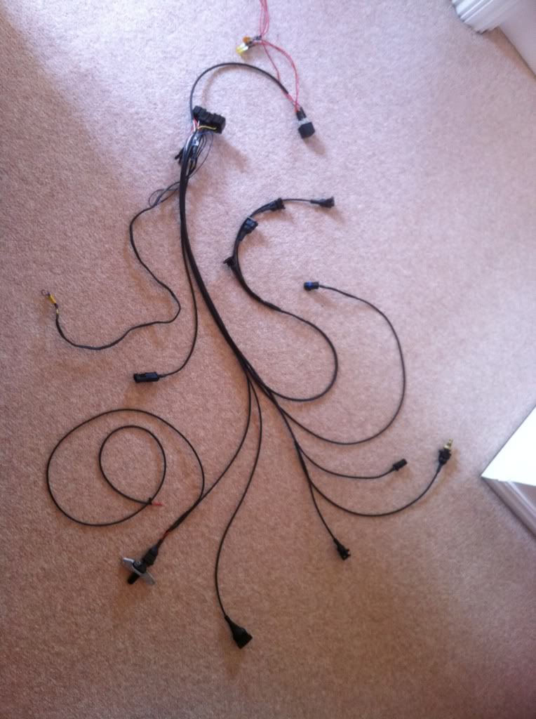

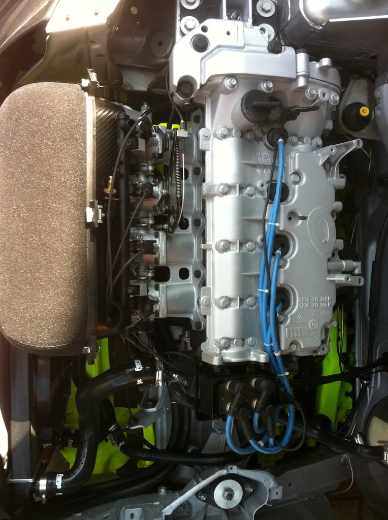

Finished my new engine loom, every connector had been measured out perfectly so I have no excess loom to make the engine bay look messy!
Now it's all connected to the right sensors :)

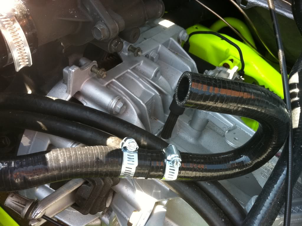

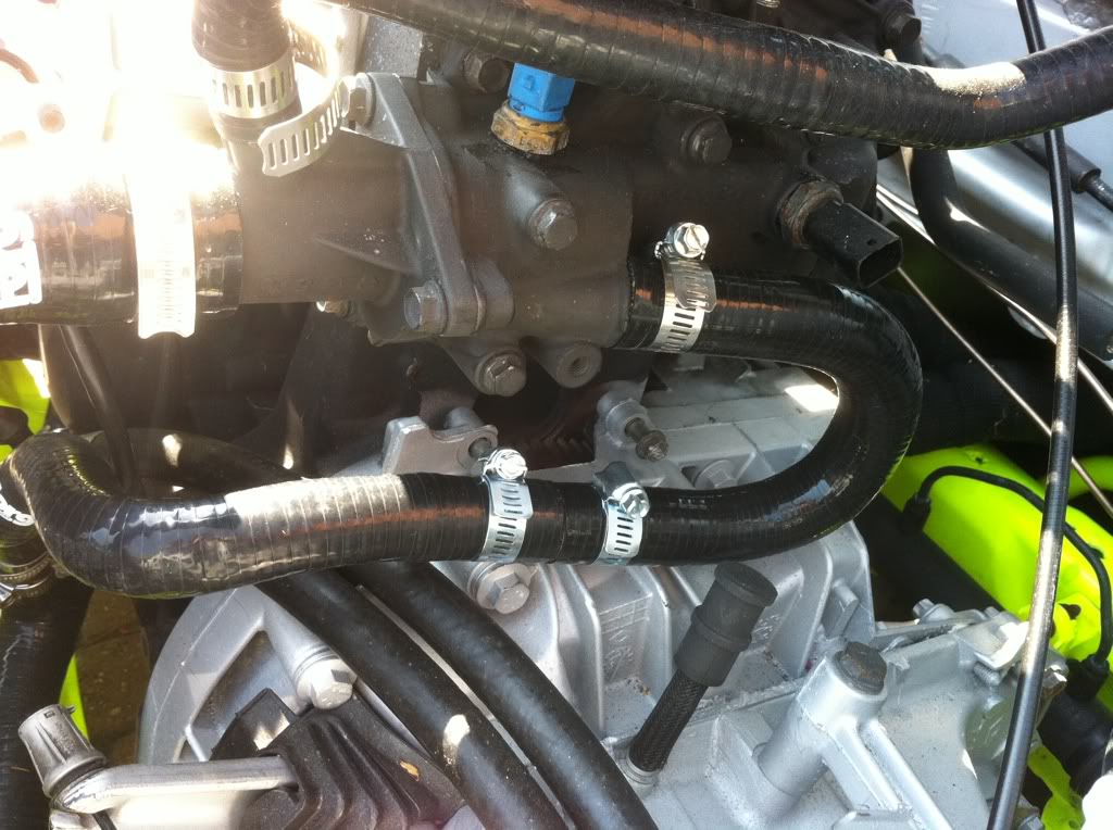

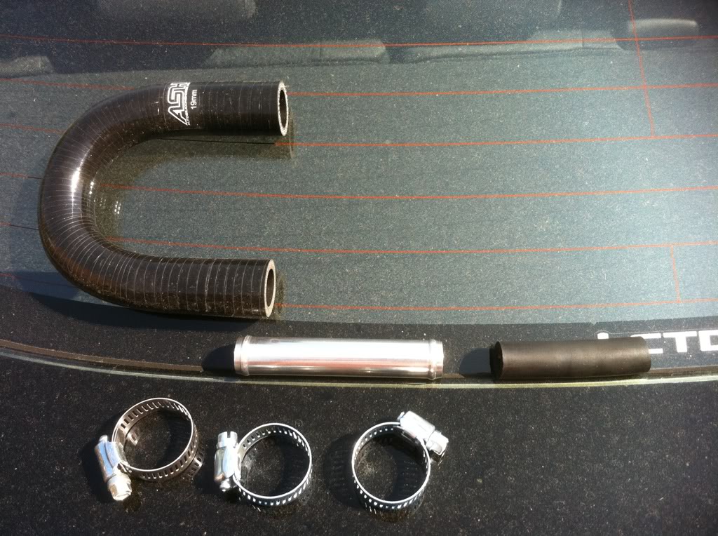

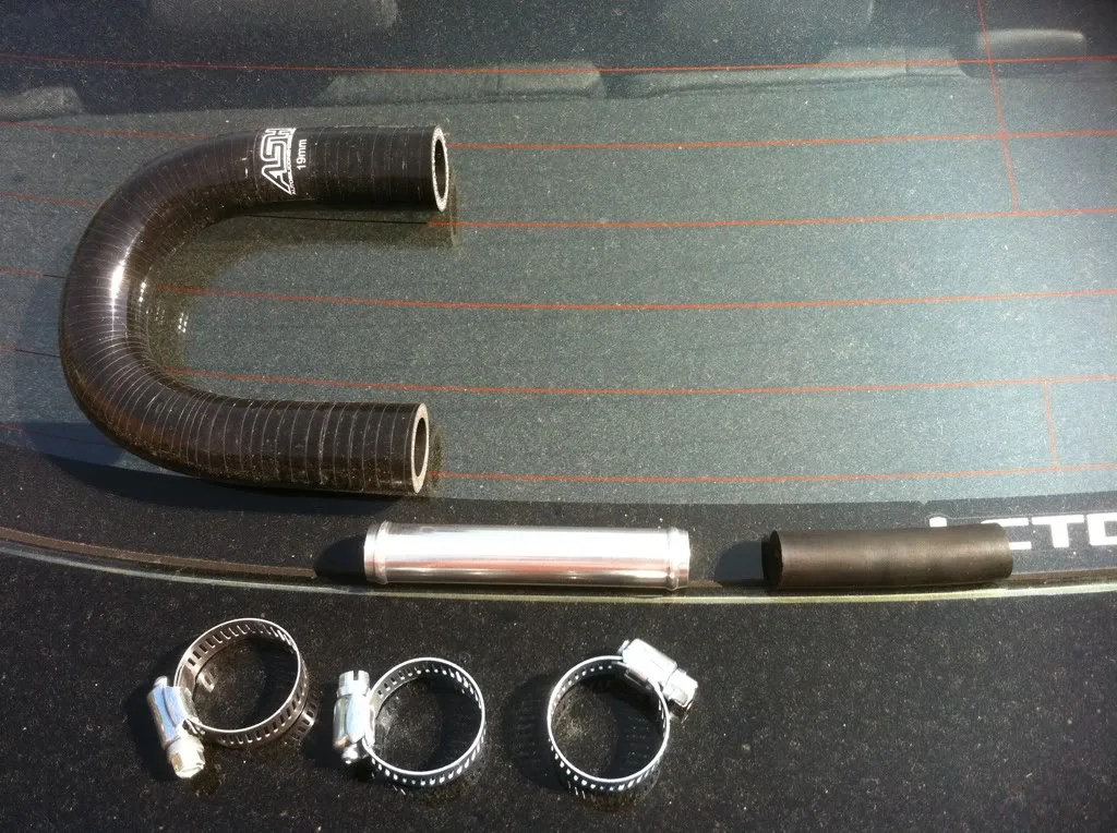

Also finished off the heater matrix delete with a proper alloy pipe and hose clips

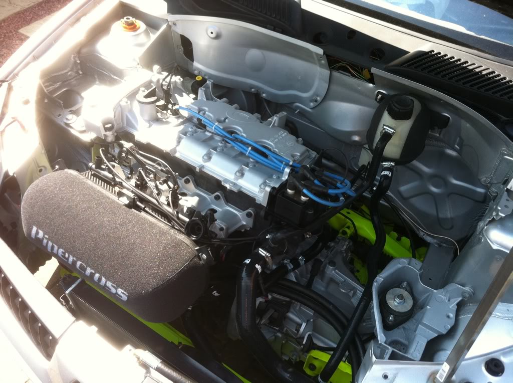

Hoping get it running (not necessary finished) in a few weeks. I am so busy during the week I am struggling to find time to get the last little bits done. But I finished rebuilding my dads car yesterday so at least I only have to get 1 car done now.
Tony what's wrong with the hose clips I have. They seem to have a tight grip about the hose but I have not filled the coolant up yet! Never even bled a rad before lol! Might need to do some searches.
  182cup & 172 racecar
We had a couple of those and go tight then suddenly slip.There is a bleed screw on the t'stat housing(10or8mm bolt),you can see it just below the temp sensor switch in the picture,below coil pack.
  340i
What Tony said, they are cheapo hose clips, I've seen a few of them fail... perfectly tight, then dropping off!
Get some decent jubilee clips on there Chris ;)
  Qashcow
I had those hose clips in mine for 3 days, they're gobshite and most failed. Will be worth piece of mind to change them :)
Rest looks minty mint
