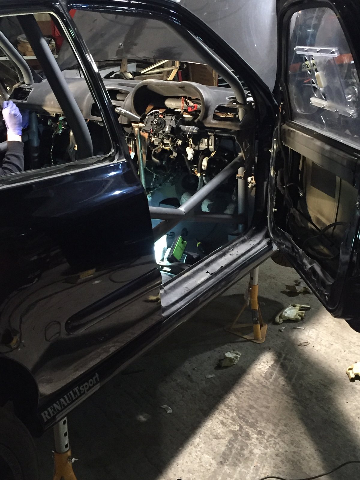

@sonny172cup looks nice I'm wanting to run just a top dash like you have, what have you used to secure it I was thinking of just cable ties to the dash bar but I'd need to mount the heater controls somewhere so not to sure what to do really
I have removed the dash bar as well. There are three metal home made brackets bolted to the original earthing bolt points, these are then bolted to the dash, and one tied to the steering column, the back of the dash has the standard 3 torx25 bolts at the back as well. Its very sturdy and is firm.

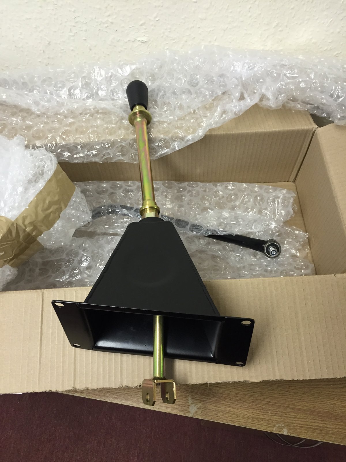

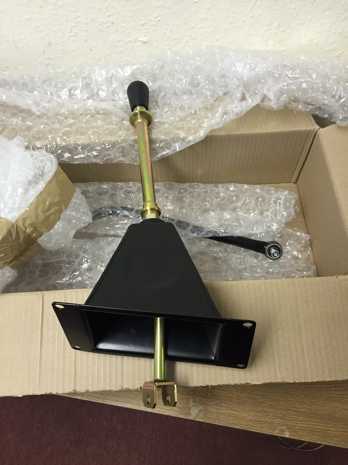

So last night I finished painting the interior so now I can go about fitting my car back up, previously had a bms shifter but I've opted for a pure Motorsport shifter now so looking forward to see what they are like, as normal with the pure Motorsport products the finish is second to none! Stay tuned for more updates
Why the PMS over the BMS? Is there much difference thought they was the same design.
On the topic of shifter, I love the standard Clio one, think its perfect.
BMS one still has rubber bushes I thought?
PMS is all spherical bearings...
May be wrong though as I've never seen a BMS one.
I liked the standard one too to be honest. Was reluctant to fit the PMS one but glad I did it's such a nice bit of kit.
I much prefer my BMS shifter over the clio one, and ontop of that i prefer my PMS one to my old BMS one.
Maybe because it makes a good mechanical clunk everytime I change gears.. But yeah feels a lot more precise than the BMS, but i had no qualms with the BMS one.

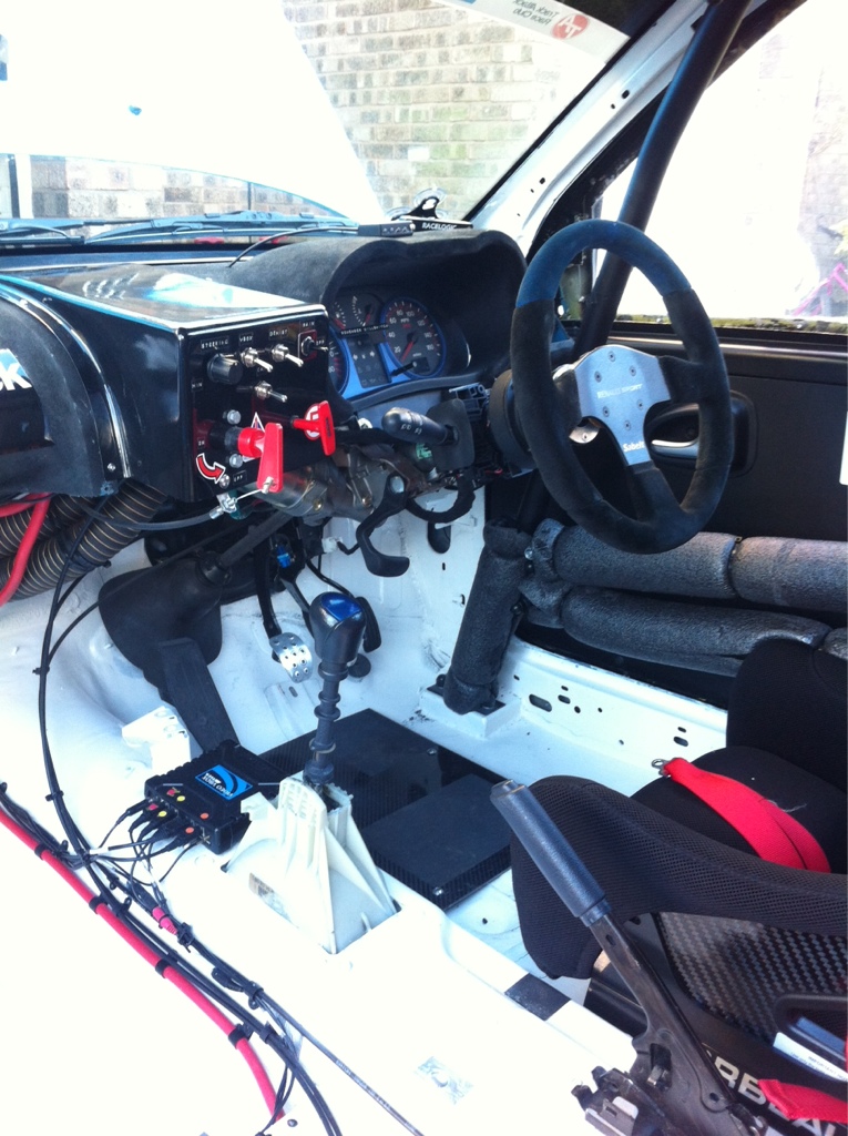

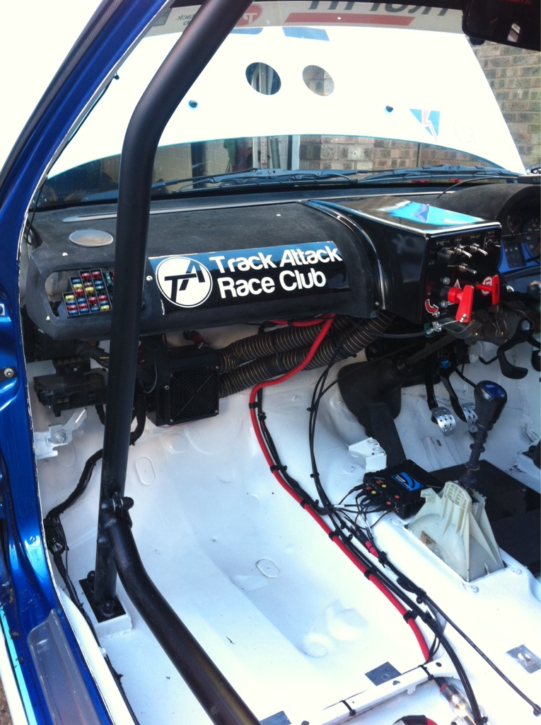

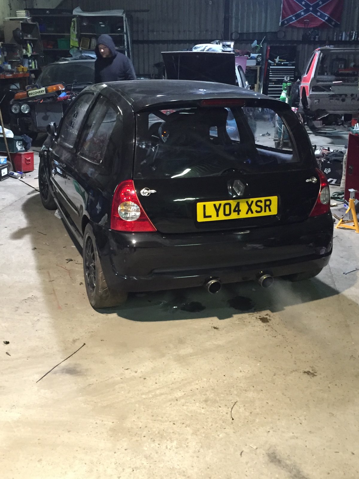

Well more progress today, got the car started but it's somehow running on 1 cylinder I don't understand why as I've not touched it engine wise but I have a friend coming over tomorrow with another Clio so I can swap coil packs and all the rest of it to fault find! But any way doors are on and dash is in!

@seanconnolly I notice you have cut your door out....how do you open and close your door? also have you got a close up of the bolts/spacers used to push the window to the door to keep it tight seal?

Have you got the leads in the right firing order? Numbers are on the coilpack, cylinders start at Flywheel end (C1@flywheel).
My mechanic who originally built the car last year checked all that and was found to be correct mate, can't wrap my head around it as nothing in the engine bay has been touched, changed fuel tanks it wouldn't start so tried it a few times then when my mate came up to the unit who built the car got it running it would only run with the throttle being pushed it wouldn't idle and it sounded horrible! Could be a coil pack or injector down I guess but like I say it's not been touched so I'm worried it could be terminal now ?
Hi mate yeah I cut the door out I just grab on the wire and pull the tab at the end, I am going to cut some carbon or plastic and have a door card made and I'll just loop a cable tie round for something to pull on I guess
As for the window I just stuffed it up into the top rubber and siliconed it in at the bottom, been fine for about a year and although it does let a bit of water in its definitely not the worst I've seen lol

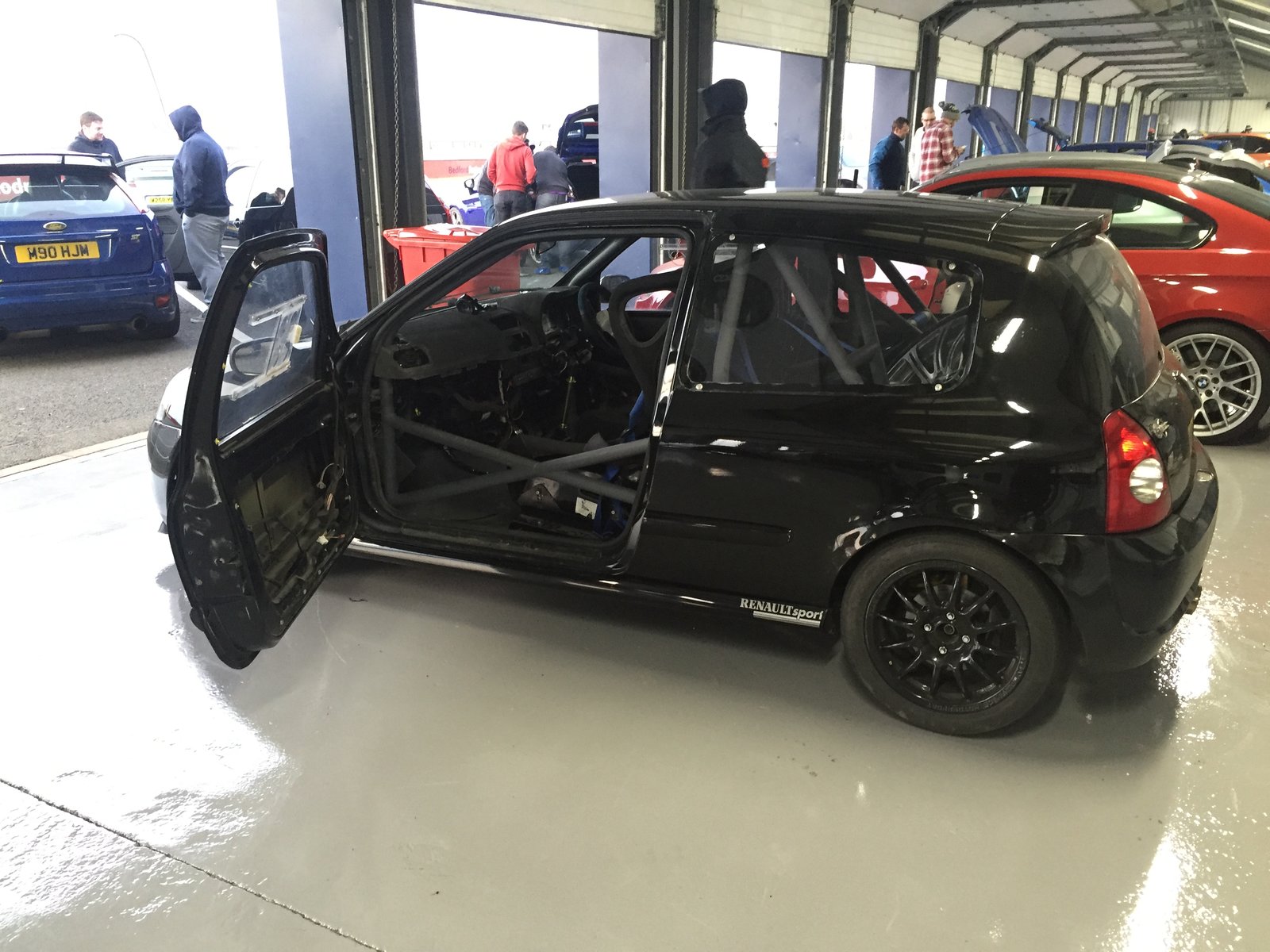

Well it's going to be tight but the car is up and running tomorrow the windows are going back in and then the bootlid will be fitted, what's the deal with not running a dash as I don't know if I'll have time to start cutting around the cage before Bedford on Saturday
You'll be fine without a dash bud, obviously make sure loom is pretty secure though.

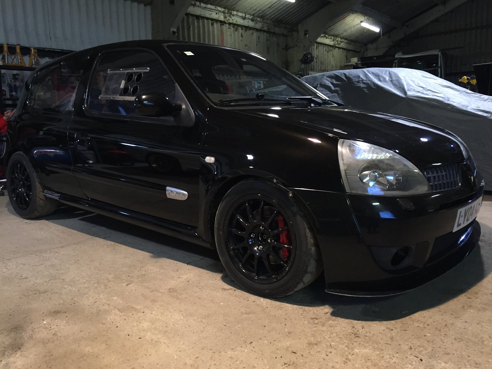

Spent a few hours going over the Clio with the machine polisher came up lovely and also had a few shots with my mates new toy a mint r32 gtr with a nice spec, drives like a brand new car if I'm honest!

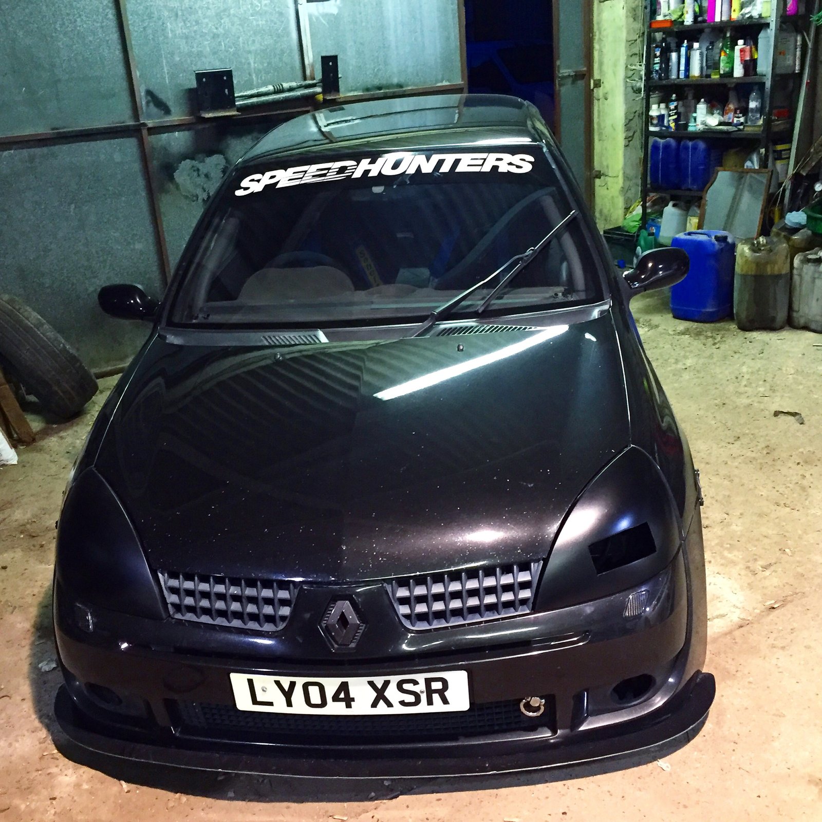

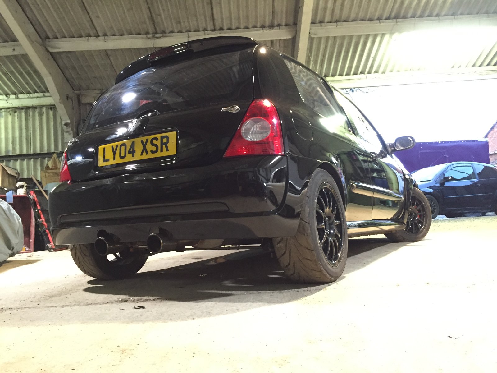

Not much to update but I've split my headlights up and sprayed them black and made some make shift headlight blanks, just took delivery off a lightweight battery and charger and electrical cut off switch and a power cable from a friends e46 m3 he was breaking so I'll be tinkering over the weekend
Any way some photos
