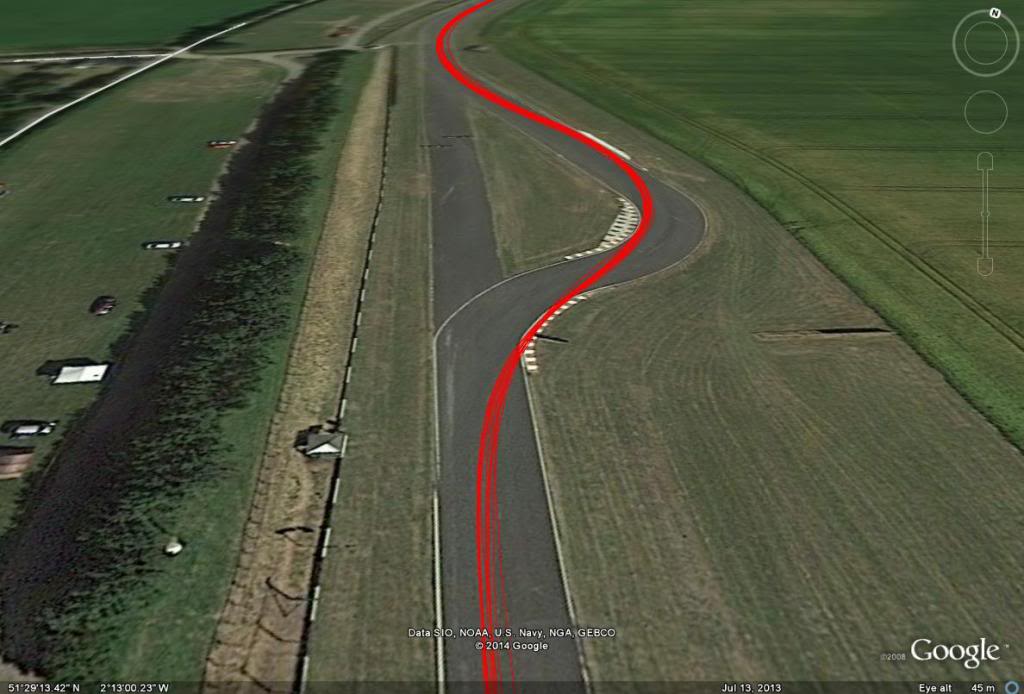

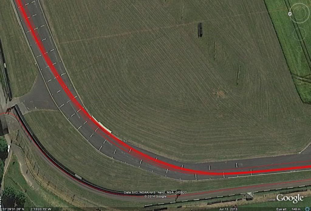

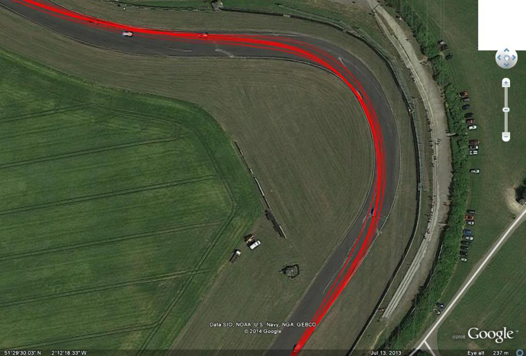

Heres a few with a Google earth overlay

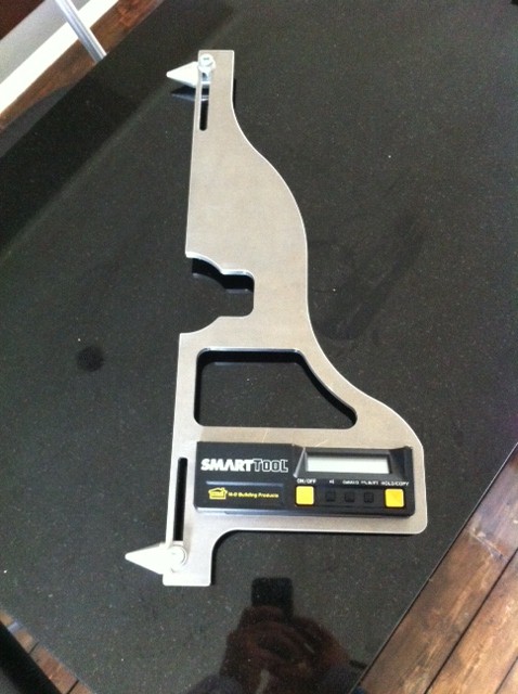

Got fed up of using a spirit level and ruler for adjusting camber so ordered one of these.....I'v used this model before and was impressed, so decided to order one.

Good choice with the camber gauge. Great bit of kit and so easy and fast to use.

Nice camber gauge. Can it compensate for an uneven floor? Or does it need to be completely level?

Great bit of kit that for the price, my mate has one I sometimes steal :)

I've got a different frame to that, got leveling feet at the bottom, so it can be done on an uneven floor, which is really handy.
