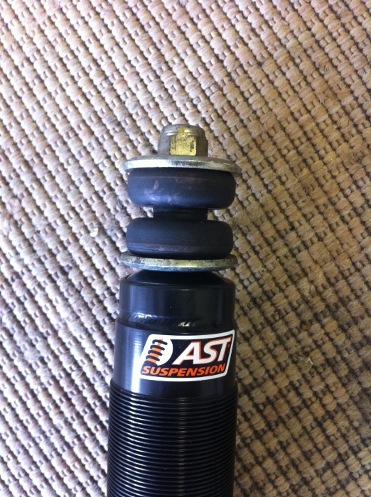

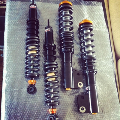

5100, with top mounts and custom springs

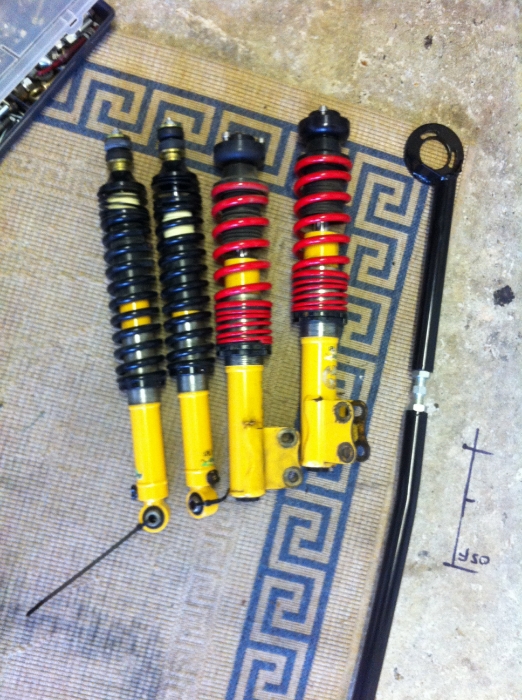

These served me well.....:dead:
What do most ppl use for the rear rubber bushes, do you use the oem ones? Im using a spare set of the Spax uprated ones, will these be ok?
AST's look good sonny, do they not come with rear top mount bushes? If not I'm sure the spax ones will be ok as long as they fit with rattling on the shaft.
What spring rates did you go for?
ASTs look very nice mate... Is that front piston just RIDICULOUSLY big or is it the pictures!!???
Must have hurt the wallet a fair bit lol ;-) Bet you can't wait to try them out.
The inner metal sleeves was original, these just slide inside the older spax rubber bushes. The newer Spax rear metal sleeves was 1mm wider than the oem/ast so these would have rattled.
Spring rates are in trial and development stages at the mo ;) but they will be a race rate as this car will not see the road
Yes they are very wide, the 4100 are a lot thinner. Did you go for the 4100 or 5100 Martin?
Only Sportline 1 mate (which I'm assuming is now called 4100?). It's all I could afford :o
If it was a race car like yours then I would have some how made up the difference in price. But I got mine from Cooksport with that good deal he was offering. Only £995. Think the 5100 are about £600 on top aren't they...
But that piston does look HUGE in your pictures lol!!
Be interesting to hear your views and opinions on the kit in comparison to what you've been using already.
You will definitely notice the difference, I love my AST's
Is there any difference spec wise between the old sportline 2 like I have on mine and the new 5100's?

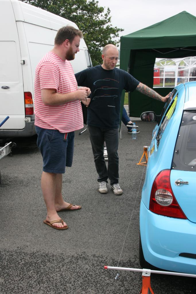

The car is booked in with Mark Fish prior to the Silverstone weekend for a corner weight session, then the next day I shall be doing the test day (Friday 8th) at Silverstone, few jobs to do on the test day, mainly to fine tune the suspension set up, examine tyre heat/pressures due to uprated springs and obviously to get used to how the car handles. Also be a bonus to get some laps in under my belt as I have never driven the National circuit. Last time I was at Silverstone was in the RS4 in 2010 and that was on the Southern Circuit.
