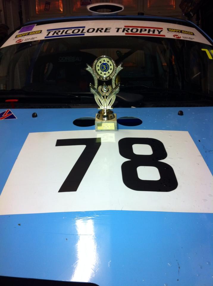

I finished 7[SUP]th[/SUP] and won 3[SUP]rd[/SUP] in class, fastest lap was 01.10m So very happy with that.

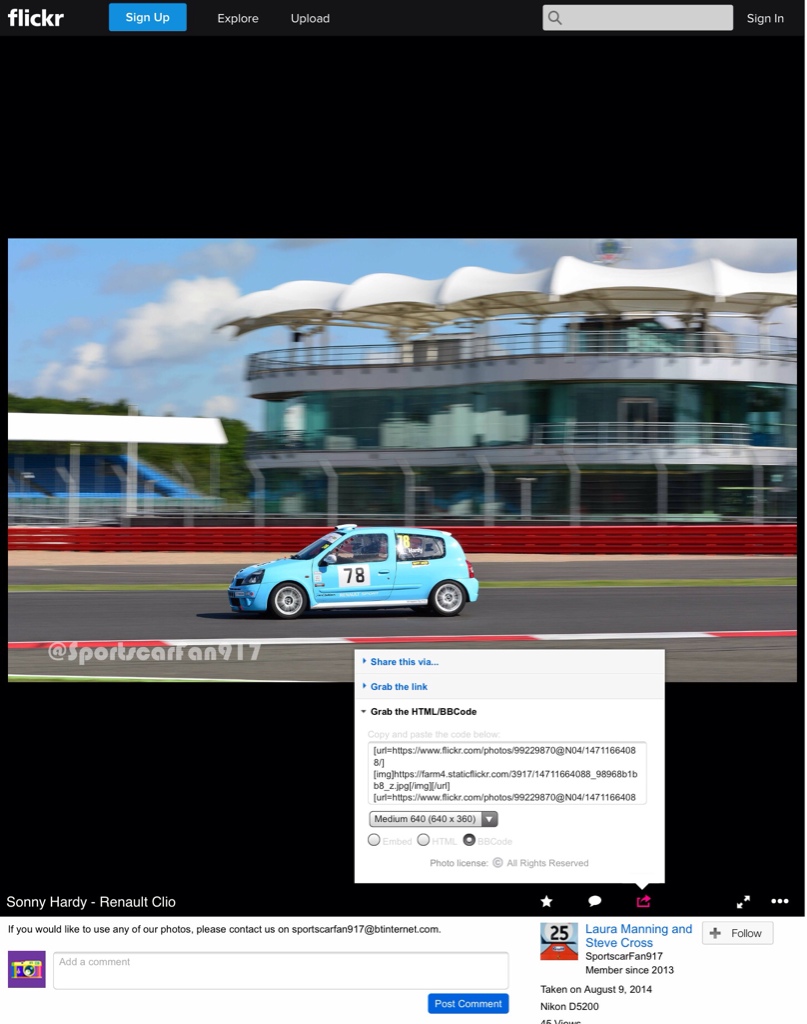

Nice one Jack, any chance she can make the photos downloadable ?
Unfortunately because of the way her settings are I don't think you can save them straight to your computer. I'm guessing she will want it left like that to stop her photos flying about the internet and not being able to be traced back to her via Flickr. If you want to post the pictures on forums its straight forward just by copying and pasting the BB code.
Double click on an image you want to post, click the share icon at the bottom of the picture, click grab HTML/BB code then select medium 640. Then select BB code and copy the whole link then just paste it into your new post.
Like this
There's some brilliant pics on there
[/url]
Sonny Hardy - Renault Clio by SportscarFan917, on Flickr[/IMG]
