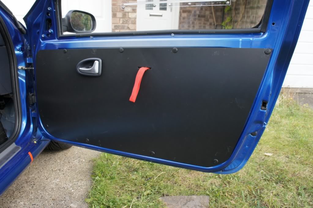

Door cards look great! Was looking for that material to do mine. Does it weigh much? What colour you having the cage?
Thanks Tommy, the door cards weight next to nothing, i will weight them once i finish work.

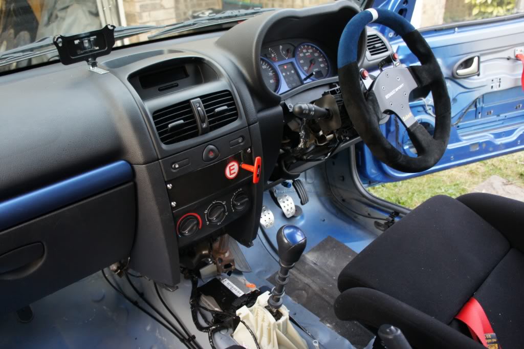

You can see in this pic my home made mount. Purchased a £3.99 iphone4 mount from ebay, took it apart and secured it to a metal L bracket and screwed it into the dash, job done.

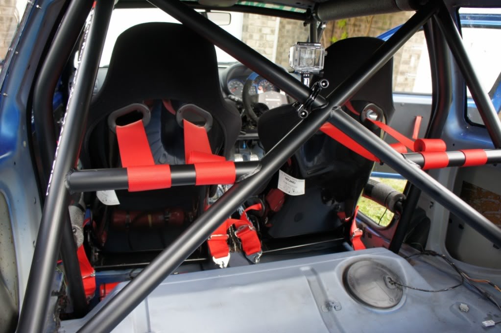

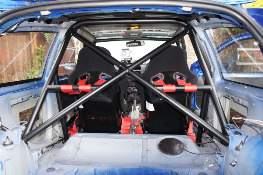

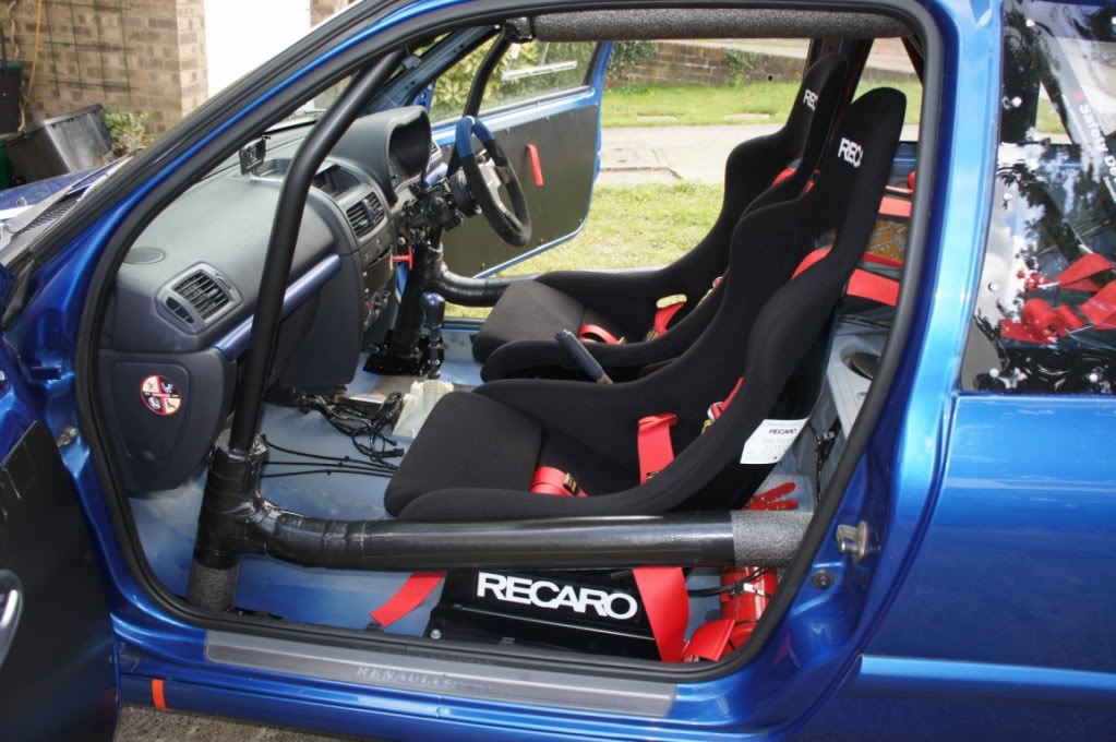

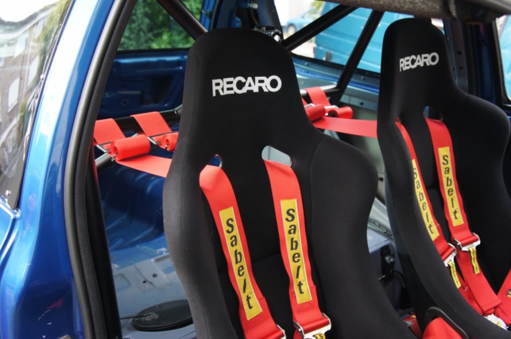

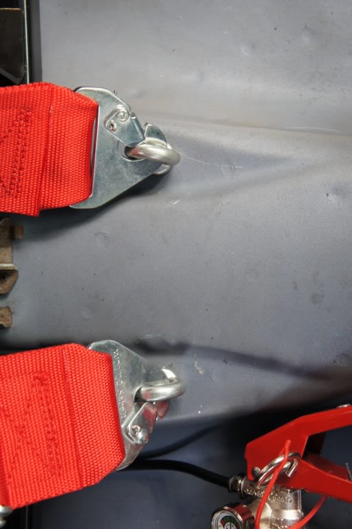

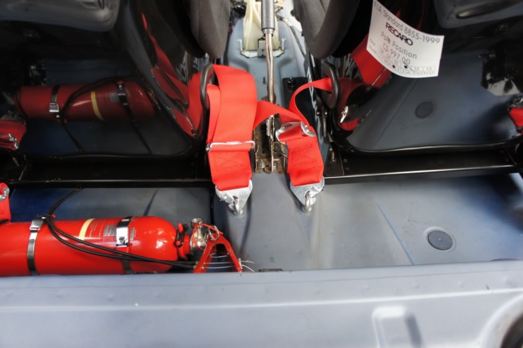

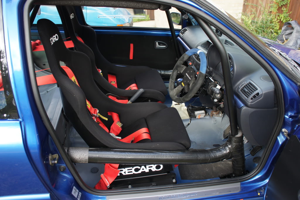

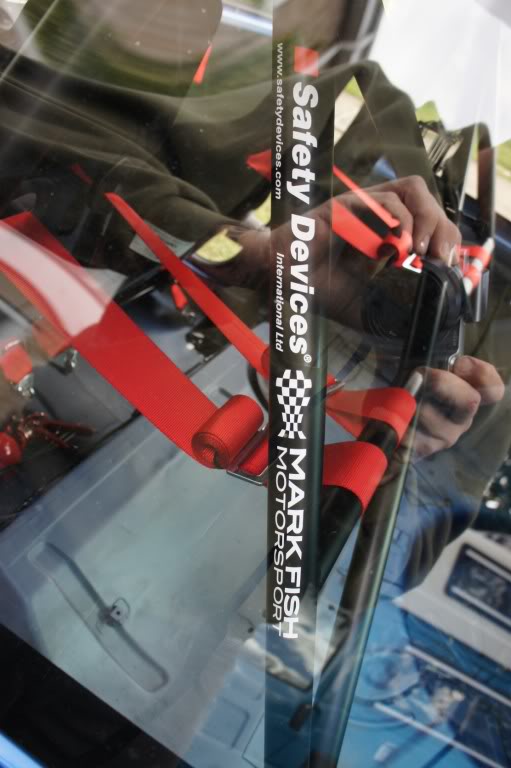

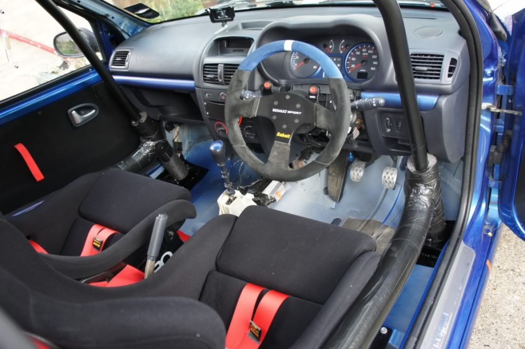

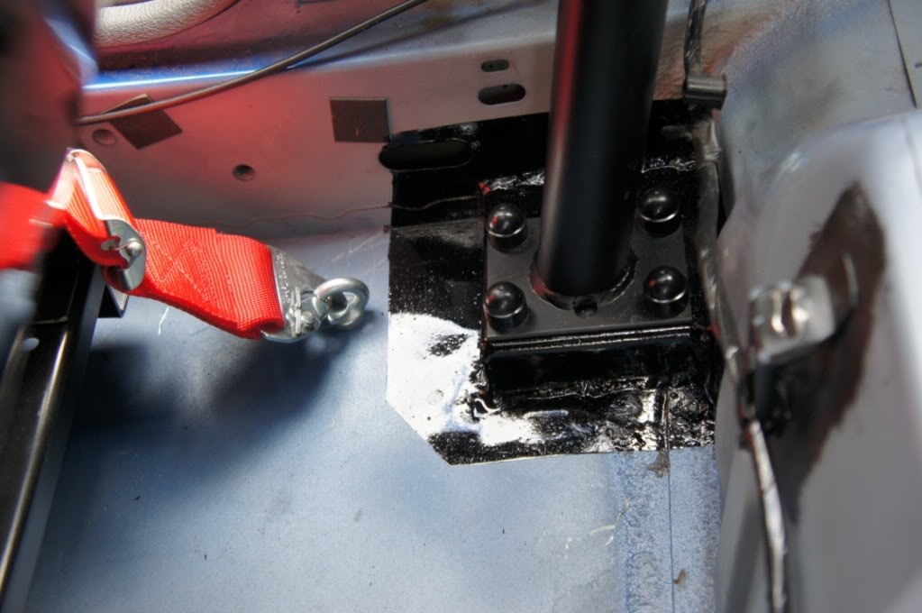

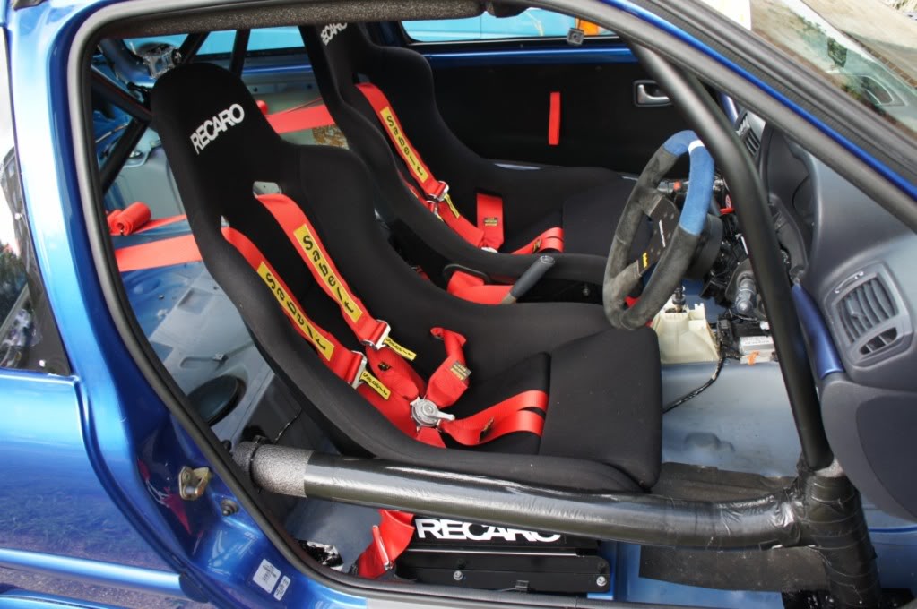

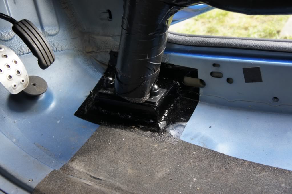

**Update - Roll Cage fitted - September 2012**
Last week I dropped the car off at Mark Fish Motorsports to have a 6 point Safety Devises roll cage fitted, while there I also had stress plates fitted for the harnesses, suspension and geometry set up and corner weighting.
The car weighed in at 981kg, and running -2 1/8 camber up front and -2 3/4 camber rear.
Overall I am really happy with the work carried out and Mark is a top bloke, I recommend him to anyone wanting a top job done on there cars.
Car is now Spa ready for next week.
Will let the pics do the talking
I also fitted the door cards after I picked the car up.

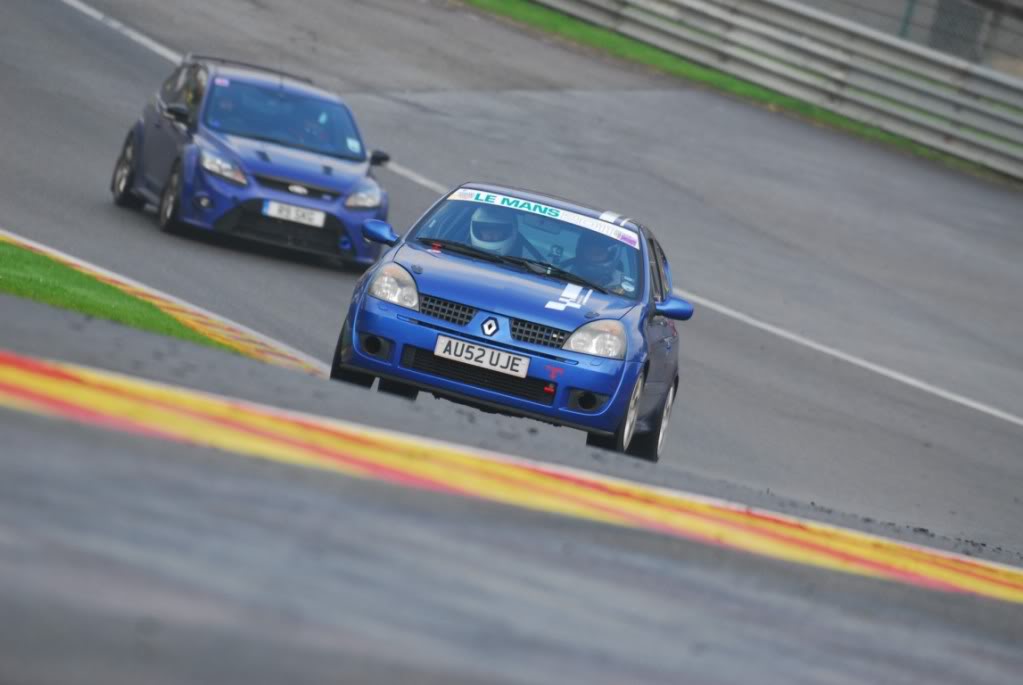

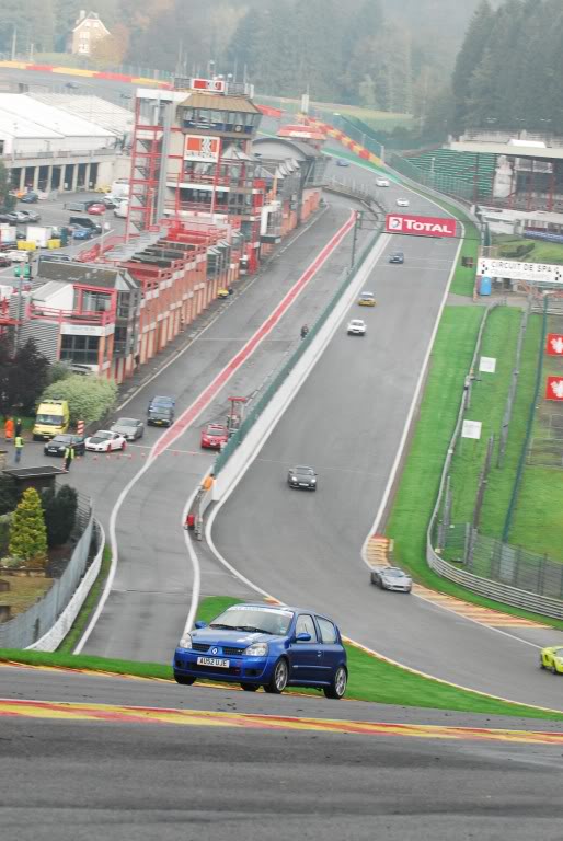

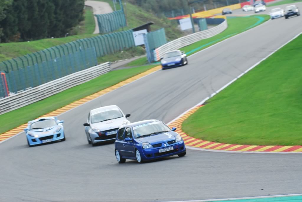

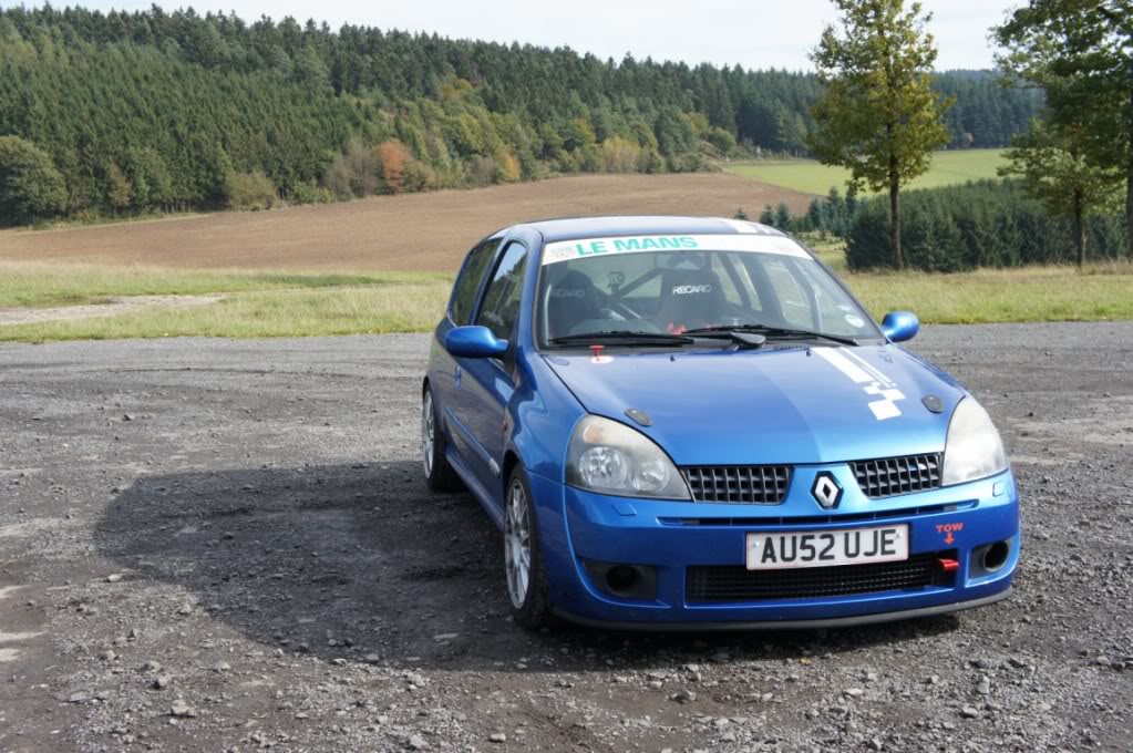

Spent a week over at the Ring and Spa, got back a few days ago.
The trip was very eventful...im summary we had 4 cars brake down/problems, one guy have a heart attack, a missed Eurotunnle train...some good point too, meeting good ppl who have a passion for cars and helping ppl out. Was good to meet Porkie, Chip, bigash and the crew, Also Gazwald..all from here. So big thanks guys was a pleasure meeting you all.
The car performed very well..apart from a faulty injector, (again thanks to Porkie and Chip for helping me out) she ran fine after that so a weekend saved. The Mark Fish geometry set up was amazing, so money well spent there.
Here are 2 vids from Spa, my PB at 3:14 and me losing it at Pouhon ;/
3:14 lap http://youtu.be/8742OJCOjHU
s**t ya pants moment http://youtu.be/aLWHSQ5gK68
Few pics from the trip
No vids of the Ring as only had limited laps due to injector problem
Full write up here (cant cut and paste) http://forum.rs246.com/viewtopic.php?f=10&t=95643&start=150
