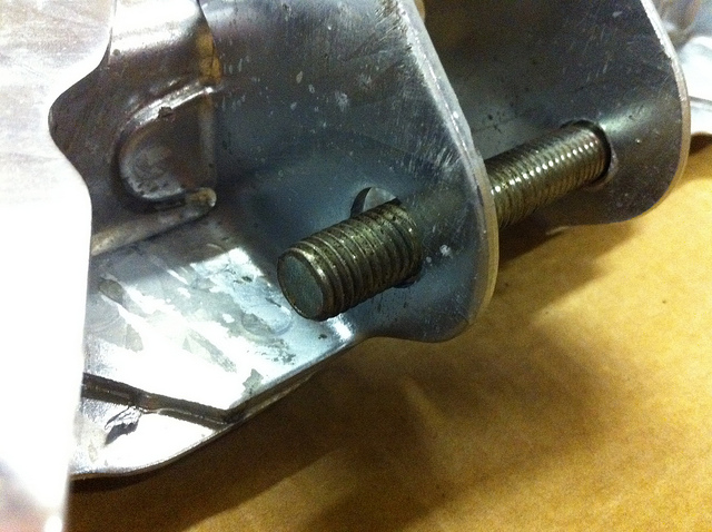

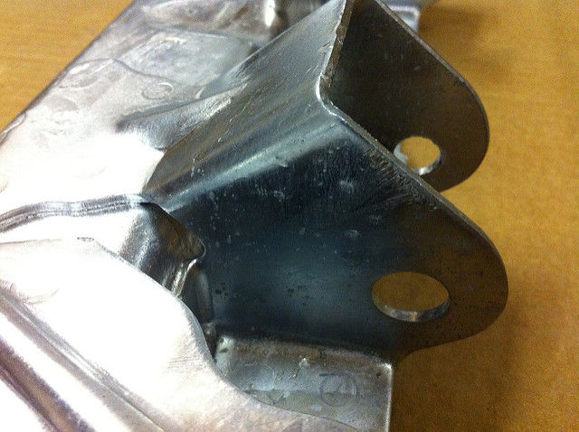

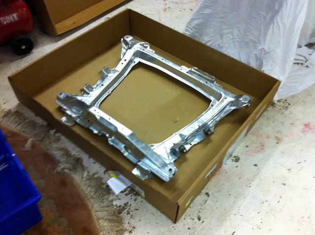

Bit of an update (for those still interested) I have a brand new genuine Renault subframe at my disposal, and I have found that the wishbone mounting holes at the rear of the subframe are indeed larger than the others.
Some pictures:
Bizarre eh? I can understand it may aid ease of assembly, but surely that benefit is over-ridden by the excessive play that will result from this design!
I have never studied this area but assuming there is a one piece metal tube inside the bush that is a tight fit inside the mounting points when the bolt is tightened then any movement under normal driving would be difficult i would think, as the one tight fitting hole would suffice.
sorry to revive an old thread, but if that hole is bigger by design, why not instead of welding on a washer, make a washer with a step in it that fills the hole?
that should positively locate the arm and solve the problem!
