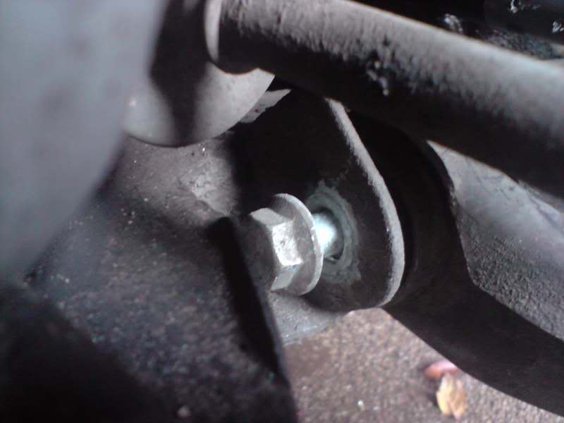

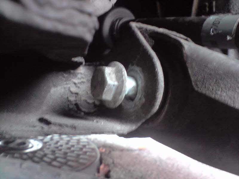

one thing i noticed from the pics is that the wearing is prettymuch the same all round, i'm meaning to say that they are worn in a perfect circle ? That's strange , i would think the movement/wearing would cause a more "oval" type of mark..
  RCSII
I've seen a couple with oval shape wear.

Mines ovaled too. Today fitting poly wishbone bushes. Will weld in a washer, but it looks like poly bushes would actually help stop this happening because of the size of the inner, versus the standard bush.

I think most of the holes have been "out of round" that I've seen- it's just very hard to view the hole shape without totally removing the bolt.

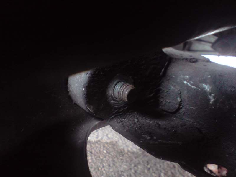

Mine had only worn the rear mounting points. I looks caused by heavy braking forces, causing the wisbones to toe out and push the rears in.

I checked mine today. Same thing. It is ph1 with 130 000km.

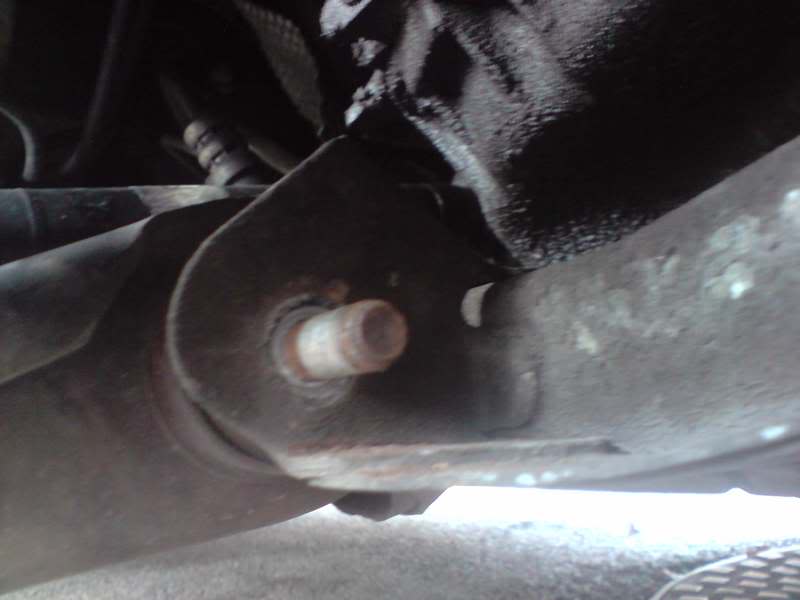

Right guys i have checked mine today.
Mine's a 2000 phase 1 172 with 106,000 miles on the clock.
I've been suffering a from clunking from o/side front since i have owned the car. I have took it to a garage to investigate it and all they could find was some slight play in the driveshaft and and slight wear in a ball joint but nothing serious, but i had these replaced anyway in hope of solving the clunk! but this made no difference and everything looks in perfect order.
My symptons are i get 2 slight clunks when pulling away (only ever clunks in 1st & not when changing through higher gears) and it sometimes clunks very slightly on hard cornering.

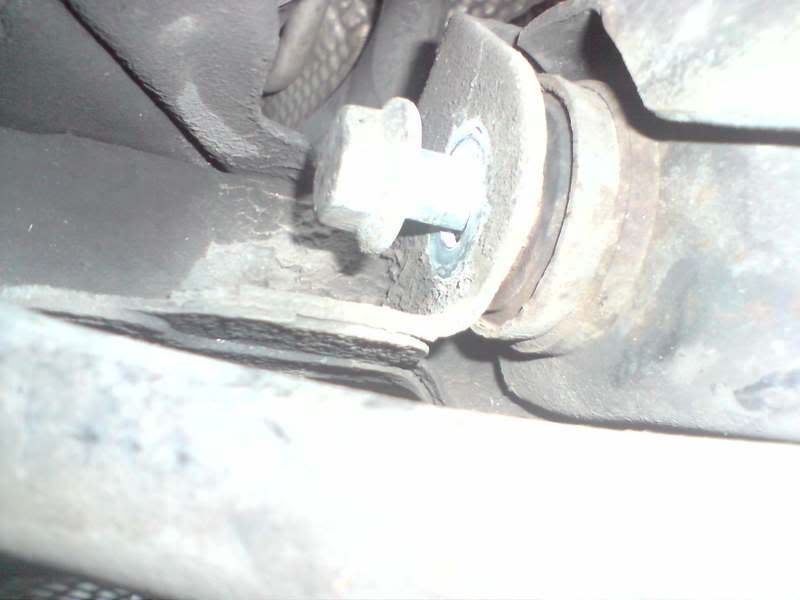

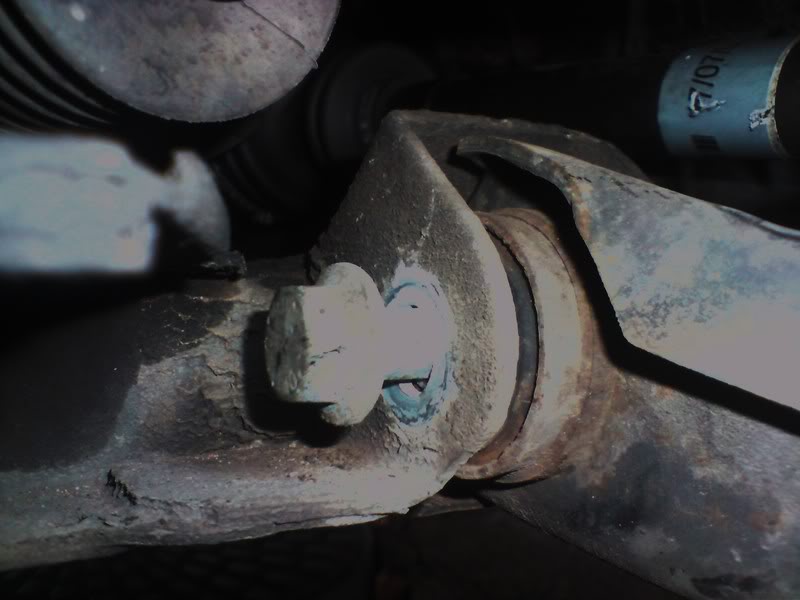

So this morning i stripped down the o/side and found the following to the rear control arm bolt hole,
I've changed the contrast in this one to make it a bit more clear,
I checked all other holes and they are in perfect condition with no distortion/wear.
So i'm quite confident that this is the cause of my clunking and it explains why the garage didn't solve the problem as you literally couldn't tell unless you undo the bolts! Hope that helps you Murcod, thanks for hopefully solving my problem!! just need to find a suitable high tensile washer now...

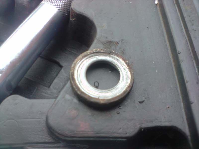

Mark One, i meant to say on my post that the very front control arm subframe mount has a washer in place between the bolt head hole in the subframe (the front mount where you have the arm from the body fixed to the control arm/subframe mount) this hole was perfect but the washer its self had taken a beating but looked to have saved any wear on the subframe itself.
So i'm thinking that this washer could probably be ordered from renault as its quite a substantial washer and used to fix damaged holes by being welded in place?
Washer and front mount minus washer in place with no wear whatsoever..

Alex the front washer is not welded in place but does look to have avoided any wear at the front.
