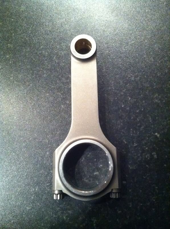

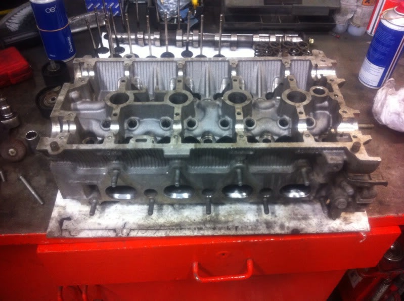

Yeah custom JE pistons in 10:1 CR with Wossner rods & arp rod bolts. Keeping standard cams & fitting 16new genuine renault valves & uprated valve springs. Im not uprating the cams & valves to stop me fitting a bigger charger & hunting for more power lol.
Plus i think around the 300bhp mark should be nice useable power & ill get an lsd fitted if needed.

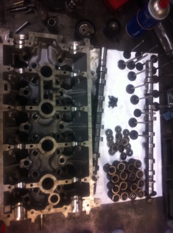

Yeah the standard ones are friction welded, ive emailed paul to see if they would be fine aslong as i didnt have a high rpm, as im sure his old white one was usin standard valves. Id heard of a sc182 dropping a valve but was led to believe it was due to loving the rev limit lol.
Thanks for the heads up tho dude more moneyDo you know where to buy the supertech valves?

I've just spoke to Paul & ordered a helix organic clutch, 630cc injectors & ended up ordering some one piece valves instead of standard renault ones to keep Gray happy
Also ordered some uprated valves springs.

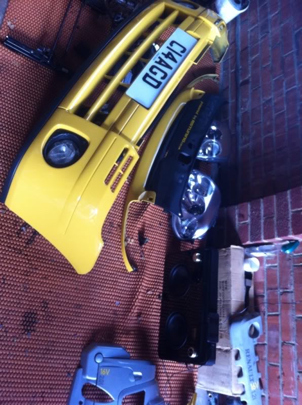

My mate who's painting the engine bay has ordered the paint for when he's next off, & I'll be making a trip to the powder coaters to get some bits & bobs done. I'll get some pics up later.

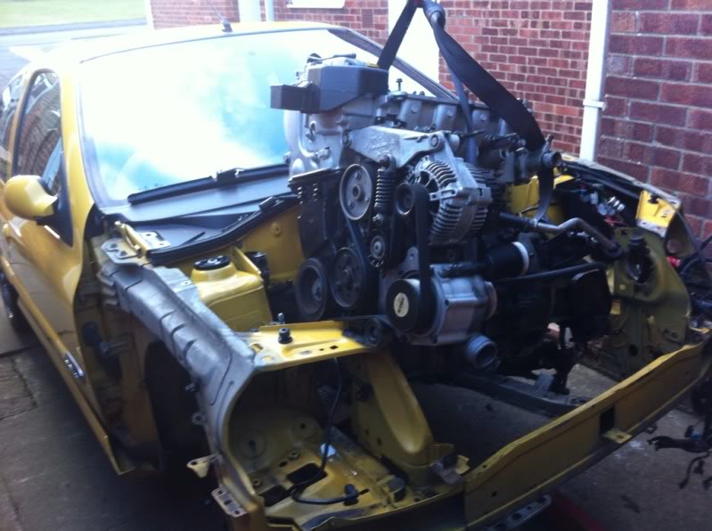

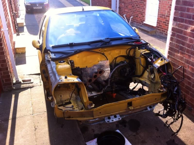

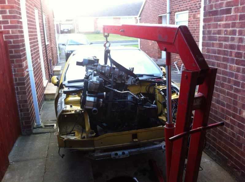

Engine is getting ripped out of mine this saturday, ready for the new engine. Been feeling sorry for itself in the driveway the past month. Hoping to give the engine bay a tidy up at the same time too. This is going ot be very, very smart once finished.
