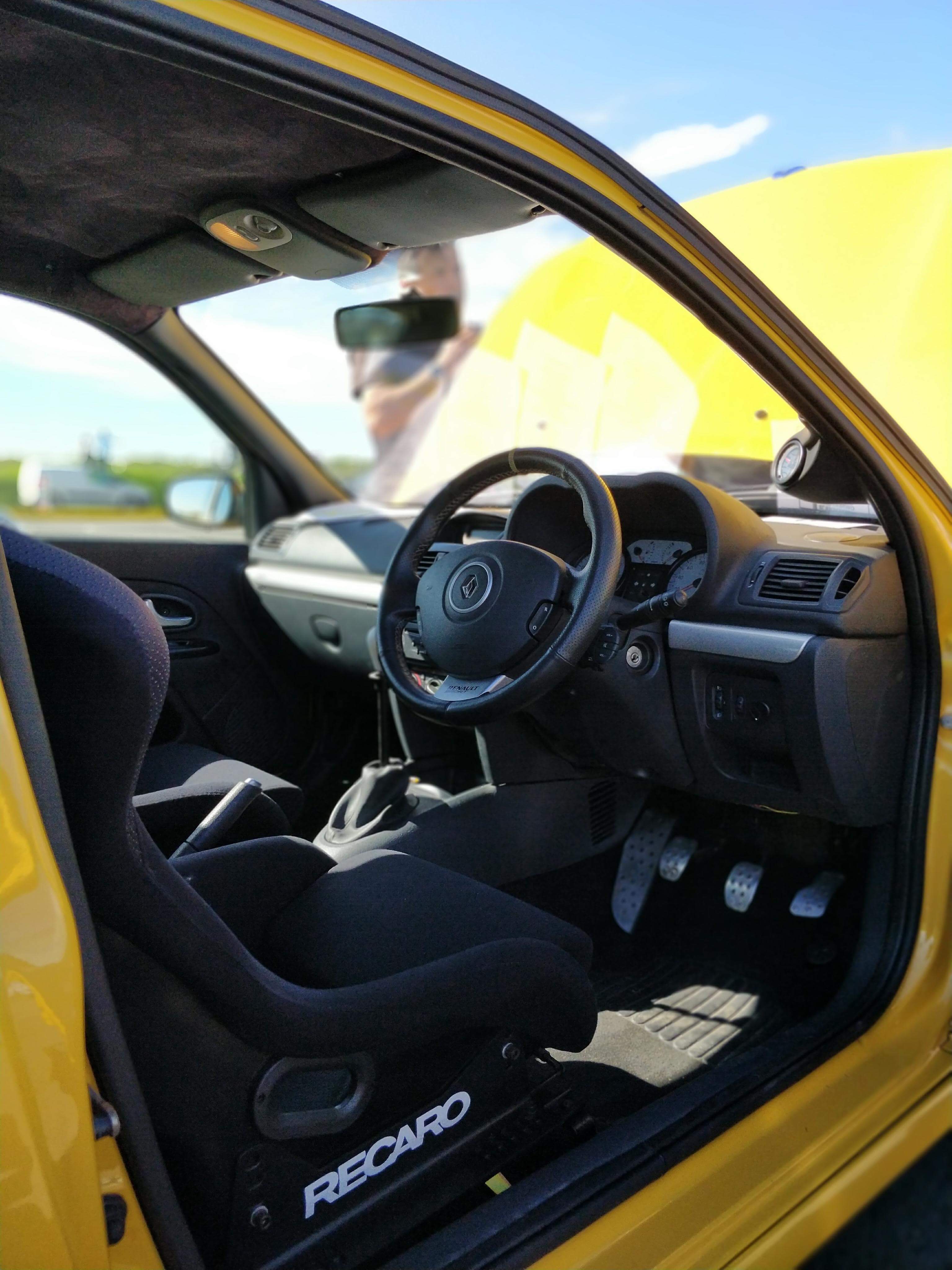

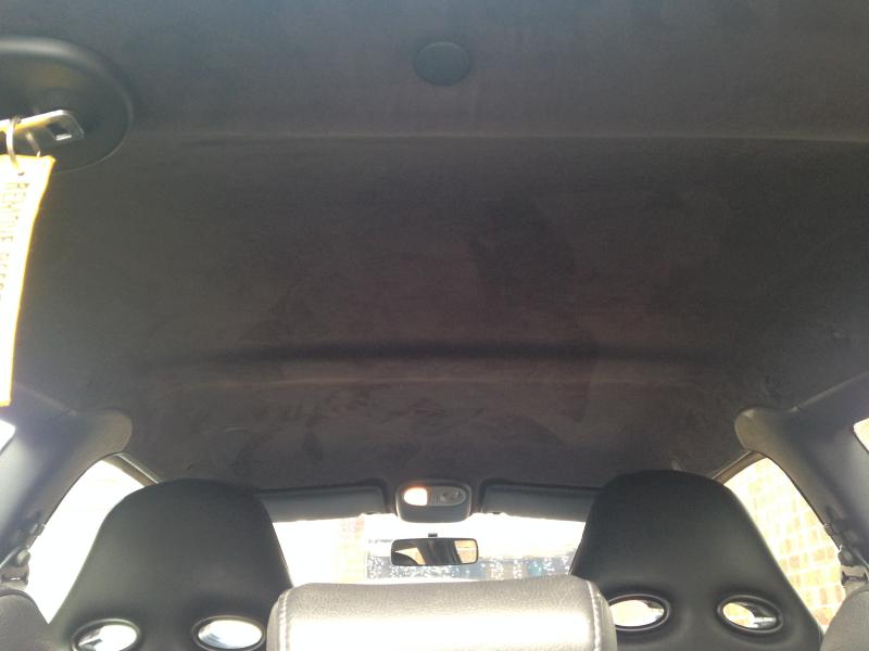

Picture of the alcantara roof lining i did last year & i painted all the light grey trims dark grey, i also fitted a 197 airbag to replace base model one, the buttons don't work due to Ph1s not having cruise but it looks a lot better with the buttons & silver ring.
didn't realise you'd done the headliner. Looks sweet mate!

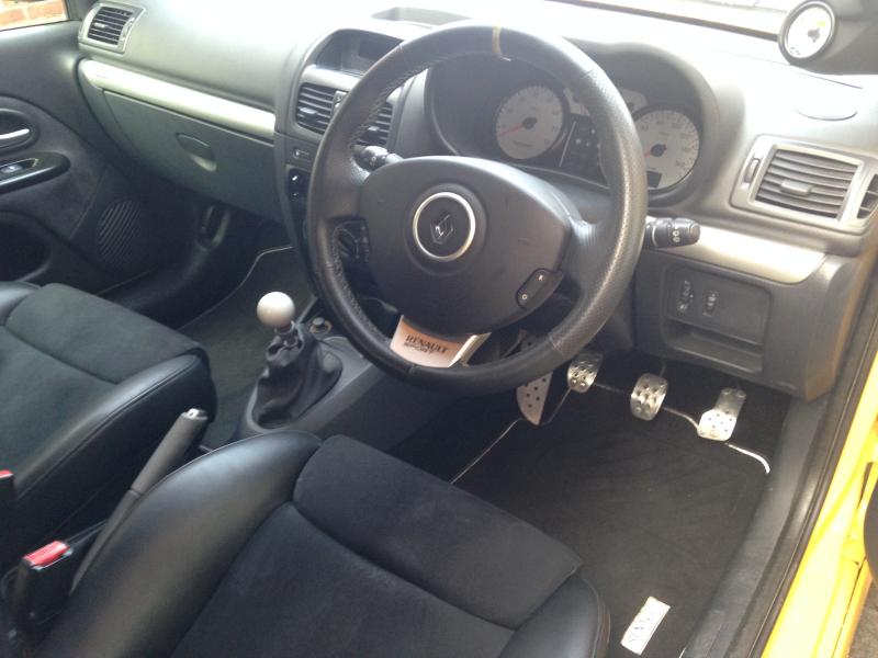

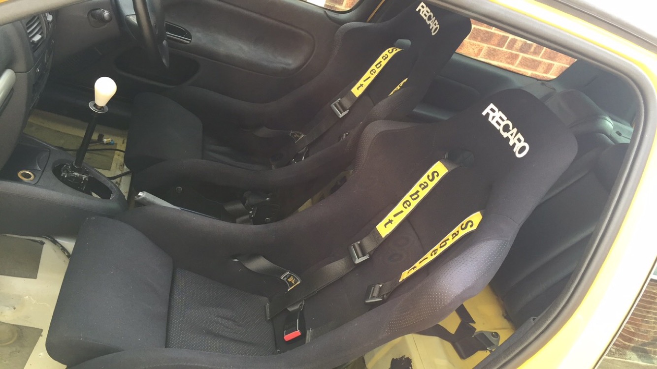

I also decided to strip the car out as it isn't a daily & take the recaro trendlines out as they are too heavy but I fitted them to the V6. I relaced the trendlines with a set of Recaro Pole Positions SPG's & a set of black Sabelt harnesses. Totally changed the driving feel of the car.

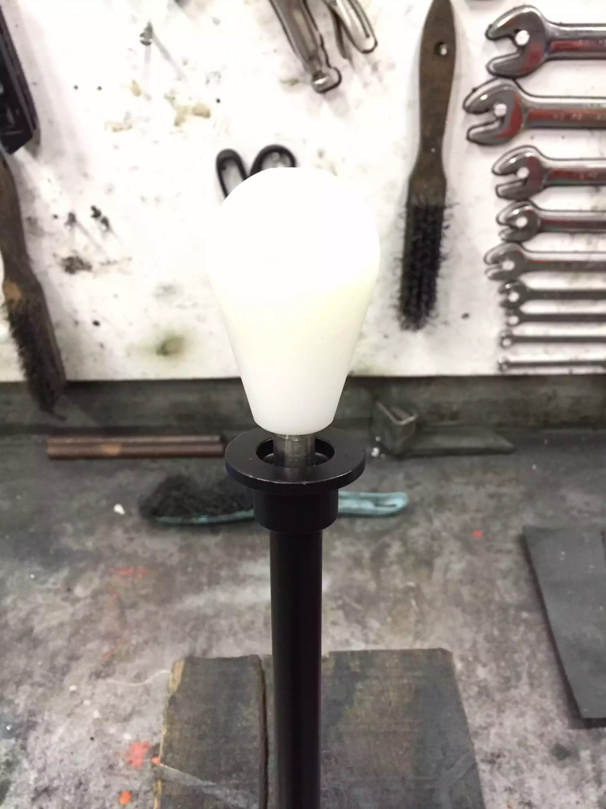

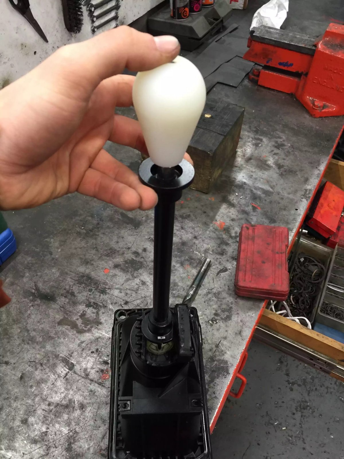

I also made my own Scenic shifter, I bought a shifter from the scrap yard & then machined some parts to make it better, made my own sleeve for the lift up reverse part instead of the crappy plastic one. Also machine the end down & tapped some treads on it & fitted a Quaife gearknob to finish it off.

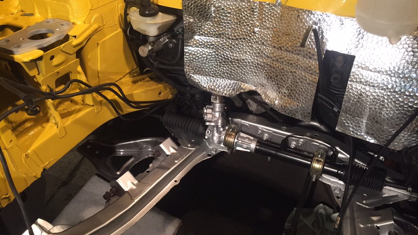

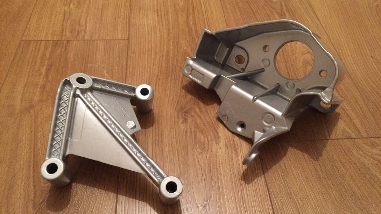

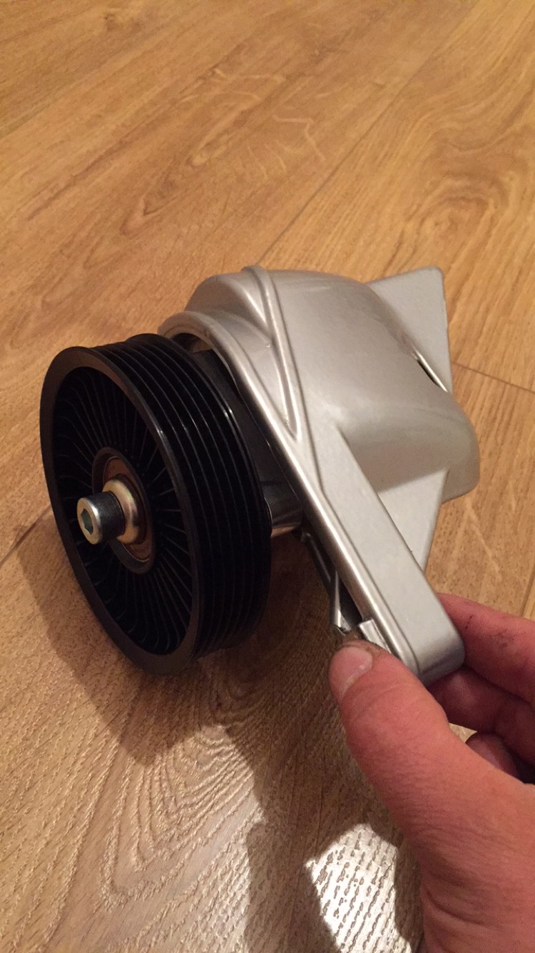

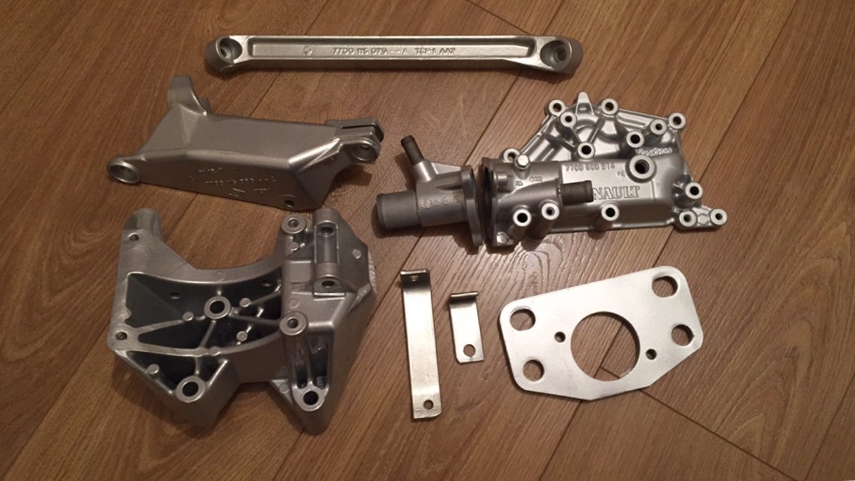

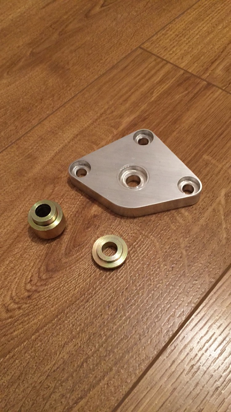

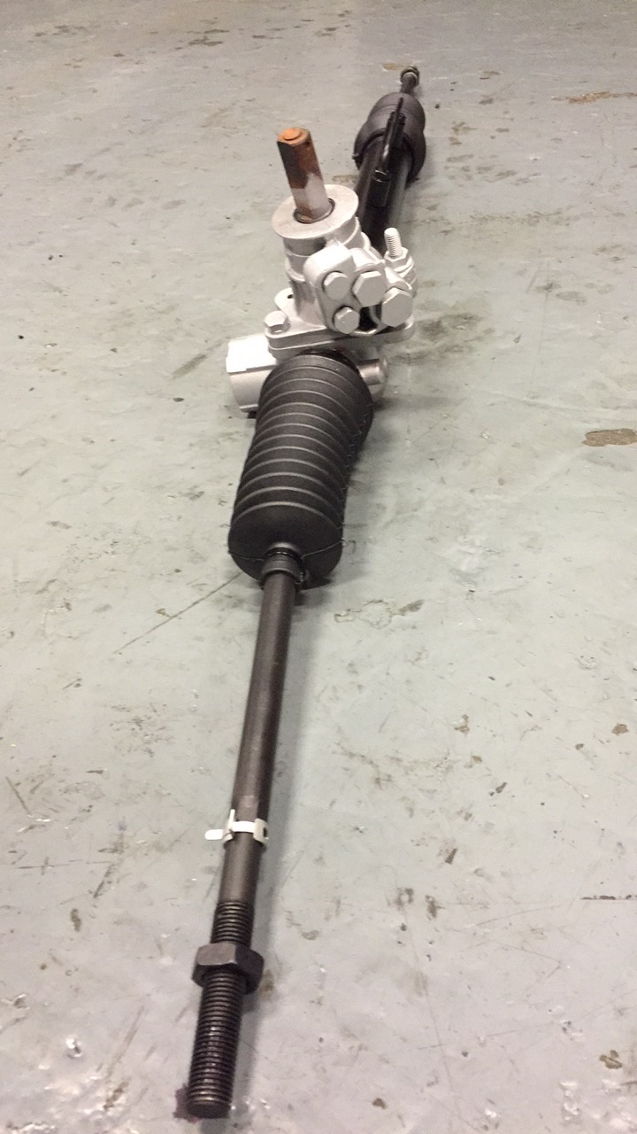

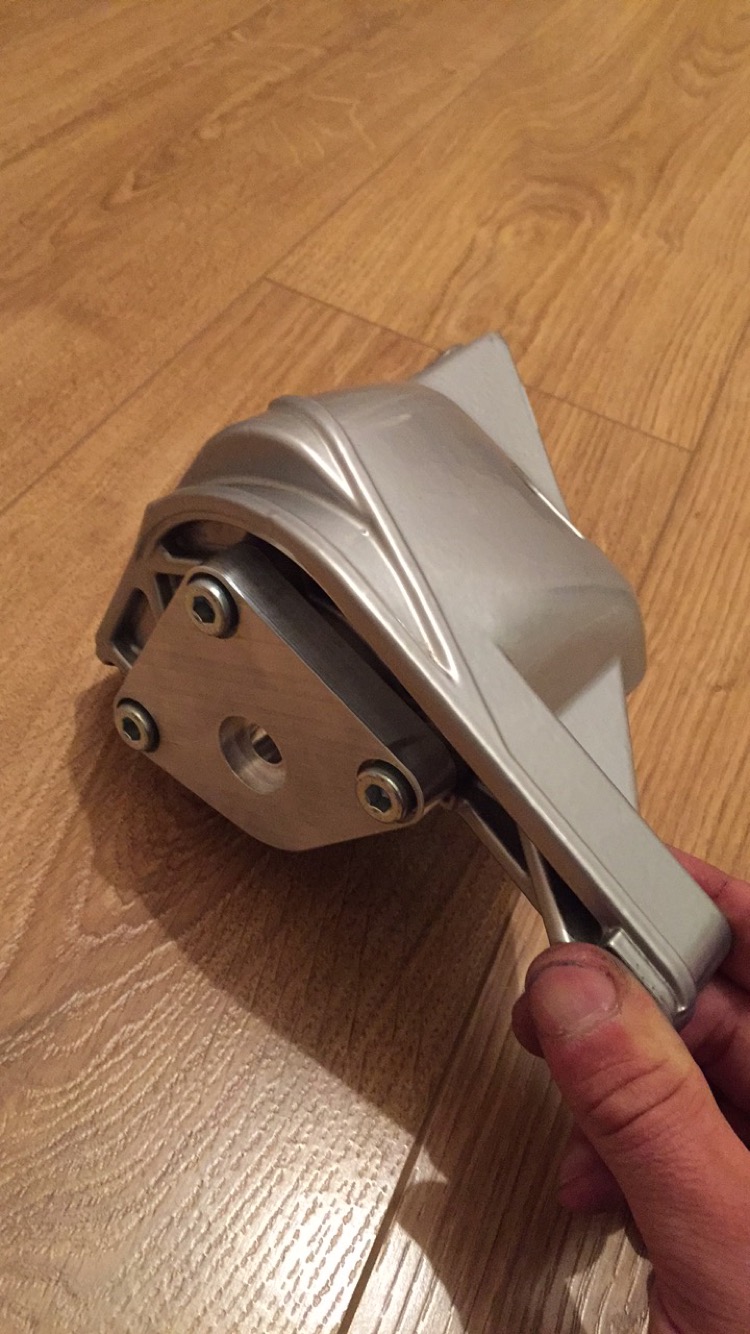

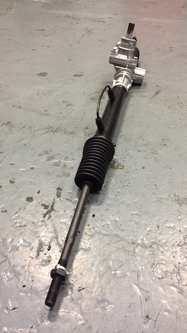

I've removed the HPAS & fitted EPAS to the car, I think I'm the only person to do this while running a supercharger? This setup could be used on cars that people still want to retain their aircon too as the supercharger uses the original aircon mount.

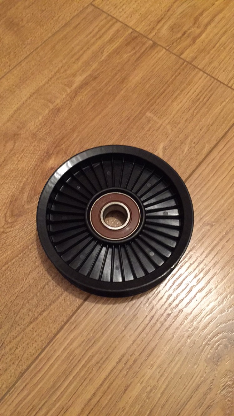

I've used the original PAS mount to the block, Pure Motorsport bracket & a Gates pulley with a bearing in for the dummy pulley, it's found on a Chevrolet 5.7L V8 which has a 17mm centre bore to work with the PMS bracket & spacer and I used a Gates 6PK1700 belt.
