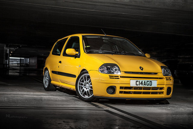

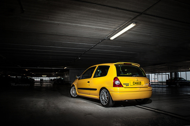

These were taken by @Niall97 I've had to use photobucket to upload them though as flickr isn't copying he link for some reason, so the quality has suffered.

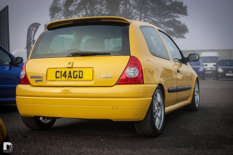

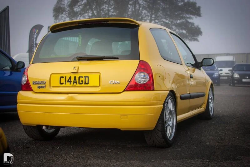

Lovely mate. I might have missed it but what spoiler do you have on it? Looks strangely weird but really good!!
Thanks mate, its a genuine Renault spoiler from the option book when the
ph1s were new.

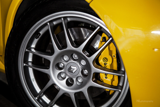

Yeah you would have to shave the calipers & get different brackets made to suit the 280mm discs.
What discs are on it now out of interest. Does look so good with the 16 inch wheels though.
When you sell up send me the spec and price buddy :wink:
Its got 300mm Brembo discs on it mate. The 16s look so much better than 15s, tyres cost more to buy but in comparison to everything else ive spent on the car they are cheap lol. Ill do a full spec list now mate.

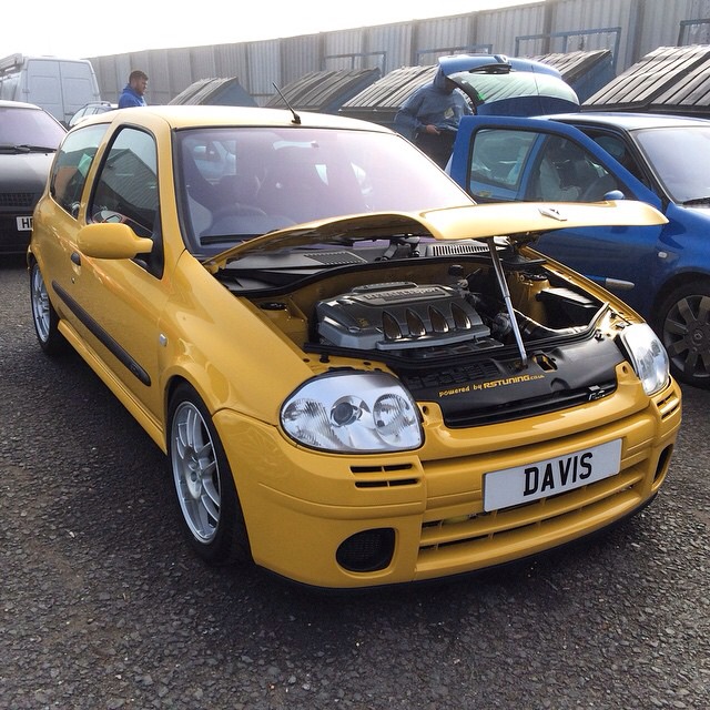

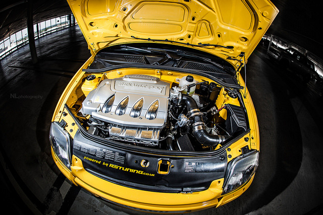

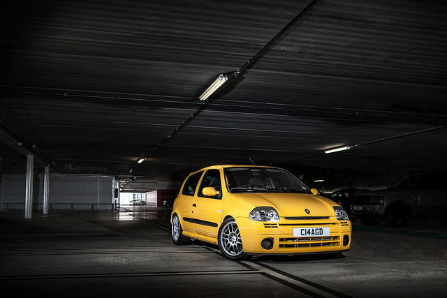

The full spec of the car, I've probs missed something off.
Engine
2.0 16v F4R
Fully rebuilt
New Thrust Washers
New Big End Bearings
New Main Bearings
Cat Cam Valve Springs
Cat Cam 438 Cams
Supertech Valves
Custom Forged CP Pistons With 10:1 CR
Forged Cat Cam Rods
ARP Rod Bolts
Cometic Head Gasket
Fully Balanced
630cc Flow Matched Injectors
Rotrex C30 94 Supercharger
Custom Pro Alloy Intercooler
Custom Pro Alloy Slim Radiator
Slim Fan
Mocal Oil Cooler For SC
Megane Sport NGK Spark plugs
Megane Sport Crank Pulley
Forge Dump Valve
ITG Air filter
K&N Breather Filter
Black Silicone Boost Pipes
Custom Yellow Intercooler Pipes
Forge Black Coolant Hoses
Clio 182 4-2-1 Manifold
K-tec 2.5" Decat/Link Pipe
K-tec 2.5" Supersport Stealth
Helix Organic Clutch
Vibratechnics Engine Mount
Vibratechnics Gearbox Mount
Powerflex Dogbone mount
Aircon Removed
Non Sport A/C Bulkhead Panel
Iceberg Silver Engine Cover
Engine Bay Fully Resprayed Sunflower Yellow
Wheels & Tyres
Genuine Renault 16" OZ F1s In Bright Silver
205/45/16 Federal 595 RS-R
Brakes & Suspension
197 Brembo 4Pot Calipers
Custom Alloy Brackets
197 Goodrich Braided Front Lines
Scenic 300mm Brembo Discs
197 Brembo Front Pads
Goodrich Braided Rear Lines
Standard Rear Discs & Pads
Polly Bushed Bottom Arms
Polly Bushed ARB
K-Tec Coilovers
K-Tec Bolt-In Solid Top Mounts
FK 20mm Front Spacers
Interior
Ph2 172 Dash Conversion
Ph2 172 Door Cards
Dynamique Black Carpet

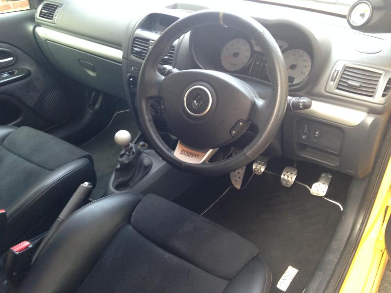

Recaro Treadline Front Seats
Ph2 172 Rear Seats
200 Steering Wheel
Boost Gauge In Pillar Pod
Alcantara roof lining
Dark Grey A Pillars
Dark Grey Sunvisors
Ph2 172 Silver Interior Handles
Ph2 172 Silver Handbrake Button
182 Silver Dash Strips
Satin Black Grab Handles
Satin Black Ph2 Speedo Surround
Ph2 172 Head Unit
182 Speakers Front&Rear
182 Tweeters In Rear
Exterior
Full Bare Shell Respray In Sunflower Yellow
Ph2 Rear Lights
4.3k HID Headlights
Clear Side Repeaters
Silvervision Indicator Bulbs
Rare Genuine Renault Spoiler
Master Van Door Lock Blanks
Ph2 Megane Front Splitter
Foglights Removed
Private Plate C14AGD
320bhp @Flywheel
270bhp @Wheels
0-60 @260bhp was 5.2secs so should be less now
165mph on the clocks
Everything in the engine bay has been powder coated silver, engine mounts, all Aux bracket work, subframe, the bottom arms & ARB have been powder coated yellow, also when it has its respray all the nuts, bolts, screws, speed clips, grommets were replaced with new.
When it is sold it will have its full normal interior fitted again & Ph2 172 carpet that looks brand new to replace the Dynamique one.
The things im doing to it over the summer will also be on the spec list too.
Typhoon ecu & mapped off Paul (rs tuning) so could be around 350bhp then.
Cup Shocks or Koni & Cooksports
A new high pressure PAS hose or do the Epas conversion
Scenic shifter
Gearbox rebuilt or buy a LSD box
Respray the engine bay again

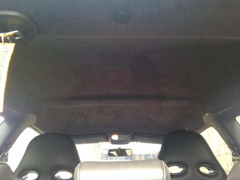

Picture of the alcantara roof lining i did last year & i painted all the light grey trims dark grey, i also fitted a 197 airbag to replace base model one, the buttons don't work due to Ph1s not having cruise but it looks a lot better with the buttons & silver ring.
