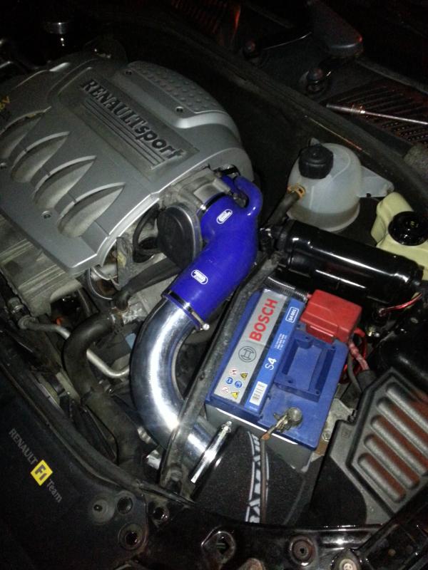

I think I may have a slightly oversized battery. That or the Ph.1 has a bracket that is closer to the battery than is in the ph2 (Not sure on that one though)
I'm buggered if I'm changing the battery, I'll just neatly cut the bracket to suit. It doesn't do anything on my car anyway.

Ok hopefully these will show what I mean about cable ties and alignment (and it shows why you need an offset neck!)
how shes looking at the mo!

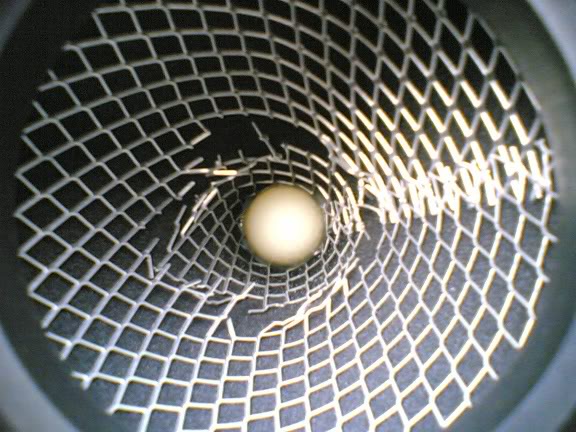

This is a Ramair filter btw...I'd avoid them like the proverbial plague!
Ali
  V6, Trackhawk, GTS
Was only a few months old that filter. Car still ran fine, whether it sucked any metal in is another question altogether.
I'd still opt for an alternative filter if indeed the inside is the same...Just saying!

10bhp gain...seems optimistic!
that's not happened from normal use! the mesh would wither get squashed in but the foam pulling in on it or be sucked into the engine completely. not sure whats gone on there! what type of filter is that anyway as it looks very small at the other end?

only thing I would be concerned about with using these aftermarket rubber bends is that the filter will move as the engine rocks.
It's a RAMAIR. It's an old old pic c2005. Possibly a different design, but I'd still avoid them
