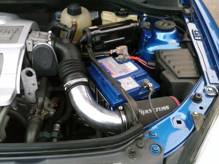

The Fatty's KTEC alternative induction setup that works just as well!
just to expand on the tests a bit, I did a rough test to see what sort of restriction my IK was giving and found the average restriction to be 0.58psi (0 is equal to open air). That is based on these calculations (both at WOT)...

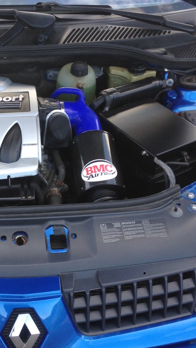

The bmc cost the sane as this setup so it's worth a try. If I don't like it I'll sell and try this one out. [emoji14]

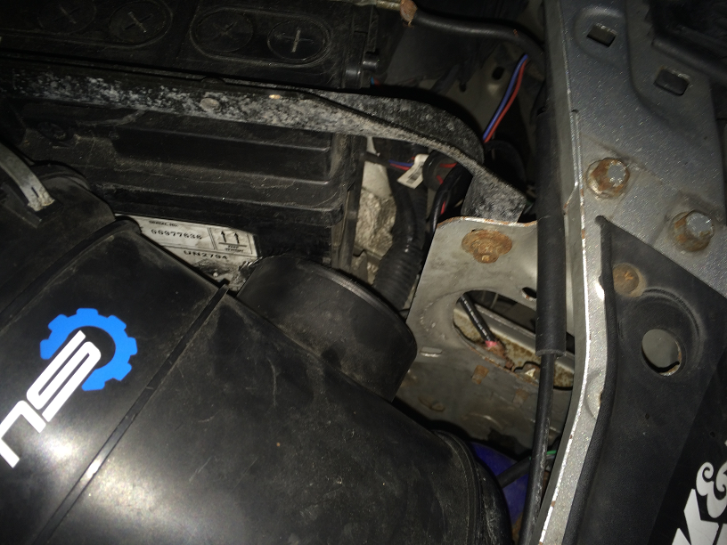

I have been hopping back and forth between these to pics and cant decide if the ph1 bracket is bigger or not (or if you just have a bigger battery?)...
I think its the latter as ECU bracket is the same, yet your batter comes further along it? @McGherkin

I think the issue is that it's about 50% longer than a normal battery. He'd have to reposition it in the boot to fit it in.

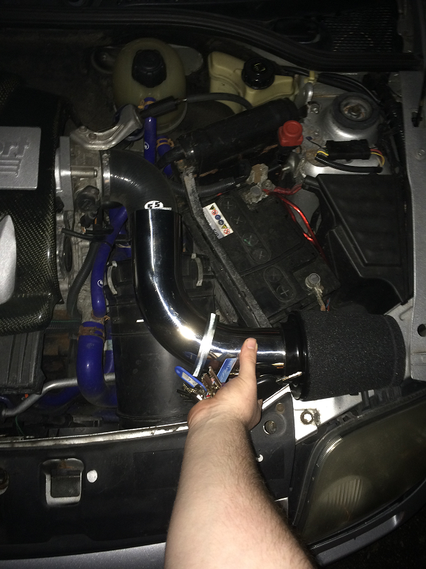

Now after waiting two weeks I finally received the pipe and had to fit everything right away.
I went for a drive with a friend and after getting the engine up to temp and giving it a bit of throttle I thought it sounded quite nice until I gave it some more and was sure the filter had popped off!
Pulling up to redline in 3rd and 4th is almost unbearable.
I'm pretty sure I'll go back to the stock airbox with an aftermarket drop-in filter instead. We'll see tomorrow if the drive to and from work will be too embarrassing.
Note, I'm 23 and have messed about with cone filters on a few cars but none have been this loud with an annoying almost resonance-like noise close to redline.
