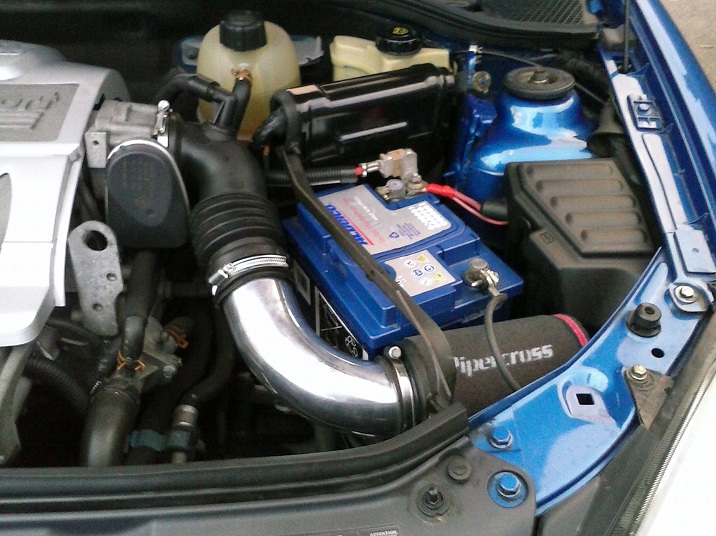

are you sure your not just being a big girls blouse?Now after waiting two weeks I finally received the pipe and had to fit everything right away.
I went for a drive with a friend and after getting the engine up to temp and giving it a bit of throttle I thought it sounded quite nice until I gave it some more and was sure the filter had popped off!
Pulling up to redline in 3rd and 4th is almost unbearable.
I'm pretty sure I'll go back to the stock airbox with an aftermarket drop-in filter instead. We'll see tomorrow if the drive to and from work will be too embarrassing.
Note, I'm 23 and have messed about with cone filters on a few cars but none have been this loud with an annoying almost resonance-like noise close to redline.

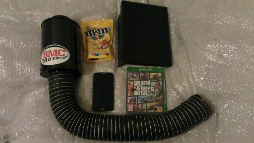

thats when I first did mine :smile: I took one look a the ktec system and thought 'there no way i'm paying that for a bit of rubber'!I did something similar back in January 2013, i thought everyone did/knew about this mod.
are you sure your not just being a big girls blouse? :tongueout:
this setup is much louder than the stock airbox, most who fit it like myself, are actually happy of the raw, rough, 'bat out of hell' type sound :smile:

It wasn't no. And I didn't want to run risk of fitting it, mapping it and then finding it still doesn't run right and having to get it mapped again on normal box and filter.Guessing the impreza wasnt mapped for the induction kit as mine ran fine
My old focus 1.8 behaved exactly the same when I fitted an IK... Combined with my impreza experience I've strayed away from IKs, but im giving them one last try now... LolFor me, yes it was. I've put it back to standard and the power has come back. I didn't lose any power at the top end it was low down. Usually it feels really torquey low down the revs, the ik completely removed that and it felt like it was making a noise but not pulling no where near as hard.
Thanks for the feedback. I wish you had cleared down you tables first though as I think that was the issue. Could also be that your timing is different to mine I suppose?Just to confirm (and not wanting to piss on anyone's bonfire) my low down torque is back after putting back to standard. Do miss that sound though 😧.
It might be worth noting my car has the 98 Ron map so maybe it doesn't adjust the fuelling for it as much as if it hasn't been played with??
Its probably just me and my luck with cars though.
I did mention it before! Its where you clear the trim tables so your car learns what to do with the air/fuel mixture faster. I suspect yours was getting it wrong to start off with and was under fueling or something like.You'd wish i'd done what now?!
Yeah maybe, my dephaser and belt was done 3 months ago at Clioturbo though so i'm certain it won't be out. Power is c**k on though.
Just had mine delivered, going to be fixing it up soon, what do you mean by dlearing the tables? sorry for the dumb questionThanks for the feedback. I wish you had cleared down you tables first though as I think that was the issue. Could also be that your timing is different to mine I suppose?
you can only do this if you have a tool to do it such as an rstuner vci, else you just have to drive around a lot for the ecu to 're-learn' its air/fuel ratios. I wouldn't worry about it unless you notice a power dropJust had mine delivered, going to be fixing it up soon, what do you mean by dlearing the tables? sorry for the dumb question
with the RSTuner you have to reflash the whole ECU (at least the the only way I have found as of yet)...Can you do that with the standard VCI or do you need the user-mapping module that lets you play with the map?
