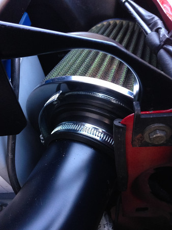

This is my intake kit, as you can see resprayed the pipe to satin black and used this green cotton pod filter i had, as you can see just squeezed in a piece of U channel rubber edge trim against the intake pipe.

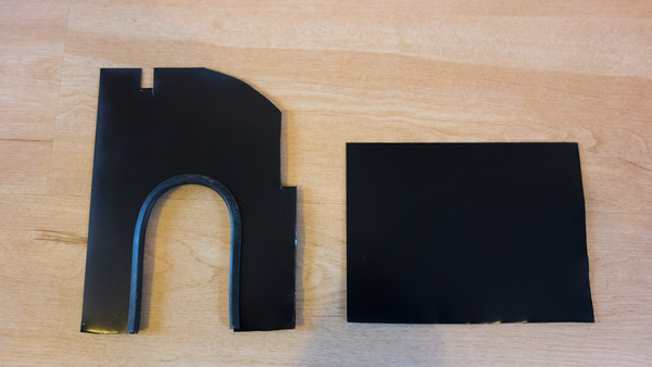

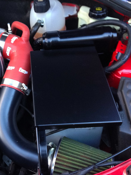

Then i custom made my own intake box out of 0.7mm aluminium, pretty simple really.

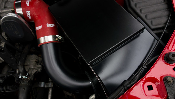

Final result after install, used lots of the rubber edge trim.
Overall happy with the DIY setup
