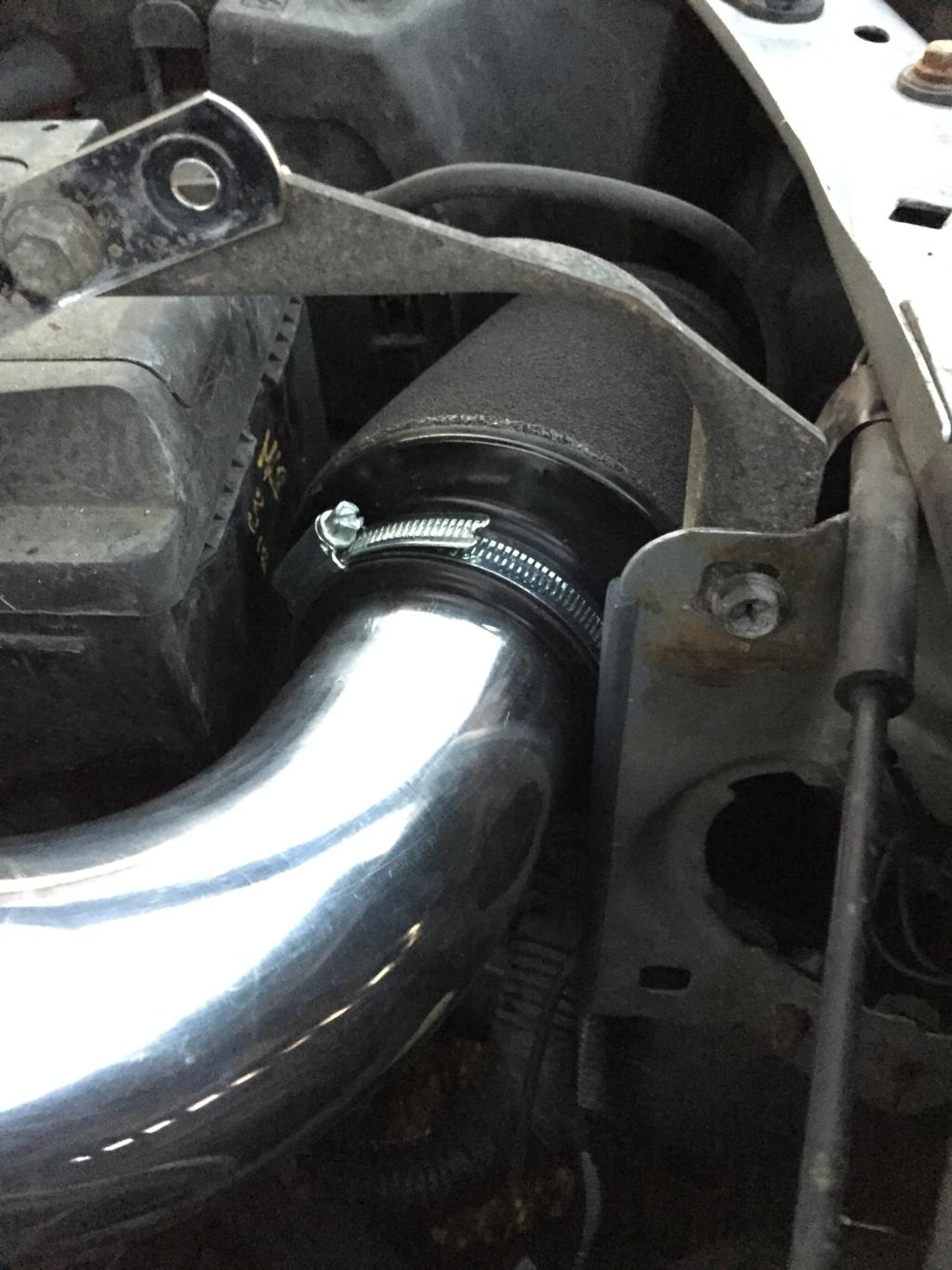

I checked the alignment of the filter and pipe and everything seems to be just fine but as there is some movement I thought I would protect the pipe against the metals work.
The motorcyclists among us may be familiar with the plastic strip you get with aftermarket screens that goes along the edge. Well anyway I used some of this to go along the metal edge. Similar to the pipe insulation mentioned earlier in the thread but takes up less space and is quite neat:

@TarkMalbot can you buy that rubber separately? Do you know what it's called? I envisioned something similar when I fitted mine but the only thing I could think of was draught excluder type stuff.

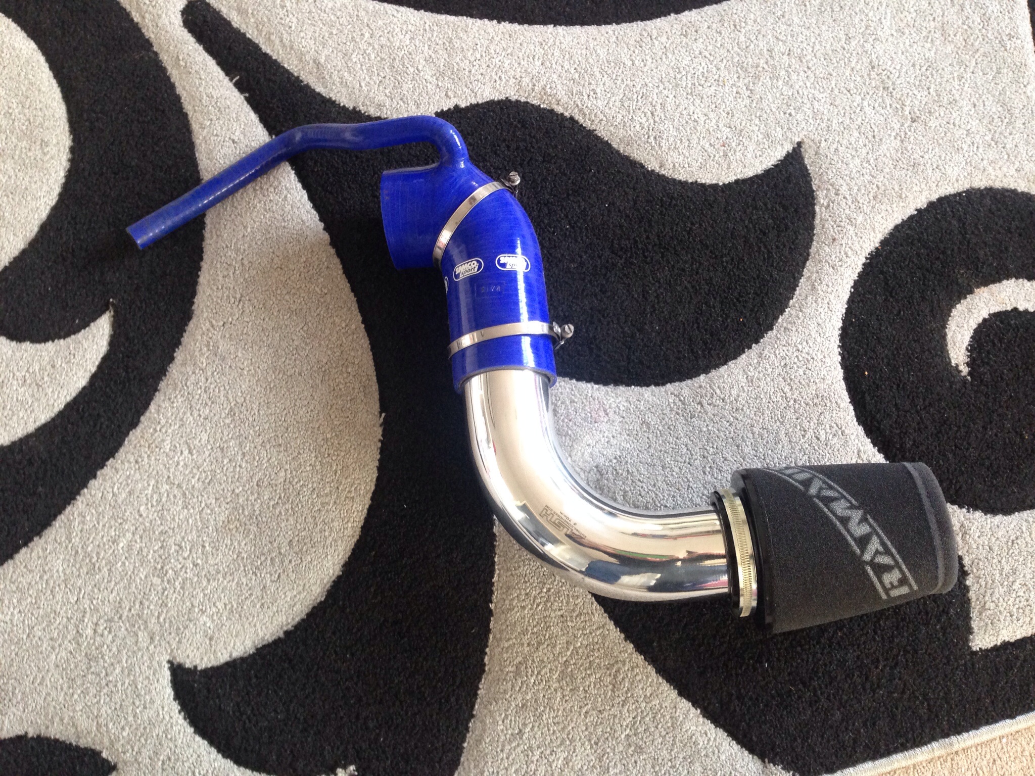

Is there any benefit to changing the original throttle body 90 degree for a silicone one? I can only see negatives such as expense, losing the suspension effect of the ribbed section and if you get a cheap 90 you have no breather hose connection.

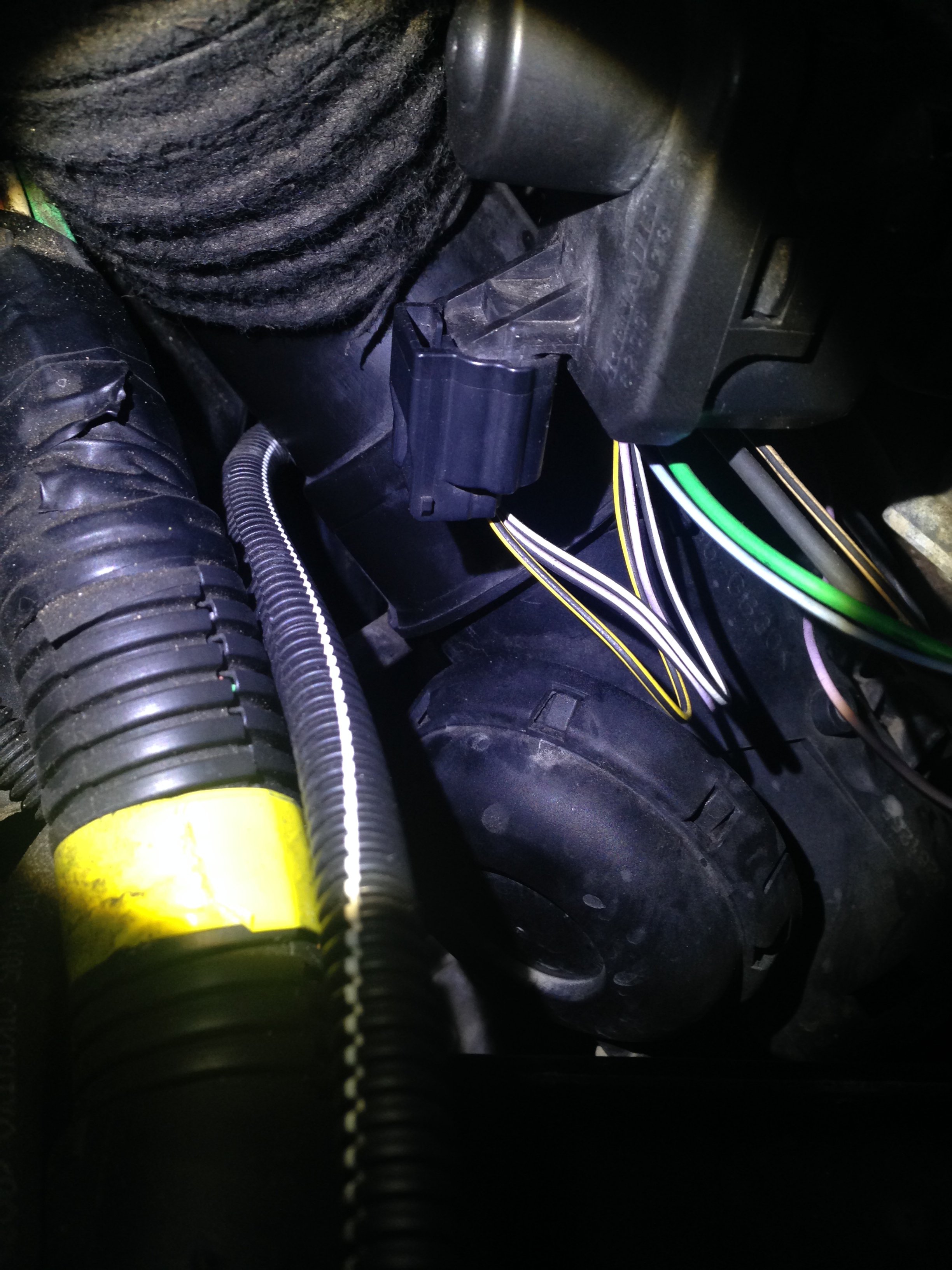

I have tried the suggestive tug and it remains very stubborn. Its quite confined and seems to be wedged in near the base of the headlight. Any other suggestions?

Not sure really. My current one didn't have them. On my previous cars I'm sure all I did was grab, squeeze and yank. Ohhh matron

the pipe has been damaged from trying to pull it out, to the point that i would have to replace the whole pipe, could i just cut the pipe low enough so i can fit the filter in and have the air still blowing through with that in and then my filter sat above it or will that make EMS light come on at all?
