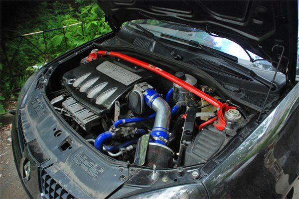

The Fatty's KTEC alternative induction setup that works just as well!
  Clio 172 cup
Orderd the parts just after Christmas and fitted them yesterday, only been out the car twice but happy with it. Not massively noticeable when driving 'normally' but sounds awesome when you put your foot down!

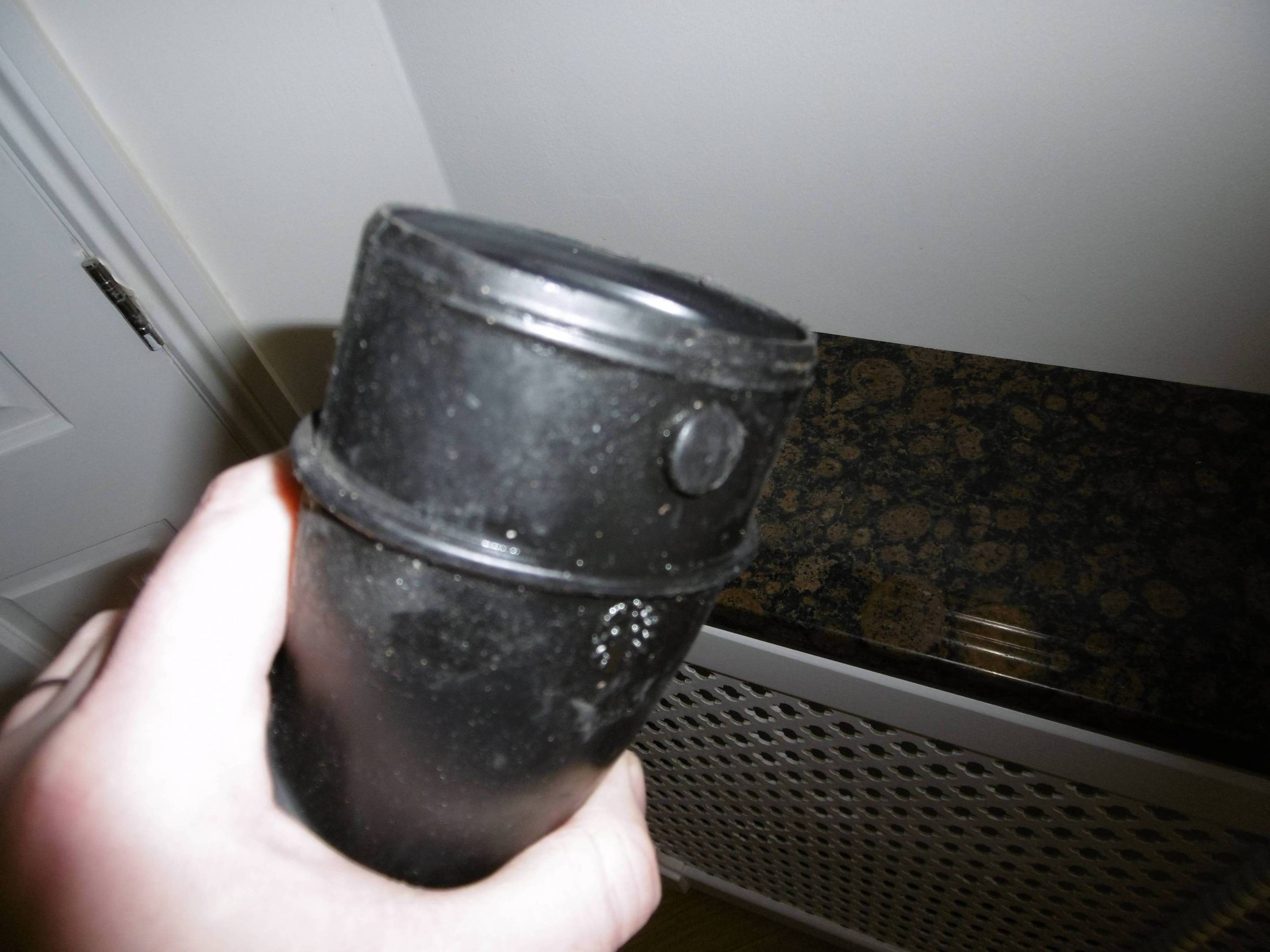

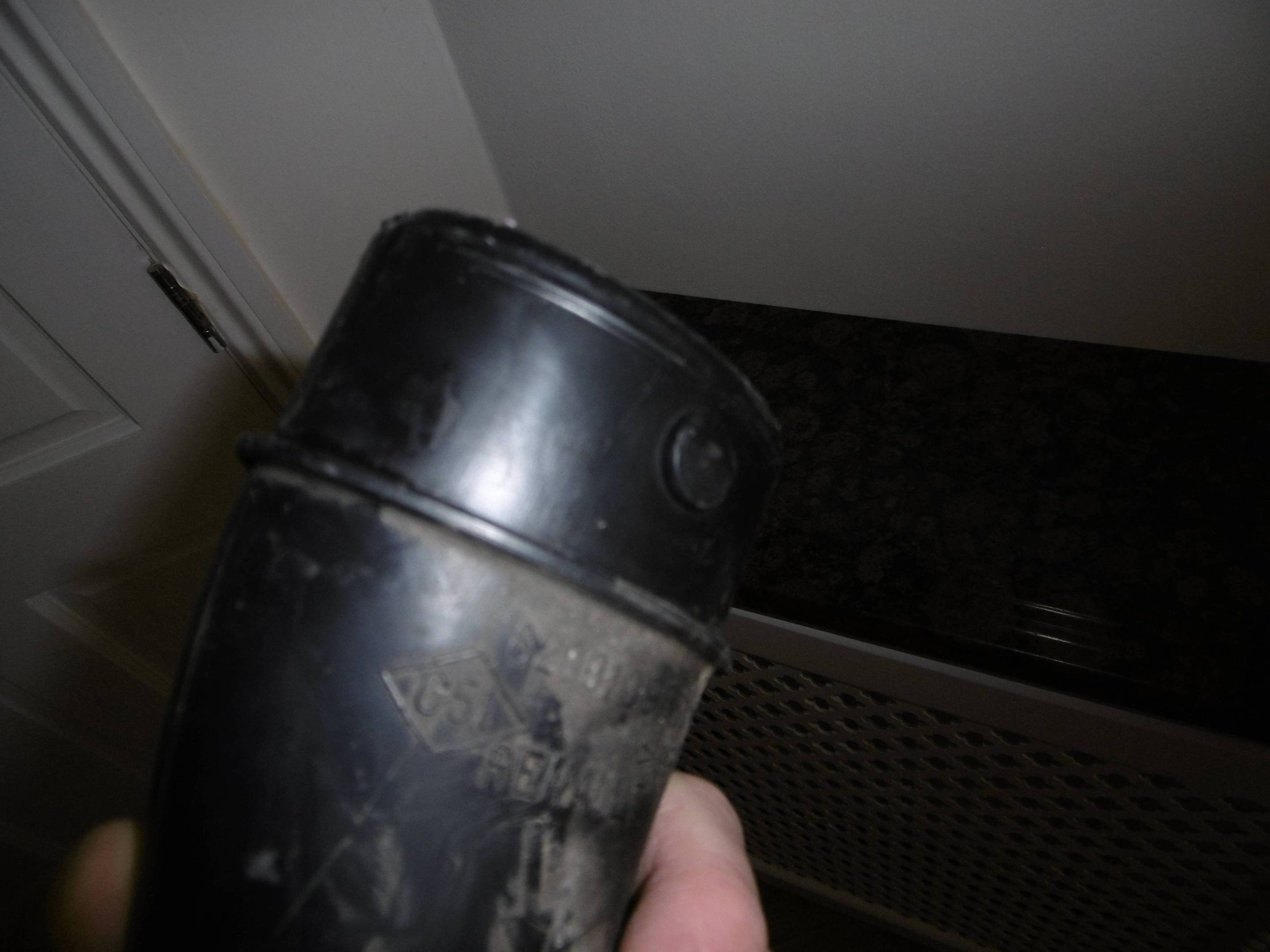

Did anyone else's pipe not have bulged ends? Mine was just a straight end, which is probably why it popped off today.
I've cabletied it back on with about 0405984 cable ties so it shouldn't come off again, but it's a point to note.
sburrell93
Scotland - South
Mine has flared ends. Doesn't sound right that you've been sent one with just straight/flat ends. Could see if they'll send you a proper one, alternatively just fire some amalgamating tape round the end of it and put it back on with the usual clamps.

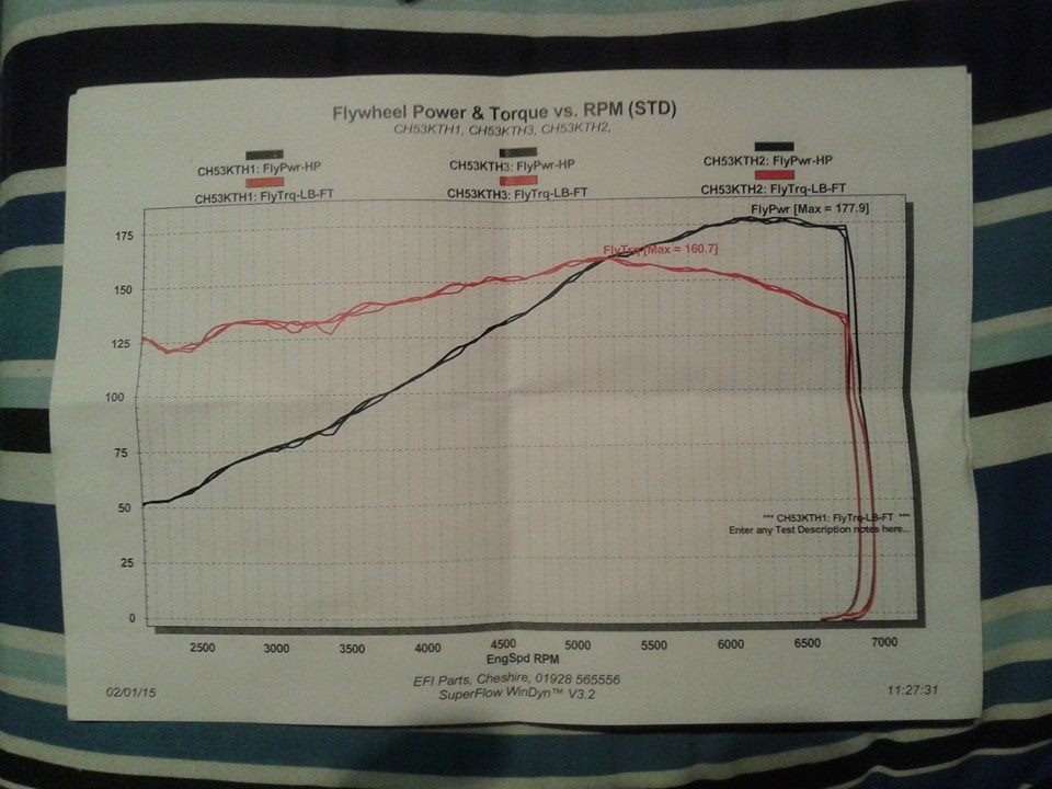

had mine RR'ed on saturday at EFI! most standard cars were hitting 169ish ... i made 177.9 :) hopefully attachment will work! running decat also
