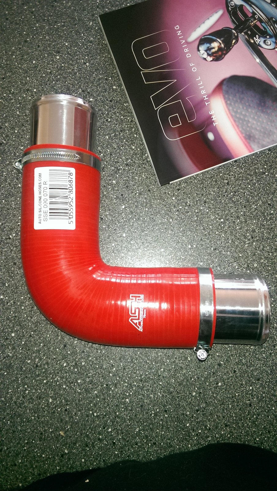

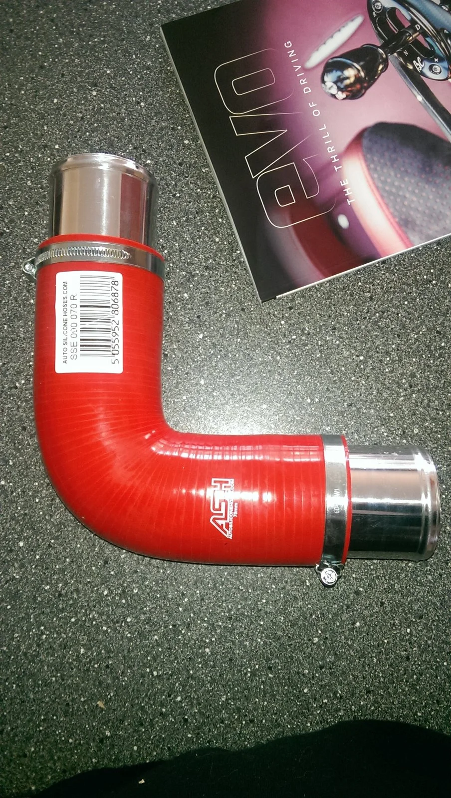

Fitted mine today and well pleased. Ash made me up a silicon pipe with alloy swaged inserts with 70mm external diameters for each end. It made fitting dead easy as both ends (engine and filter end) can be adjusted for length. This was about 16 quid. I also went with the smaller offset Ram Air filter at 24.99. Took about 20minutes to fit in all. Took about 5 minutes for the ECU to sort itself out but then ran great. Not as loud as I was expecting but once over about 4K revs sounds superb with the Milltek system.

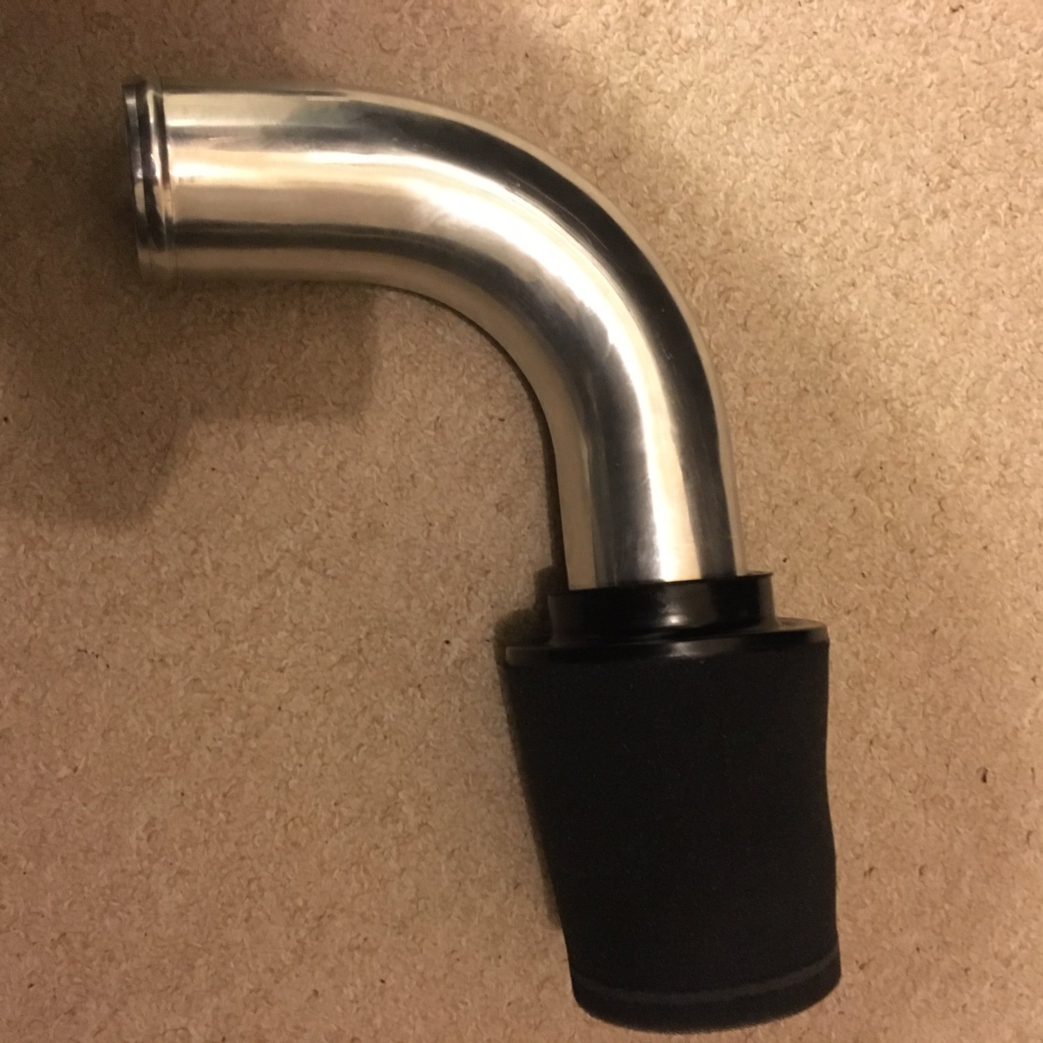

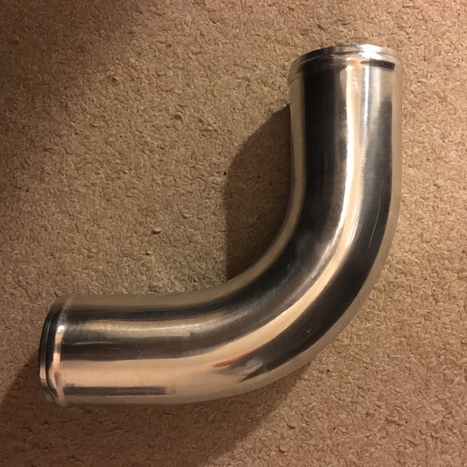

I bought an alloy pipe with swaged ends but doesn't seem to fit the air filter properly. Did anyone experience the same problem?

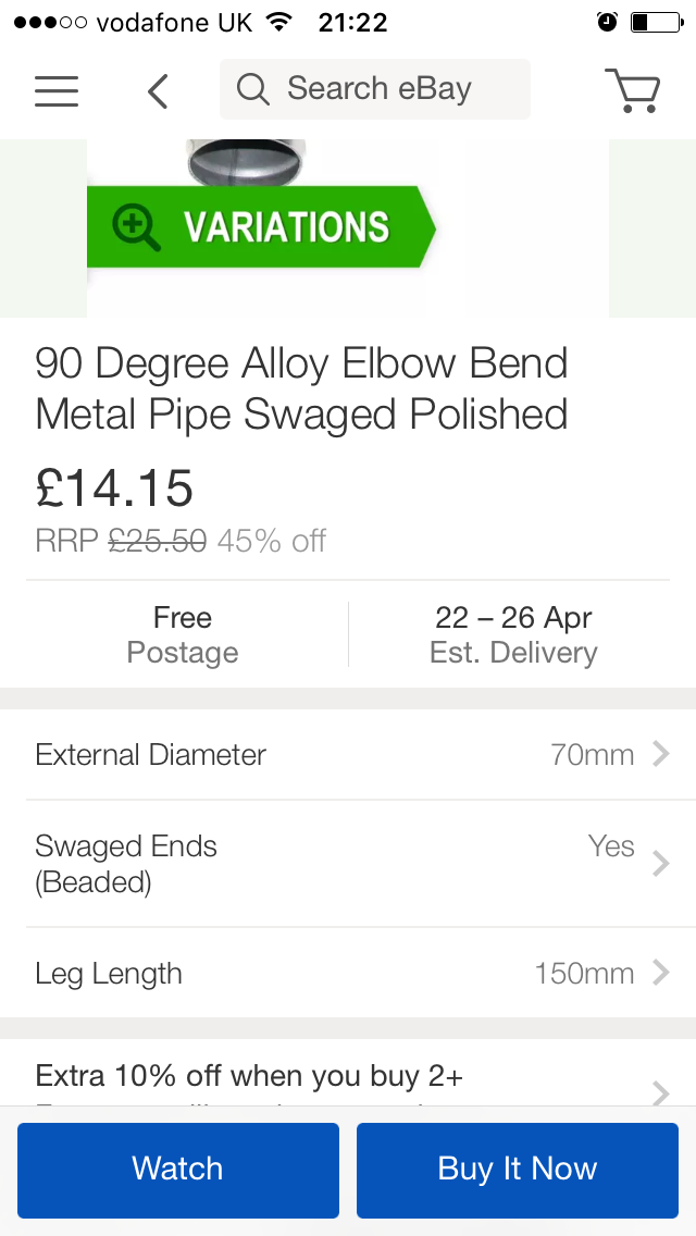

external pipe diameter of 70mm with swaged ends is the correct fit chap. You may need to smear the filter neck with a dab of vaseline first if its dead tight though but it'll go in - assuming you've got the correct filter size. The jubilee then tightens up behind the swage.
I've been trying to push it in so hard that the cage is starting to warp. After I tried some vaseline it seems to want to pop back out. Clearly I'm not doing something right. I'm expecting the swaged end to push past the the rib section in the filter.
It can be tricky. Make sure you fix the cage inside of the filter.
What you might find easier is to take your battery out, push the elbow into the filter outside of the car making sure not to grip the foam part of filter. Then assemble the induction kit and refit the battery after. The battery takes a few minutes to remove with a 13mm socket on an extension bar. to get the battery retention bolt back in just use one hand from the side and one above and you should be ok.
@mayur_my. Optical is correct, it can be tight and maybe worth assembling prior to fitting. Ignore the silicon pipe in the pic but the swaged ends of yours are like this?

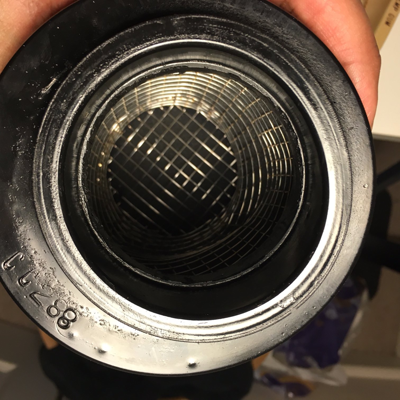

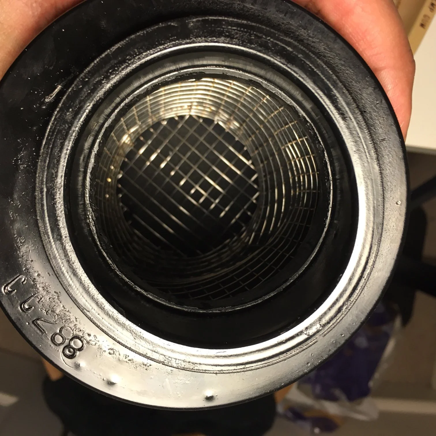

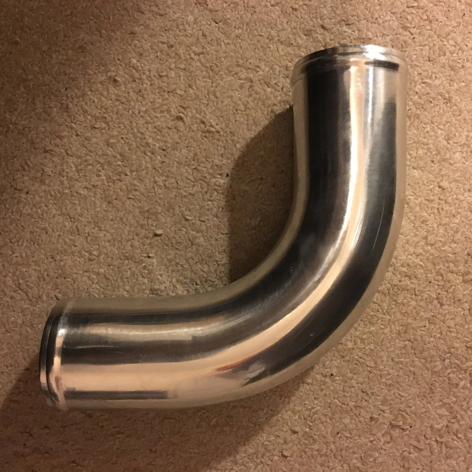

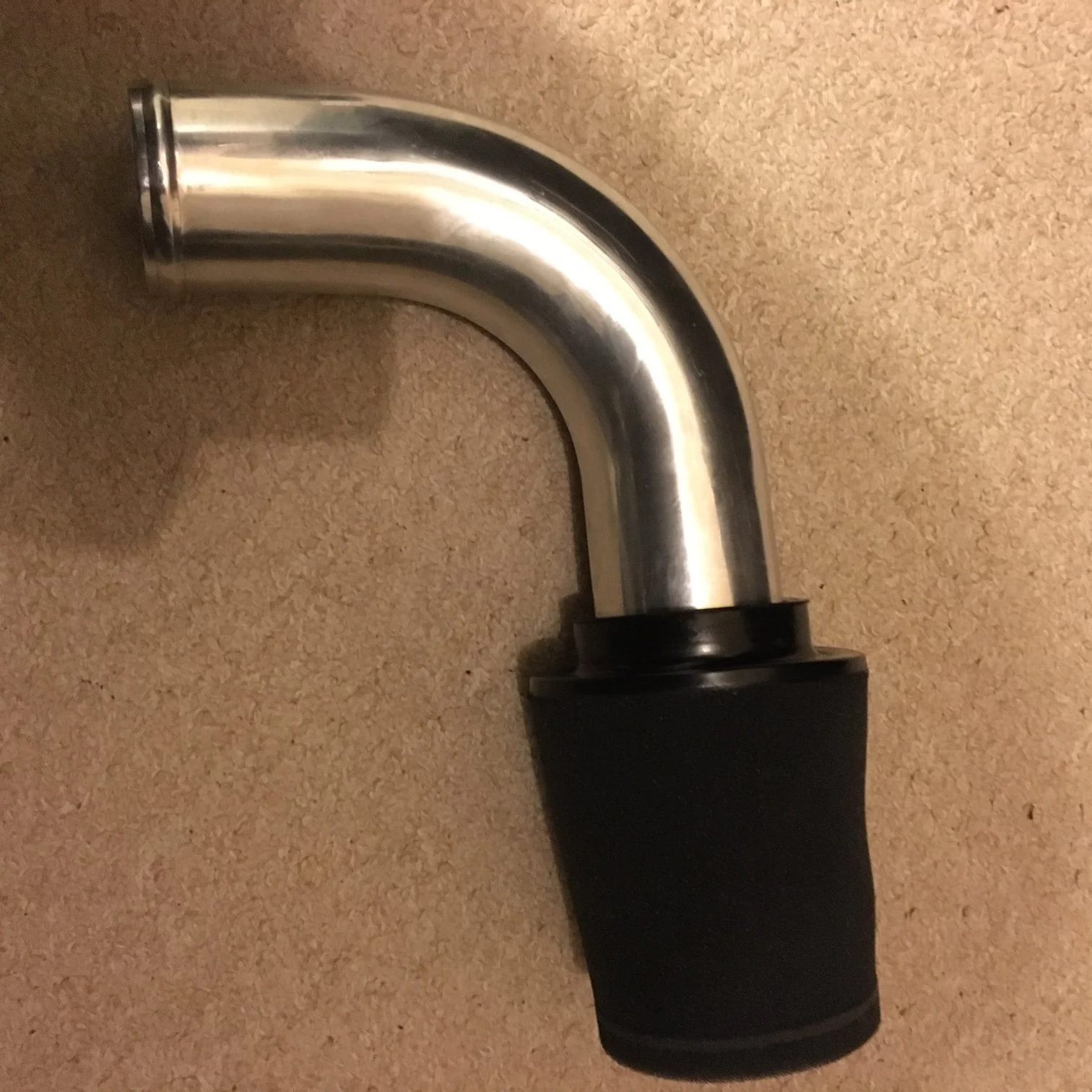

Here Ive attached some pictures of the pipe and filter. Its feels like the pipe doesn't go in far enough. I've been trying to connect the pipe and filter outside the car so there no issue of not having enough room to push it in. I think the only thing for me to do is tighten the jubilee clip and see whether the filter can be easily pulled off. From what I read I understand I should try and loop a zip tie through the jubilee clip before I completely tighten it. If I get it fitted tomorrow I'm off to rag the car for the afternoon and enjoy the sound everyone is raving about. Thanks for all the advice I'll report back if I continue to have problems. This forum has helped me sort so many things for my car so a big thank you to those people that make an active contribution.
