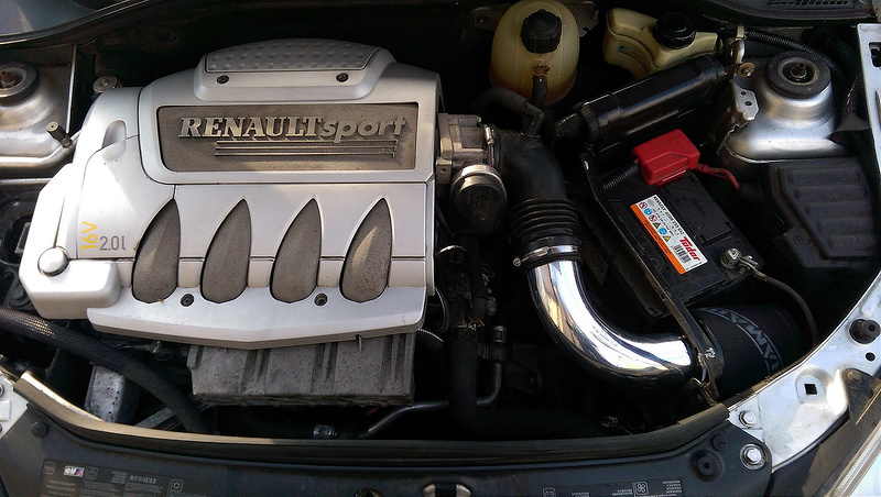

Yep, me again.
So I've removed the airbox, however there's a tube on the other side of the airbox going down below the headlight thats connected to something. What is it?! Also how to remove this?! Sorry for being useless again haha
Yep, me again.
Accoutic valve. Rip it out, bung the pipe that goes to the inlet
Remove the bumper. It doesn't NEED to come out, you could just leave it there
If it's a bumper off job I'll leave it for today!
But otherwise, I think I finally got there!
I'll have a go when I get time at some point possibly! It took me about an hour to do this as it was (I'm sure you guys did it in like 5 mins or something but anyway!)
Thanks for the help!

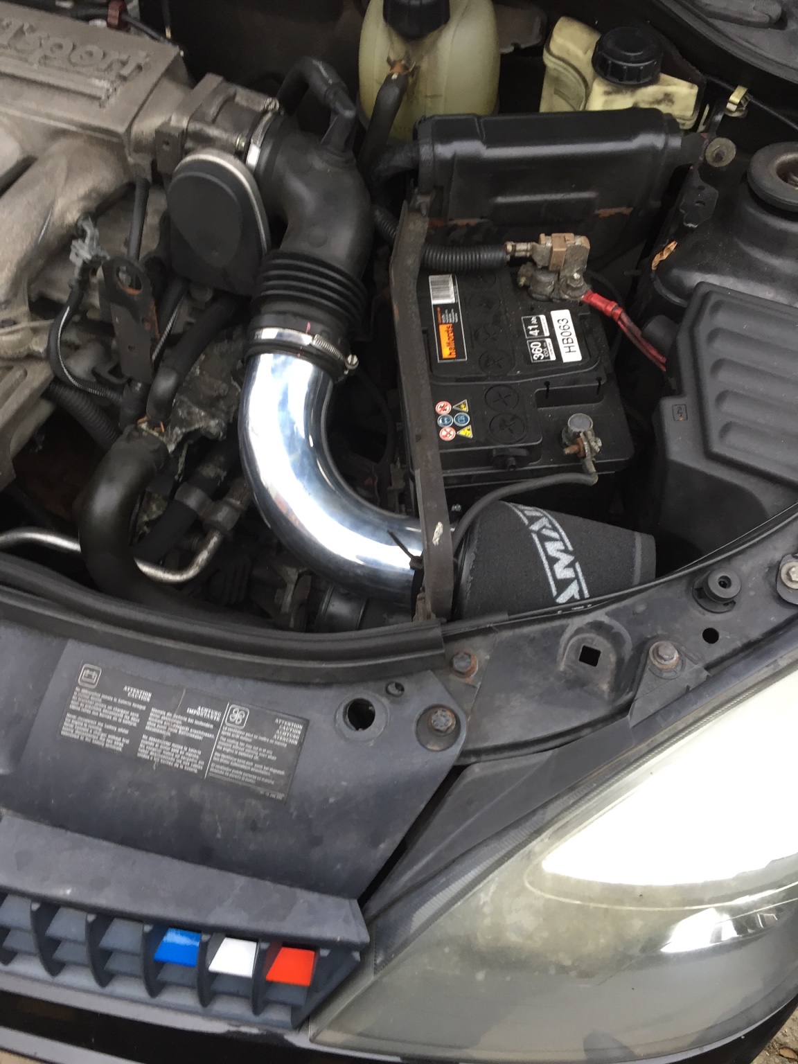

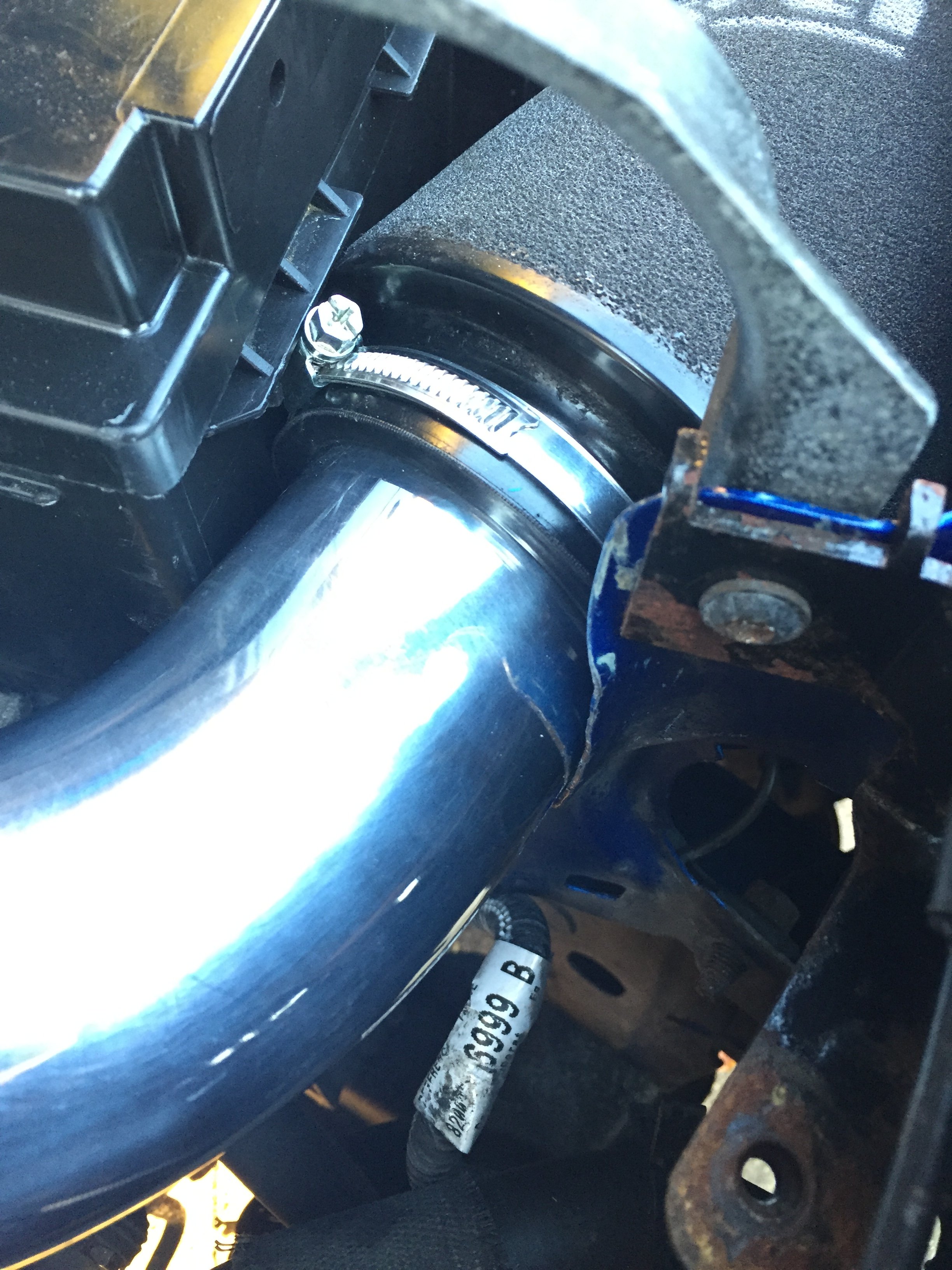

So mines being a bit of a PITA!
is there extra metal work in the ph1 than the ph2?
Normal size battery but using a k&n filter until the Ramair one turns up. Possibly k&n being too big?
Any one had this problem? Had to bend the metal work to make it fit! It's bloody tight! But sounds awesome!!!
I had to cut the metal away on mine after fitting a non standard battery which was slightly bigger
Is the battery all the way back?
Slotted straight in on my Ph1 with no issues....apart from putting a massive gash in my hand as I dragged it over a jubilee clip bit that acted like a knife blade.
