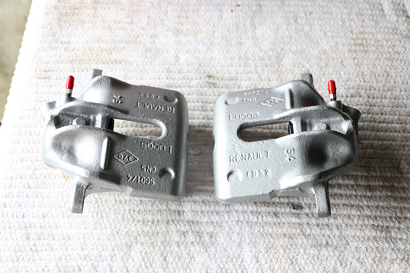

Are the calipers hard to rebuild? The ones on my build are shot wouldn't mind doing this.
Hi mate, thank you very much.
They are not too bad tbh but i used to work on Aston Martins where we used to re-build the 4 pot calipers so these are easy.
The trick is to get everything clean, i wash the calipers in the cleaning tank 1st, then remove the pistons and seals. Once the seals are out then i clean the seal groove with a spike to make sure that there isn't any old bits of rubber seal in there and its 100% mint ready for the new seal.
Then they get cleaned again and a good blow out with an air line, to reassemble i wipe clean brake fluid around the inside where the new piston will fit and on the new seal.
Pop the new seal in, being careful not to damage it. Once that's in then you fit the dust cover. The tricky bit is trying to get the new piston into the dust cover, for this i use a spike to run around the edge of the dust cover until the piston is in.
This can take a while as its a tight fit around the piston, again being careful not to split it with the spike. Once the dust cover is in then you can push the piston in to the caliper.
You must make sure the piston is square or it will catch on the piston wall but once it is square then it pushes in fine.
I always replace the bleed nipples so that the new ones will seal, for the cost its not worth using the old ones that have been done up and un-done god knows how many times. :smile:

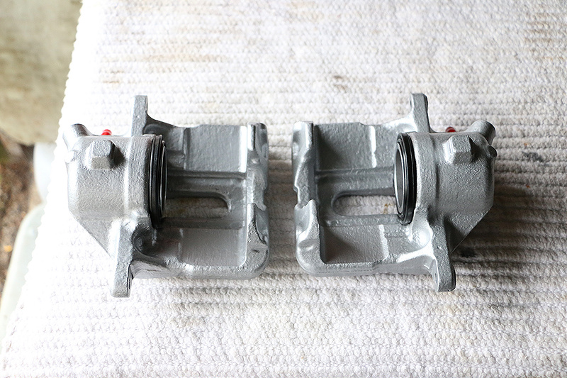

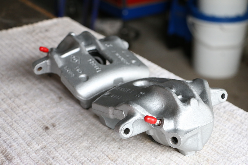

Here are a few pictures of the finished calipers that i sent back to Andy.
005 by scottieraven, on Flickr
011 by scottieraven, on Flickr
006 by scottieraven, on Flickr
Thanks for posting up the pics mate (and indeed for such a good job on the calipers). They are currently sat on my computer desk staring me in the face and will remain there until the spring. As soon as the winter is done they will be going on the car. I might then send you the calipers I have on there now and get those refurbed as an additional backup set... ;)

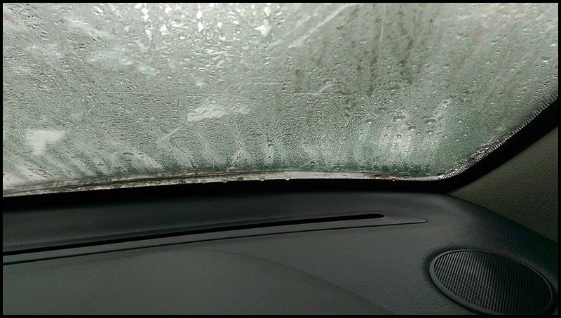

Talking of last night being a chiller, I had another issue this morning whereby the inside of my car windscreen and side windows were frozen solid. I couldn't get the heaters on because the car wouldn't start and I couldn't easily clear the inside due to no engine running and no heat... catch-22! I checked the seals later in the day and all appears waterproof and airtight. I think the issue maybe due to the fact I had the whole interior washed and shampoo'd last week when it was detailed. With the weather turning so poor, it's not fully dried out and I think that's where the moisture is coming from (seats, carpets, headliner).

Been terrible the past 2 days down here on the coast. Door was frozen solid this morning.

Ooft, that lovely sound of seals squealing as you tear them apart from their frozen hold... :tongueout: I can imagine it's quite, er, 'fresh' down by the coast this time of year!

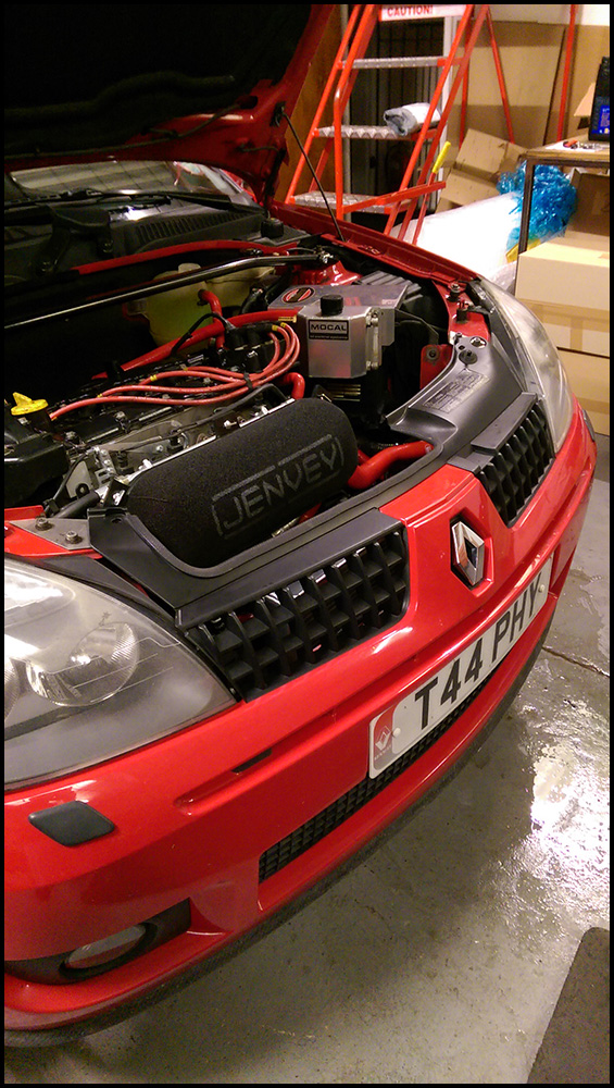

November 2014 - Update #3
A few things have happened over the last couple of days that have resulted in an elevation in my mood! Apart from the bit where I'm expecting the first points on my licence... s**t!
Anyways, I was able to make use of a dongle, software and laptop to hook into the GEN90 ECU the other night. The plan was to take a look at what the ECU was seeing in terms of sensor readings and, most importantly, to stay WELL clear of anything that didn't make sense... Such as the mapping tables! LOL! To cut a long story short, the sensors were looking spot on and certainly returning what appeared to be valid results. But... the lambda/oxygen sensor was disabled. No wonder fitting a new sensor recently hadn't made any difference... The new sensor was simply enabled and - well - the difference was noticeable. No more issues around 2k and no more issues around 3k either. It's now a LOT smoother and civilised and I can drive around at 30mph in 5th without the engine stuttering, kangarooing and stalling. My mpg has also improved somewhat. It was around 18-20mpg. Now I'm hovering around the 30mpg mark when driving steady. That makes me happy :)
Another good piece of news is that the cold start is improved, too. Just a single little blip to get her started and she idles fine now and warms up nicely. It sounds like a bag of spanners admittedly (cold forged components!) and rather lumpy, but no stalling and no drastic rpm drops leading to stalls. :)

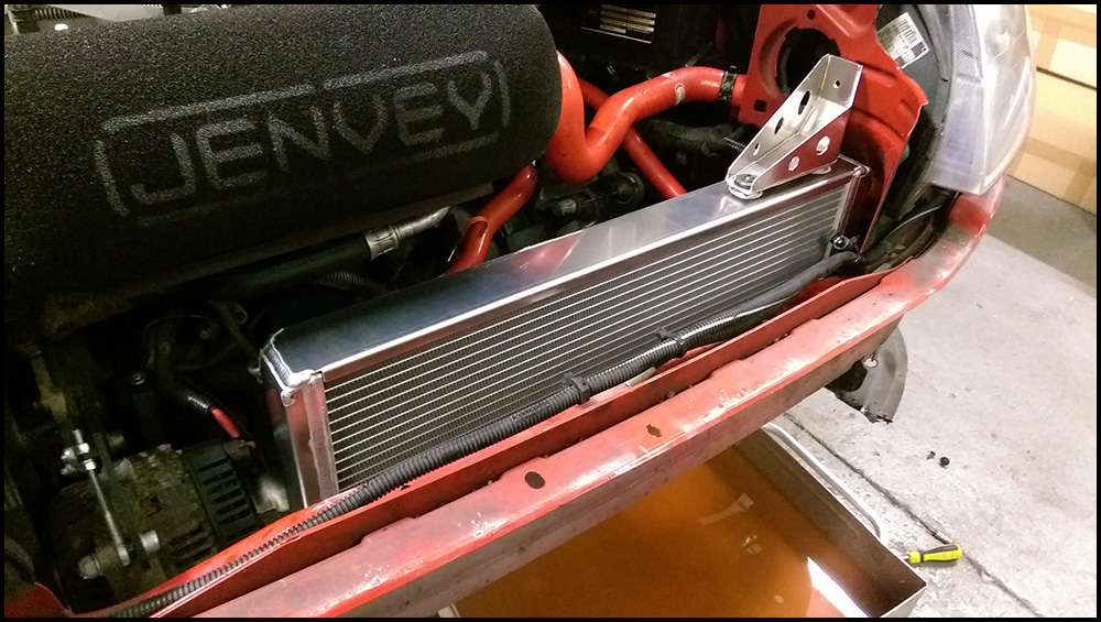

Fitted the new radiator to the trophy this morning, very very easy job, fits perfectly and Andy seems one very happy customer, looks the dogs too if I do say so myself. I am indeed selling an identical radiator to the one that is shown here. Can't wait for Andy to fit the new headertank once the cap arrives :) pleasure to meet you and do business with you andy!

Fitted the new radiator to the trophy this morning, very very easy job, fits perfectly and Andy seems one very happy customer, looks the dogs too if I do say so myself. I am indeed selling an identical radiator to the one that is shown here. Can't wait for Andy to fit the new headertank once the cap arrives :smile: pleasure to meet you and do business with you andy!

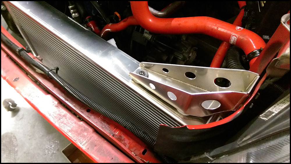

November 2014 - Update #4

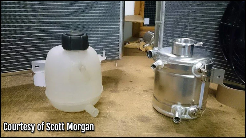

As alluded to in my update yesterday, I took a road trip this morning to see @ScottRallye in order to get the new radiator/fan fitted and to pick up the header tank (sadly the header tank will have to be fitted at a later date as I need to get hold of a suitable cap first). Scott was kind enough to take time out of his day to fit the radiator for me whilst I generally got in the way and had a nosey at some of the other beautifully fabricated and welded items that he and Matt have produced (pics to follow). Naturally I am grateful for his time, help and expertise and extend my thanks to him.
Please excuse the not-so-good quality of the mobile phone photos because, like an idiot, I didn't take my camera with my as I had intended to. Suffice to say, the quality of the radiator (and header tank) is superb. Functional and good to look at; beautifully fabricated and welded. These items most certainly are NOT like the cr*p you can get off e-bay and consequently aren't the cheapest. BUT, they are worth every penny (in my opinion) and if you are investing a significant chunk of money on your car/engine then it makes sense to also have an adequate cooling system. I'm in no way affiliated to where Scott works but would highly recommend you give him a shout if you are serious about getting a proper radiator setup done (or indeed header tank, catch tank, custom pipework, etc.) I'll post up a few pics as I go along...

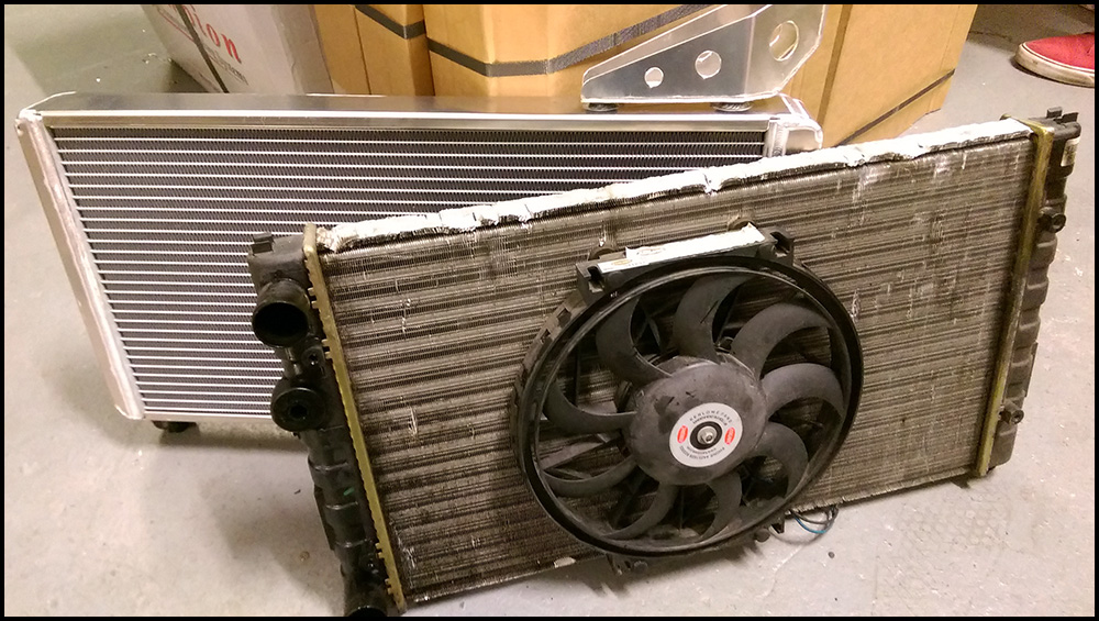

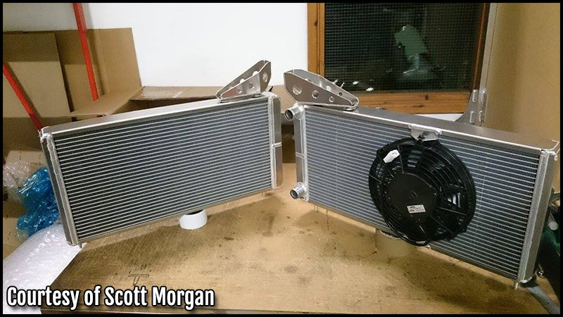

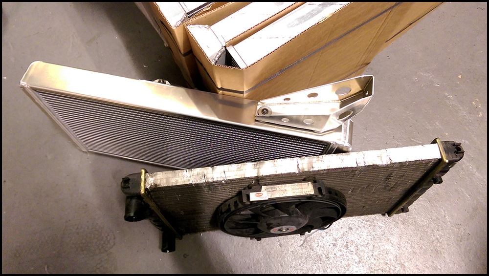

To start with, here's a side-by-side comparison of the new radiator and the old Polo rad that I was running. Obviously the new radiator is running a considerably more efficient cooling core and is double the thickness.

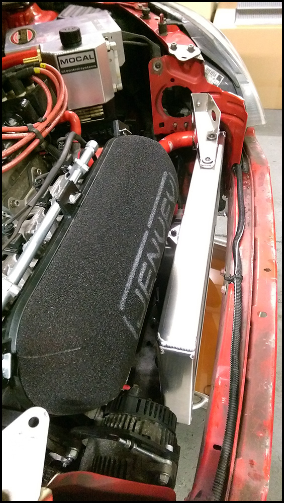

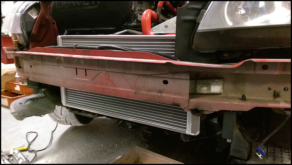

With regards to the radiator, it was/is a breeze to fit. Simply take the old one off, drill an additional hold for a securing bolt and drop in the new radiator. It fits like a glove. It was designed specifically for these cars hence offers this nice drop-in ease of fitting. My radiator also has the SPAL VA07 PULL fan that is PROPERLY fitted and sealed against the radiator core. Rather than sitting a short distance away from the core and pulling through surrounding air, this is sat flush against the rad and also sealed to ensure that all air pulled through it actually comes through the rad (and naturally offers maximum possible cooling).
You can just see in the photo above where you need to drill an additional hole for securing the rad via the mm perfect bracket. Damn it looks good! The picture below also gives you some idea as to the room in the engine bay that this setup has afforded me (and, again, where you need to drill that hole for the bracket).
All back together! It's a shame that it's hidden because I just want to show it off... :)

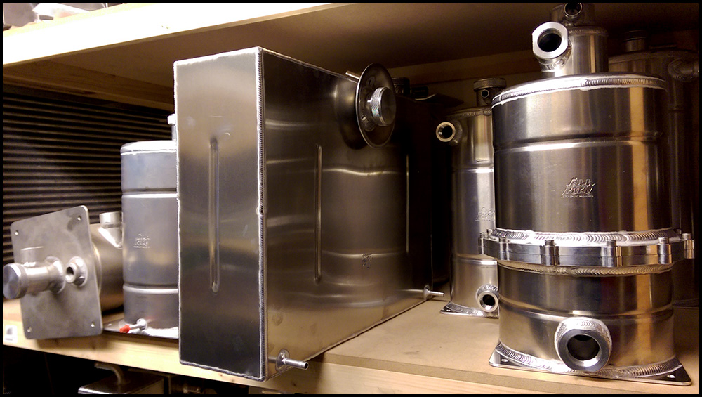

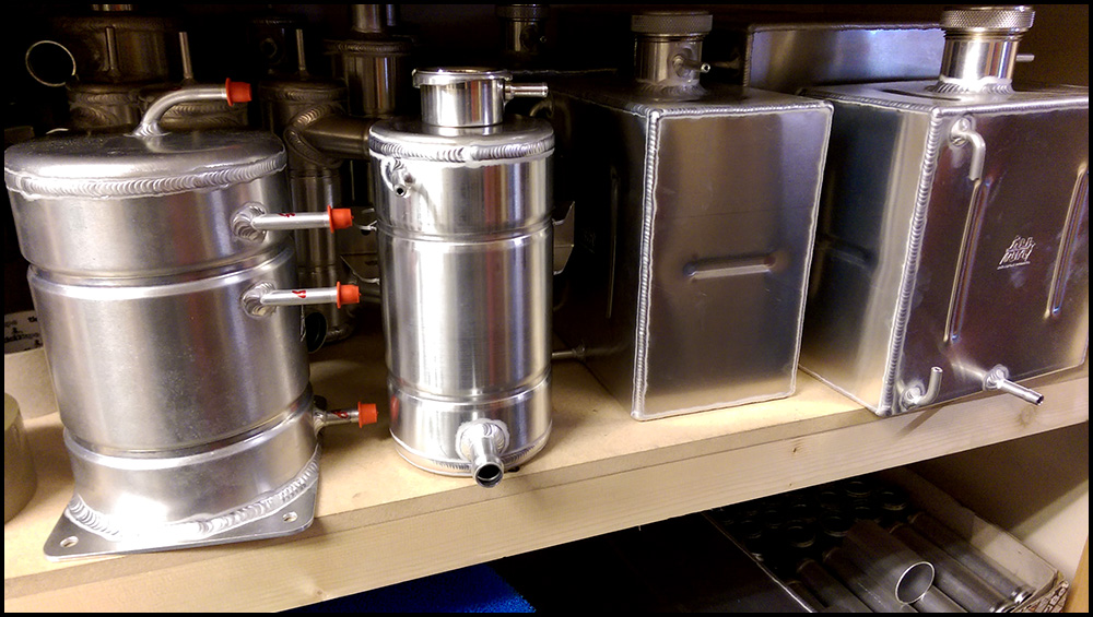

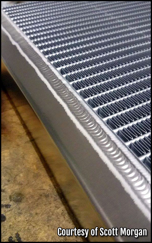

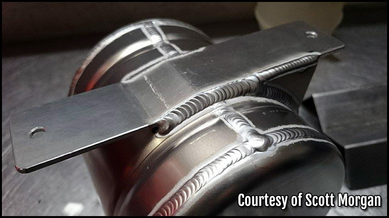

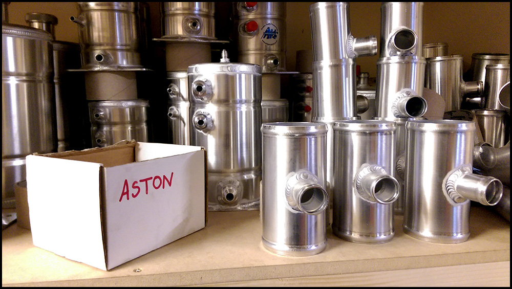

As mentioned above, I had a bit of a nosey around the storeroom and shelves whilst Scott wrestled with removing the bumper. :tongueout: I'm sure he won't mind if I post a few pics showing off their handiwork...
I guess the quality of products speak for themselves when your client-base included WRC and F1 teams :)

As a high-compression build it generates a LOT of heat mate. Hence why the old Polo rad was only ever a temporary measure until I got a proper setup installed :)
