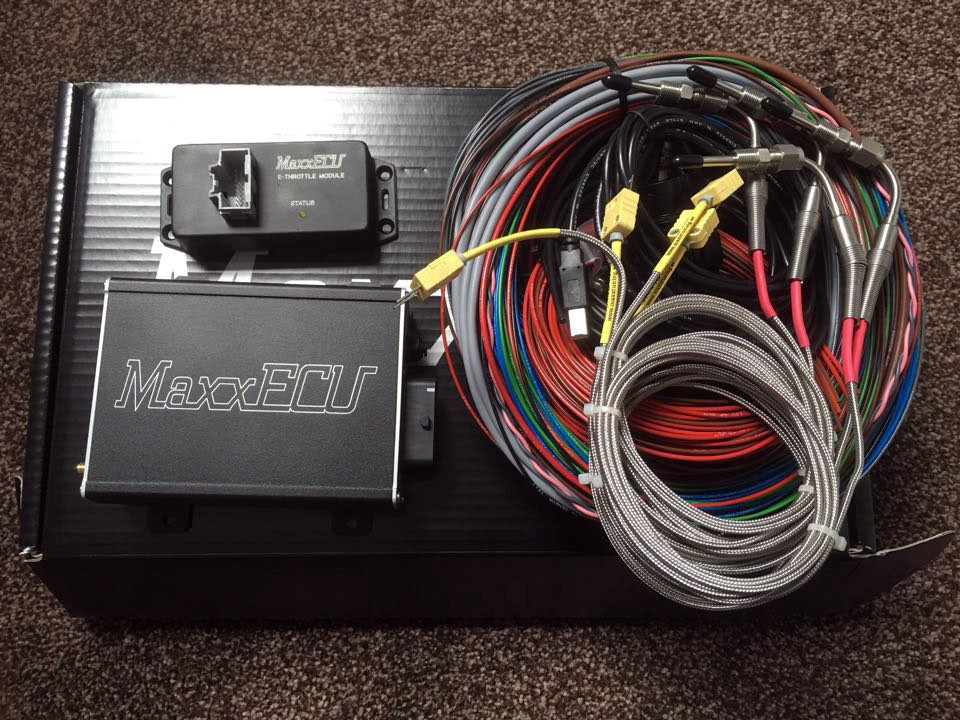

I am happy to report that some good progress was made on the Trophy last week. The EPAS is in and working (will be tweakable by having a custom dial added somewhere in the cockpit), the interior is back together and the standard electrics are pretty much back up and running - such as windows, lights and so forth. The security system will no longer work but that's easy to sort later with an aftermarket system. Continuing the good news, the digital dash and ECU also powered up without issue. Obviously they are not yet fully integrated and setup as the build needs to advance considerably further until that can happen. At least I know my brand new parts (which are now several years old) do actually work.
(MaxxECU, e-Throttle module, partial wiring harness, USB connection cable and 4x EGT sensors)​

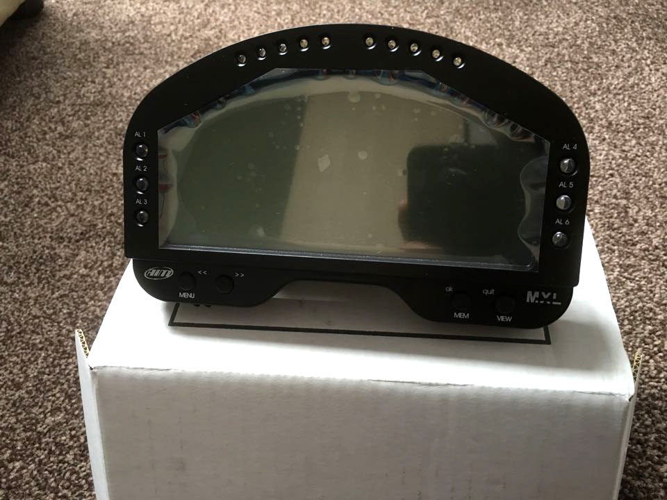

(Digital dash to completely replace clocks - fully customisable alarms / alerts, etc.)​

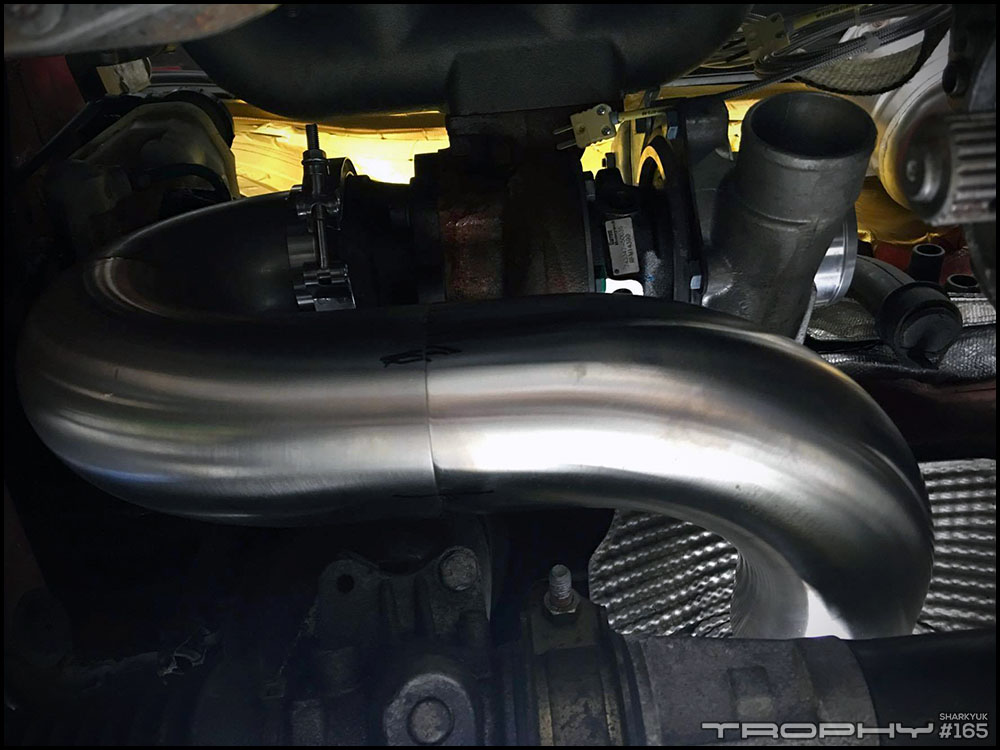

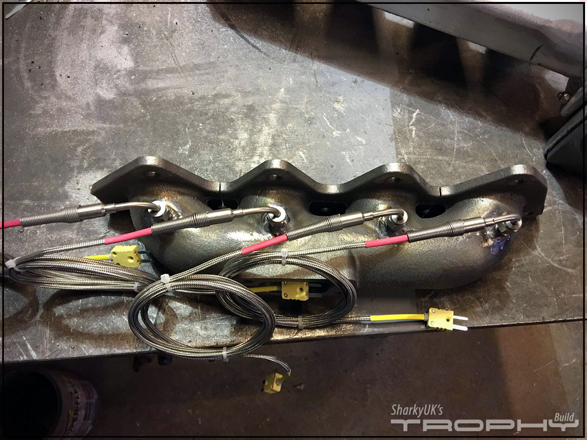

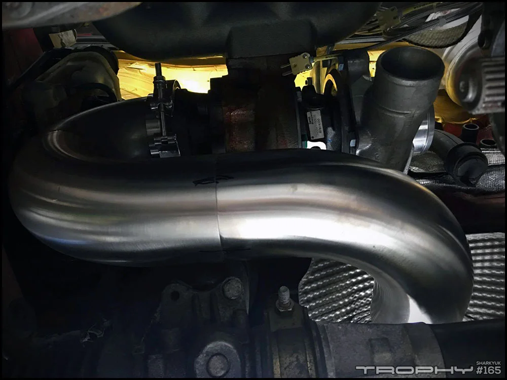

Taking a closer look at the exhaust it was evident that the increased diameter and size of the system did not actually leave much room for the placement of the swirl pot (which was to be on the underside rear of the car). It was deemed a too risky to run the fuel lines and swirl pot so close to a red hot exhaust system. If something did go awry I would at least prefer a little bit of extra time to try and vacate the car before the whole thing went up in a ball of petroleum-fuelled flame! The most sensible option is to lose the boot and fit the swirl pot in there along with a high-pressure fuel pump. As the boot space is being lost, at least partially, it was decided to move the battery to the boot as well. The plan is to actually build a false floor in the boot space so at least a small amount of boot space is available should I need it. Of course this will be done properly, too - proper connectors and fittings for the fuel lines, etc. and not just lines fed through holes drilled through the chassis / underbody! The fuel system is giving a little cause for concern but the revised plan is much better and safer.
(Got to monitor those EGT's...)​

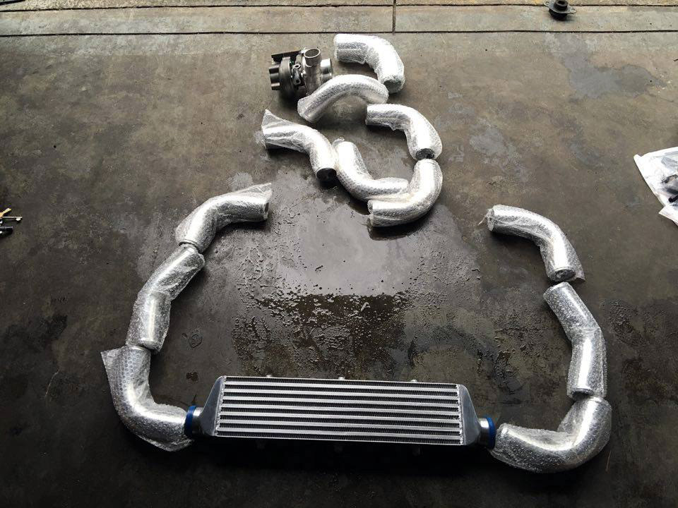

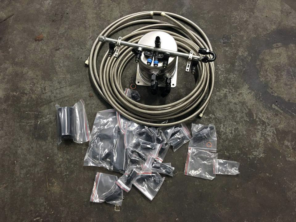

Talking of fuelling, the sad news is that several parts I had bought for the build are actually missing - such as injectors and fuel rail. There are also other parts missing and I daresay more will come to light once Mick and I have gone through the parts inventory again. No gaskets, not much in the way of the original nuts and bolts, the list goes on. This is very disappointing and I'm not really sure what to do about it. I'm not sure there is much I can do about it as I have no paperwork for the items purchased and most were bought through SJM several years ago now. I may have to seek professional advice on that one but I'm not sure it's going to be worth the hassle; potentially an expensive lesson learned unfortunately.
(Fuel parts, some of which are missing)​
(Intercooler and friends)​
Still talking of fuelling, Mark (NorthloopCup) has kindly been helping and advising behind the scenes as he is pretty familiar with this sort of stuff. He recommended an R3 aluminium fuel rail hence Mick will be onto Renault tomorrow to enquire about the required parts. (Cheers Mark!) He has also been able to advise on the turbo as it is sometimes the case that roller bearing turbos don't always take well to having excessive amounts of oil fed through them, hence the potential requirement for an oil restrictor.
Thinking even further ahead Mick has been reaching out to businesses in an attempt to obtain quotes for custom interior work. Like myself, he is not too keen on simply bolting the digital dash to the existing binnacle - it would look absolutely crap to be honest. Hence, we are considering a custom binnacle design that incorporates the digital dash seamlessly. There are various options - 3D printing (cheap, but not the best finish), fibreglass-like composites (middle of the road, decent finish) or high-end composite carbon fibre complete with custom laser-etching and similar. I may opt for the carbon fibre if the price is right (with 'Trophy' and '165' laser etched somewhere into the design provided it's not too tacky and complements the overall aesthetic of the car). As said though, that's a long way off yet as there's a lot to get done before then.

Talking of ECU, I am using a MaxxECU setup that isn't particularly common on RenaultSport Clios! I've gathered all the relevant documentation together (including wiring diagrams) and sent them over to Mick to aid his progress on the loom / harness and electrics side of things.

@SharkyUK those R3 items aren’t available from Renault!! It’s from rsport! I’ll get the details for you if mick struggles. ??
That explains @NorthloopCup question the other day!! My advice Sharky is to make sure you at least order the banjo bolts for either end of the fuel rail. I didn’t and then ended up ordering it the other day with some other parts. Each time John at R Sport has been extremely helpful ??

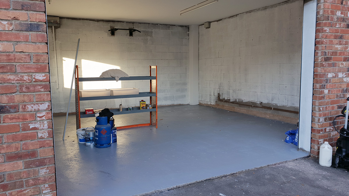

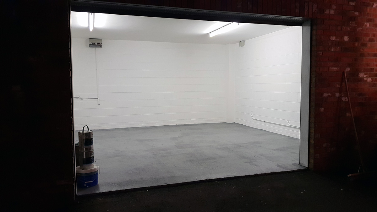

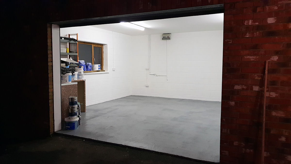

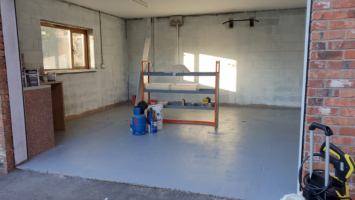

Nothing much to report as I have been stupidly busy of late. In fact, I've hardly given the Trophy a second-thought over the last month or so! However, I have turned my attention to the "Trophy Room" - a little place that Trophy #165 can call home when she's ready to return.
Still a work-in-progress but it's great to finally have a decent garage to put the cars in and to be able to work on them. Not that I know what I'm doing.
It's been acid-washed and currently has a single coat of floor seal / paint. The floor will be finished when the walls and ceilings are complete (which are undergoing a 50/50 mix whitewash before a couple of layers of paint are thrown at it).

Nice little home for it @SharkyUK I would suggest getting some decent lighting in there, TBH two single four foot fluorescents aint gonna cut!! You will really want some decent lighting, if you weren't so far away I'd do it for you ?
Yeah, the lighting will need addressing. So... are you a sparky? Rates? Availability? Hahahaha! :)

I have no idea what state the Trophy is in but - yay - the garage is complete and ready for filling with junk. Or cars. Or both. :)
