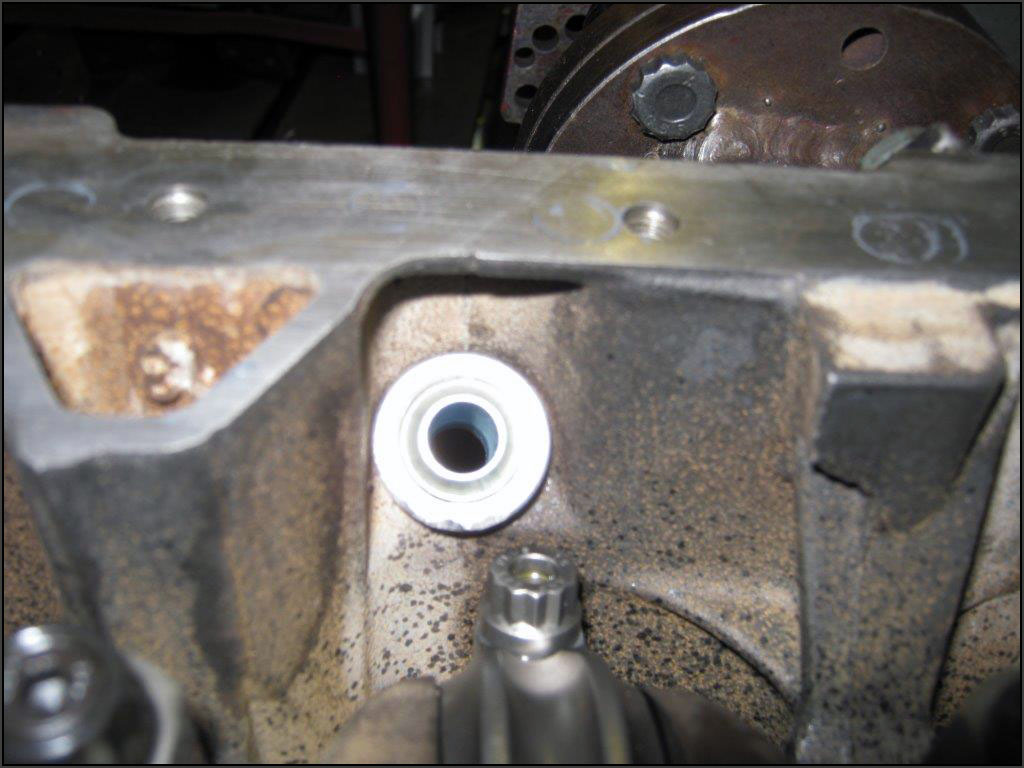

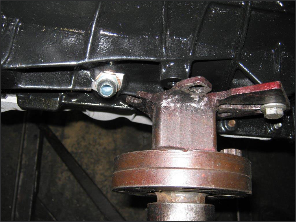

Stick a picture of the sump up Andy , it could only really be for a temp sensor or turbo oil return depending on location.
I think I've sussed it mate. To be honest it might already say somewhere in my build thread but I can't find it...! ?
This first image, I believe, shows an AN8 threaded locking ring which is likely for the turbo oil drain.
The second image is an M12 x 1.5mm boss welded to sump, which I expect is for a temperature sensor.
? Possibly maybe. Seems to make sense and I seem to recall that (the above) was the intention!

Surely that's the oil feed back to the sump? Standard fare for turbo'd vehicles.
Wouldn't normally have a temp sensor in the sump, not that accurate as it won't be seeing the true operating temp.
Best to have a sensor on a sandwich plate off the oil filter.
threaded M12 is definitely turbo oil return. AN8 is too small for that.
AN8 likely a sensor - or catch can return if its set up to do that (not a good idea IMO)
Thanks for the replies, gents. I have a helping hand visiting the car next Friday who will probably be able to shed some light on what goes where, etc. ?
